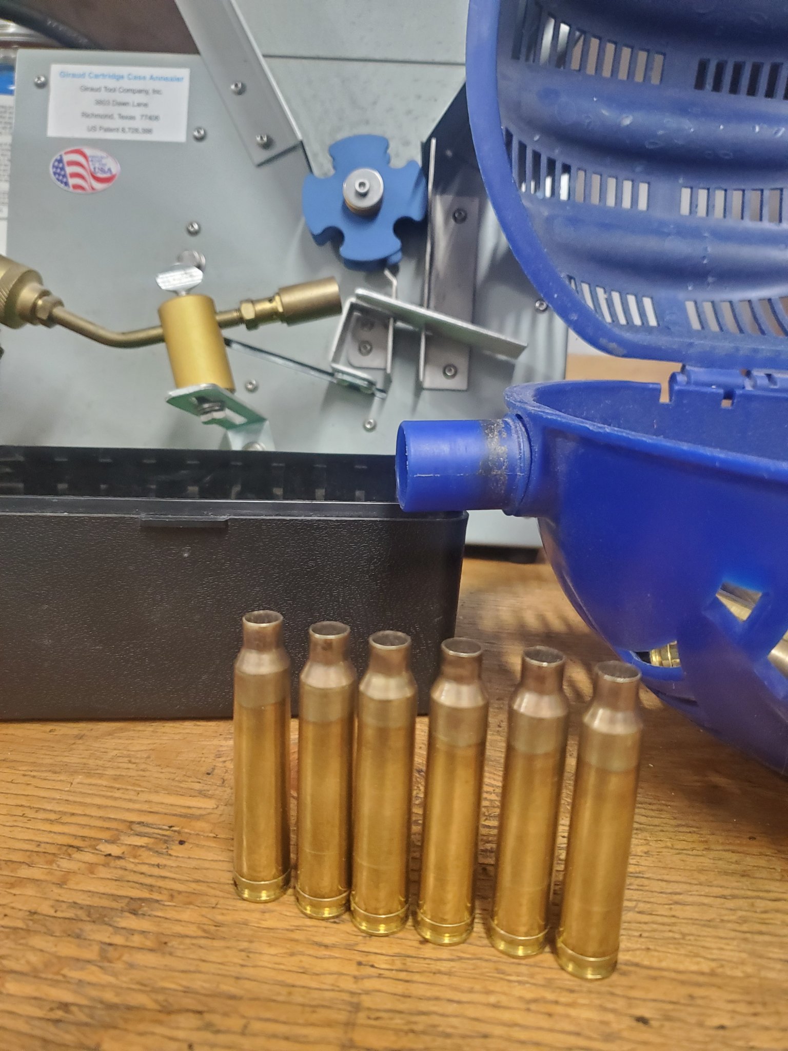

This topic isn't a hill I choose to die on. I conducted my own in house tests to see if annealing was of benefit and I found it is. I also anneal by flame with a drill/socket/torch and can read the annealing progress on the brass and know when to quit. This seems to drive the AMP guys nuts, but this/my method works. I brought back to life a batch of brass that had become so work hardened, the seating force became ridiculous. I did't know about annealing back then (6yrs ago?) and called RCBS to ask if there was something amiss with the die that would cause this. So, they recommended I anneal the brass. Couple youtube videos later and a bit of developed finesse and I saved that batch of brass for some continual loadings. I have been annealing ever since. My necks glow a little bit and the anneal line forms just below the shoulder and I'm good.
My method is a time suck, so I have been eye balling the "Ugly Annealer" to automate my very similar flame anneal process.
