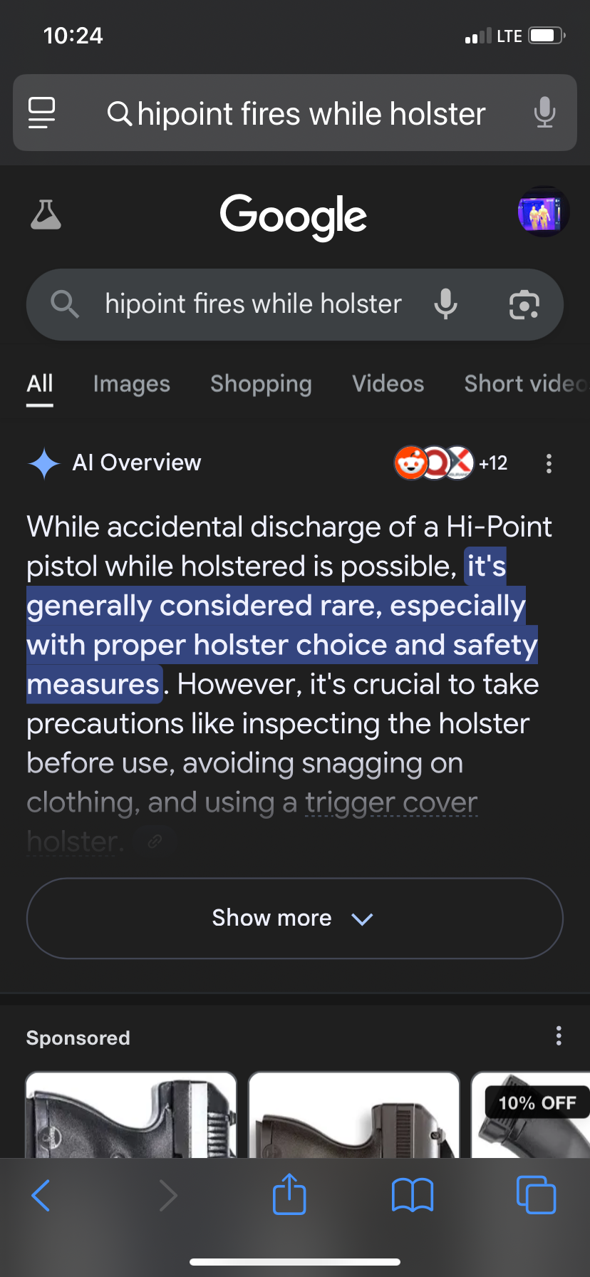

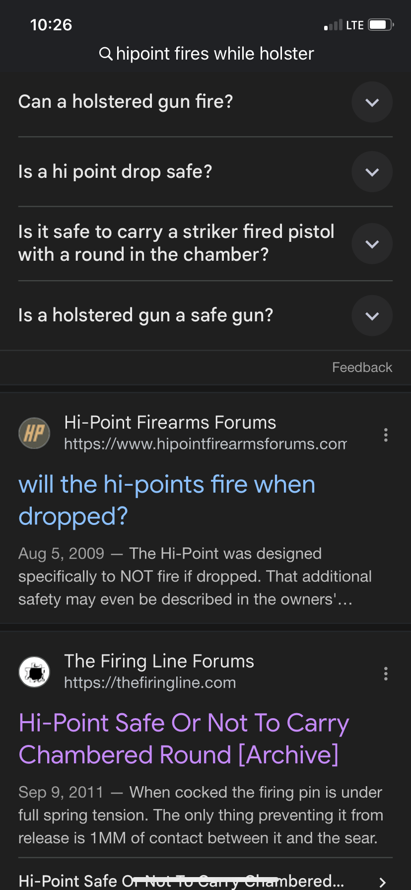

I did a quick google fu search- and stopped counting after 80 mostly well documented incidents of a 320 firing while in the holster.
Did a similar search for “Hi Point fires while holstered “. And all results were for Sig firing while holstered .

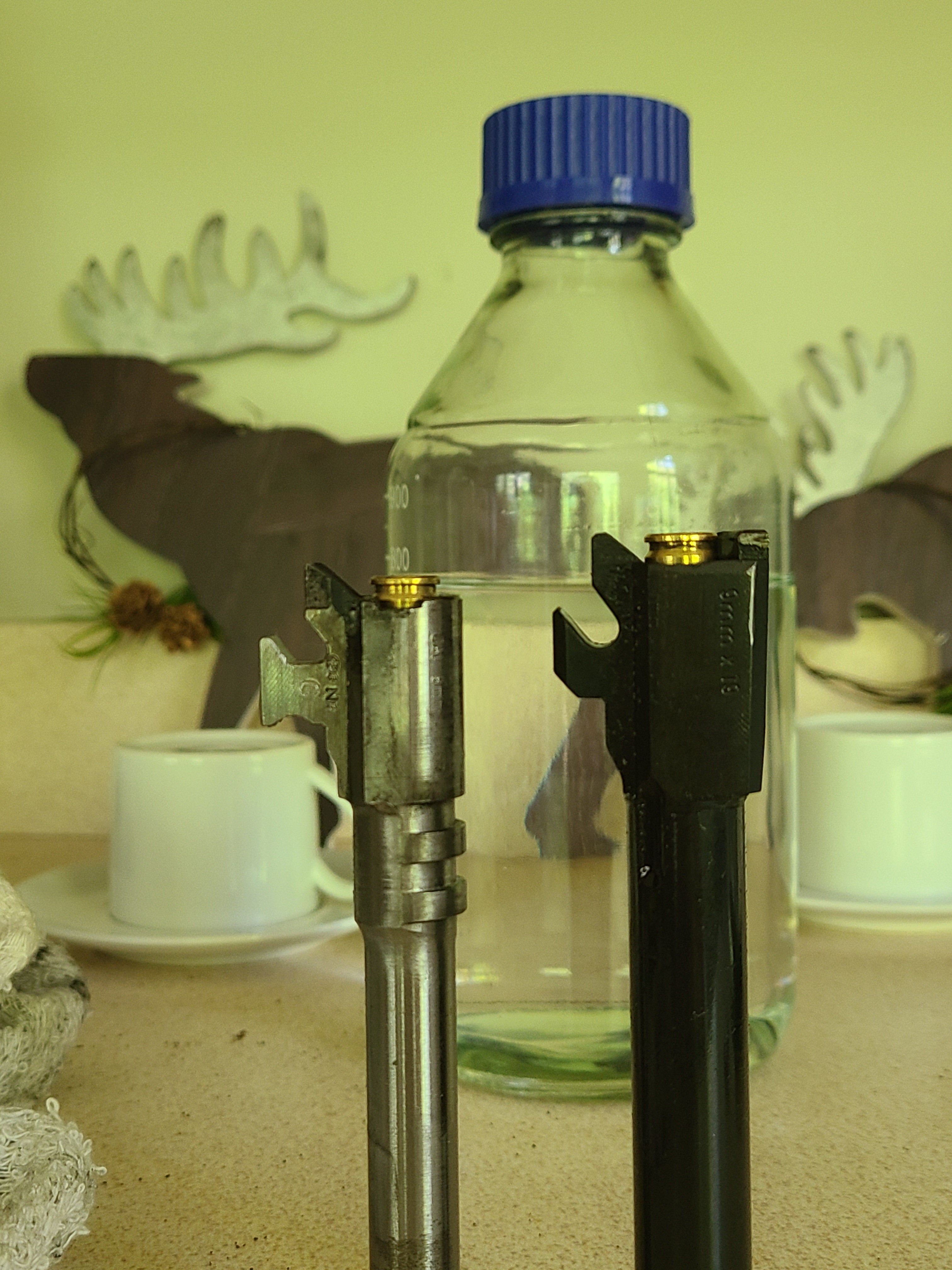

First, OOB detonations causing the grip module to blow up. This is thought to be caused primarily by the disconnector that connects before the action is in battery, and a barrel with an unsupported chamber. The chamber problem is similar to early Glock, and I've read to a worse extent. Apparently the disconnector wears with use and makes this more likely.
