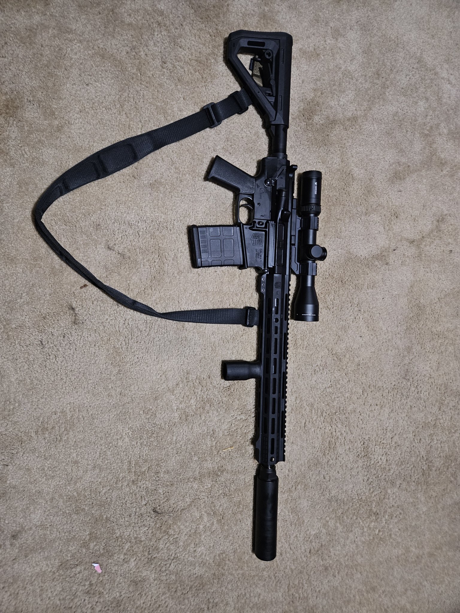

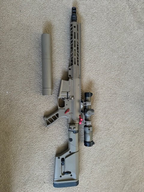

Any 8.6 Blackout Builds here yet?
Finally got 11.5" Mos-tek to finish 8.6 w/6.5tw and TBAC Ultra. Haven't loaded anything yet, waiting for temps to get to double digits...

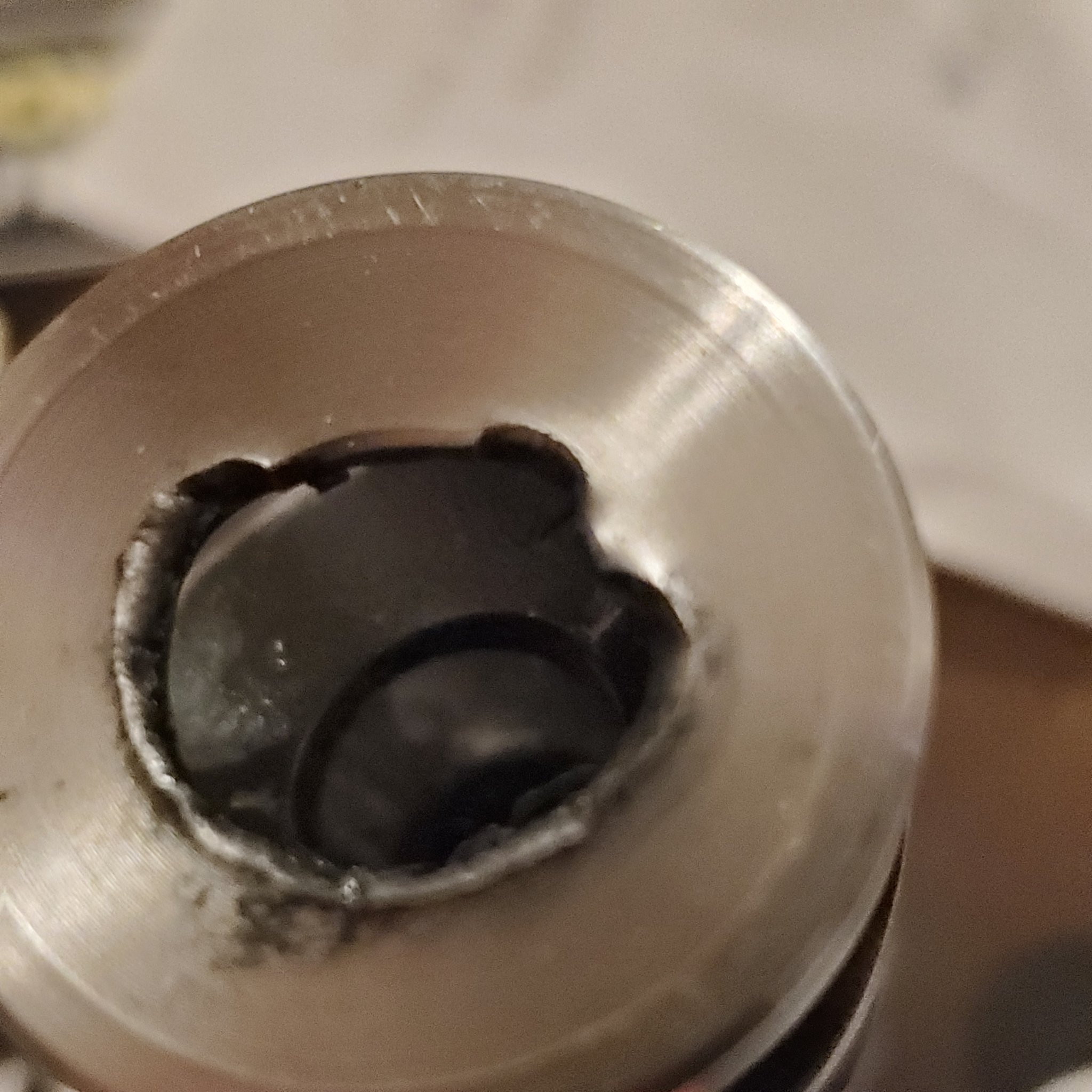

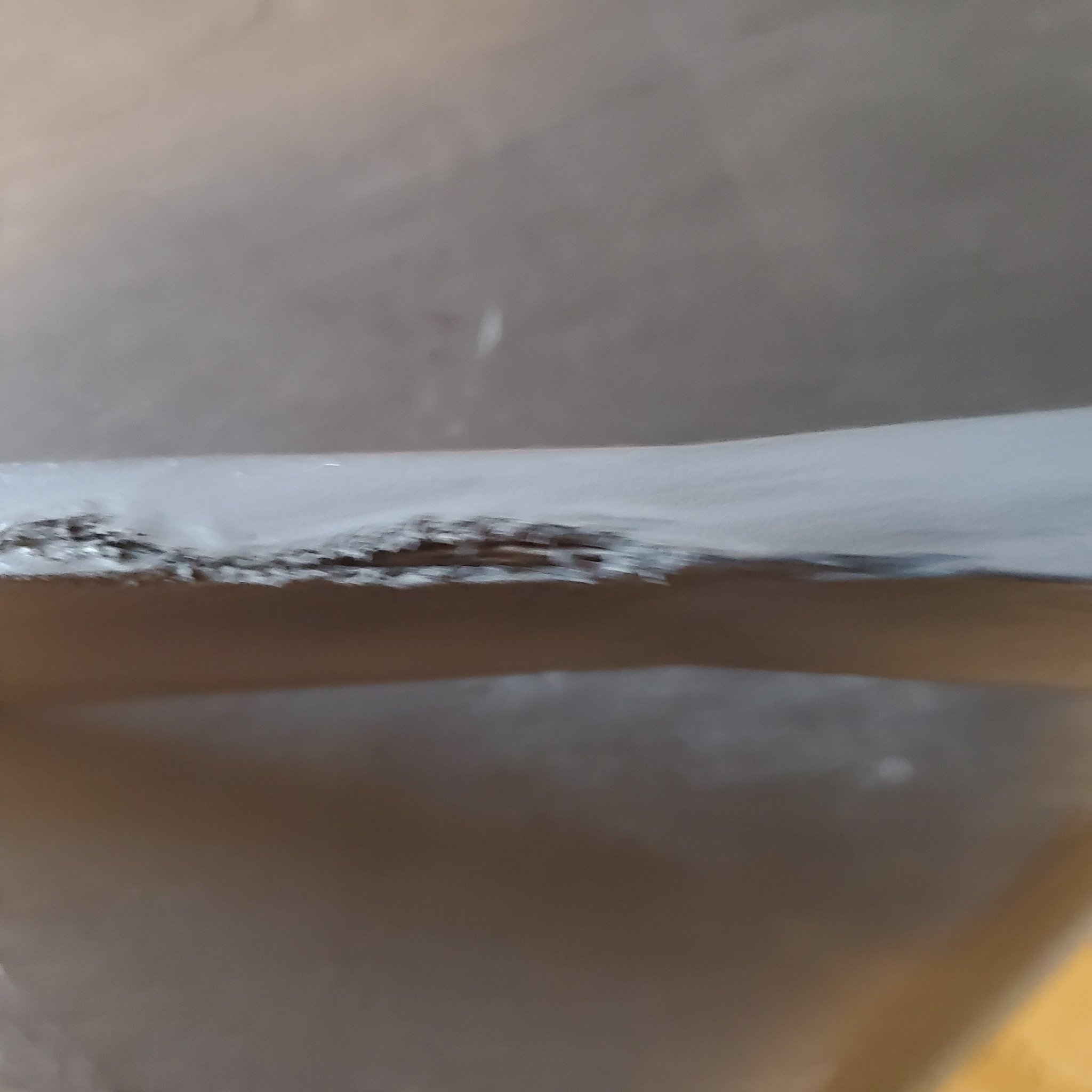

Here is my experience with the 3 twist following early reloading data... it took Faxon months to take down after many of us complained about it being dangerous.
Destroyed the muzzle brake, and magnetospeed bayonet, with their recommended load data.
The 6.5 twist does NOT have this problem, my 3 twist has been scrapped.

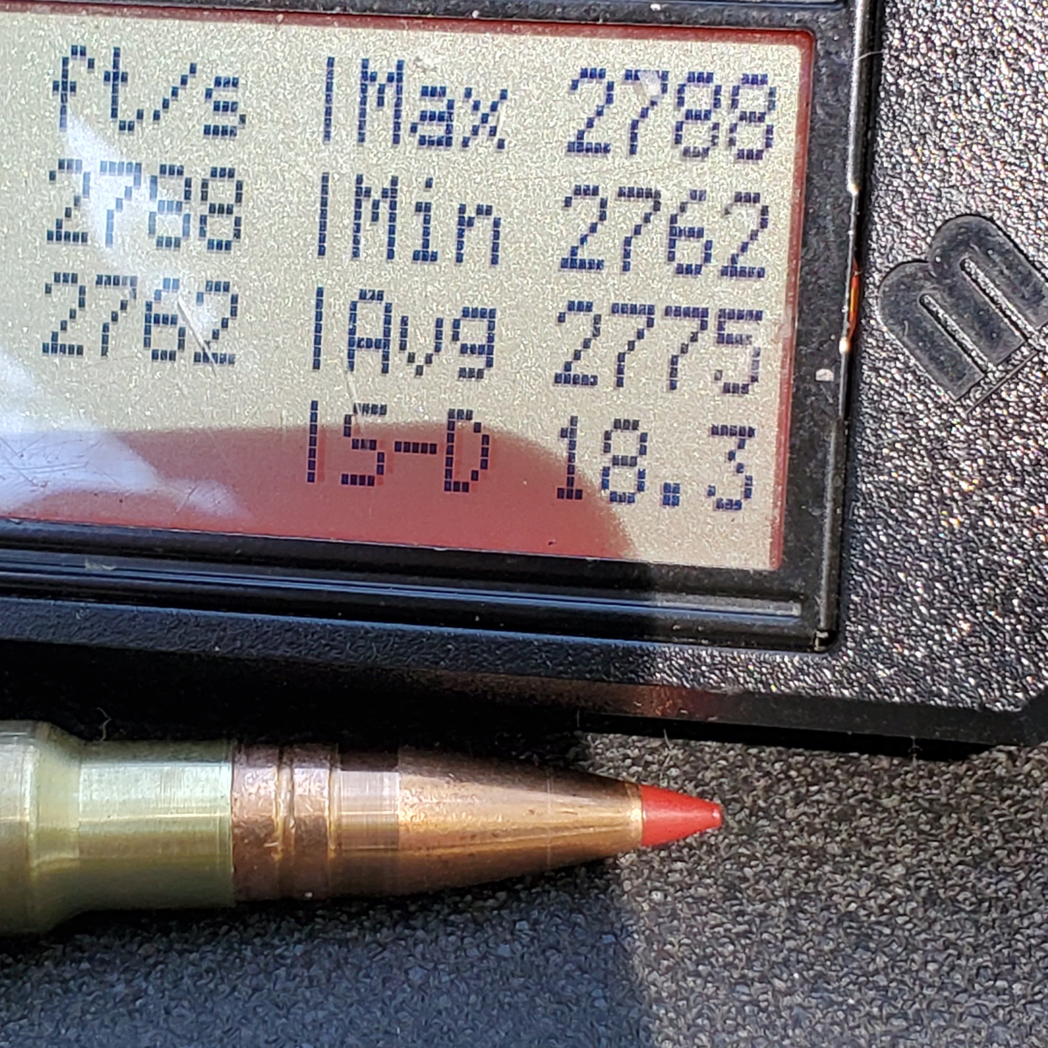

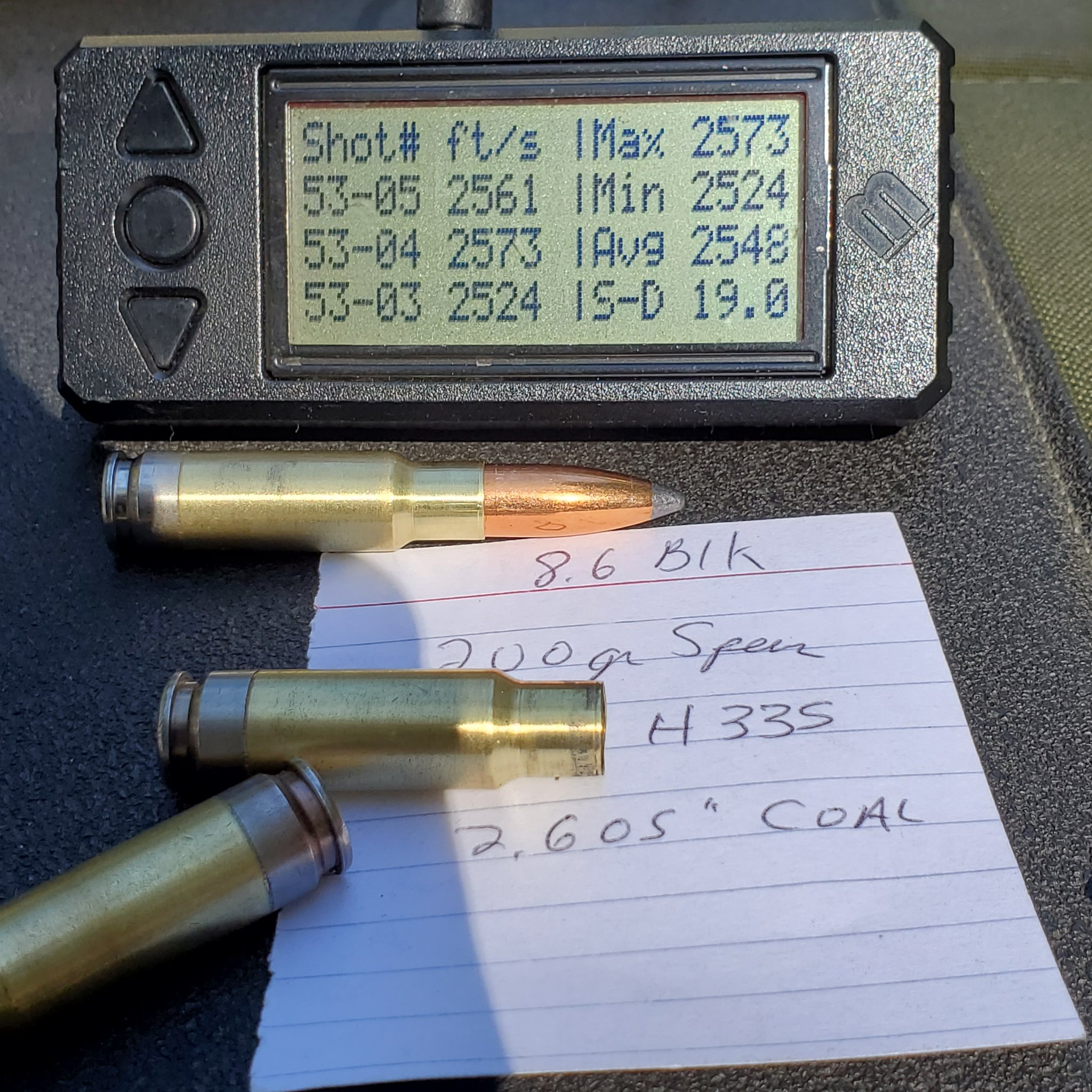

I have data on Barnes 160 gr supers to 350 gr Subs.
I recommend Alpha 8.6 Brass especially for bolts, in the 6.5 twist, for consistency and added velocity for that platform.
I use hybrid cases for my high performance loads, but Alpha brass will work well for those not interested in hybrid cases...mostly for bolts, autos take a bit of tuning. This has all been discussed in full.
Short barrels will not be able to attain these high velocities, but velocity and accuracy can be greatly improved with the 6.5 twist.
