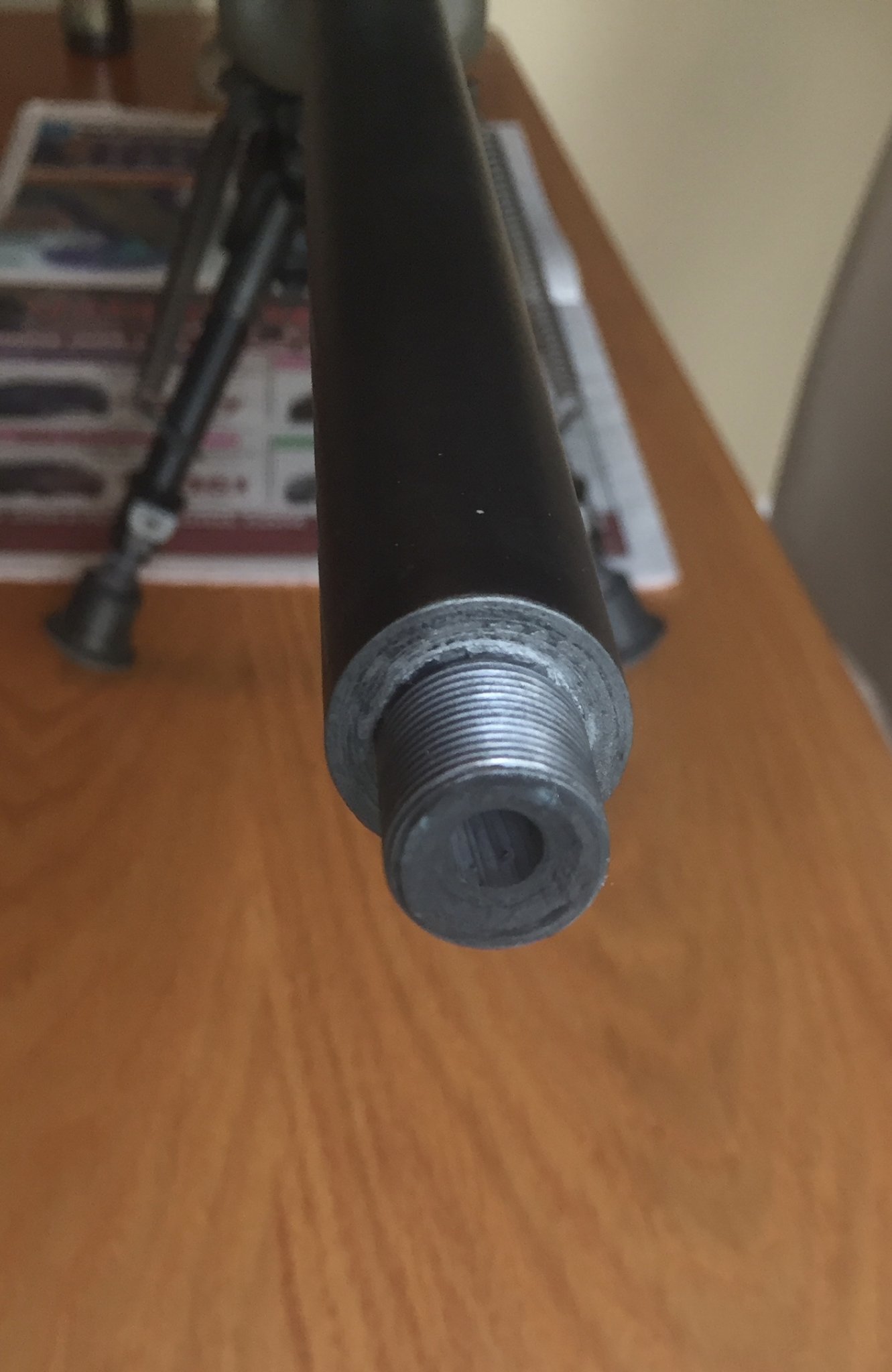

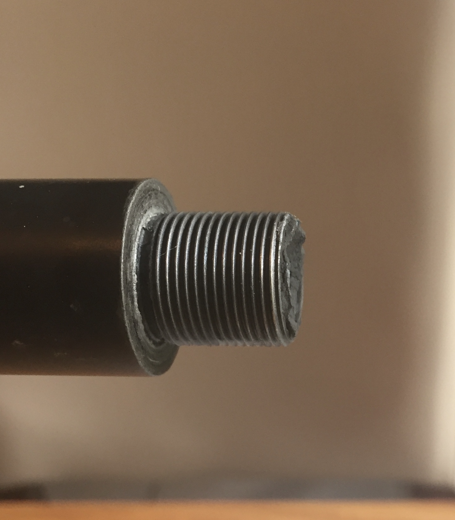

Any magical elixirs for removing carbon build up from muzzle?
