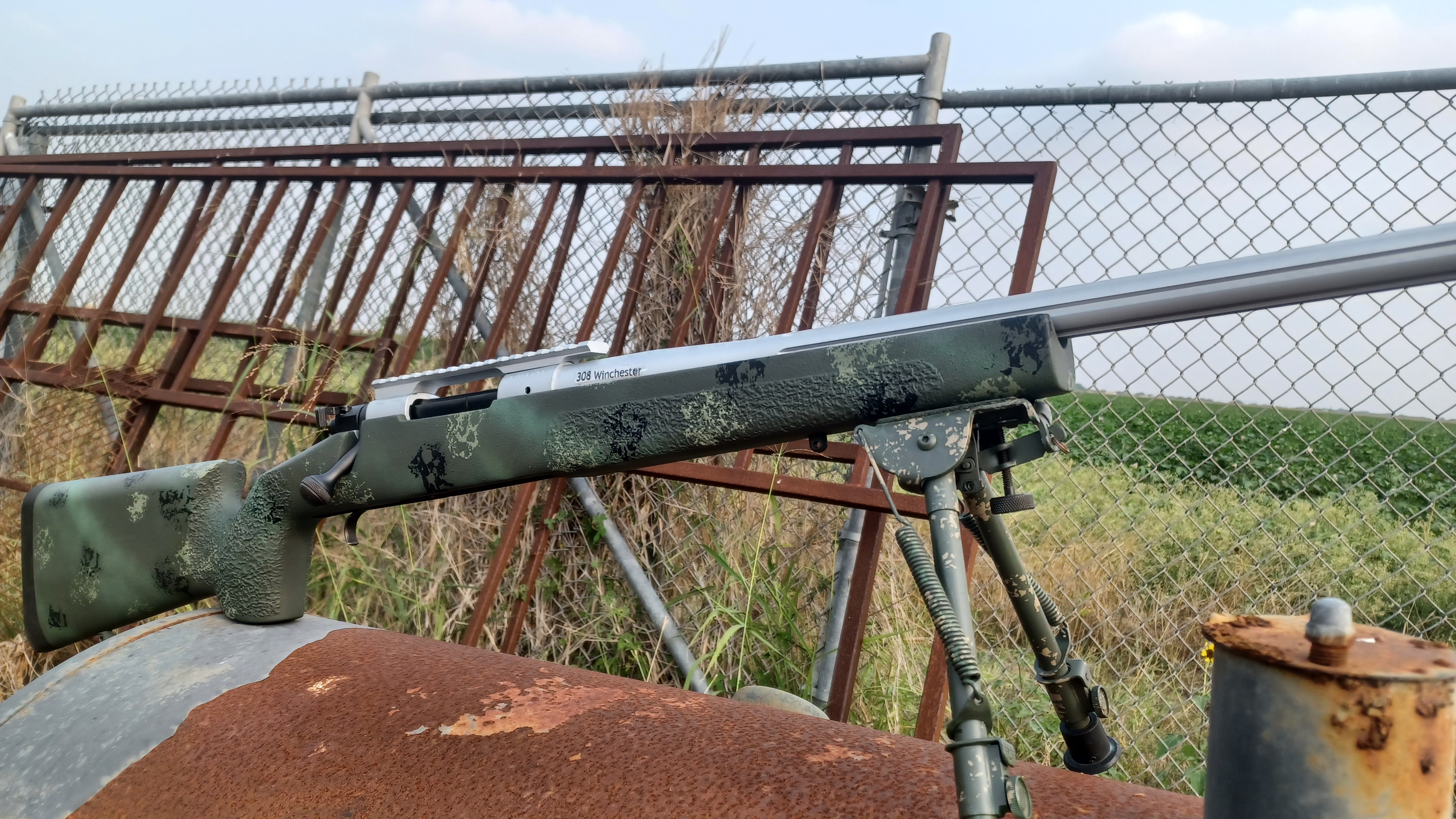

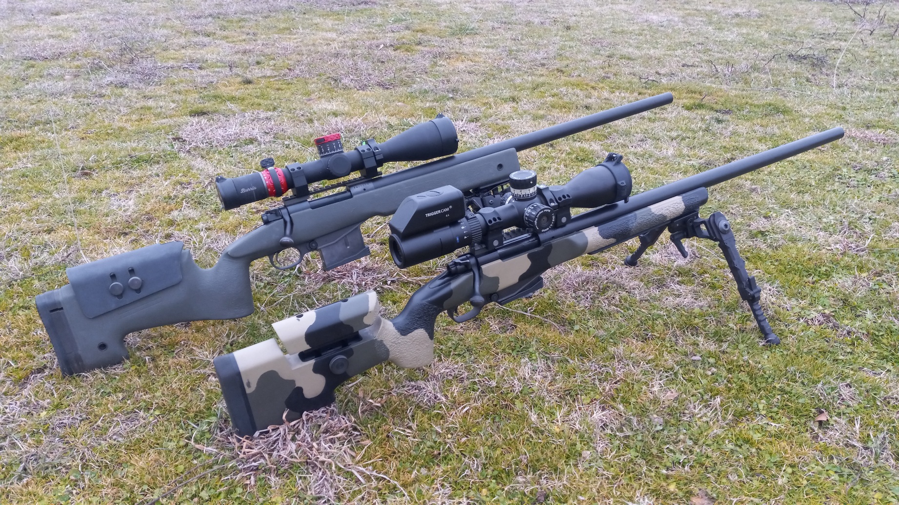

While not nearly as refined as LongRifles, here is mine.

Is this an spr a1? Consider it a good buy?
Not quite. Its a factory Winchester stealth, the differences are a 26" non chromed lined barrel with a freebore that is about .1 shorter than the 308 SPR I had, it doesn't have 8/40 screws for the scope base and last, it has a MOA trigger from the factory. All that said, it has about a 75fps advantage to my old SPR and while may SPR shot good groups this thing shoots like it wears a custom barrel... super tight. I was going to have it cut back until I started shooting it and saw it shot to good to mess with. I sold my SPR shortly after buying this and upgraded the stock to a SPR take off, bedded it in devcan and swapped a spring in the trigger for a nice 3 pound pull. Also added PT&G's AI AE DBM system that required no action work to install.

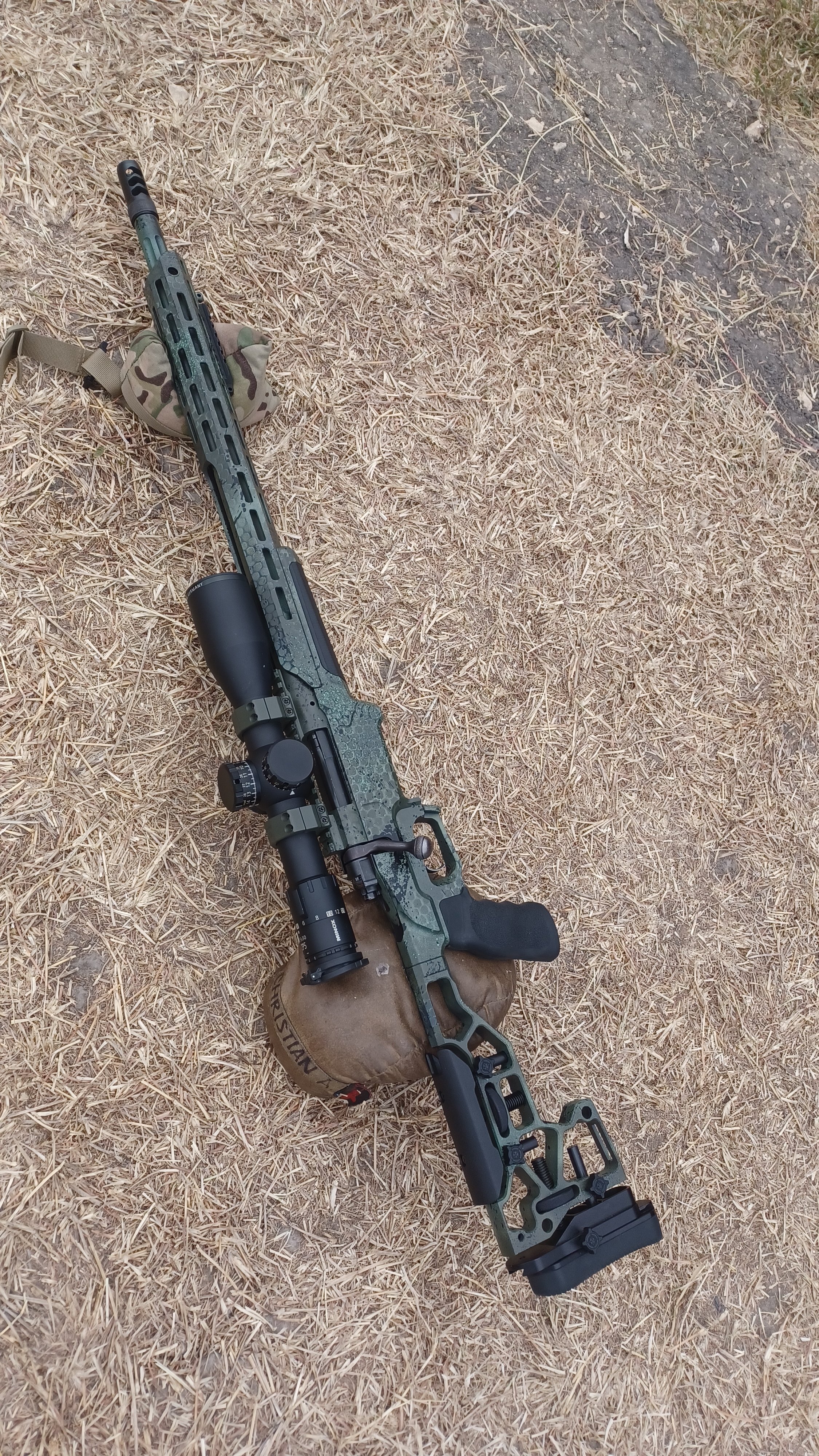

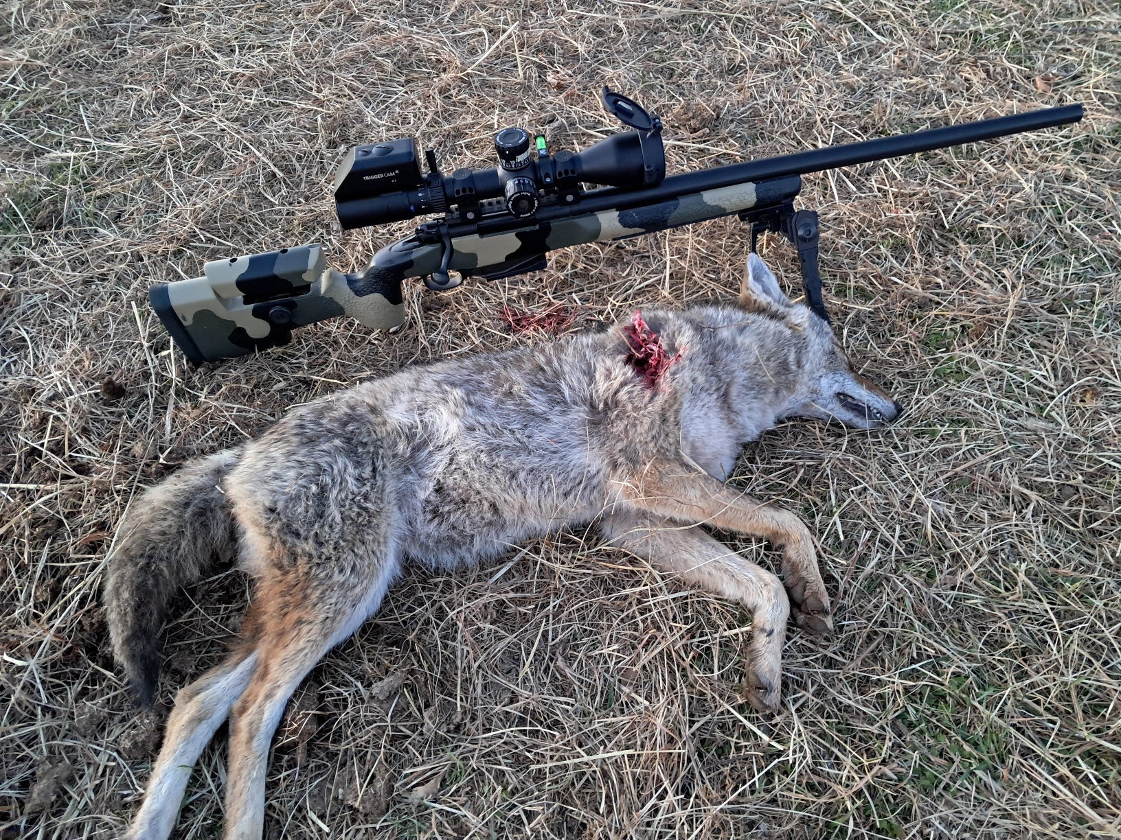

I've got a couple builds on the FN SPR action. I think that counts.
Sorry for the lack of decent photos, all the good ones are on my old phone.
6.5x47L. 26" Bartlein, McM A5, LRP S3. It does more than pretty good..
Dat key-otey woulda been deader wit a 700.

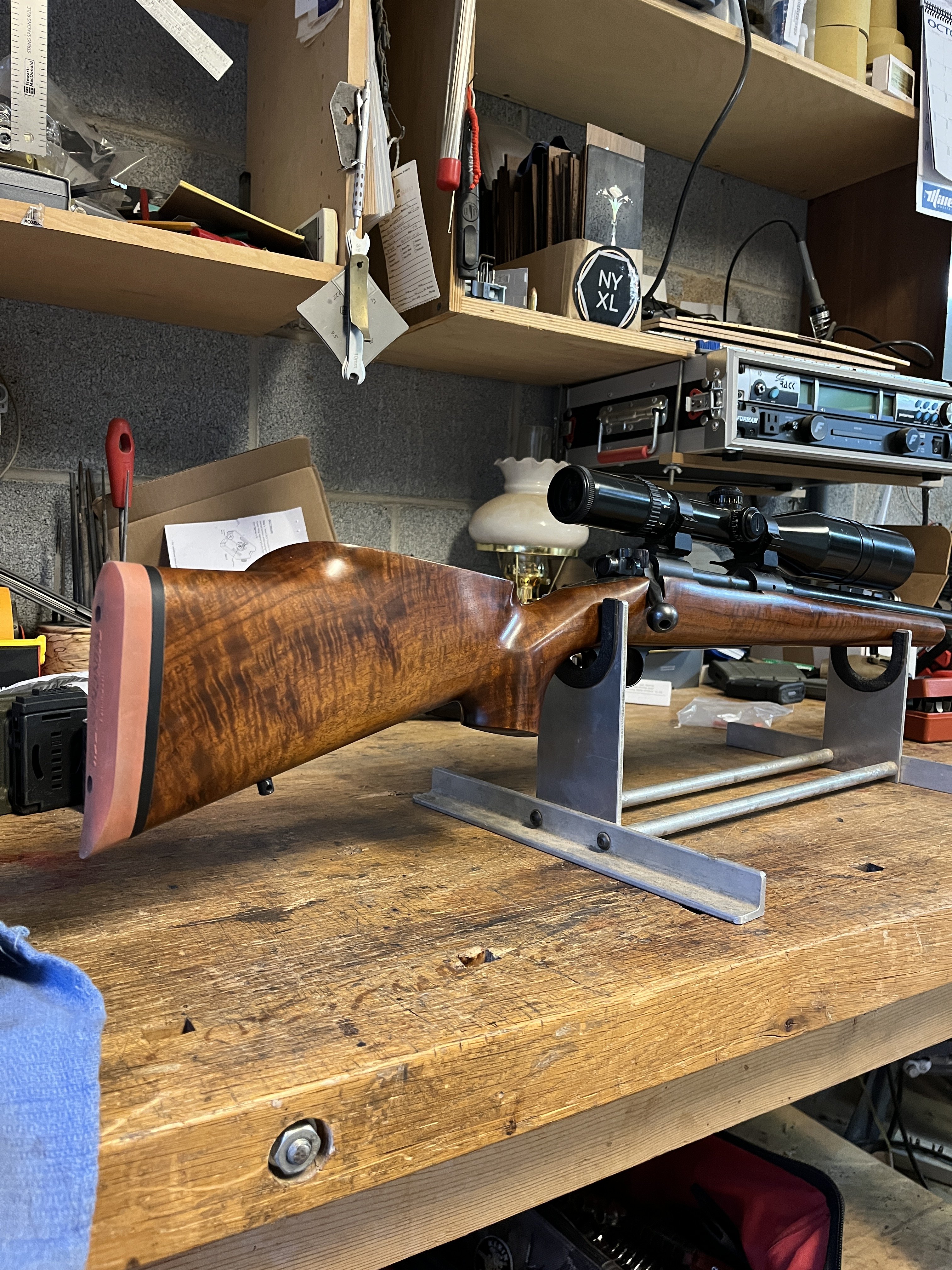

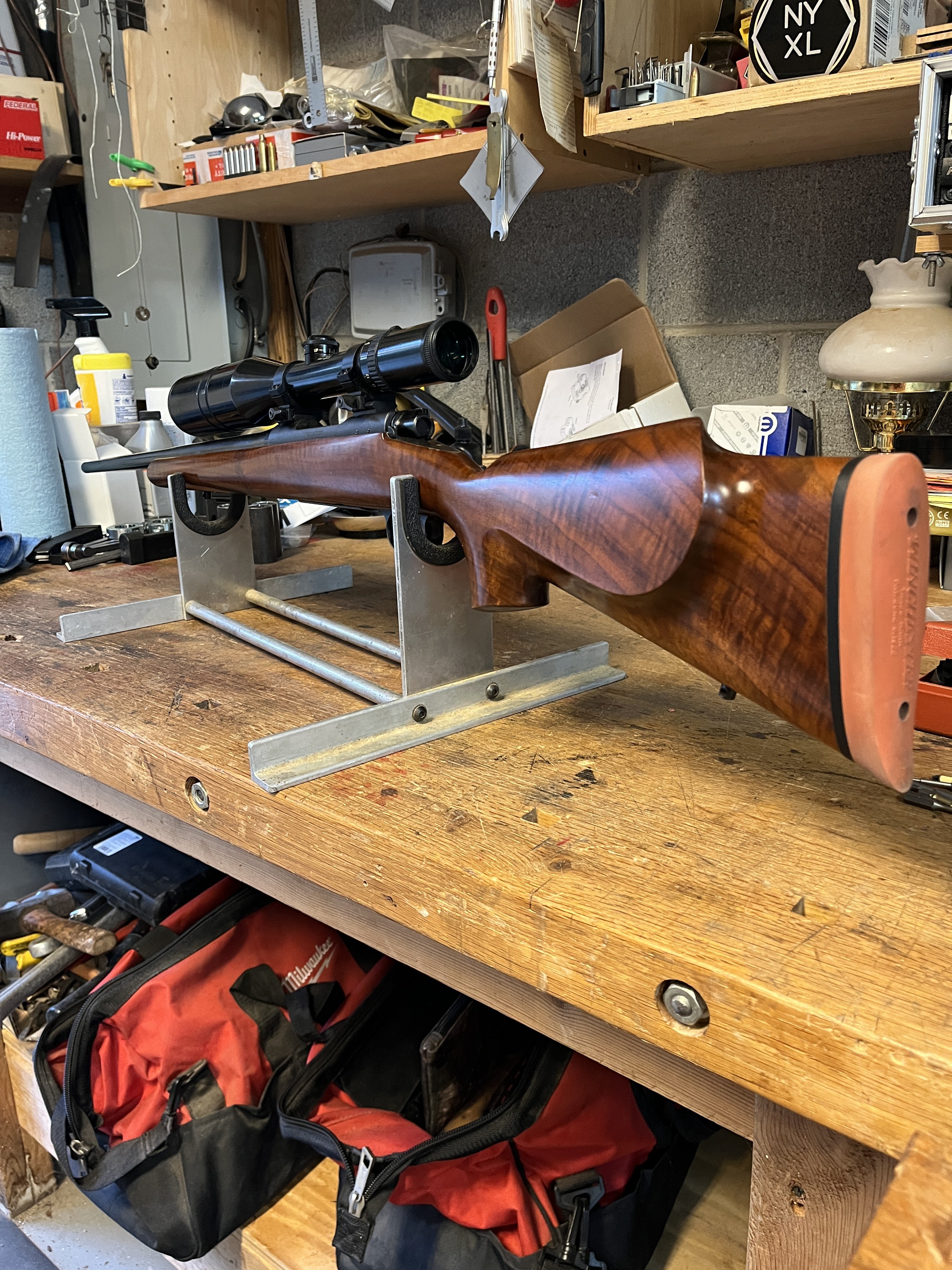

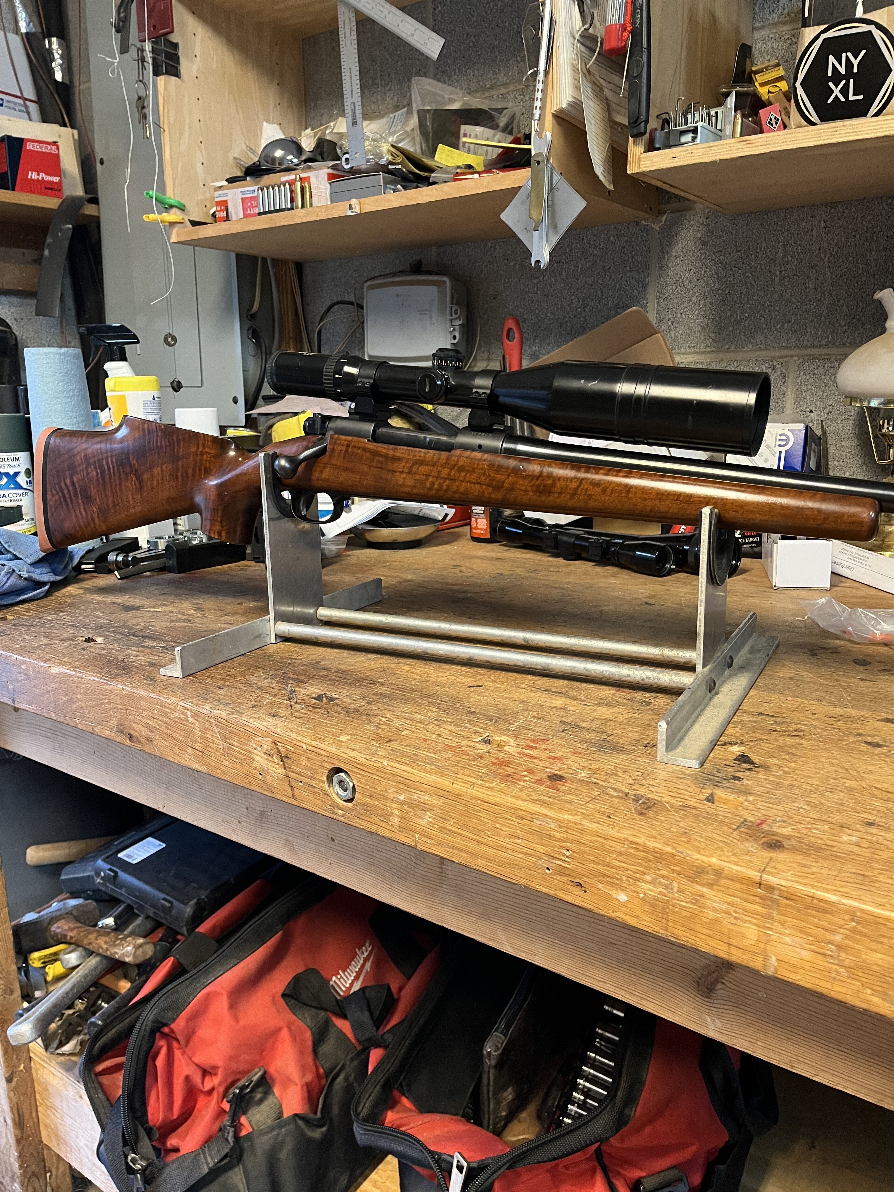

I’ve got a couple model 54s and a model 70. Haven’t kilt anything with them yet, except some paper

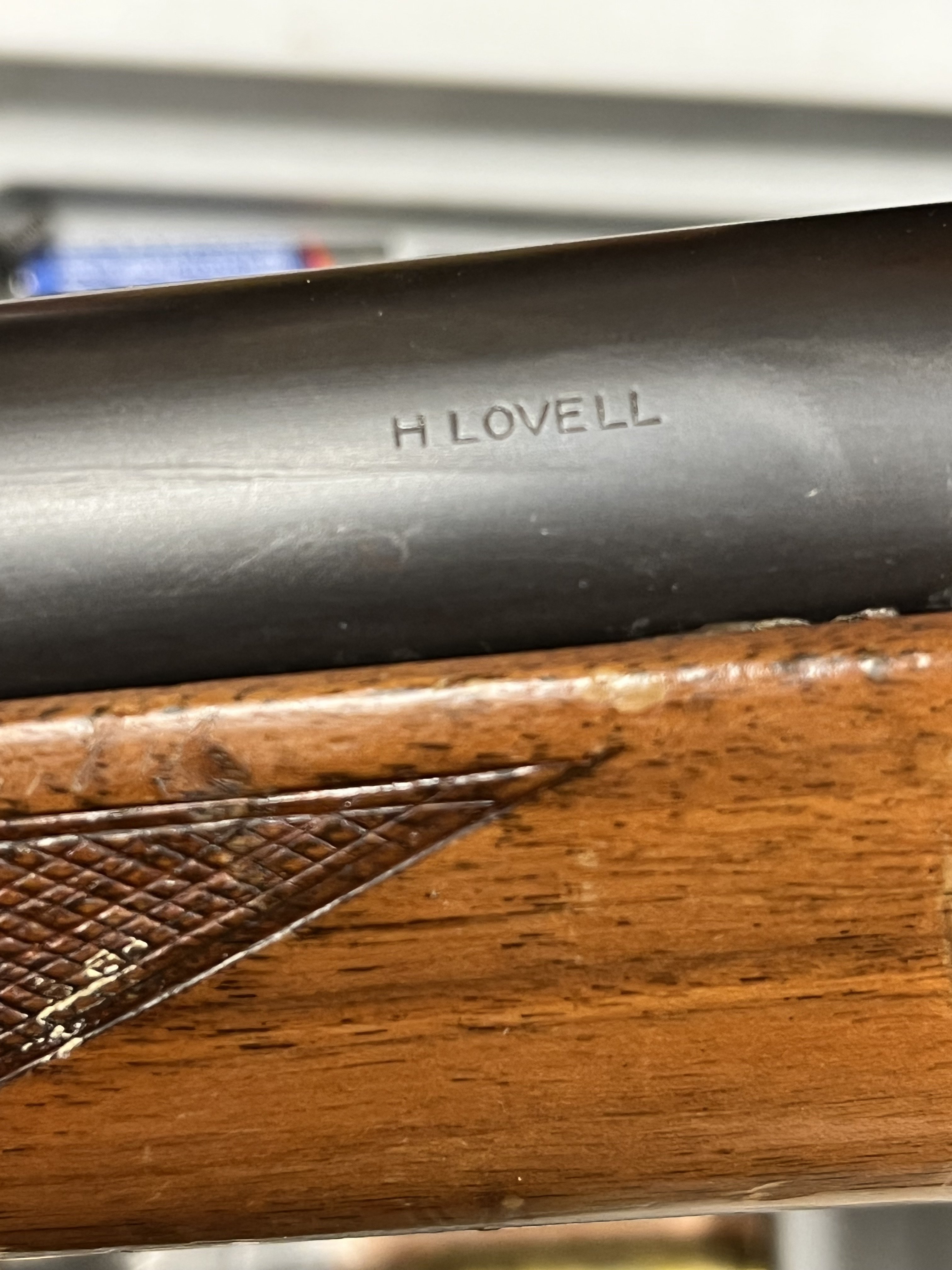

Model 54 built by Hervey Lovell, gun is a 1934 production I believe. Chambered in 22-250, and slings 55 grainers at around 3600fps still.

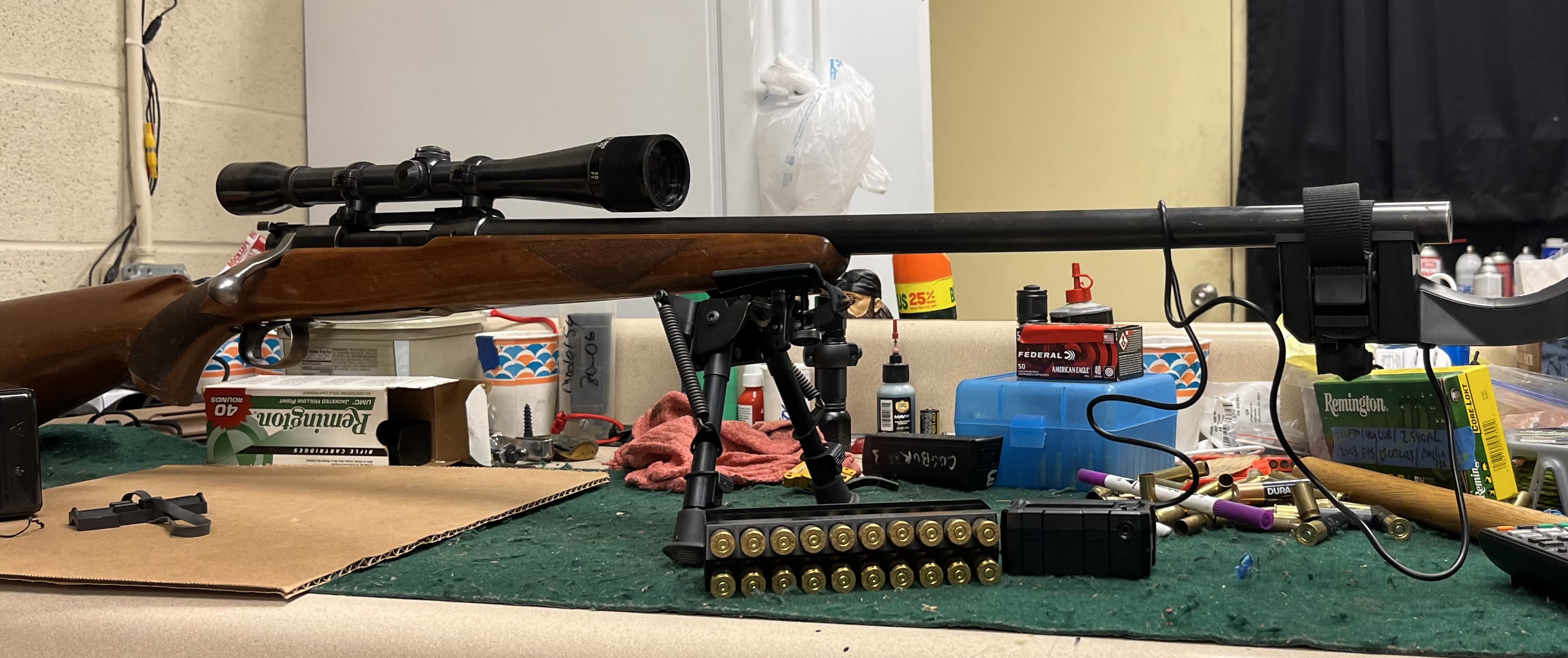

What side of the bed did you wake up on, I replied to this because I bought 2 supposed m70's at a gun show years ago that were M54's with M70 barrels screwed on and I recognized the foreword screw going through the recoil lug and the part of my reply about the trigger is because the m54 has a trigger very simular to a military mauser. nothing I wrote was designed to denigrate anybody or swell my ego, your is plenty for all of us, I don't have ay idea why replying to an old post has anything to do with this information and with your attitude in life I would suppose you have a lot of experience with old girl friends. better get back on your meds

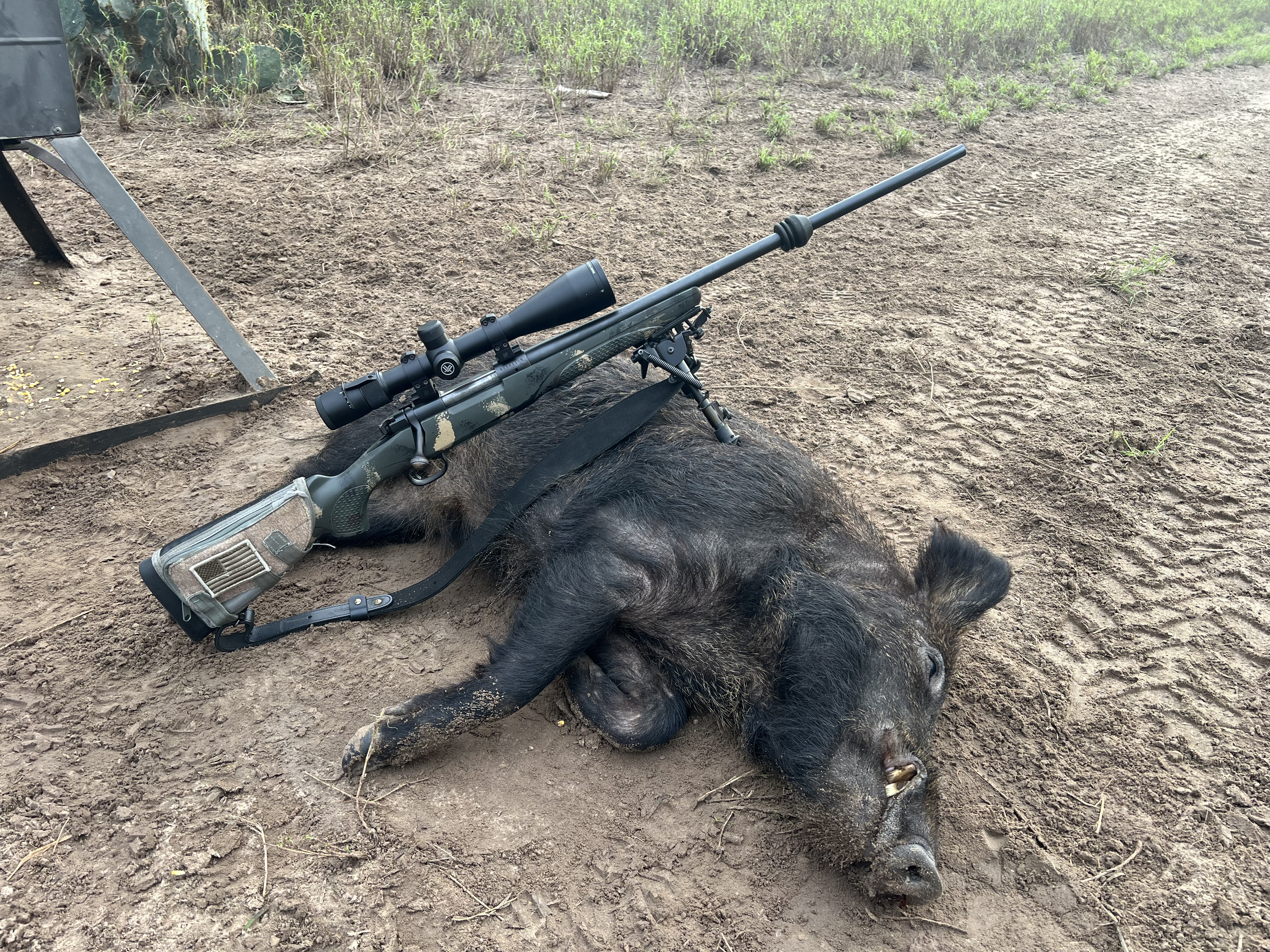

Here is my dad’s m70 in 270 wsm with a boar I killed this past deer season. Growing up this rifle went on every hunt with us and it never missed. He’s shot deer, pigs, aoudad, nilgai and elk with it. I liked the rifle so much I had to have a m70 of my own and bought one in 7mm wsm. Started off with a paint job on the factory stock but quickly escalated into a manners eh1 and now it’s currently at the smith getting a carbon barrel.

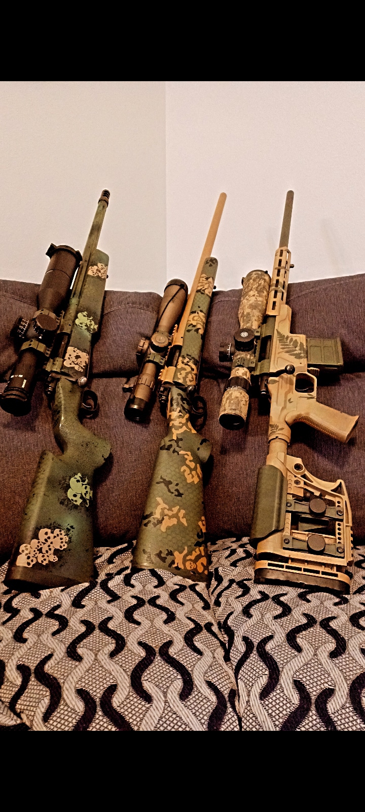

The one on the far right is not a m70 or SPR but it is a howa. The other two are m70/spr.

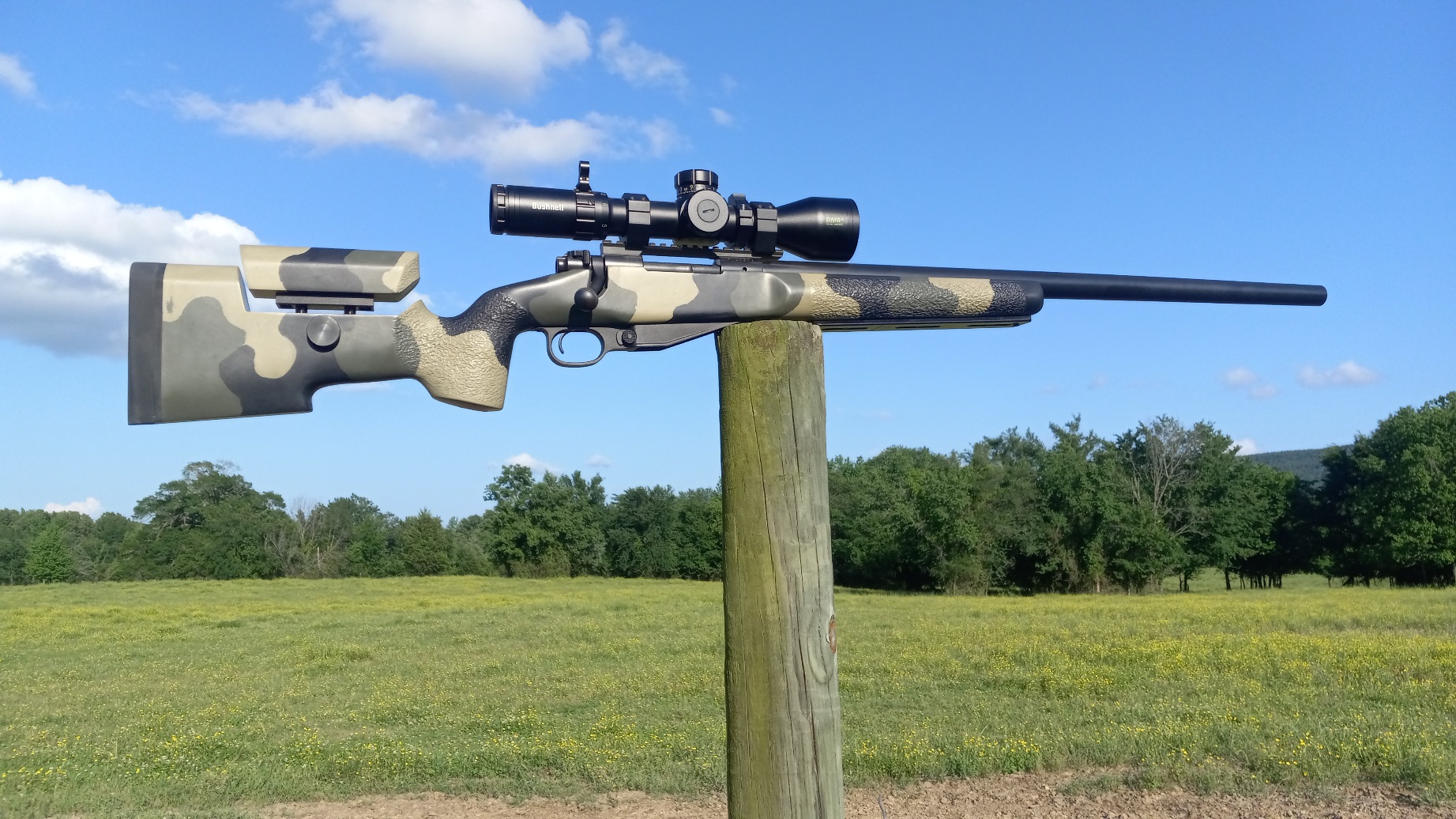

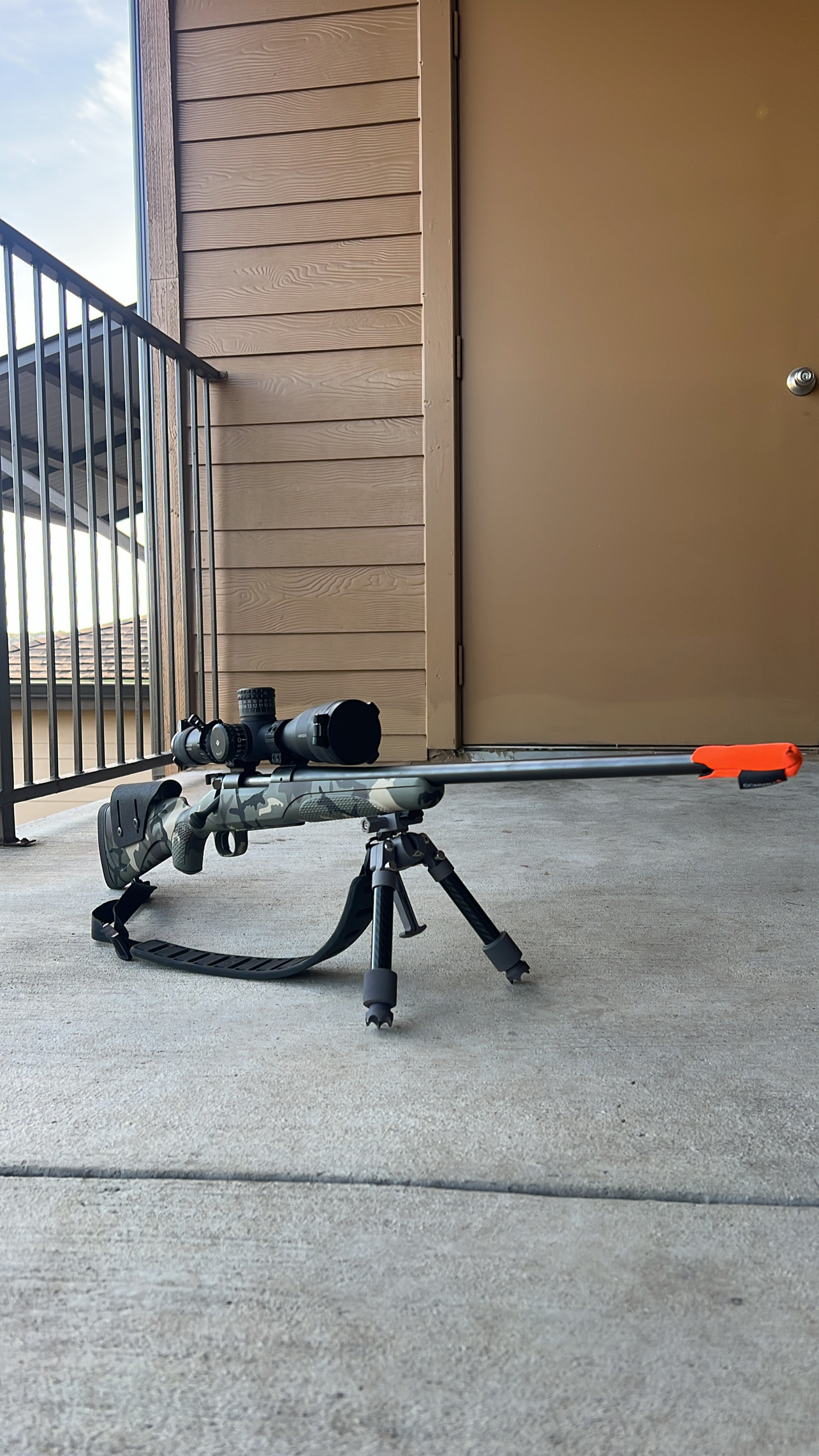

This one is not mine but it's an SPR from a member here

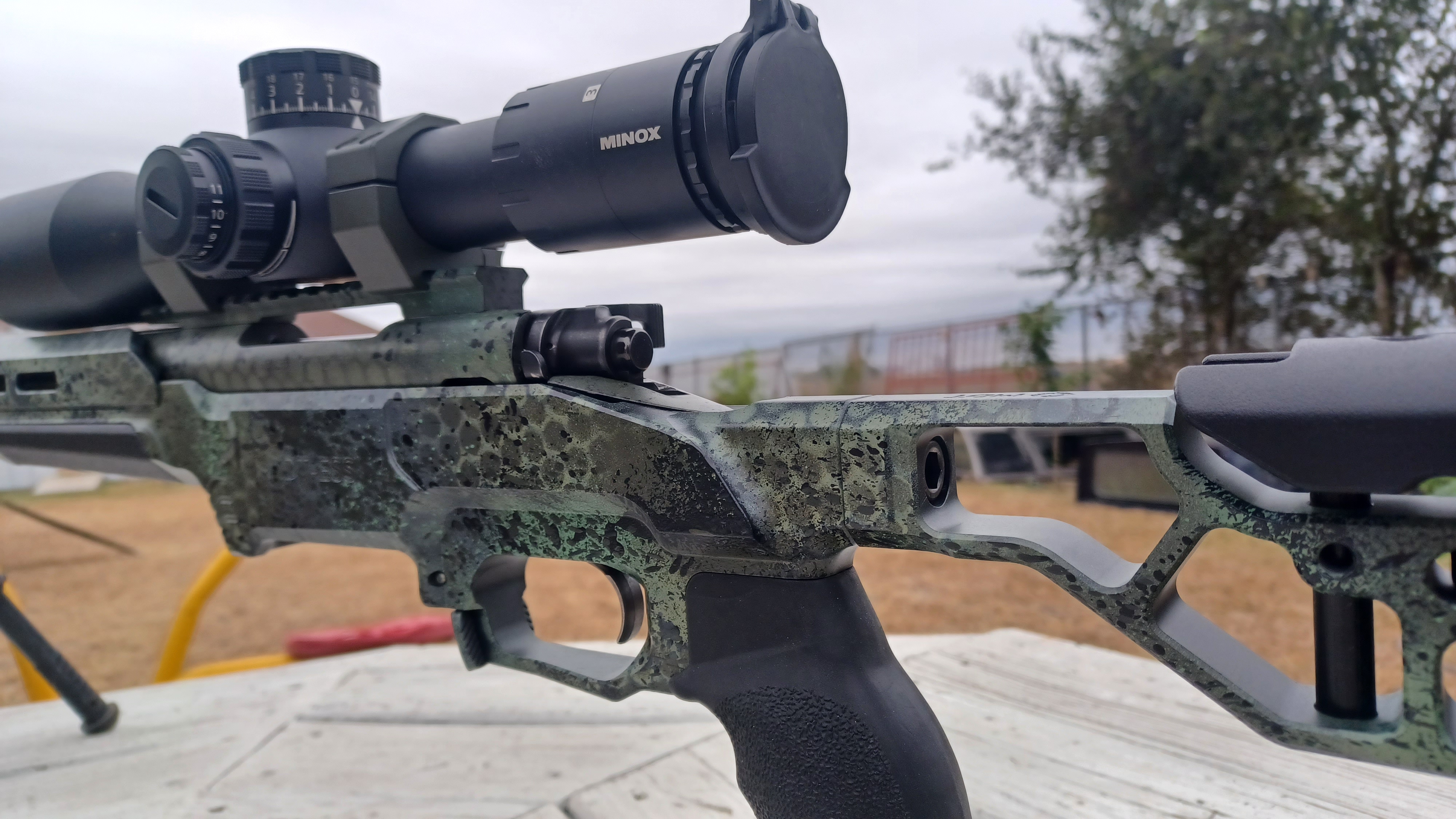

This is my same rifle from the chassis on the 1st pics

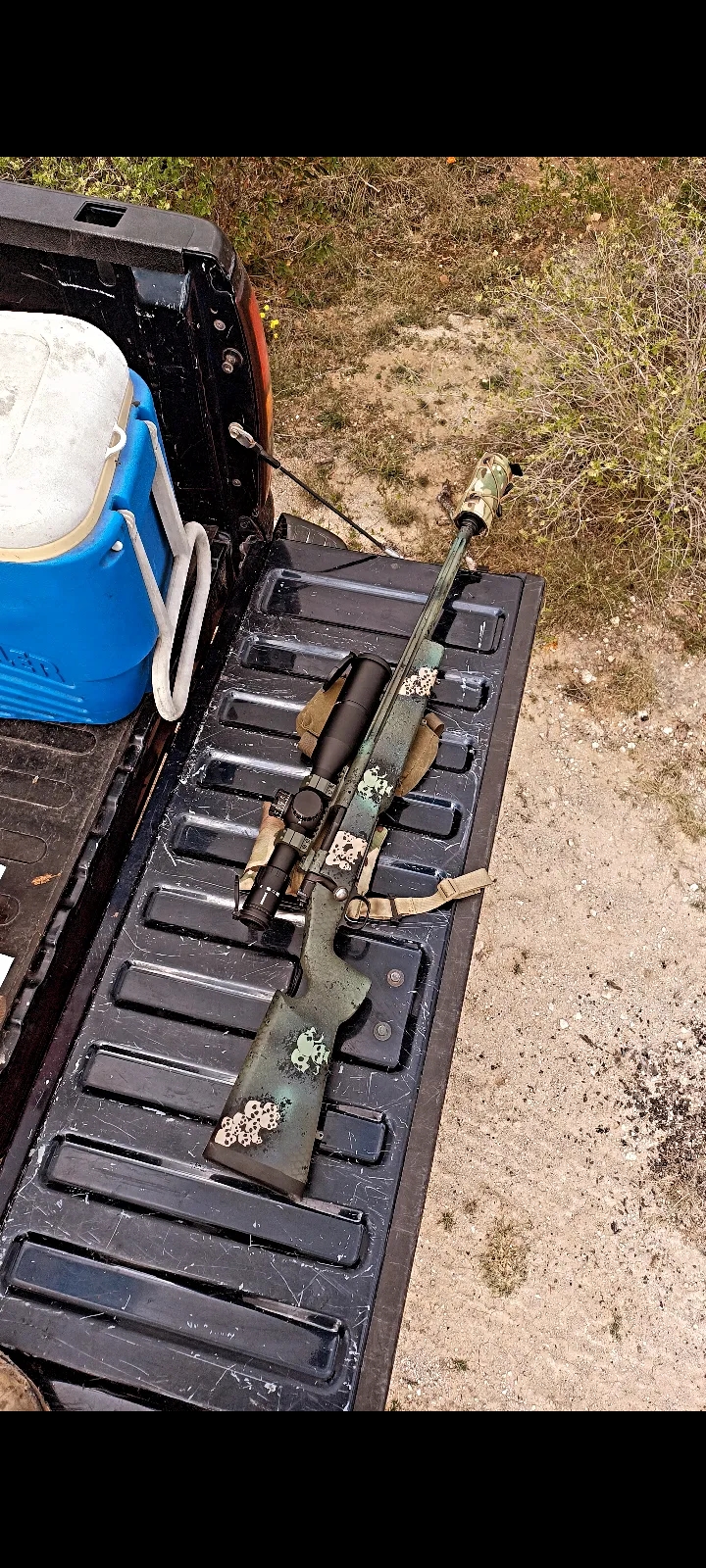

Another one of my SPR
