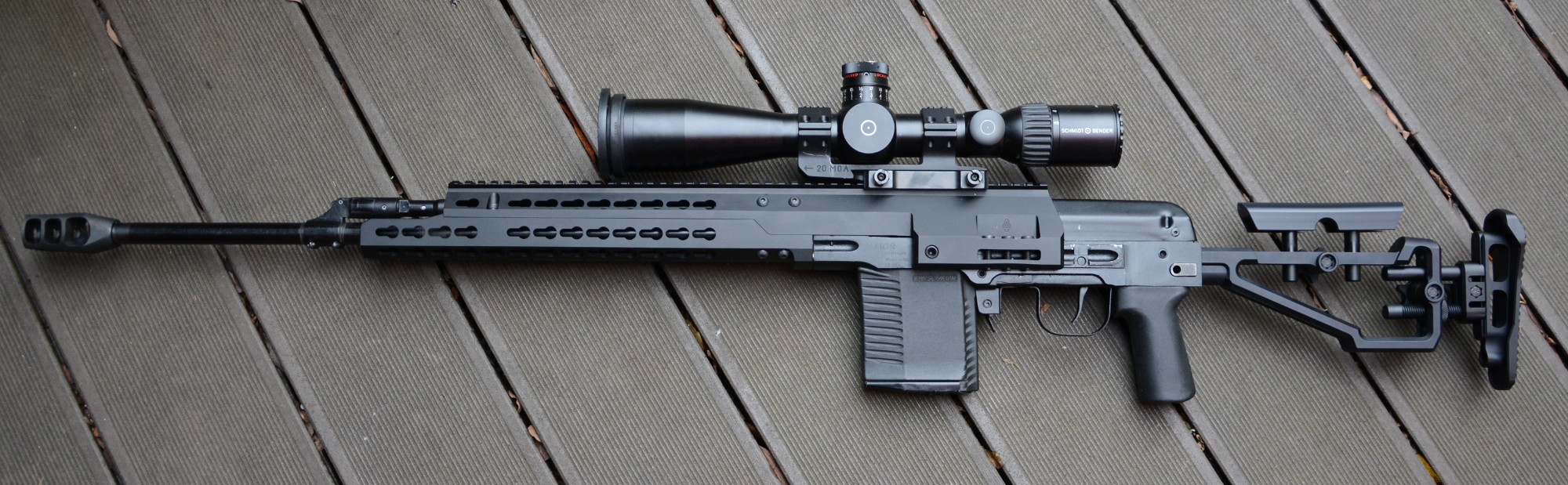

Recent (2014) SVD-S-like Tigr in .308
On the range, shootout vs. the other side of the curtain:
eiVAukeZdNSS0zGT-qhOaJGUMJIHyfWEdZAb7Oc9Kp05FeUkI3c1rAmG8MBJChppwYD9fsbCMHdvtkIxjtkvpAPXsecB4jWwNg-PZlxEPzqg82nTffUybLZ2W4uFqRBH

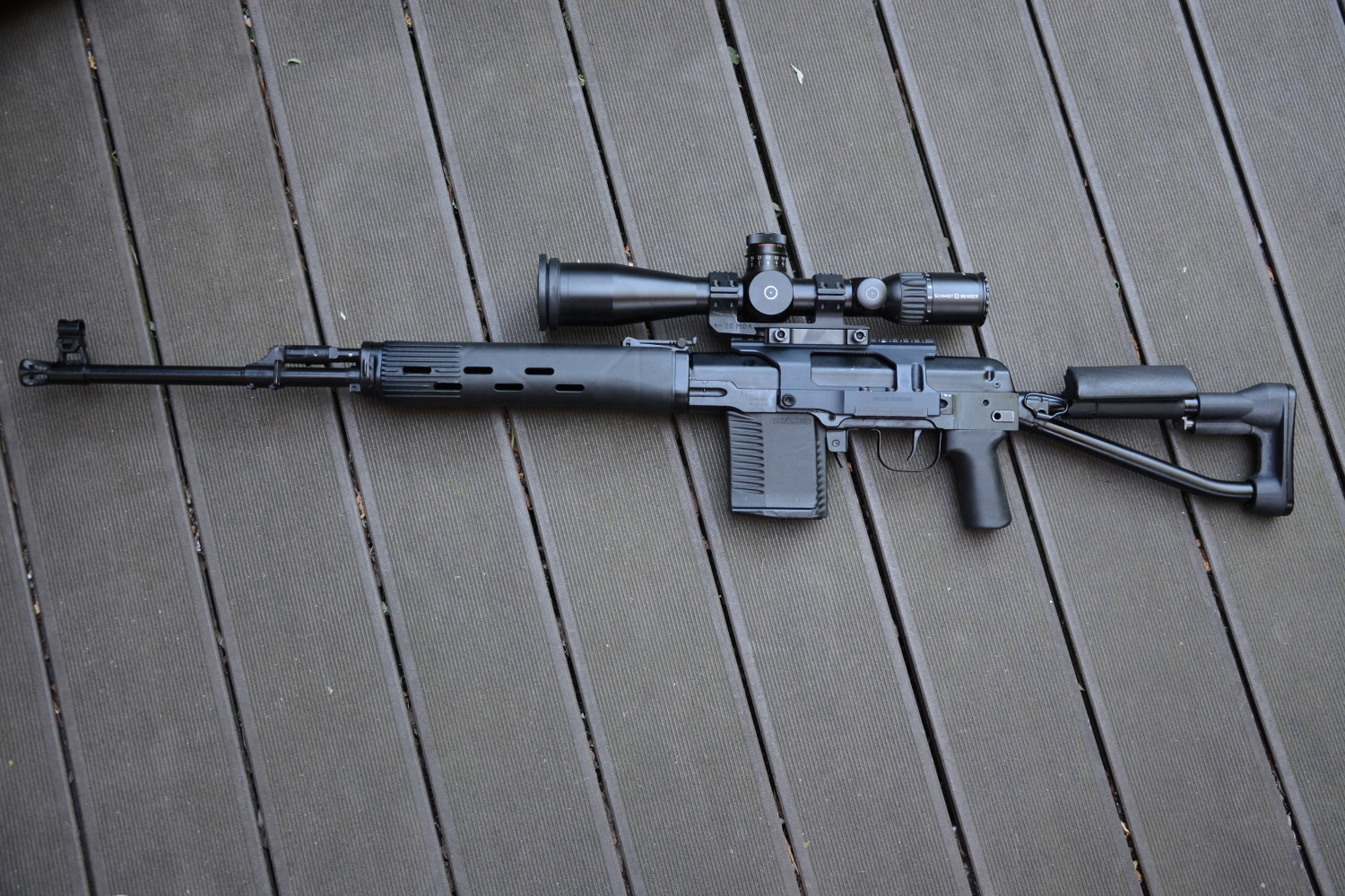

Original stock with SAG optics mount and a S&B PMII 3-20x (yes, I know, it's too much scope for this gun, but that was just to test accuracy):
Later config: SAG chassis + stock
In practice, it's a roughly 2-minute rifle, totally surpriseless, reliable and comfortable.

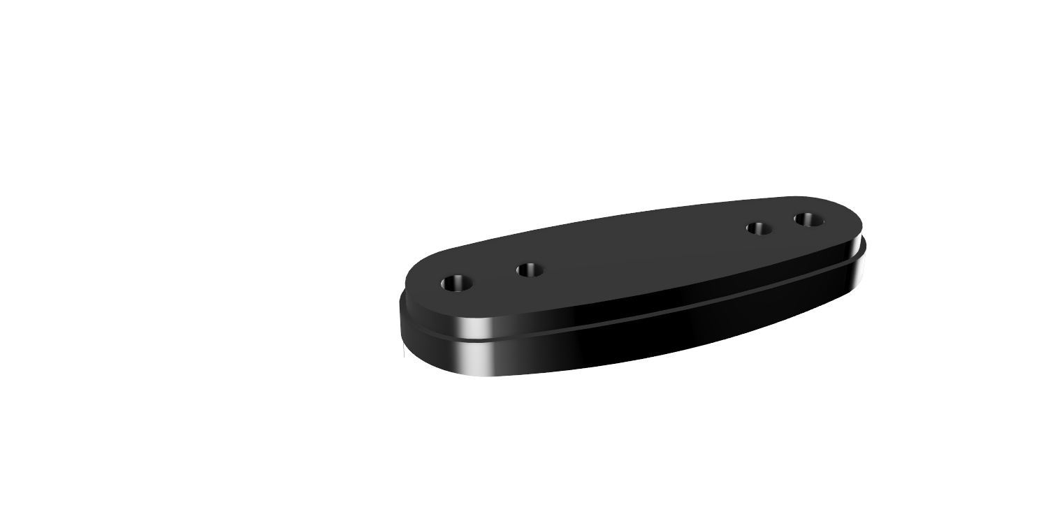

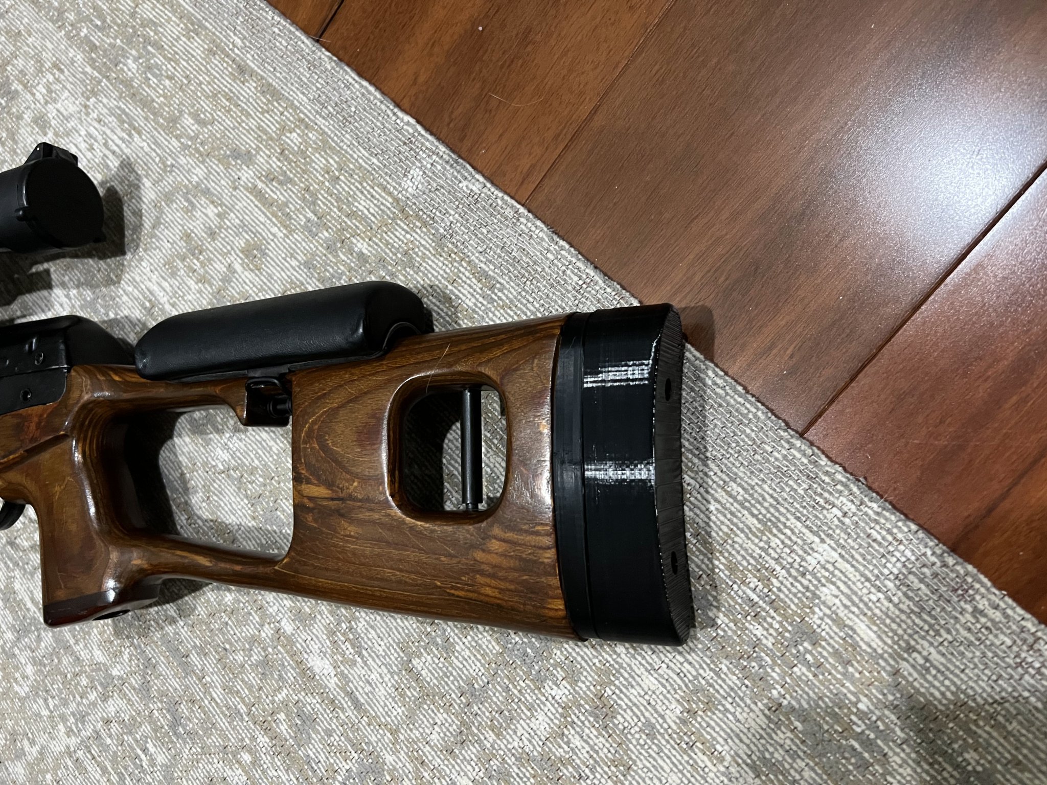

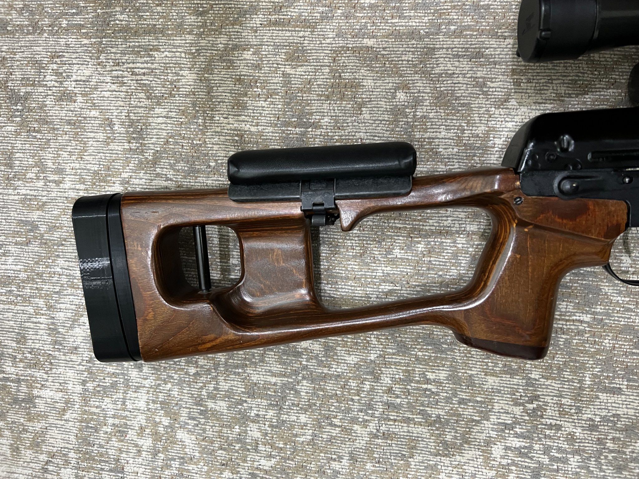

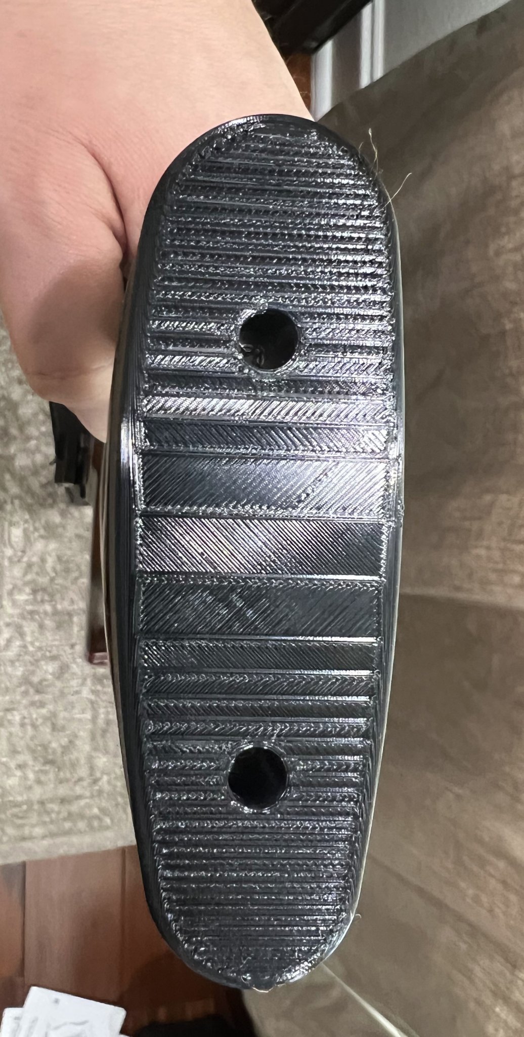

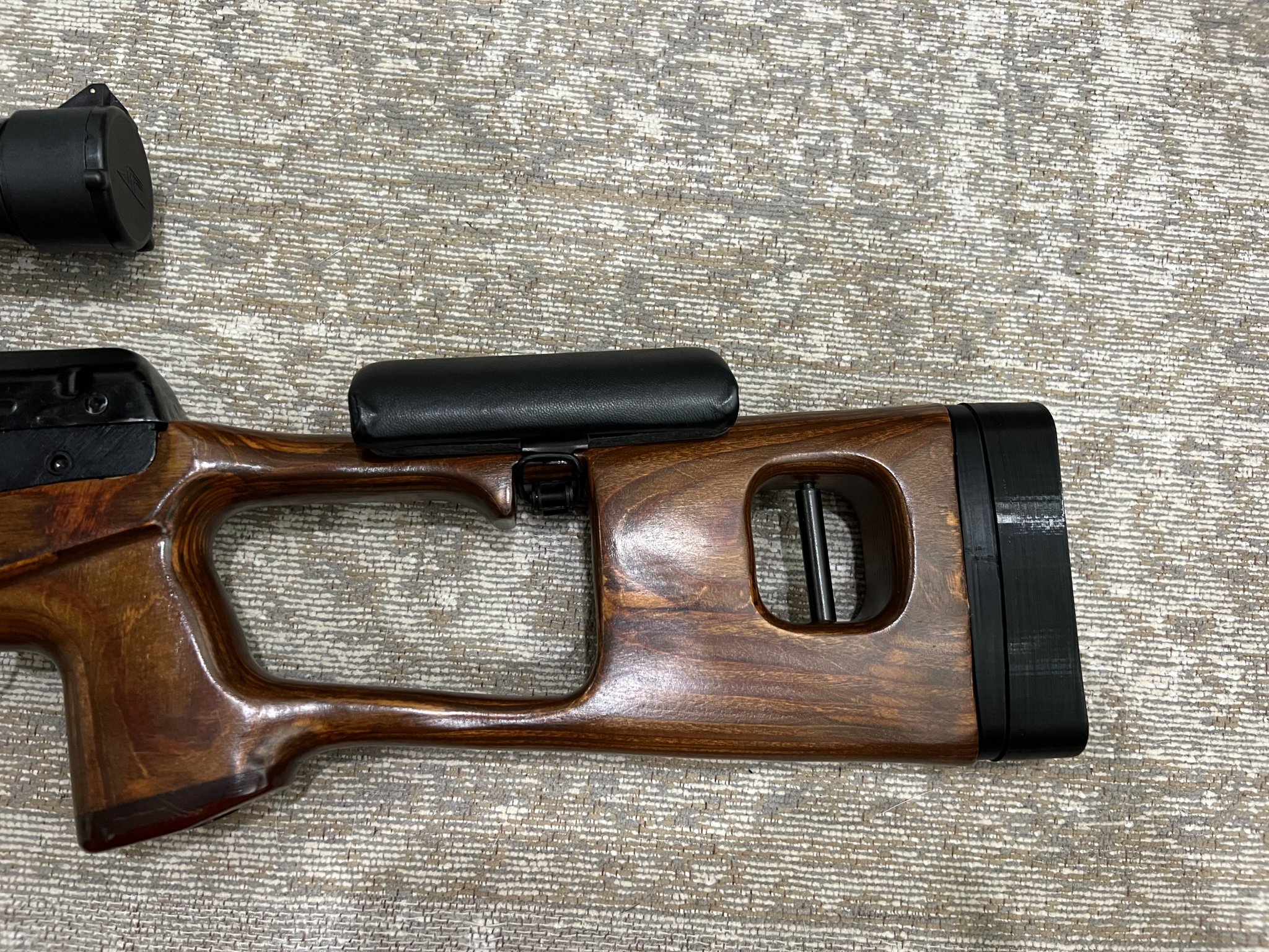

Testing the market if anyone is interested in a product. As many of you know SVD LOP is extremely short, and you need between 25 - 30mm of LOP to make both a good cheek weld for proper PSO/POSP scope alignment.
I have designed and started manufacture of a SVD compatible mount (2-piece) (28mm LOP addition), allowing you to reuse original screws and holes (i.e. completely reversible), while getting both an extended LOP and a semi-hard "rubber" buttpad.
It also provides for a solid mount, not a "rubber" extender many of you use today :)
[Please make sure you have the channel pictured in the wood photo, I have tested the product on 2 SVD stocks and it fit, however as you know, Russian manufacture is not exactly "precise" so minor fitting may be required.
The price will be $60 shipped, will need about 1 week lead time to ship if anyone wants one.
I wouldn't need that, as I swapped all my SVDs over to polymer stocks, but with all the new SVD owners thanks to the HD-18s coming in you might get some bites if you post over on the AK Forum and AK Files.

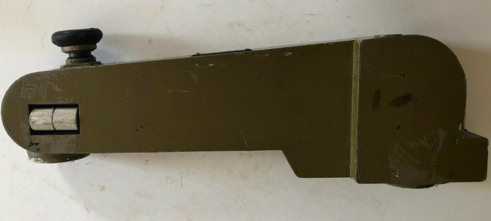

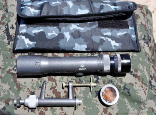

Do you have any pics of the portable Soviet Coincidence RangeFinders?
Spotting scope, with a dual mil/ SVD rangefinder (quite small/compact really) 4-20x
And the rangefinder with about ~1ft long baseline. Not the most compact thing, but well, neither was the GVS5, and this is far lighter.
Reactions: LRRPF52

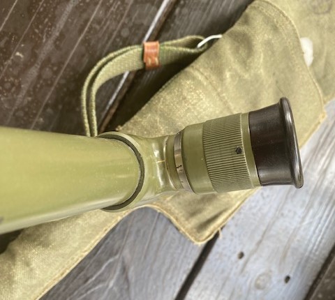

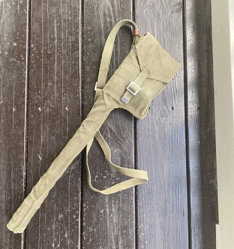

"Do you have any "through the scope" pics from that? I've only ever handled the PSO-based spotting scope, never any of the Soviet-era range finding contraptions."

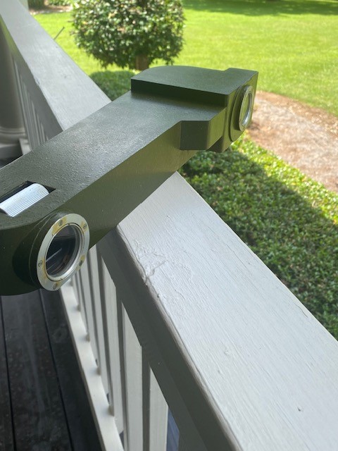

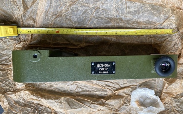

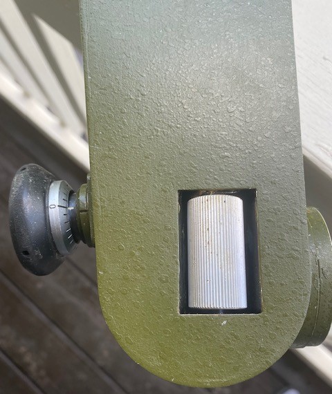

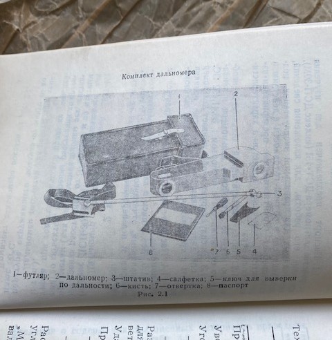

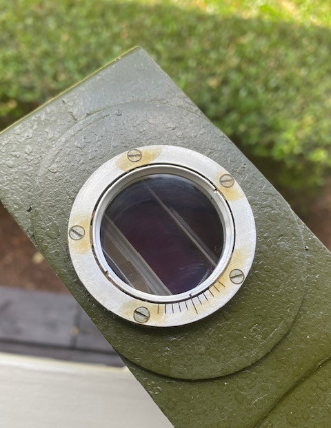

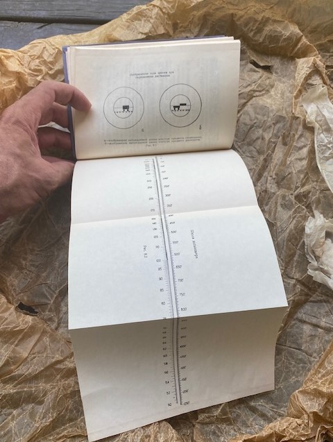

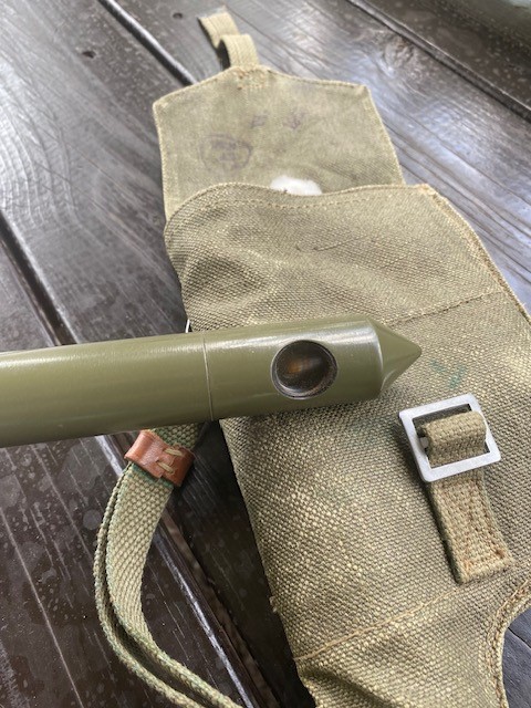

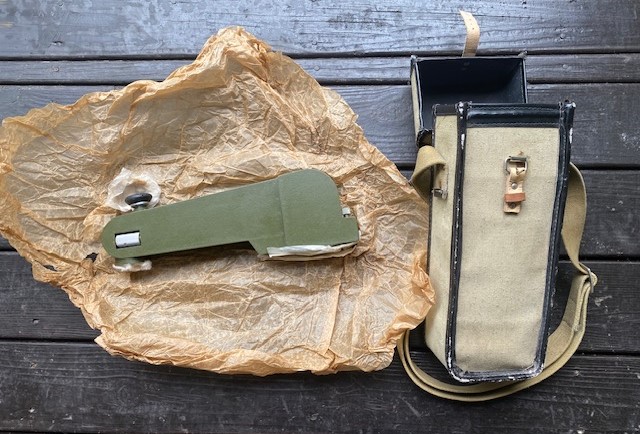

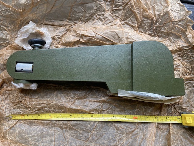

For a little follow up on this piece on a beautiful Memorial Day weekend. In honor of those he gave the most for this country!
The telephone pole in the distance is approx 120 yards from my front porch.

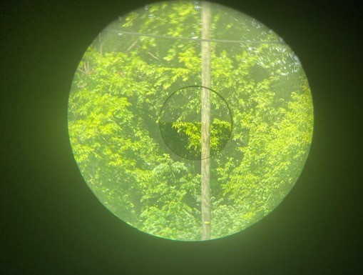

This was the best i could get with my feeble photography skills but you can see the circle but what is hard to see is that circle is bisected whereby the lower section can be focused in and out by the roller on the side for gross adjustment until you get the item in the view to "match up" with the top half of the view.

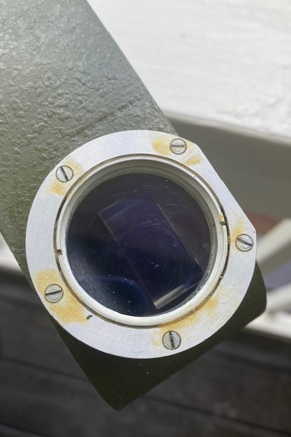

The fine adjustment is done with they eye piece where you can see the calibration. This also came with the booklet, which I have not translated but would be cool to do that one day. That booklet goes into the details of some of the other "kit' that must have been issued at the time. One piece of this which did not come with the scope and the base is a belt and rod contractions that must be used to steady the range finder when being used.

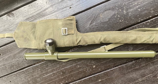

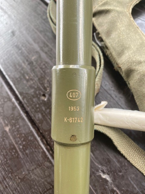

Here is another piece that I picked up a bit before the other one, before all the Ukrainian mess cooked off that is sniper related that some may enjoy,
These seem much handier.
Here is another feeble attempt at getting a shot of the view from the lense;
Same telephone pole and what you cant see is the stadia like a scope would have vertical and horizontal.
