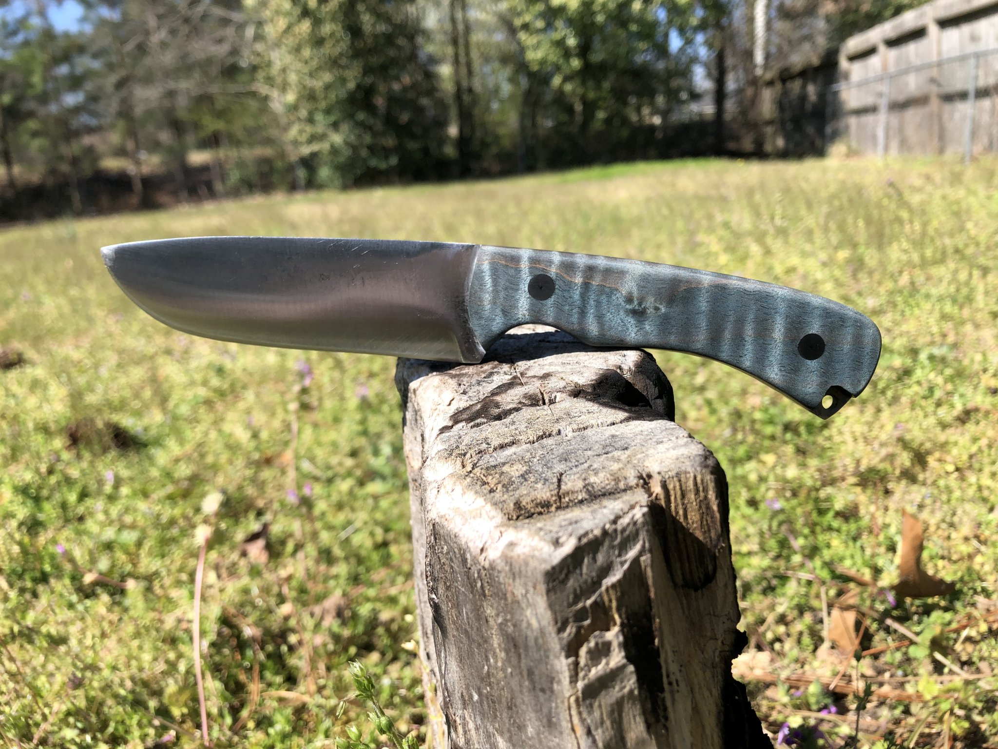

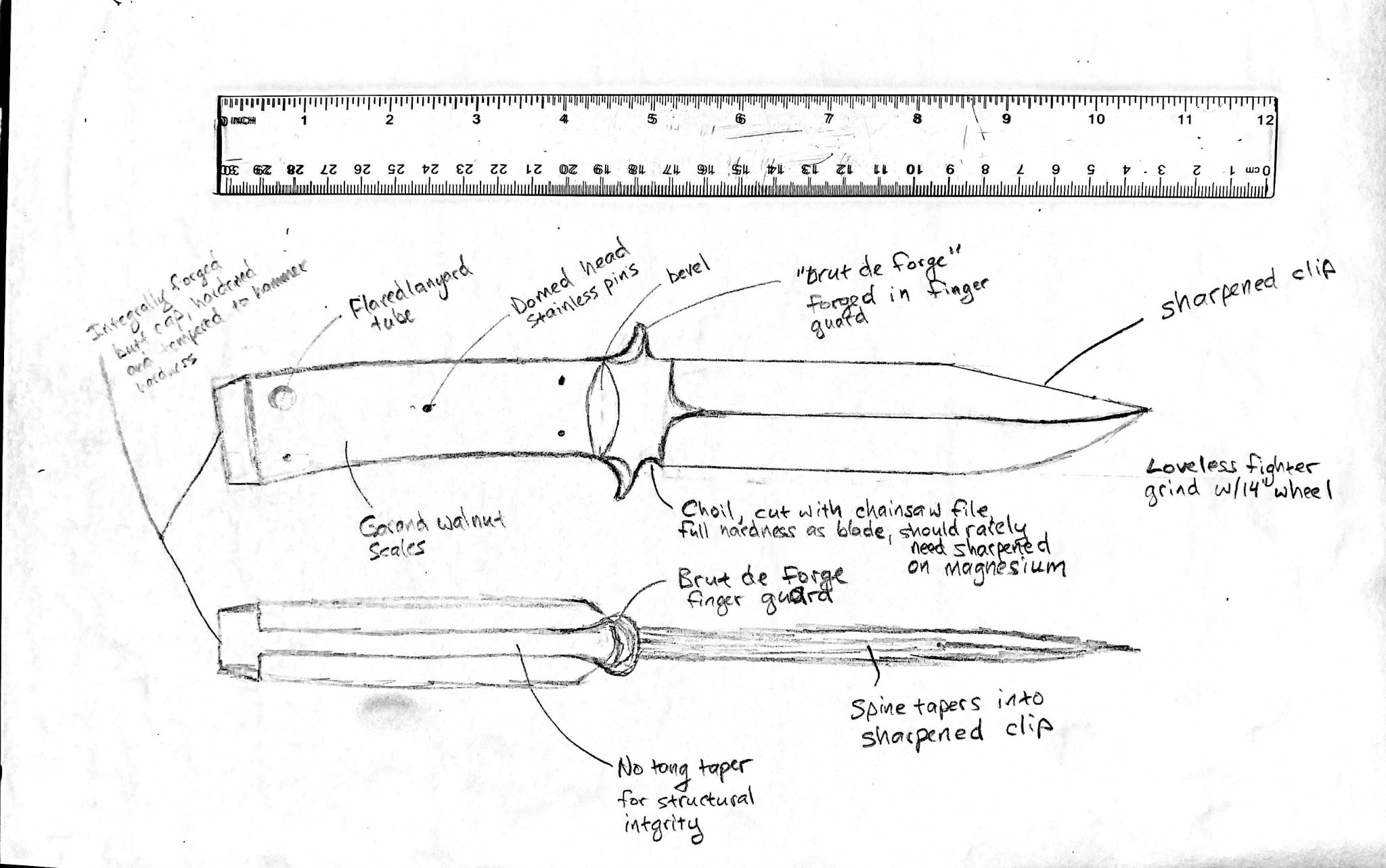

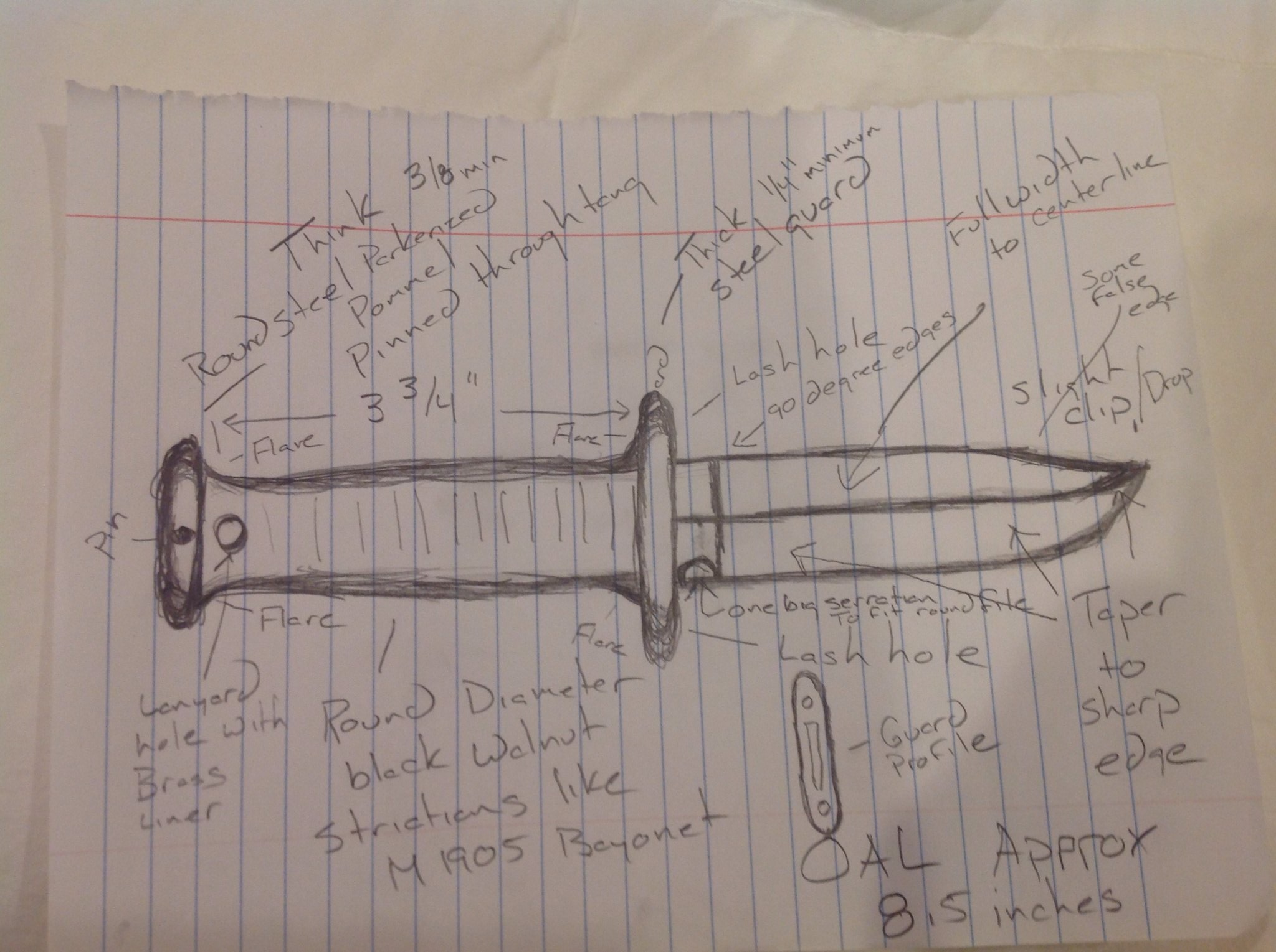

I like my knives to be pretty spartan, drop or working clip, a manageable size, pommel suitable for some light hammering, spine suitable for some battoning, 90 degree edges for striking a fire steel/fire starting.
The maker I was talking to had issues with some of my ideas, particularly the "hammering" of the pommel.
He took my ideas and came up with what would work with his skills/desires as a builder.
He came back with this....
My original sketch to compare...
If anything he added some bling to my spartan desires.
I liked it and we parted with an agreement if he built it Id buy it but than I never heard anymore so I kind of moved on. He builds really nice knives and I hope he is finding success. Who knows I may get contact one of these days stating "Hey your knife is done, pay me $X and Ill send it".
Just an interesting side note on how when it comes to knives the user/builder really have to be in unison on their ideas.

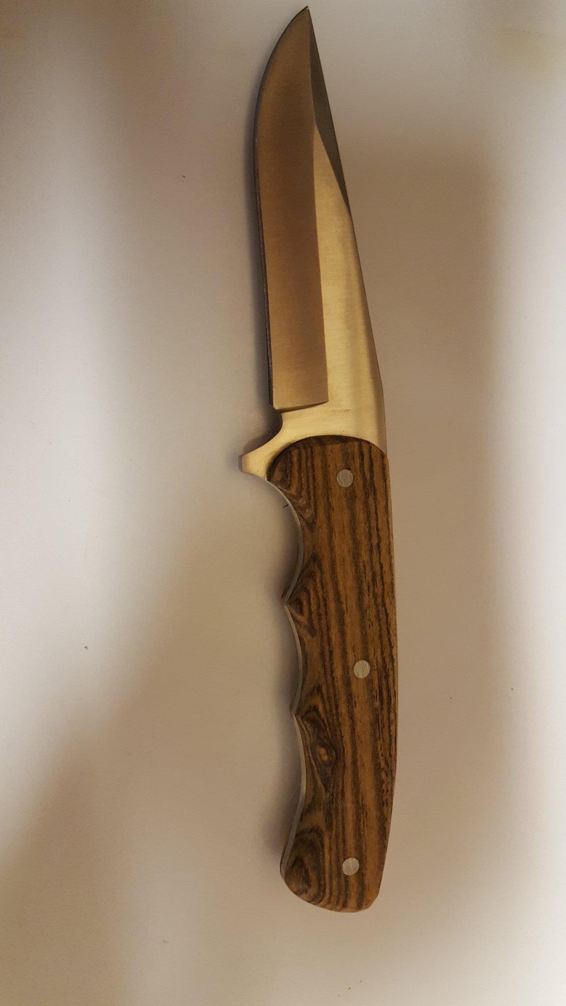

I want to get into this more. Right now I can only buy a finished blade, and do the handle work. Have dabbled in wood work over the years making jewelry boxes and such. Here is one I made for my dad this past Christmas, and a couple boxes I’ve made. I think pics are on my phone, will post in a moment.

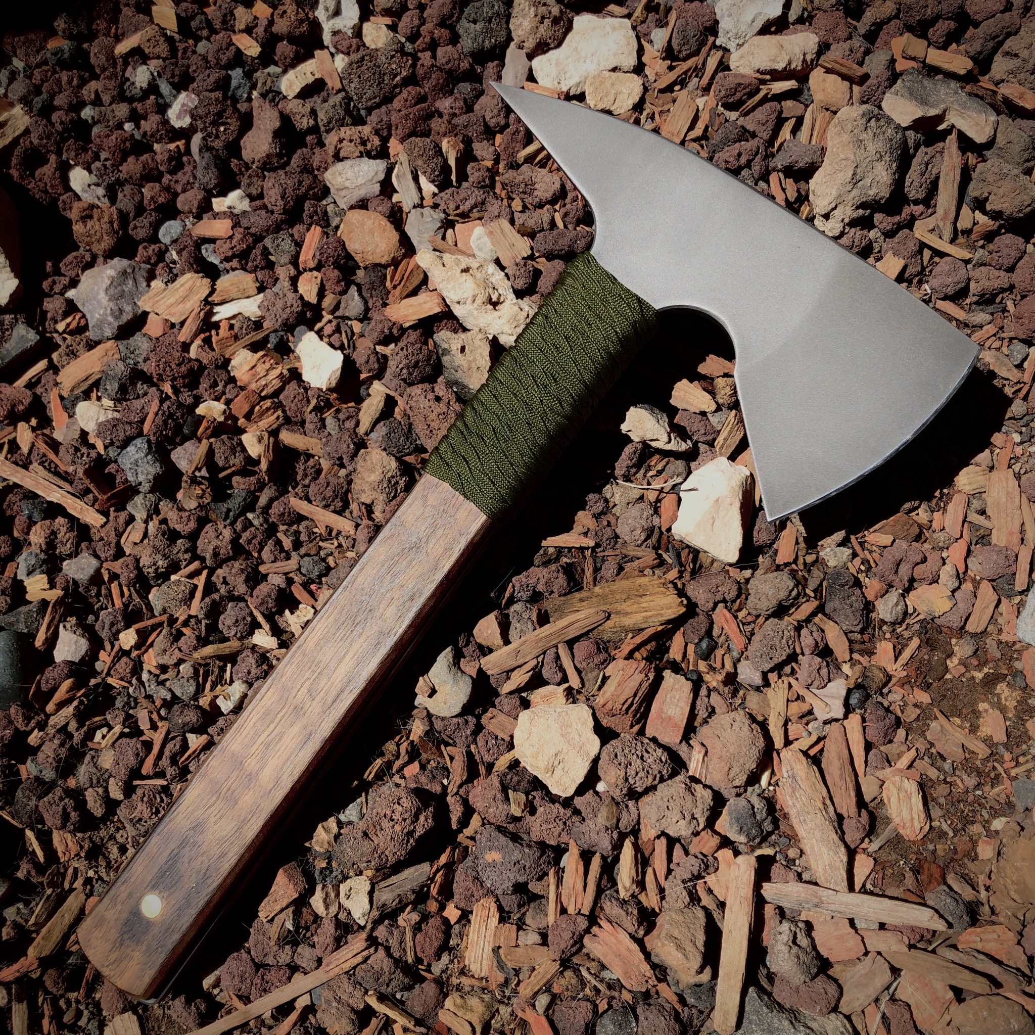

Not a knife but hope it fits. I wanted one of the Winkler Ranger Axes but $600 seemed a little out of line to me. Bought a CRKT Rune Axe and modified it to fit the bill. Re-profiled the bit and spike, stripped the black powder coat, gave it a vinegar patina and made some longer walnut scales with brass pins. Finished it up with an OD wrap. Pretty dang happy with it for the $60 investment
That is pretty dang sweet. I’ll keep you guys updated on my tomahawk Im building.
That is a mean looking SOB
