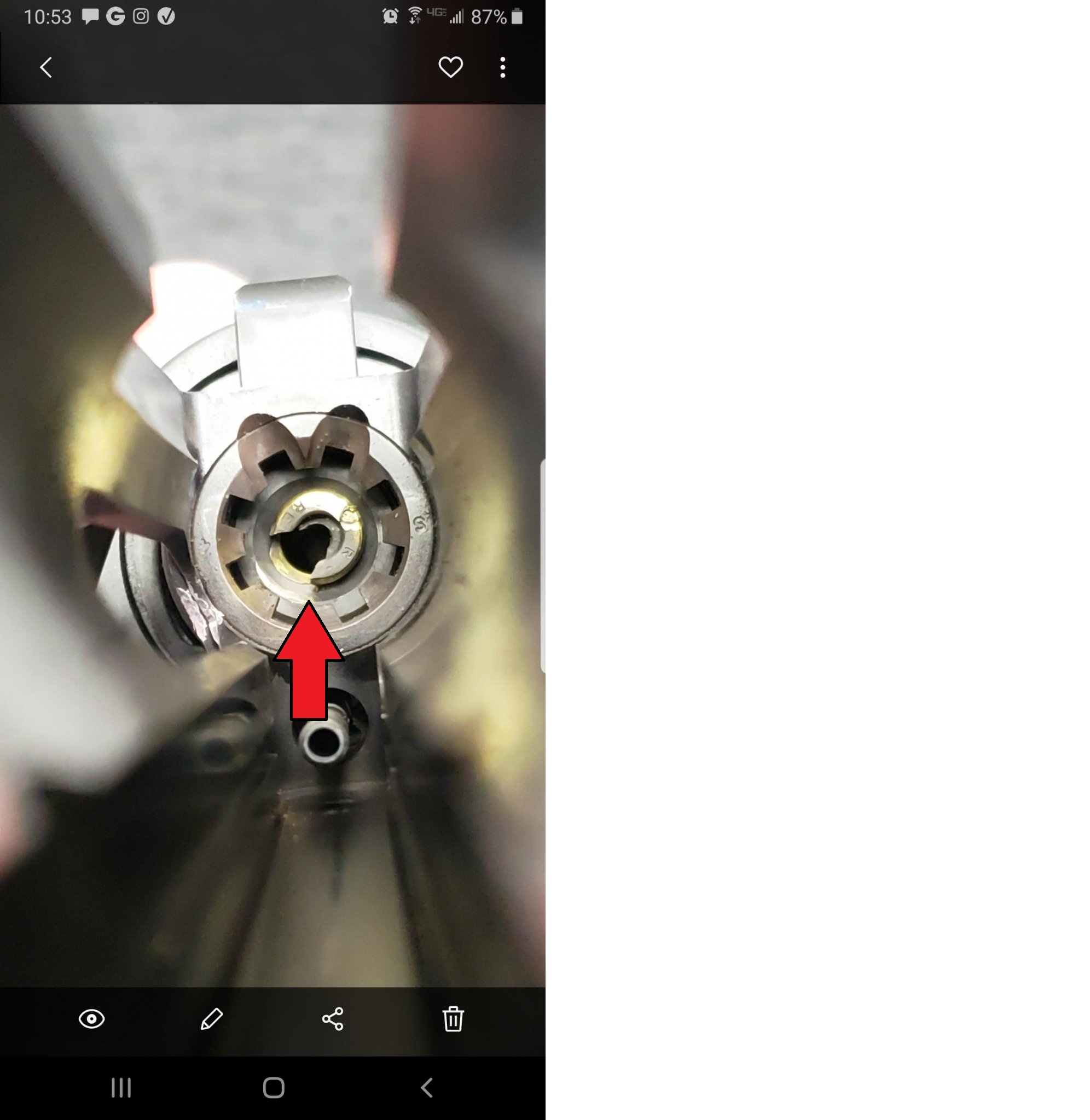

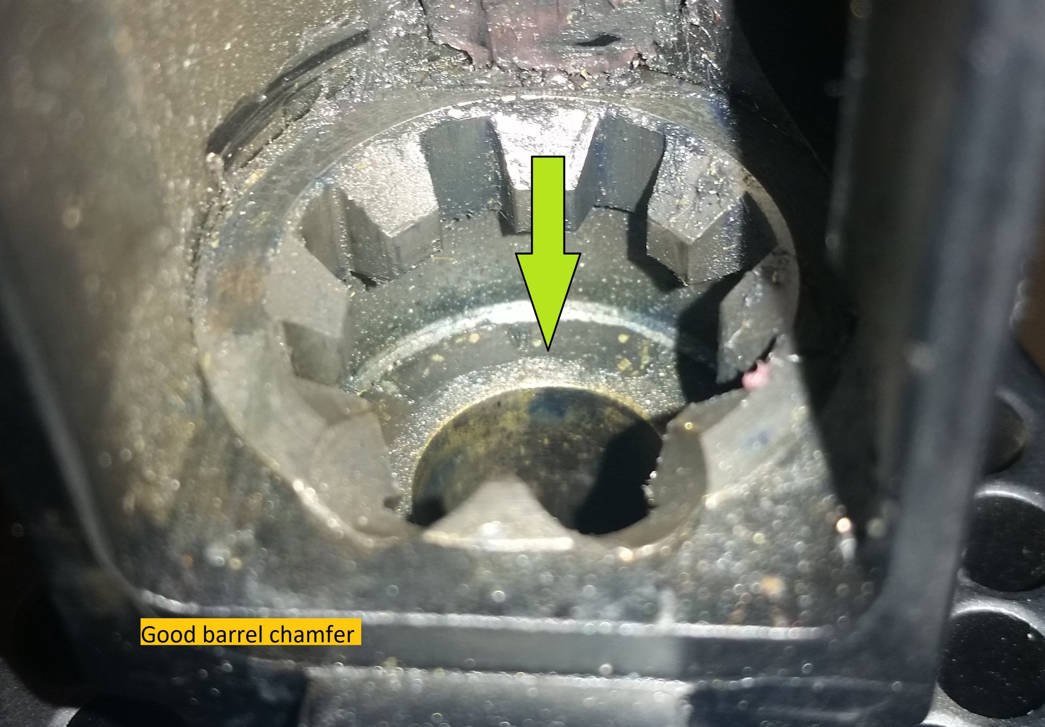

The barrel was over chamfered, as seem in this pic, where the case failure follows the deep chamfer on the barrel. The chamfer should be very slight, not countersunk like that one. There is no support at the sidewall of the case. I would guess the other brass has expended in that area, that case was the weaker of the group, but bound to be an issue. This is an issue with the barrel manufacturer. Red arrow shows the area in question, the seond image with a green arrow shows how it should look.
The barrel was over chamfered, as seem in this pic, where the case failure follows the deep chamfer on the barrel. The chamfer should be very slight, not countersunk like that one. There is no support at the sidewall of the case. I would guess the other brass has expended in that area, that case was the weaker of the group, but bound to be an issue. This is an issue with the barrel manufacturer. Red arrow shows the area in question, the seond image with a green arrow shows how it should look.View attachment 7389316View attachment 7389317
That would do it, especially with cases that didn’t have a lot of ‘meat’ at the head.
