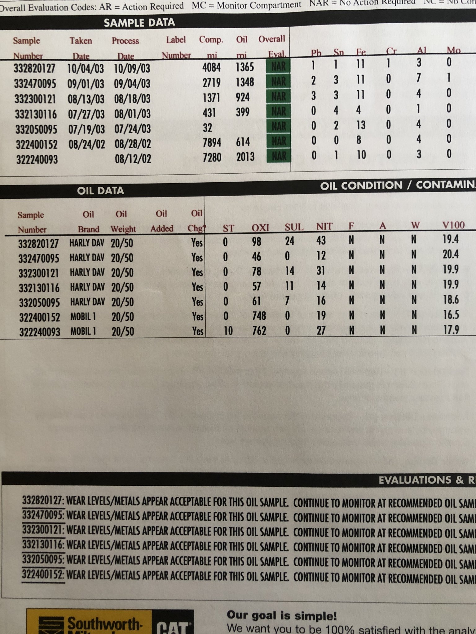

I used to work for a construction company and we had bags and bags of sample bottles we would use to draw oil from machines and send to Caterpillar for analysis.
My 96 Road King began getting tested and what the wear numbers showed me was using a standard 20W-50 and changing it regularly was better than the expensive Mobil 1 synthetic......and using either I changed oil at the same intervals 3000 miles often less.
Wear numbers on the metals where higher with Mobil 1. Some other numbers would be high too, who knows maybe it was the ingredients in the formulation. Maybe a difference would be seen between an air cooled Harley and something with supplemental cooling.

Were the "wear" numbers you are referring to above, determined by metal content in the oil analysis or by wear measurements made on disassembled parts?
I have to assume the former.............which I'd be a little skeptical of as reflective of true "wear" on critical parts, like bores, rings, bearing cams & cranks.
But that's interesting at any rate.................what metals showed increases? By what magnitude?

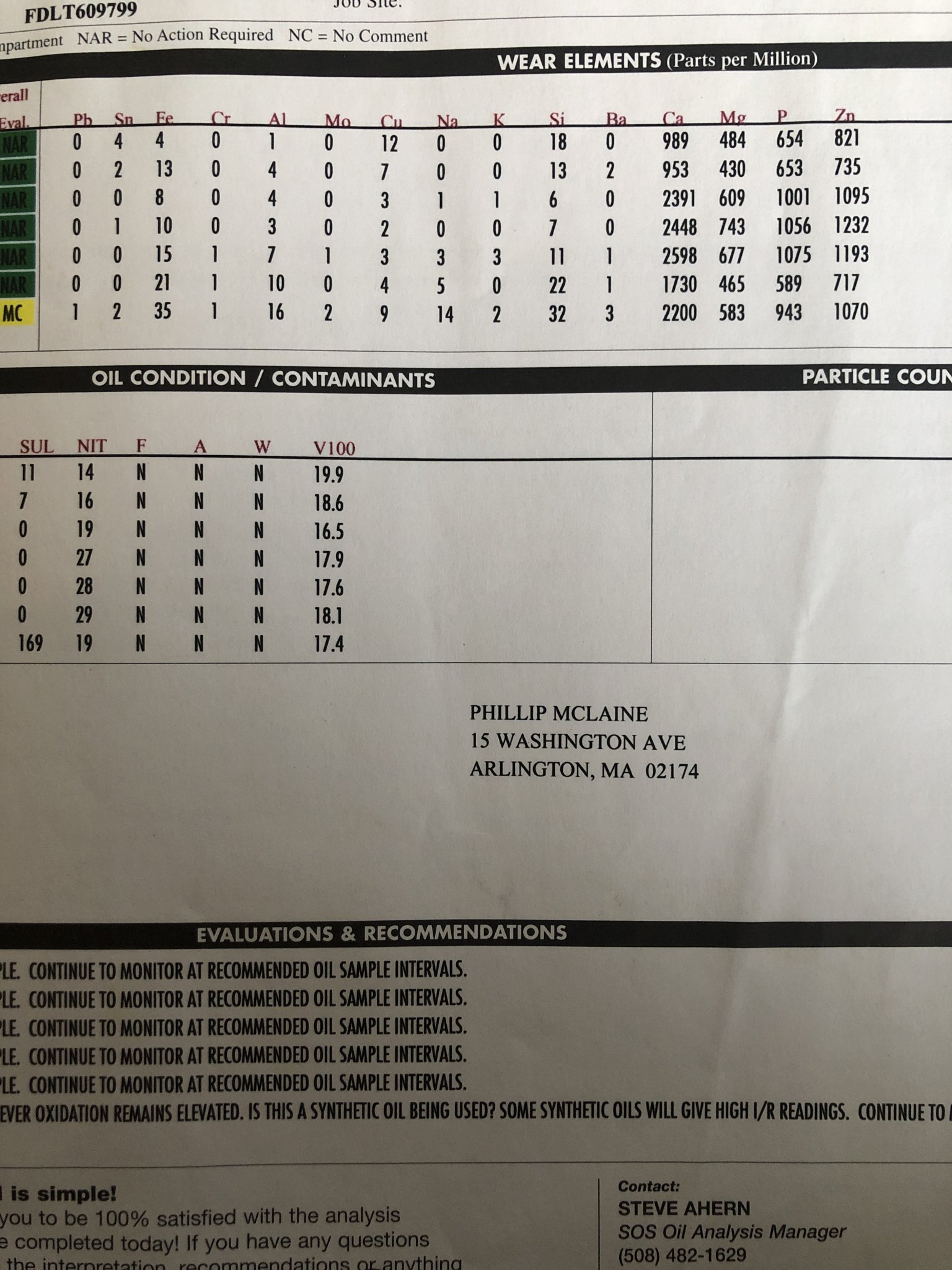

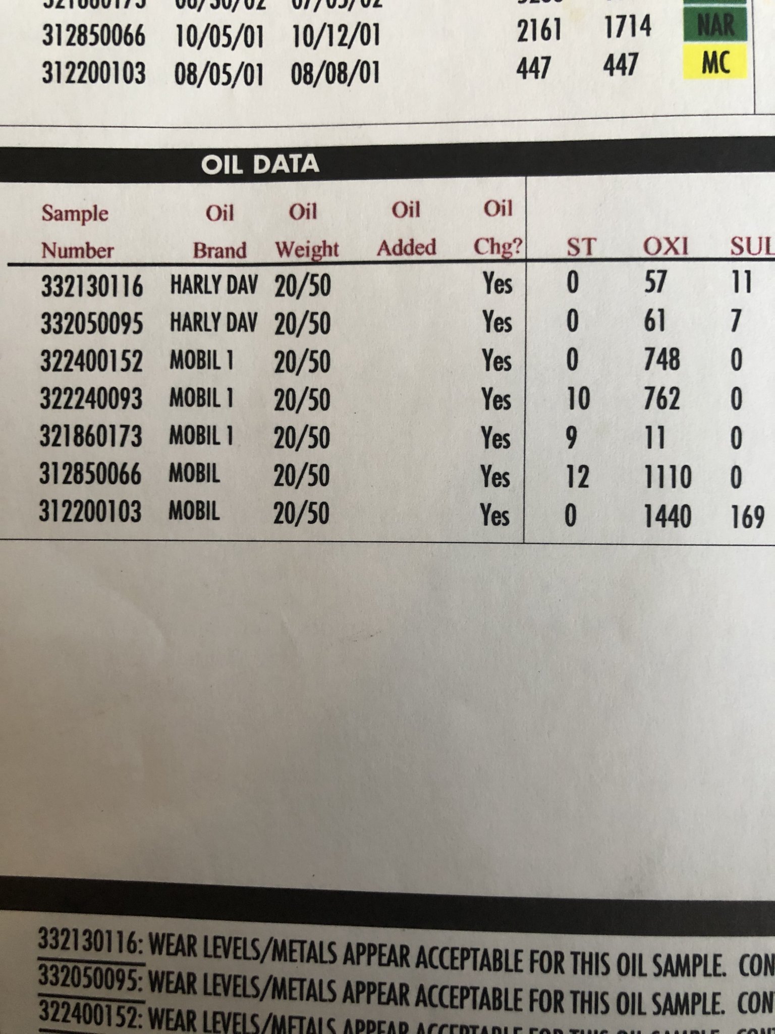

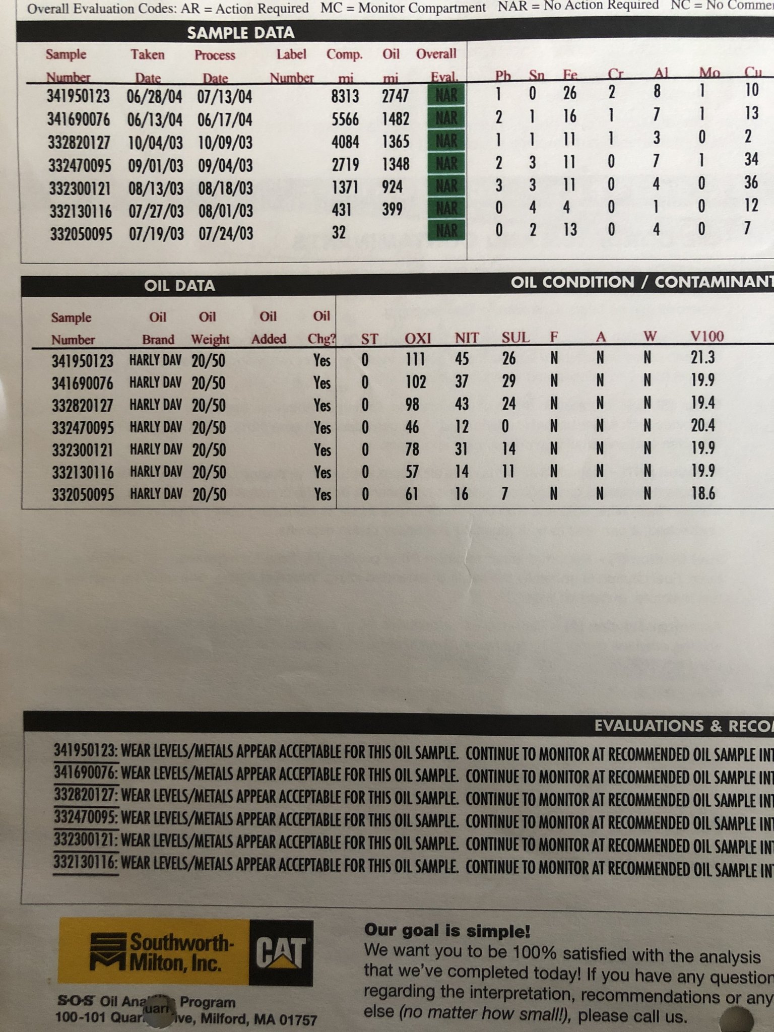

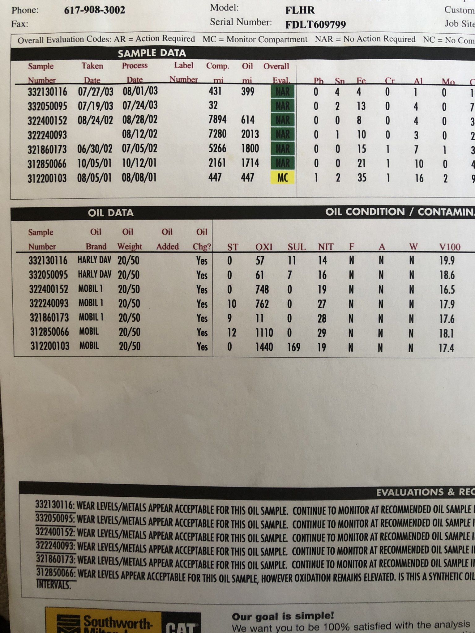

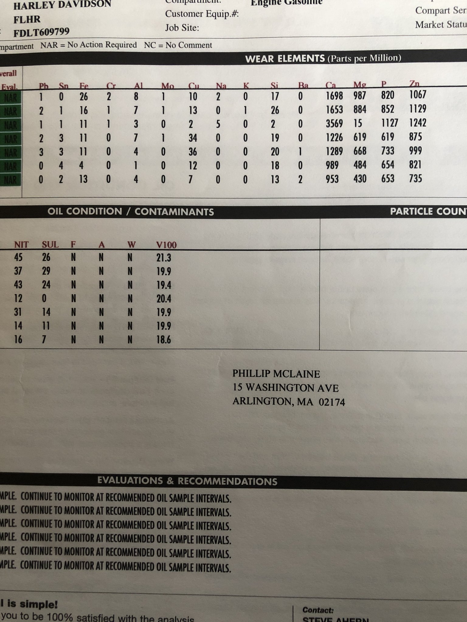

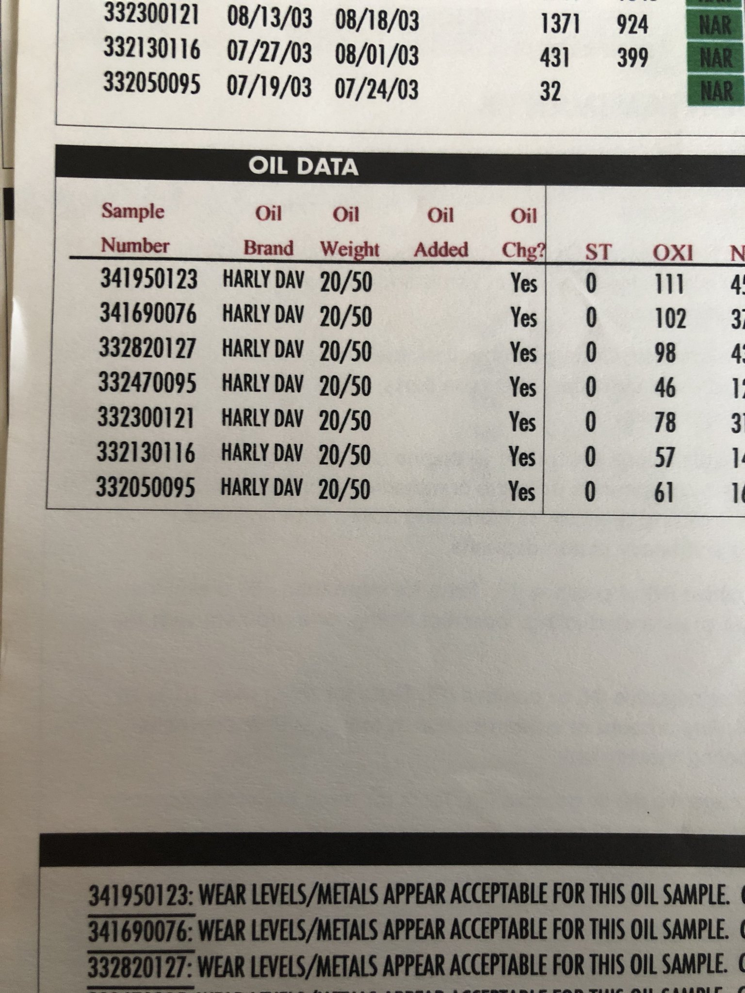

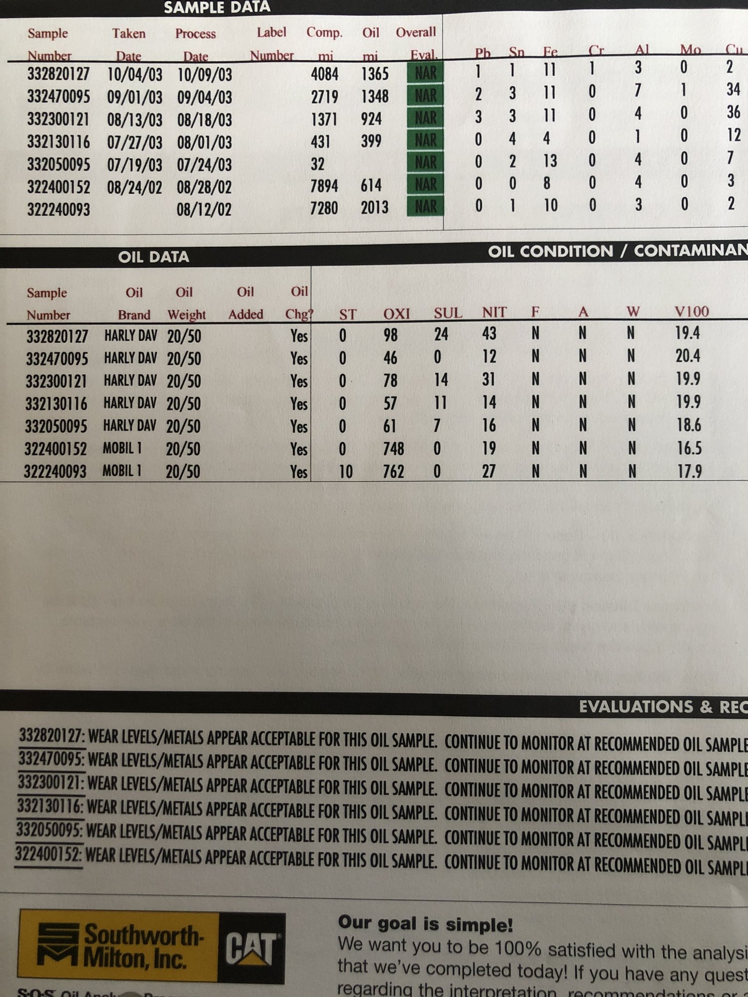

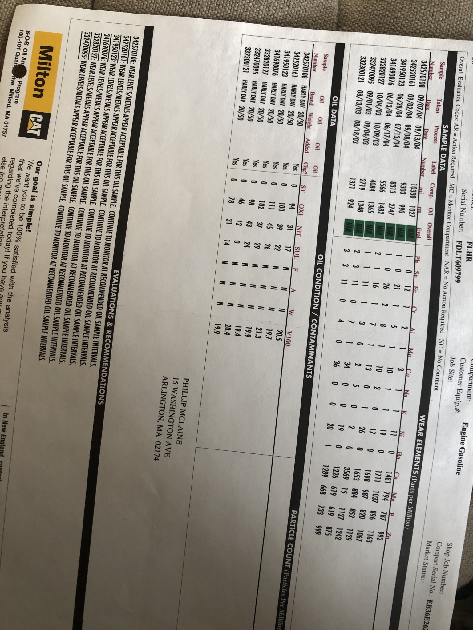

Here is a sample summary of my Merch 120 CI looks like it was run on Harley 20/50 since rebuild…Also some reports that include Mobil 1 being used thing that really stood out was how much soot was generated by Mobil 1 but the HD dinosaur oil ran soot free. Also note the oxidation numbers.
Anyone with real experience would read this much better than I can. I just thought it was cool data.

Wear elements
Very interesting info as I work in a business that produces ICE parts, for both Cat & HD & I also have 2 HD's.
I'm not an oil or lube specialist but I do know a fair bit about wear mechanisms of ICE parts & we run 12 dynos for testing.
W/o doing baseline chemistries (which CAT may have on file) it's hard to compare or make sense of some of what they are calling "Wear Elements" as I'm pretty sure much of that chemistry is additives in the Mobil 1.
The most telling to me would likely be Fe..............which could be related to lot of components in the engine but since ring & liner friction is the highest in the engine, it might be an indicator of potential liner wear. The rings are coated so you would likely not see much ring wear impact from iron, at least on the face.
I don't see any big swings in Fe........................w/o understanding all their history of this kind of analysis in relating the oil content of various things, it's hard to know what they are looking for either.
The only real way to determine parts wear is post test disassembly of pre-measured parts IMO, which we do of course; oil consumption is measured as the test is running, or sometimes just with drain & weigh.
