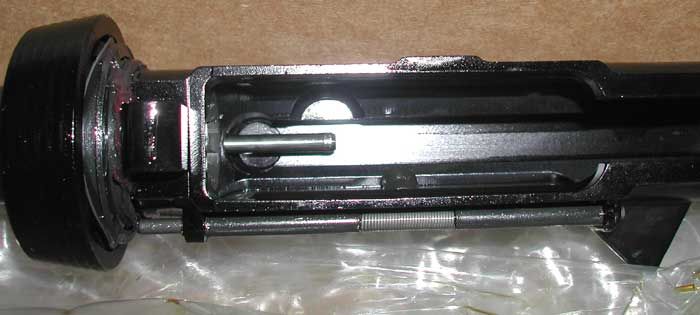

How far is your gas tube protruding into the upper? Does it end at the cam pin cutout like this one or is it shorter?
dWJlLmpwZw

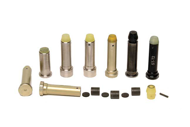

I swapped out the buffer spring and buffer for a Tubb flat spring and Odin adjustable buffer. Tried various weights from 1.5oz to 4.5 oz, with no change. I tried 2 different BCGs, with no change. Tested the BCG with bolt removed to check gas tube fit, no issue. Tested to make sure the gas block was aligned (though the dimpling jig ensured it would be, and removing the block I could see the holes matched up perfectly) by blowing air through with the barrel plugged. Gas key is tight and properly staked. Thoroughly lubed the bcg.

I have tried milspec carbine spring and buffer, and Tubb flat spring stock and with 3 coils cut, with adjustable buffer from 1.5 oz to 5.6 oz. It's not a buffer or spring issue.
