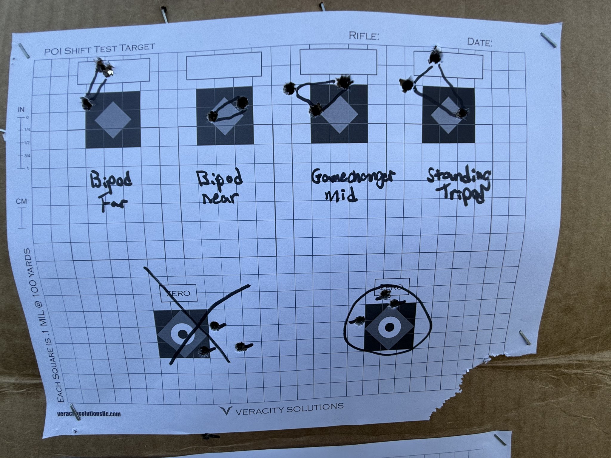

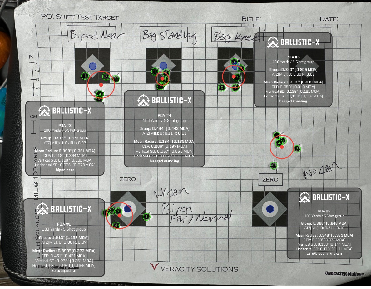

I recently did a test with my factory 18” Seekins DMR. Note my zero in the bottom right target is high, and correlates to the “bipod far” square, which makes sense because that how I zeroed the rifle.
Very pleased with the results of the Seekins. ~0.17 mils of shift is well within acceptable when accounting for my performance with this ammo.

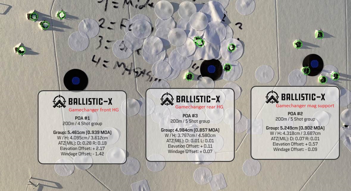

  • Ballistic-X-Export-2024-11-19 17:04:30.936732.png

One other observation is that after zeroing off bipod, I shot a 10 round group prone mag supported (part of a friendly competition and didn't use bipod out of fairness to shooters without one) and found a 0.8mil (!!!) downward shift. I think this makes sense because in mag supported prone I am applying additional downward pressure on the handguard to counter balance my cheek pressure on the stock. This is completely opposite to bipod supported where the bipod is applying upwards force, and it logically makes sense that the shift is larger than the shift I get off a bag and barricade because that is a relatively neutral position with regards to handguard force.
Reactions: Tx_Aggie
I threw 1/2 moa out as an example and vague recollections of pics people posted on this thread, but maybe their shift was more.
I had to read your description three times. Still not sure I understand it. So to back brief: When you zero from a bipod your POI has a downward shift? And then when you shoot prone, mag supported you have double the downward shift? And then articulate that the handguard pressures are opposing between bipod supported(up) and mag supported with your support hand applying a heavy downward force?
Random question: zeroing with a bipod, downward shift. Shift from what? Did you already have a zero from a different position? And the downward shift was from a known good zero, but just from a different position?
As a complete aside to handguard flex, shooting mag supported in the prone is a really great tool for teaching NPOA(Natural Point of Aim). I developed an ARM (Advanced Rifle Marksmanship) POI based on the 400pt Rifle Aggregate. We had Tiger Swan come out to our unit as part of a PMT for an Afghanistan rotation. Their pistol instruction was on point and their rifle instruction was okay, but the 400pt Rifle Aggregate they used to teach their version of the rifle fundamentals is a great drill, although it could be pared down to a 300pt drill. You shoot 3 x 10rd, time fire strings on an IPSC target and your looking for A zone hits. From three different positions/ distances. 100m Kneeling, 200m Sitting, 300m Prone. The drill starts Standing, low ready, in kit, and you have 60 secs to go kneeling, fire 10rds with a mag change anywhere you want in the string. Move back to 200, Standing to sitting, 60secs, 10rds, one mag change, 300, Standing to prone, 10rds 1 mag change. Walk up and score all 30 shots for a total of 300pts. You can apply different scoring depending on the target you're using. B8 repair center, FBI Silhouette, etc.
When I teach shooting in the prone in kit, mag supported, you have 4 different axis that your barrel can try to point. Up, down, left and right. Place the mag and point the barrel,.if your too high on target you have to readjust the buttstock in your shoulder slightly up to adjust elevation. For left or right you pick up the gun and place the mag so the gun is pointing directly at the target, on sights so you don't have to move your body to get on target. And you do all this with your firing hand. You don't apply your support hand until you have a good NPOA. Once you do, you LIGHTLY apply your support hand as far out in the fore end as possible with your elbow providing support off the ground. The role of the support hand is to steady the long axis of the rifle only. If you're using your support hand to point the gun on target you're not shooting a NPOA. It's just there to quell the normal wobble zone with light guidance. Your body should aim the rifle naturally in target. Your firing hand pulls back into your shoulder and cheek pressure helps lock the gun in.
I use a VTAC sling to wrap in the kneeling and sitting. This allows the gun to rest in a position, in a NPOA. When you can shoot over 275 on a B8 repair center on this drill you're doing pretty good. And you're generally all inside the black. And as I think about it, the last time I shot it, I didn't have an obvious 10rd POI shift from, say sitting slung vs prone. You might want to try using your support hand as light pressure to steady and using your firing hand to provide the majority of pressure.
I zeroed POA = POI with the bipod at 100yd (i.e. no shift condition). When shooting off a barricade + bag with no adjustments to zero, I have a mild downward shift (0.4mils). When shooting mag supported prone with no adjustments to zero I had a significant downward shift (0.8mils) - this isn't something I generally do with this rifle but again only did it to be fair to other shooters without bipods. I only bring it up to demonstrate the point that in my experience, the mechanical POI shift from pressure on the forearm can be orders of magnitude larger than what I would consider a normal NPOA-related shift. The rifle in question has a KAC URX4 and Douglas 16" barrel.
The drill I was shooting actually was the 400pt aggregate shot on a B8 repair center with no mag change. I also do not have an obvious POI shift going from kneeling to sitting but I did going to prone - to your point it is technique induced due to the amount of downward pressure I was applying to the handguard, which did not feel like an extreme amount. I did shoot another group mag supported prone to confirm and both times I was impacting about a half inch below the bottom edge of the 9-ring (i.e. ~3moa shift).

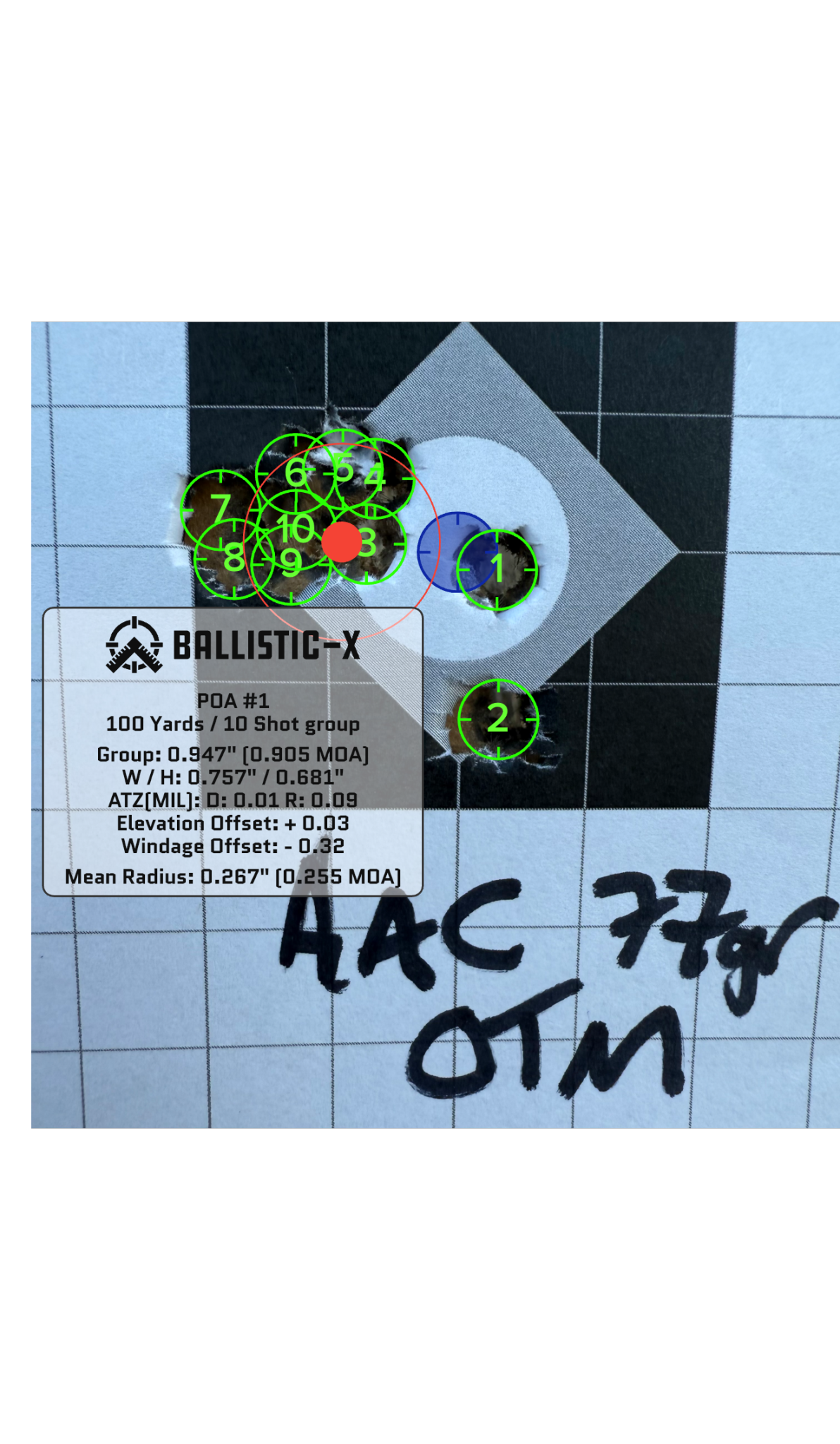

This is a great thread - thanks for starting it and for your data to kick it off! I have noticed different levels of POI shift between 7 different ARs. I have noticed it is less for rifles with stiffer connection between receiver and hand guard and thicker barrel contours, but I have never quantified the shifts. Generally the shift doesn't seem to be worth thinking about in the heavy barrel AR10s (less with SP10 than a custom with Aero M5 upper, almost zero for Armalite T10 with true free-float barrel). The shift seems to be a few tenths mil for SPR/DMR AR15s with medium contours (White Oak SDM upper/PWS lower and Seekins DMR) but is much larger, maybe close to 0.5 to 0.7 for the lighter contour AR15s with light weight hand rails (e.g. DDM4V7). After reading this thread I am going to try two things - be more consistent with down-force when in a position that requires it, and quantify the shifts for each rifle in each position.
RD LPR-15 with a 20" WOA barrel. MK262 77gr. 100yds
Self-diagnosing, in the prone I'm shooting a light grip, neutral bipod load, about as medium shoulder pressure I can but I was shooting off a polished, glazed concrete floor with a CkyePod's clawed feet so the gun slides forward. Off the kneeling bag, I'm putting a lot more shoulder into it and the gun is much more fixed with my support hand c-clamping the handguard against the bag. I shot tripod twice. Locked the leveling head the first time and unlocked it the second time to essentially free-gun it. Hence why the POI resembles the bagged group. I wasn't surprised to see a POI shift high off the locked tripod but I I was surprised at the windage shift too. I think the difference shown between the two tripod shooting styles shows just how much influence support hand placement and shoulder input has to NPOA and POI.
ETA: Aero M4 Enhanced in 22ARC. 20" Craddock RTR. Berger 85.5 Hybrids, 28gr TAC, 2818fps, 9fps SD over 20rds.

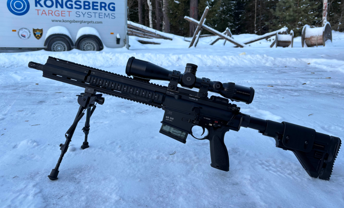

I have currently tested the MR308A3-28, and the mr223a3 with geissele handguard.
I cant discern a significant shift with the fiocchi 55gr ammo im using in the mr223, anything gets lost in the dispersion. need some better ammo first.

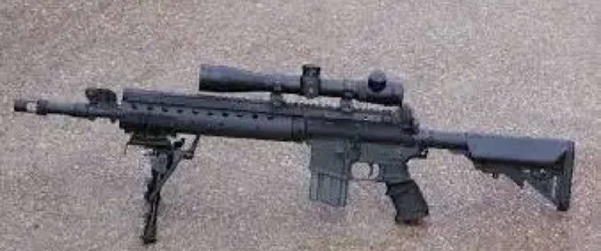

for the mr308 i got the groups below, shot at 200m to see any shift a little better. so you are looking at about 2" at 200m with only the weight of the rifle loading the handguard.
I'm also curious why they would notch the top rail at the upper to handrail transition...unless it's part of how the barrel nut is torqued, it seems like an unnecessary weak spot.
