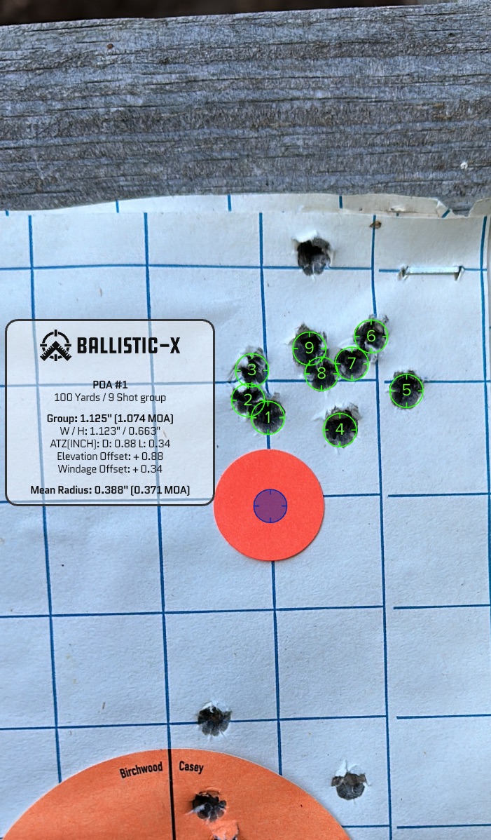

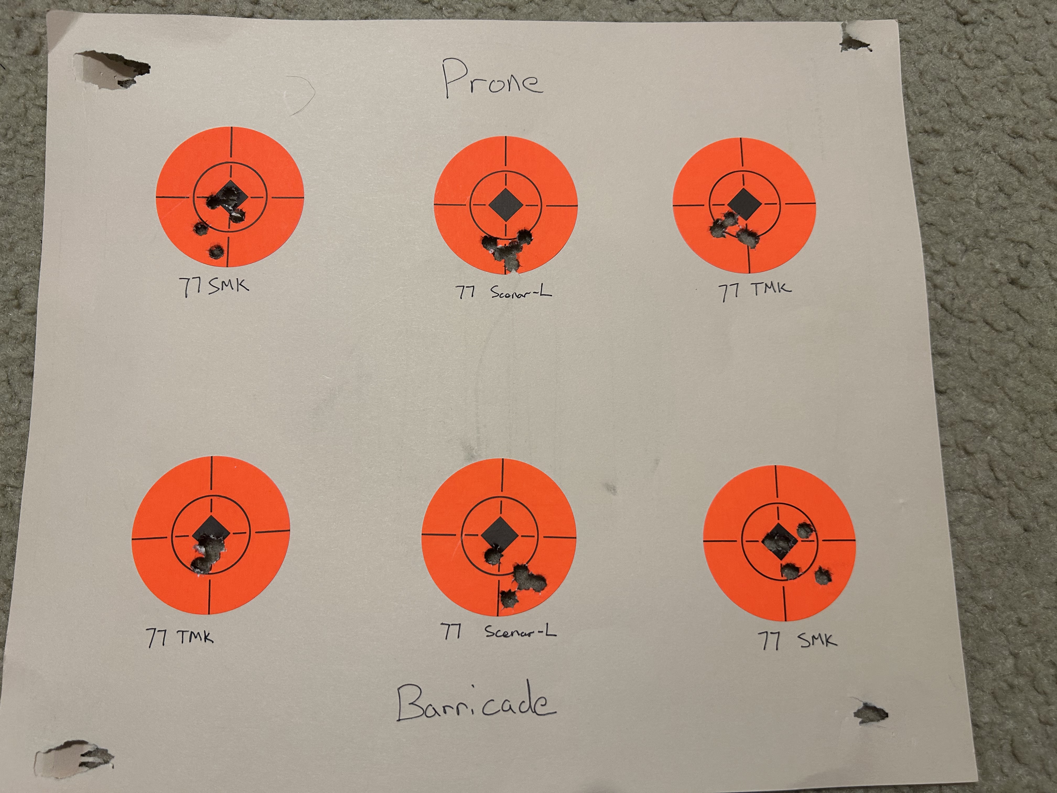

Tested 3 different bullets out of new barrel today and decided to try this test. Top row is prone, bottom is barricade. Unfortunately not corresponding bullets so I labeled the groups to better match.
Mega bullet upper and KAC URX4. I know other people have posted issues with URX4 in this thread but this is my second and I haven’t had issues. I actually have a spare MML upper available but chose the URX4 on standard upper because I can get a lower height over bore with URX4.
I will note on this particular rifle I bridged the upper and handguard with the scope mount. Not intentionally, I just didn’t have a cantilever available and this was unused.

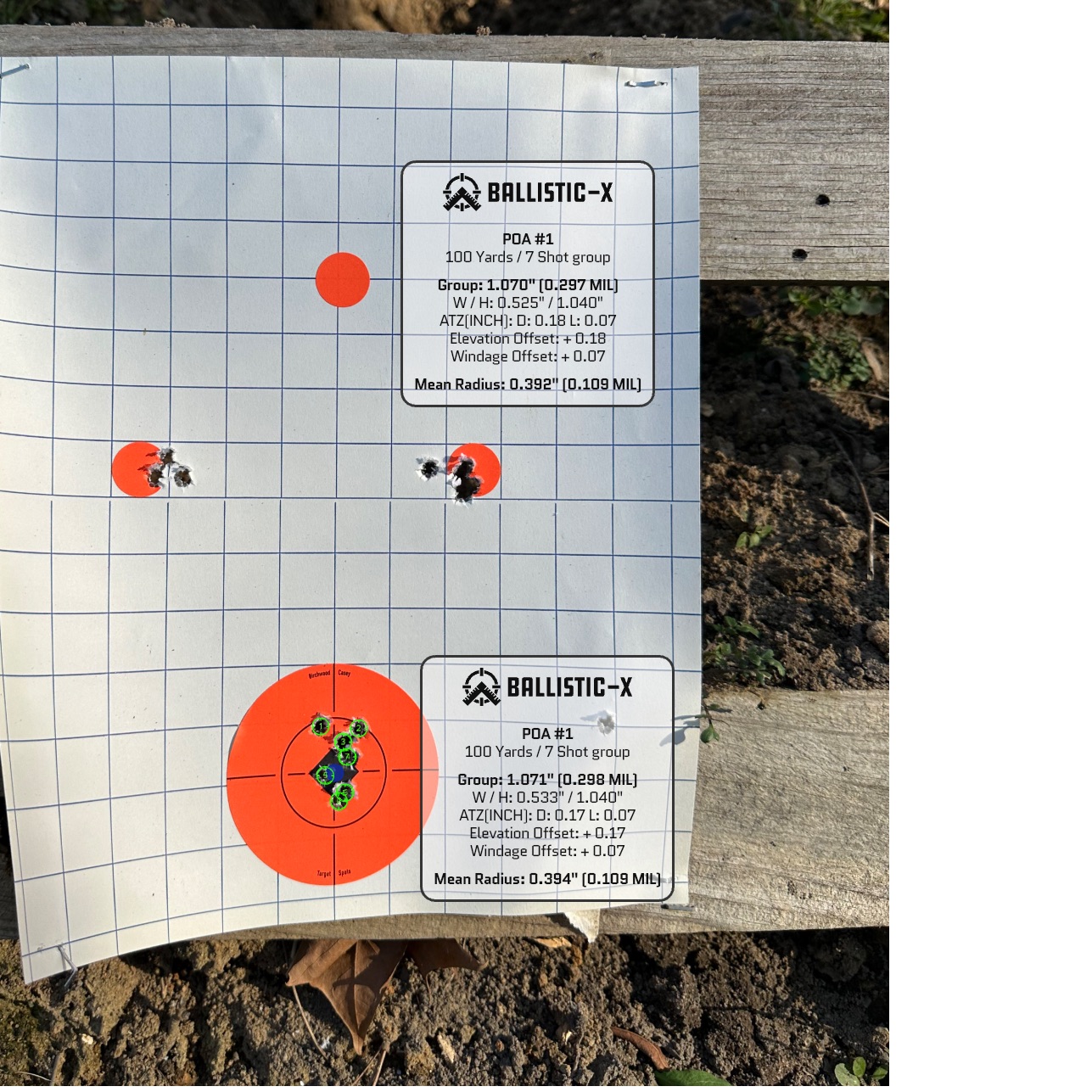

Im kinda battling with this issue right now and im leaning toward it being a fundamentals-consistency issue while shooting my rig from prone with bipod far forward and rear bag. All my groups are around 1”-1.25” and in that group I will have 3-4 rounds stacked in a .5”-.6” group and then a couple shots that blow the group out to a inch or a little more…
Rifle is a vltor Mur upper receiver, PVA Osprey 6 arc barrel, Geissele mk18 rail(bipod attached via arca on the rail), suppressed with TBAC Ultra 7 .264.
I admit I don’t have nearly as much time trying to shoot ar’s at a level of precision like i do my bolt guns and thats why im thinking its definitely me and not the gun or load(i am handloading for this gun). Barrel has right at 200 rounds on it so it should be broke in.
This is not always how it shoots but is kind of representative of how i can lay down some great groups and then the next is over an inch. Those smaller dots are right at 3/4”, the grid paper im shooting on is a weird scale.

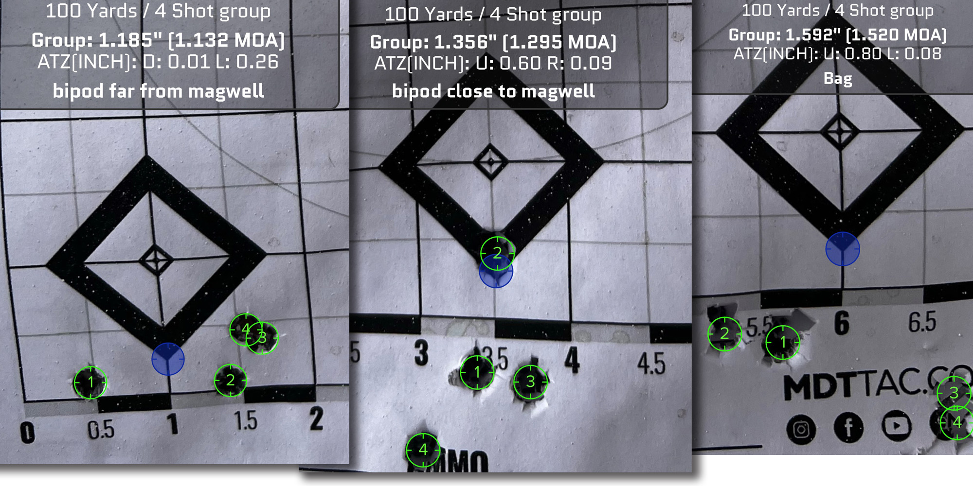

Here's another data point.
Rifle: Cobalt Kinetics CK-Pro with Rainier Match 16" barrel
Test (Left to Right)
bipod near muzzle > bipod near magwell > no bipod, shot off bag near magwell
*ignore terrible group sizes, shot cheap practice ammo fairly quickly on these groups
Results:

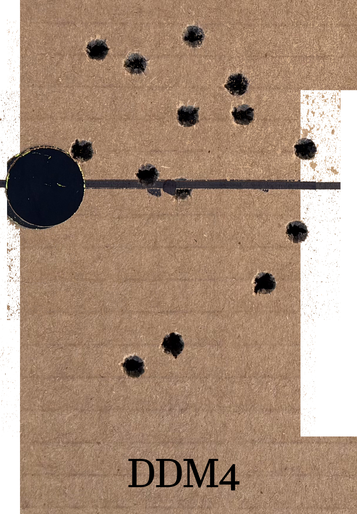

Appears to be about a 0.2 mrad shift for positional shooting. I probably should have tested this a long time ago. Good to know.

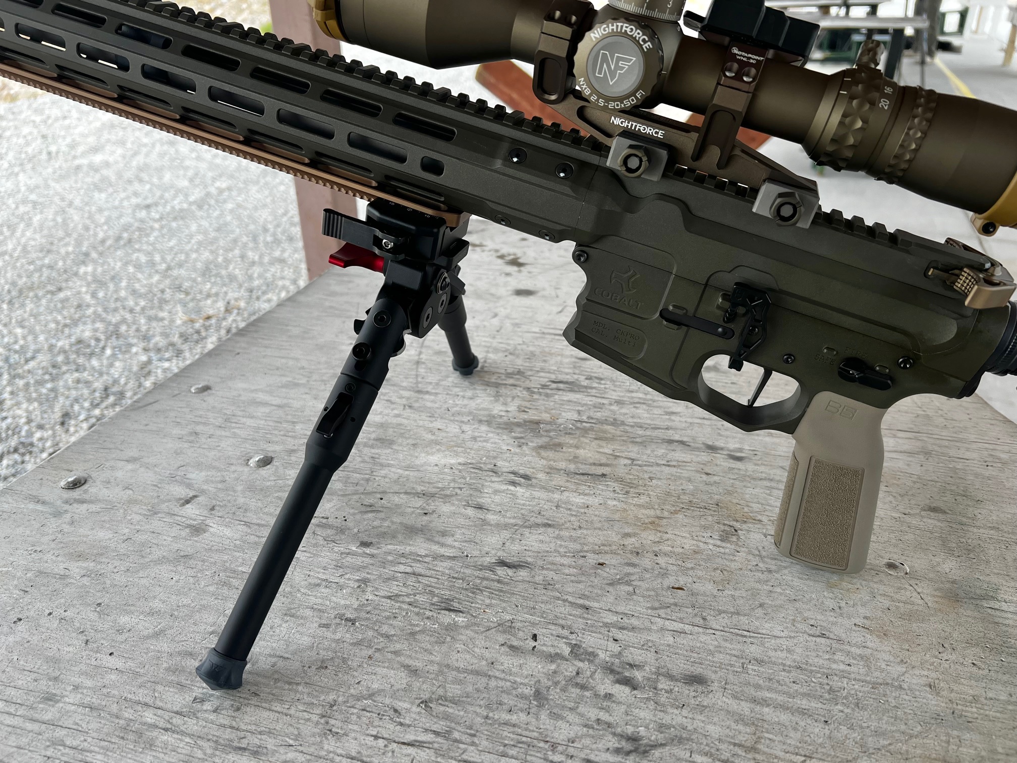

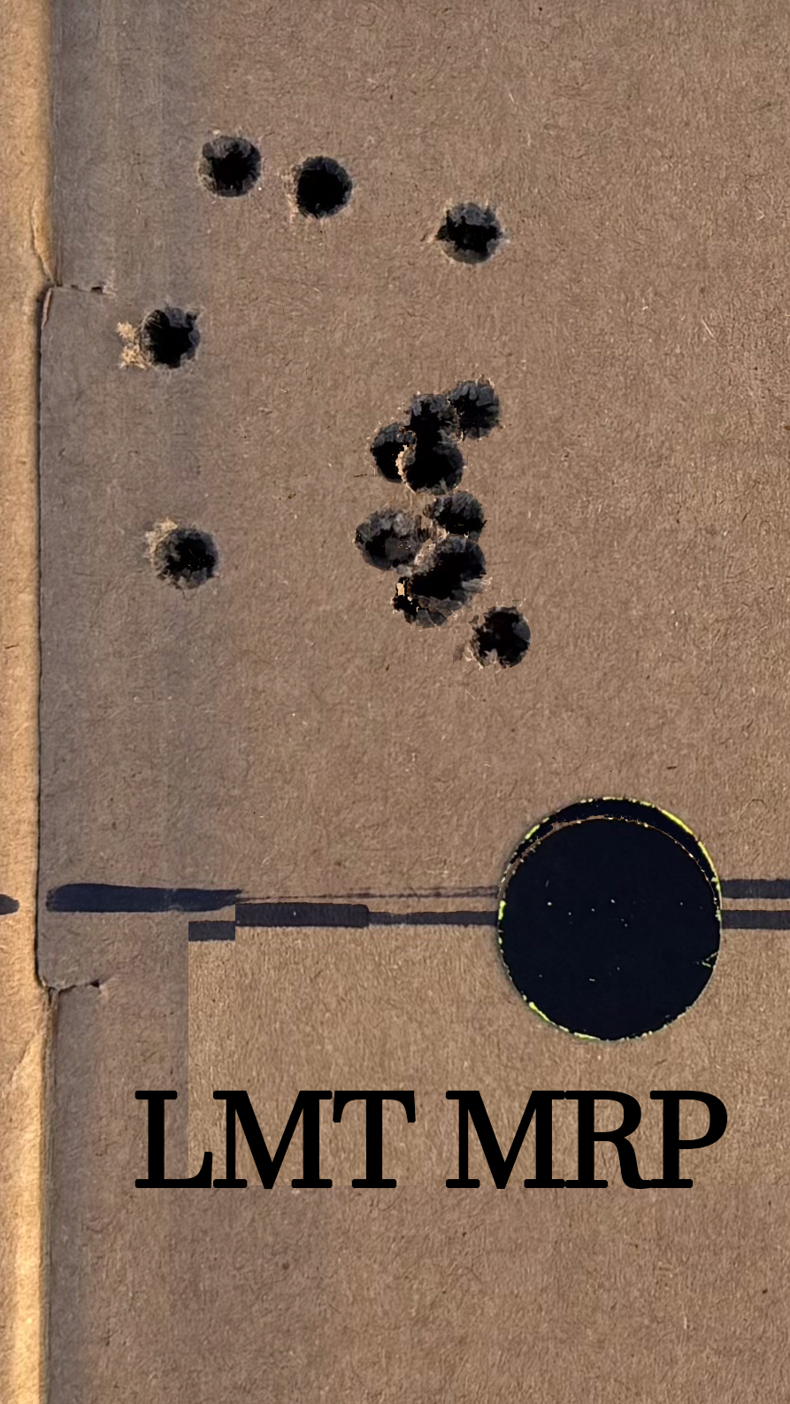

I definitely need to do more testing, but reading this thread got me curious. I shot my LMT MRP tonight from a bag and also from a bipod extended all the way out on the rail. I did get two nice tight groups, but with a bipod the group dropped .1 mil and shifted .1 mil left.
Barrel is a Bartlein conversion, it's now a very accurate rifle. I went with LMT partially because of the minimal POI shift, along with the ability to change barrels quickly and easily.
I'll test this more this weekend and follow up with some photos
Results:

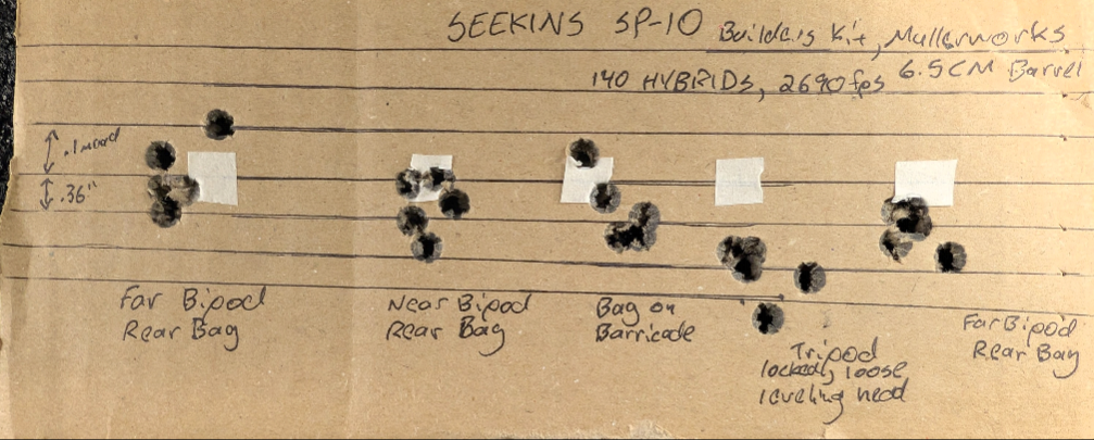

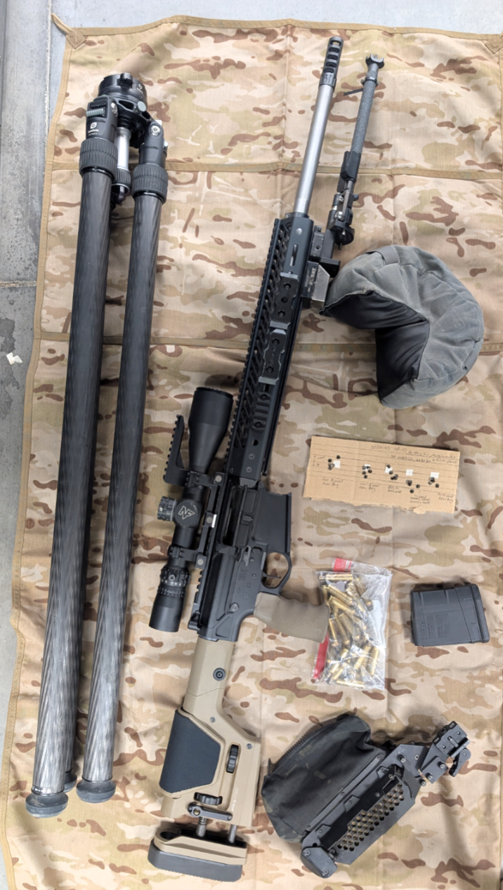

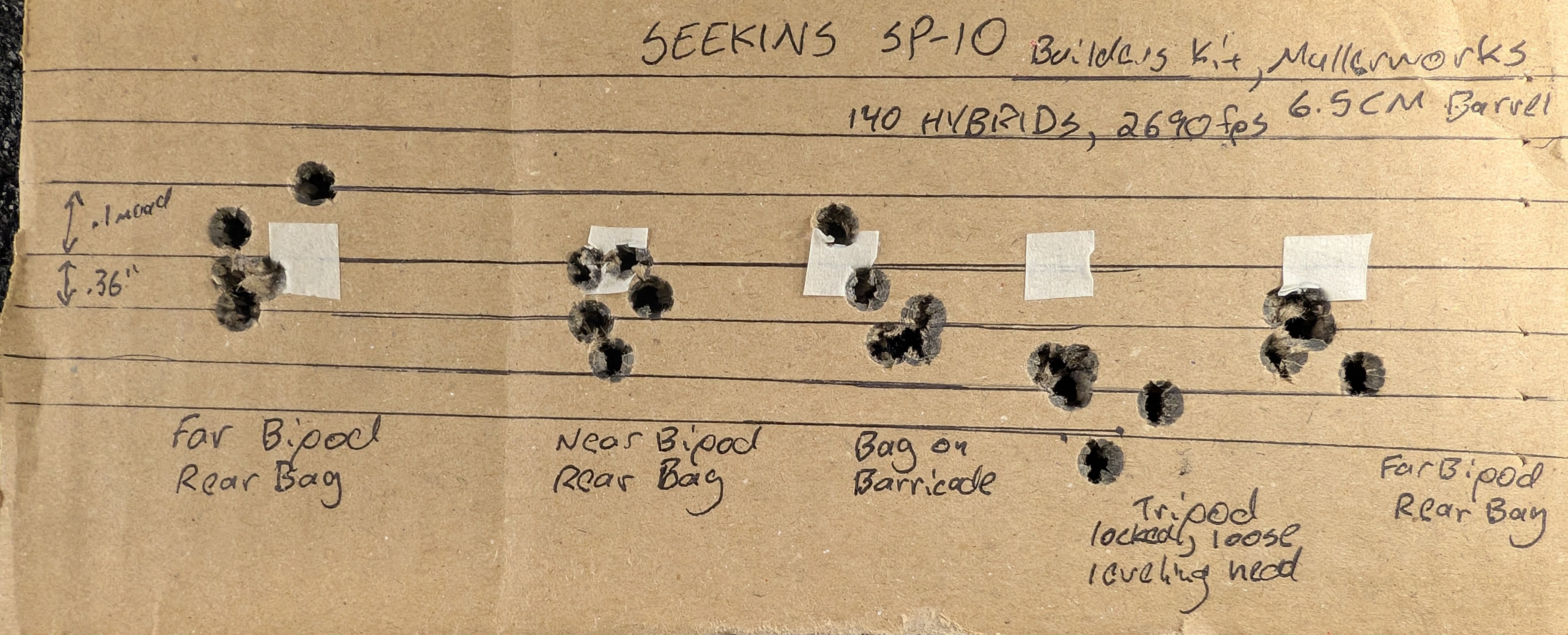

Seekins SP-10 builders kit. Mullerworks custom 6.5CM barrel. JP guts.
One bag, one tripod, one bipod, one barricade. About a .1mrad from all other positions to tripod and back. And I'm fairly certain it's how I'm driving the gun off the tripod to manage wobble that's causing the shift, not the handguard flexing.

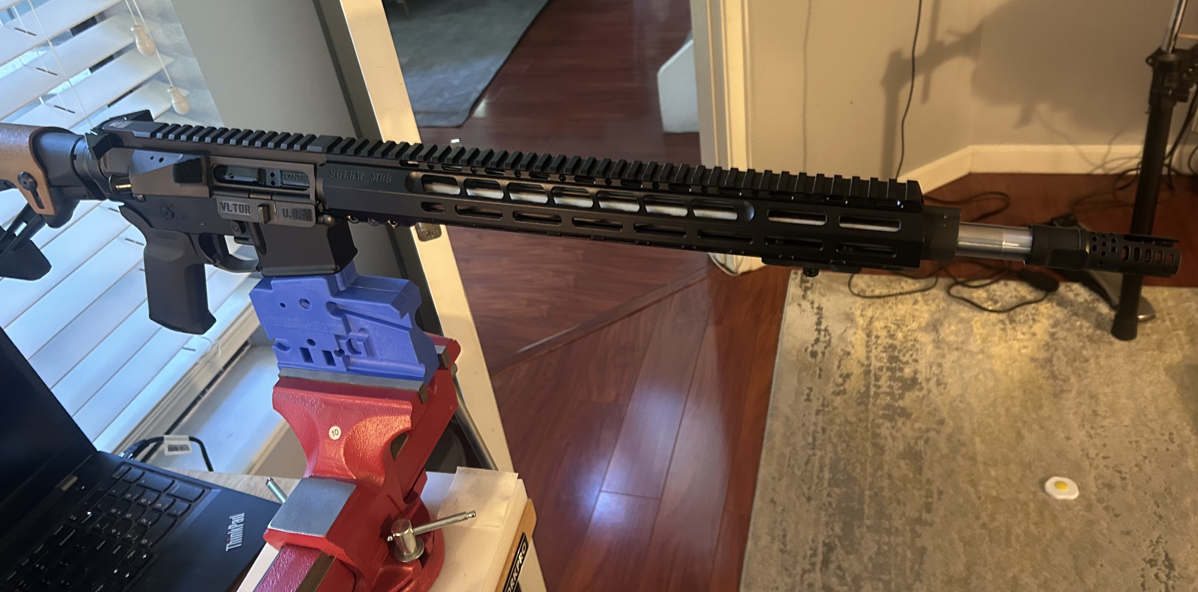

Nice…I have almost an identical build that I just finished (MUR upper + 18” Osprey 6 ARC barrel + M89 15” Rail). I have yet to shoot it as im still working on some ammo with alpha brass and 107 smk’s.
