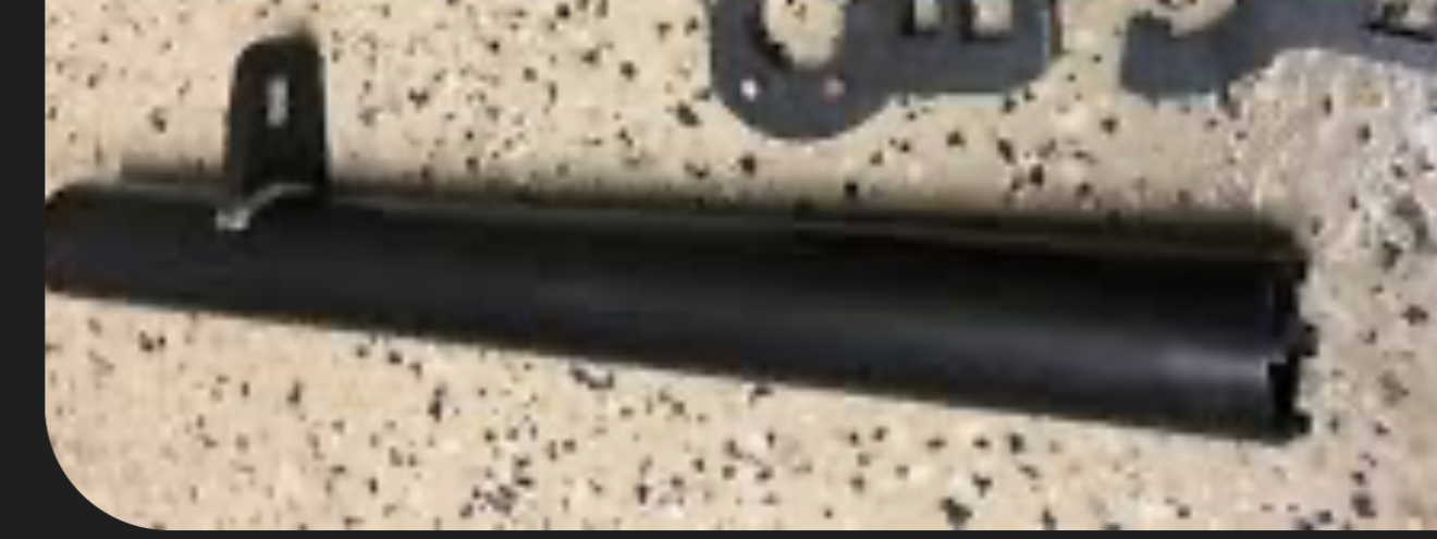

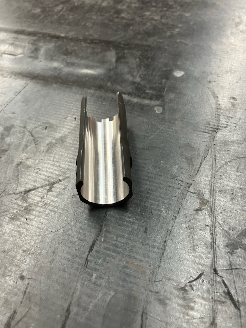

I meant HOW its torqued on. I don't see any external screws or something with the photos I've seen.
These shipped with the megalithic uppers and could be purchased separately for a while.
I’d assume the ICON uppers will use something similar.

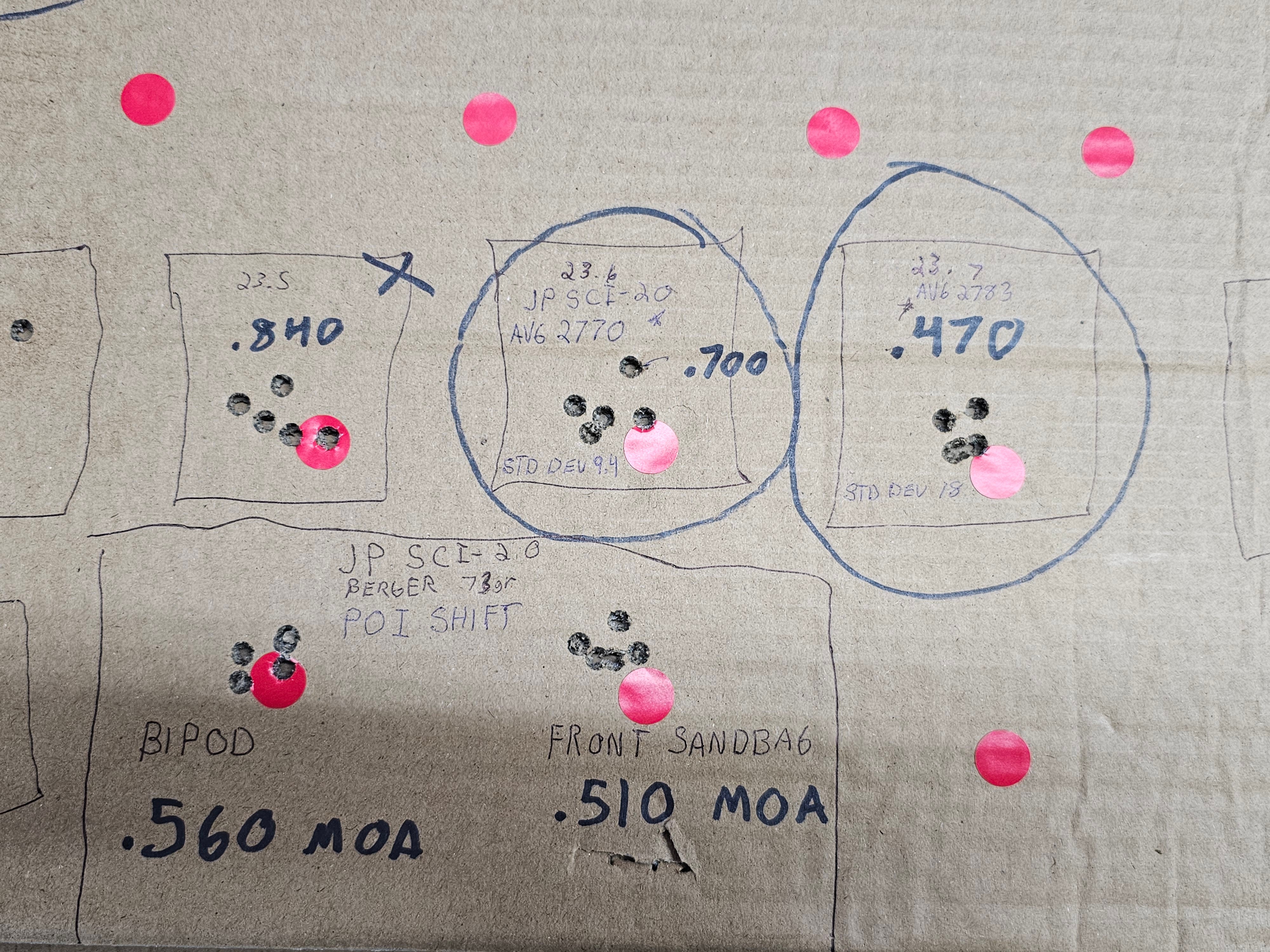

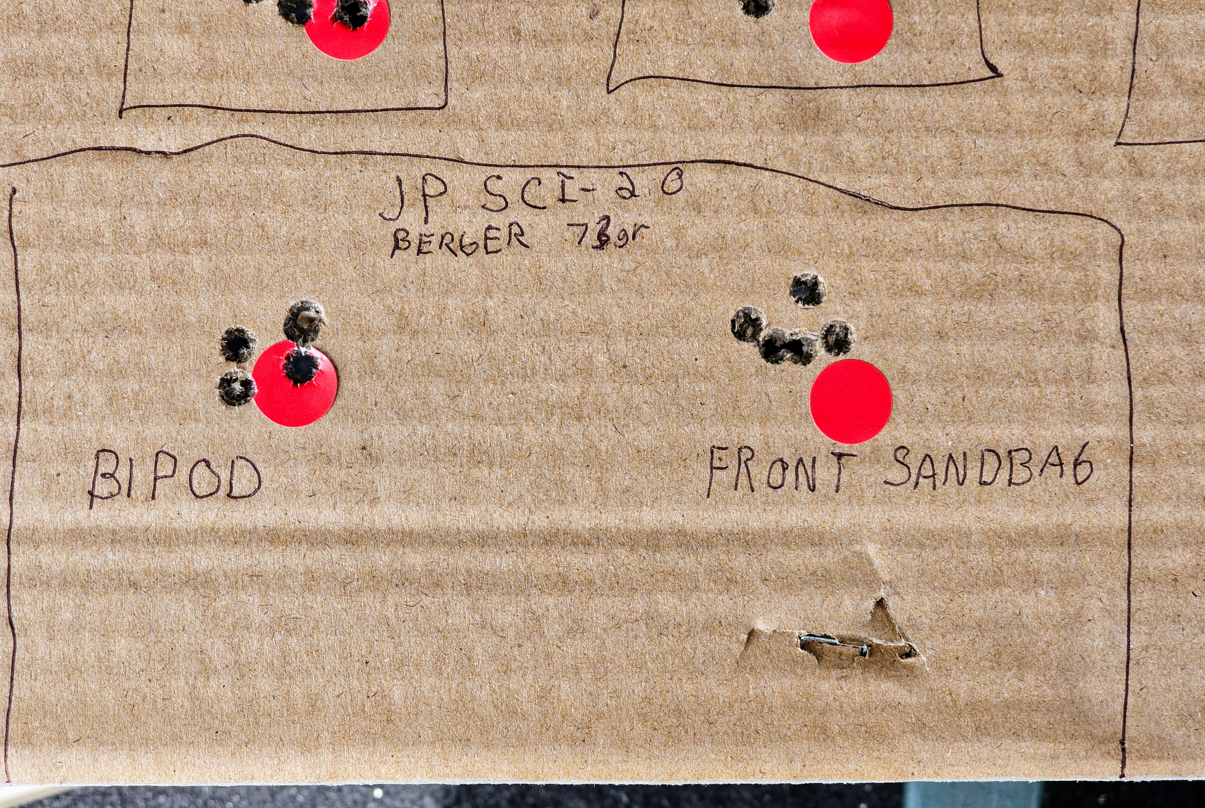

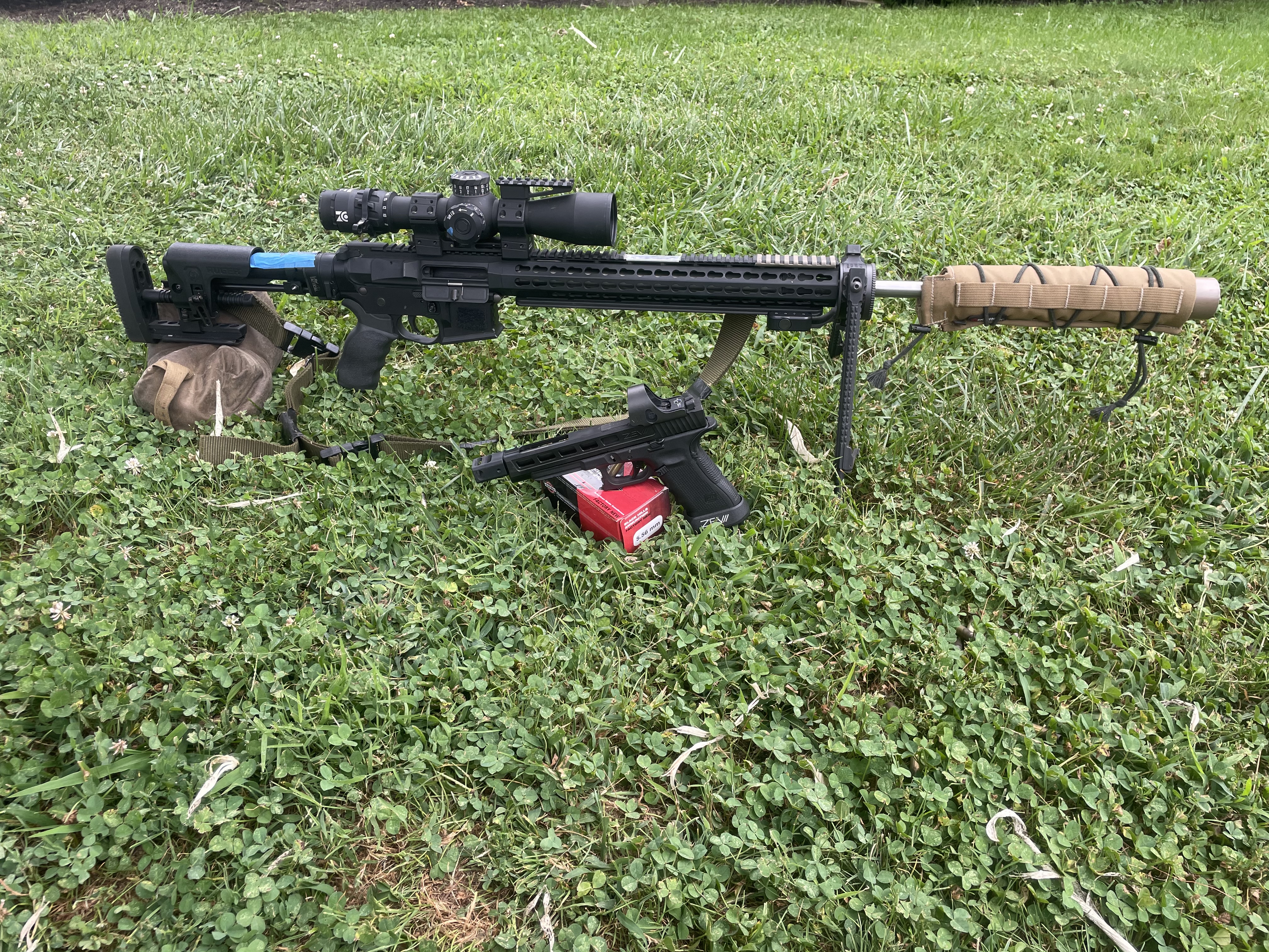

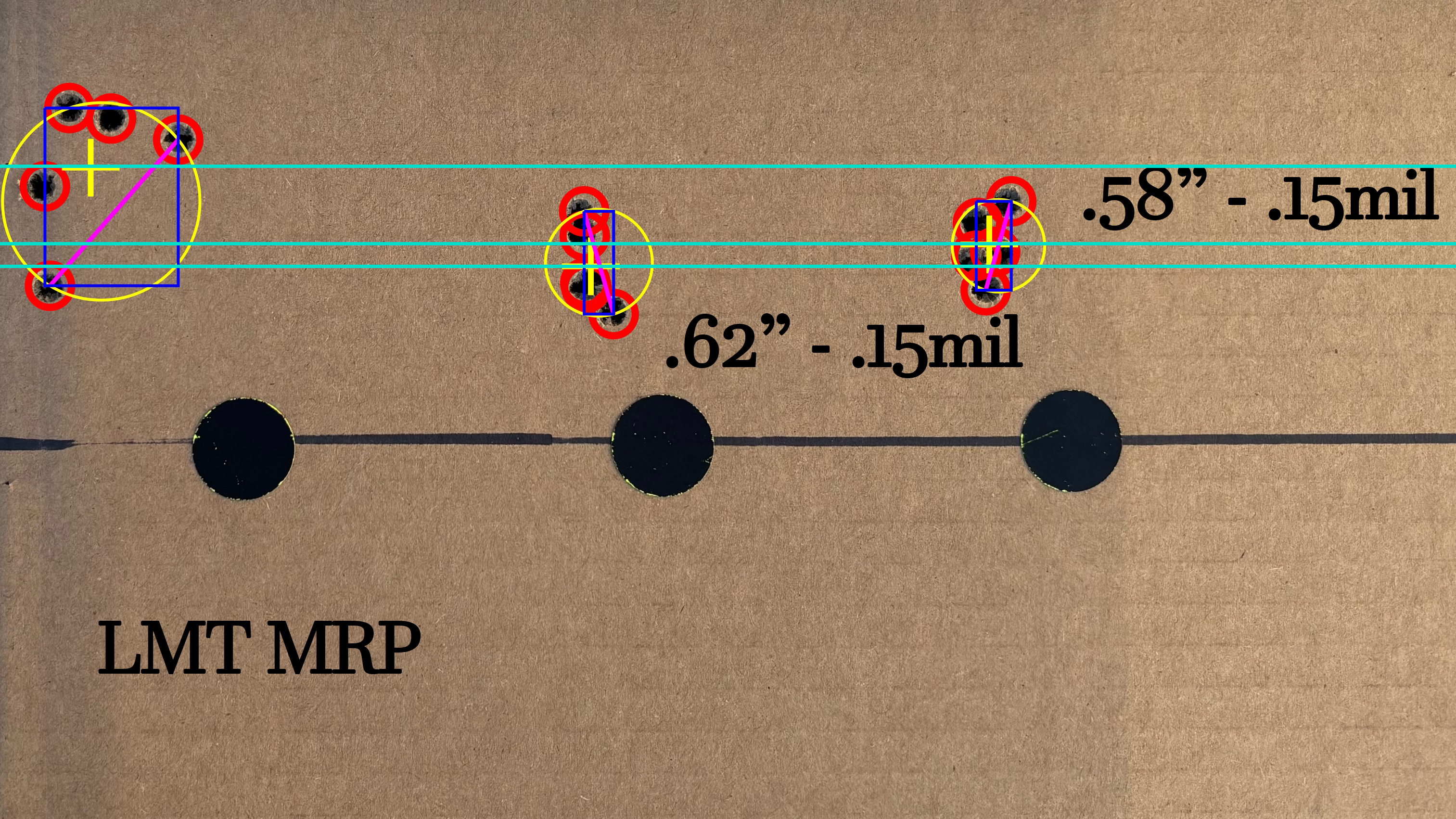

I definitely need to do more testing, but reading this thread got me curious. I shot my LMT MRP tonight from a bag and also from a bipod extended all the way out on the rail. I did get two nice tight groups, but with a bipod the group dropped .1 mil and shifted .1 mil left.
Barrel is a Bartlein conversion, it's now a very accurate rifle. I went with LMT partially because of the minimal POI shift, along with the ability to change barrels quickly and easily.
I'll test this more this weekend and follow up with some photos
One more point.
Shoot rifle A prone and off a barricade. See 0.4mil shift.
Shoot rifle B prone and off barricade (same shooter and technique as before, for the sake of argument also assume the stock is the same). See 0.1 mil shift.
Tell me that it's still support/NPOA and not at all affected by the actual rifle.
This reflects my personal testing as well at .4 and .2 shift.
Is it the rifle? Is it the shooter? Most likely, yes.

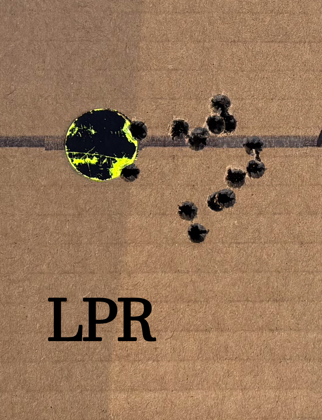

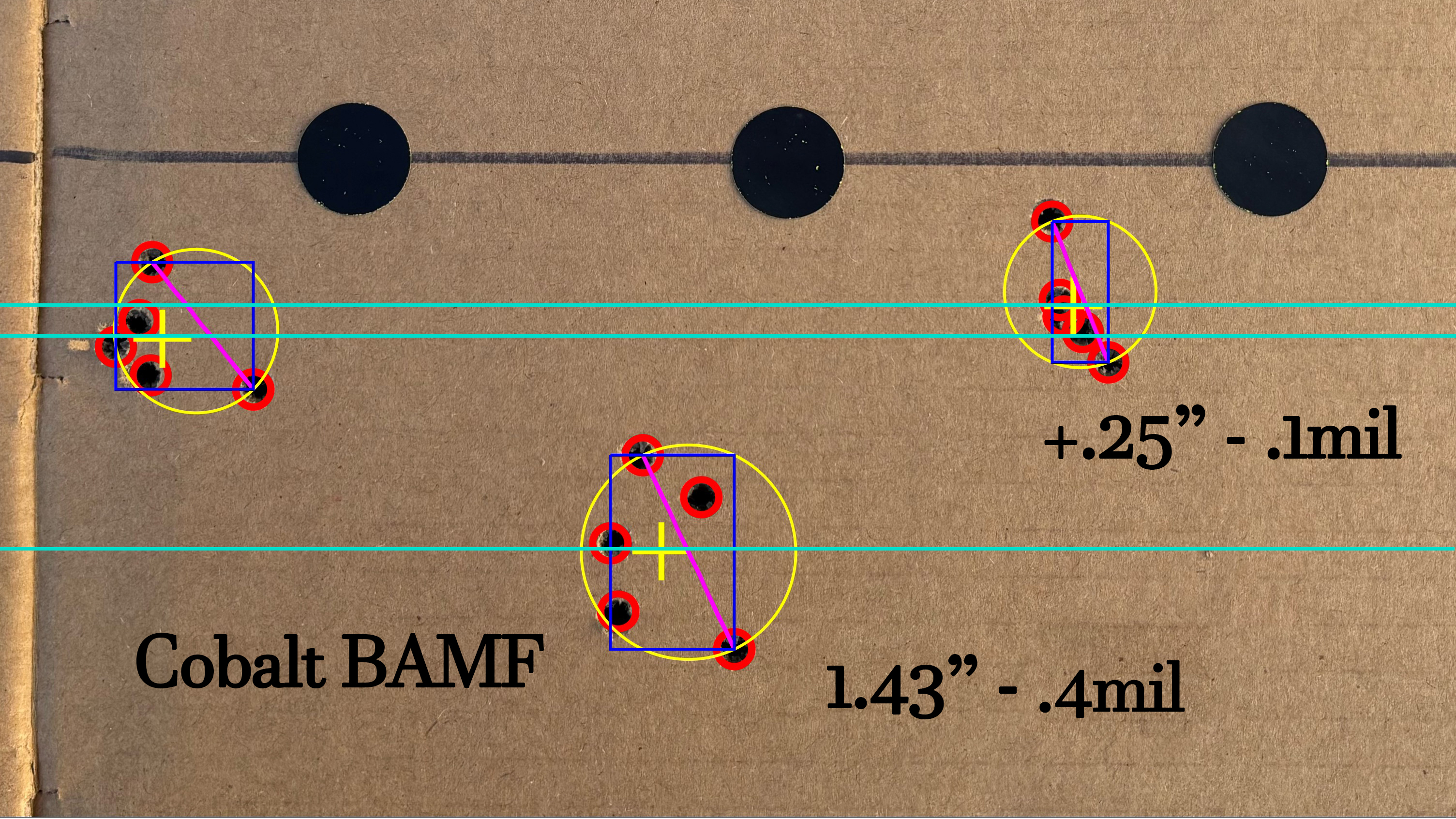

My 18" KAC LPR Mod 2 upper with 15" URX4 mlok, with Area419 arcalock rail, OCL OCM5 can, shows at 100y
.30 mil shift down from bipod far to bipod middle
.44 mil shift down from bipod far to bipod near
.41 mil shift down from bipod far to bag near
I zero off my bipod far so that's why I keep that as my reference point.
I will try my 18" Centurion MK12 barrel with 15" CMT HDM handguard with Area419 arca lock rail this weekend maybe.

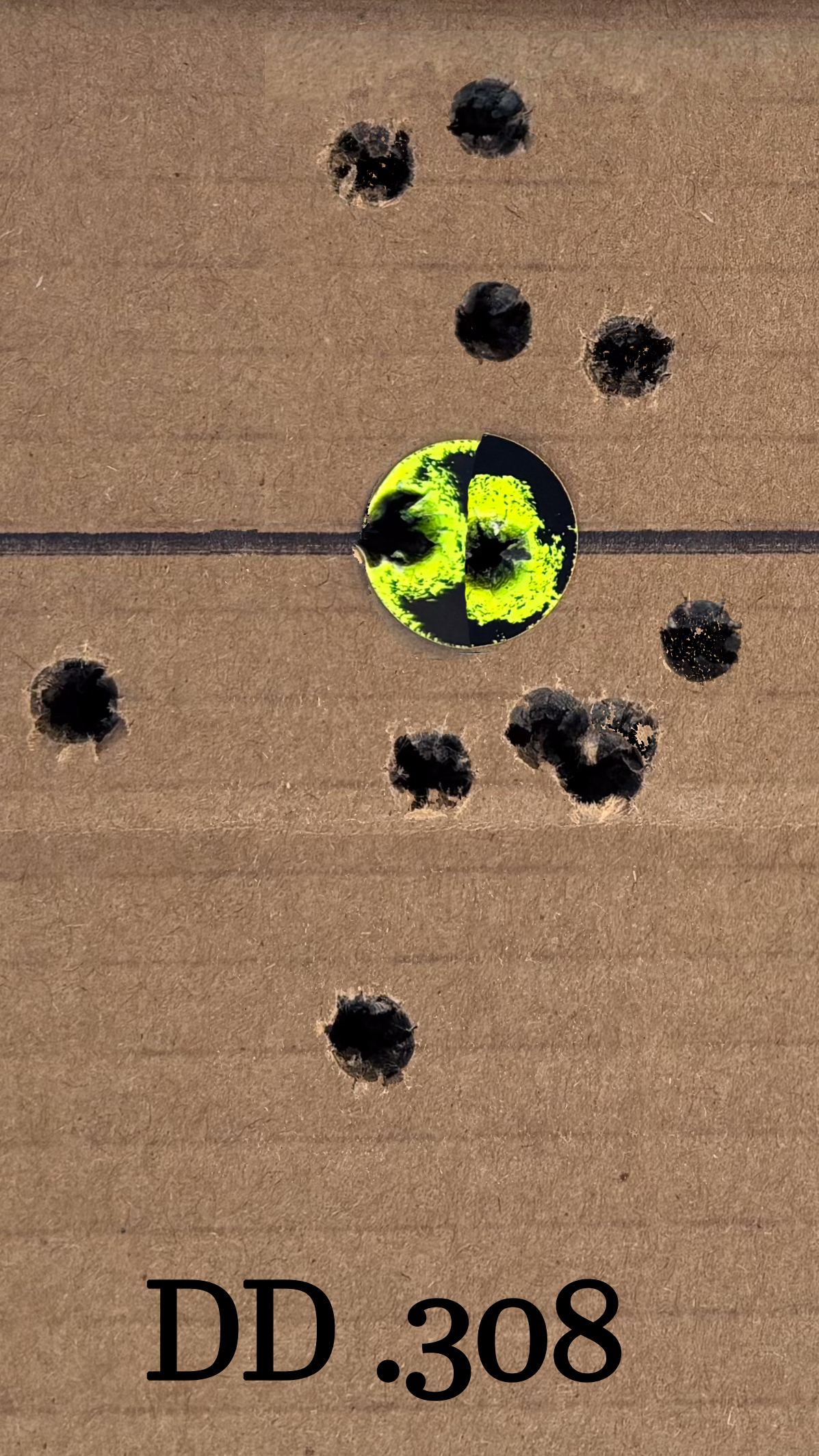

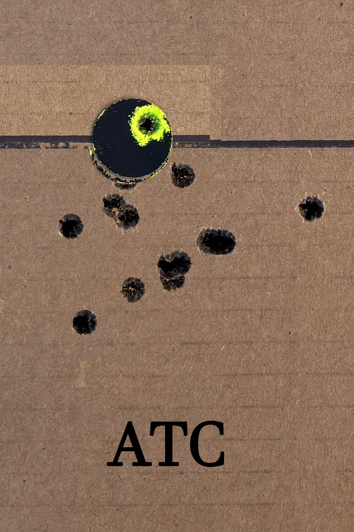

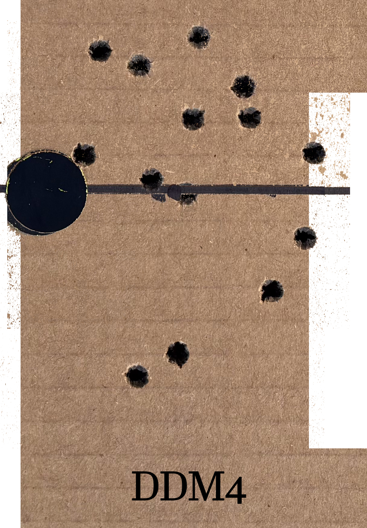

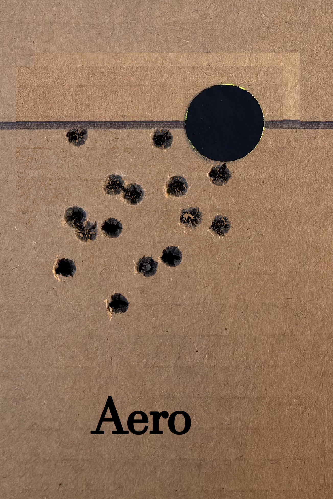

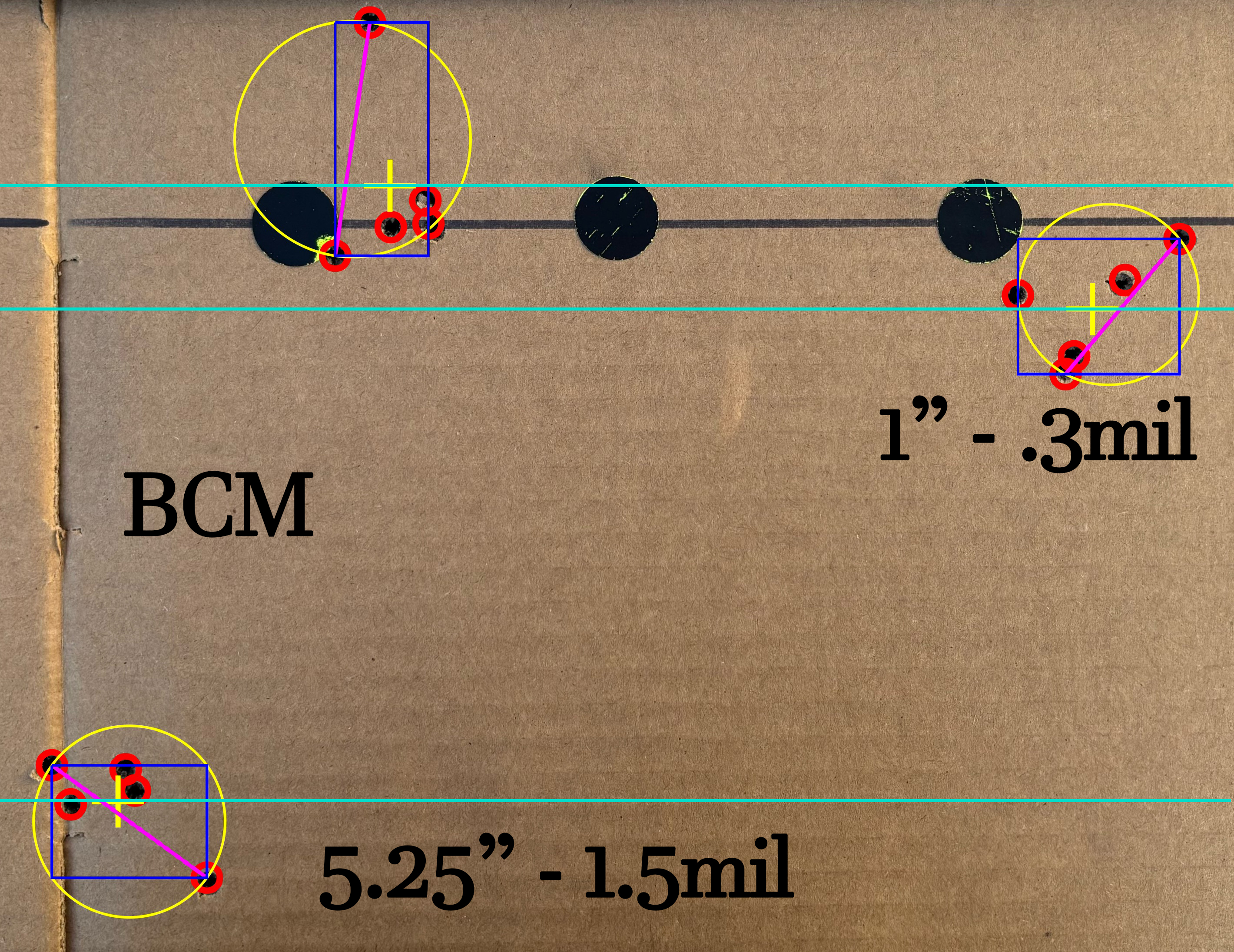

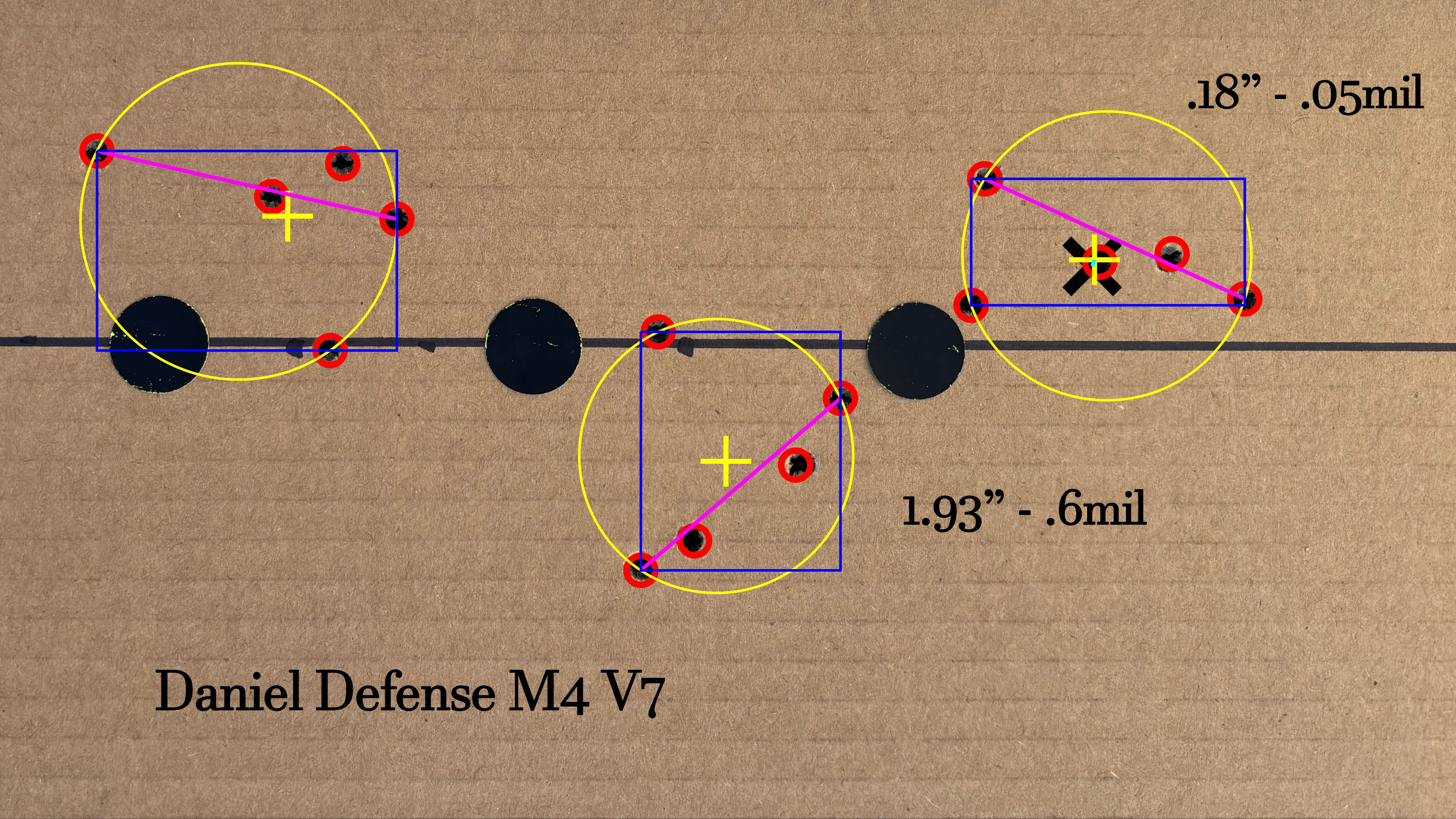

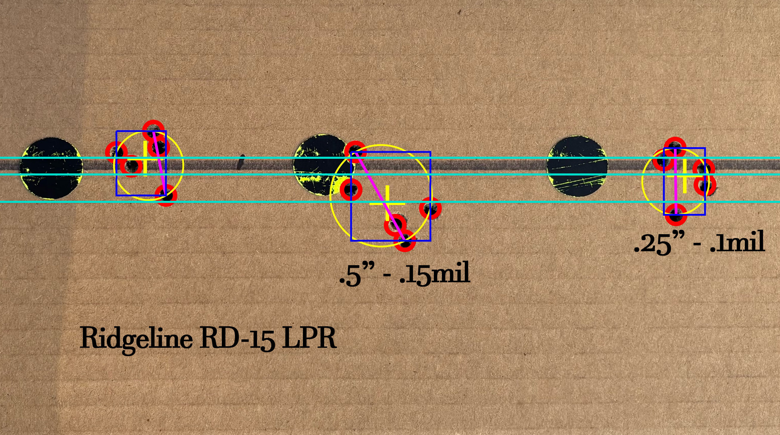

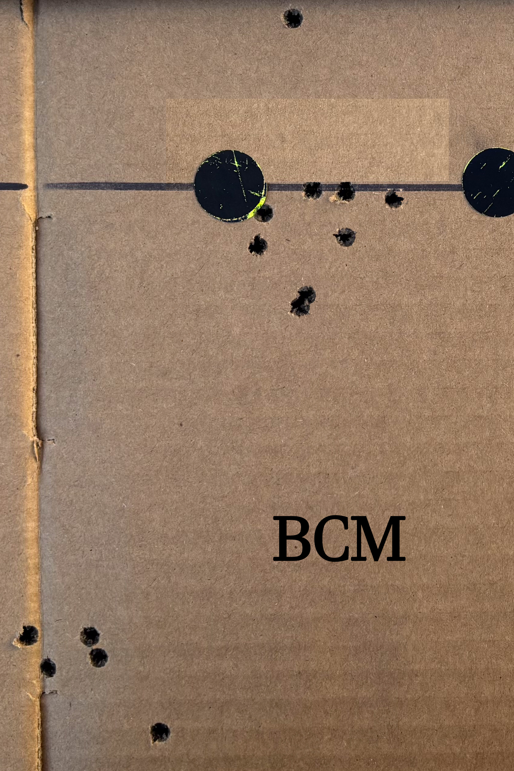

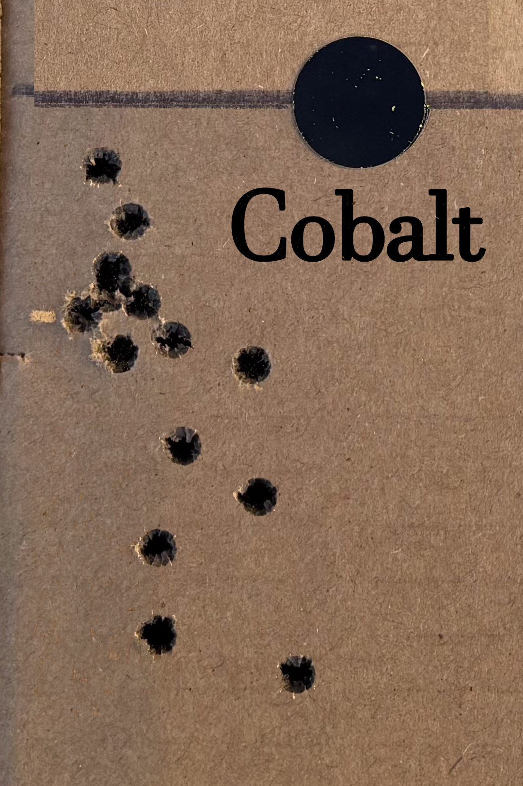

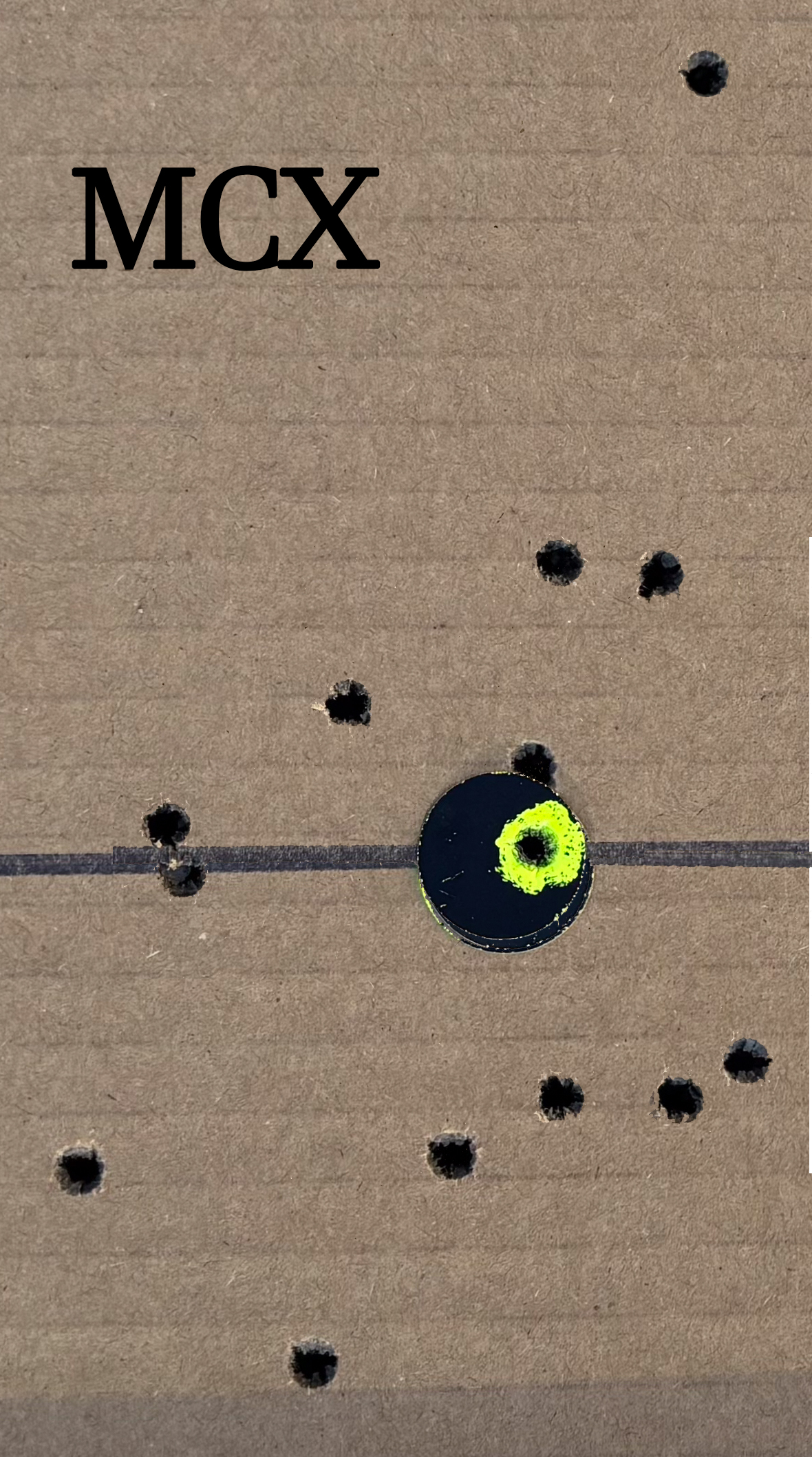

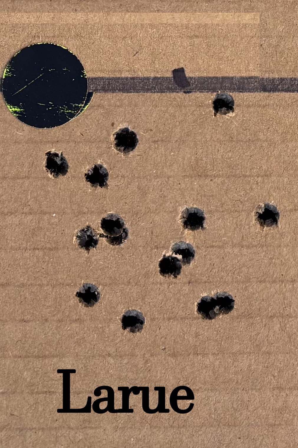

First dot is prone. Second is prone with a heavy pre-load on the bipod. Third dot is standing off a single bag on a barricade.
100y, 5 shots each except I think the DD .308 a couple were 4. I have a number of concerns regarding the validity of these results that I'll express a bit more in a video later so for now here are the results for your own consideration.
I'm dyslexic as hell and rounded the conversions so if I'm way off anywhere let me know so I can fix it.
The BCM was an 18" barrel in a standard BCM upper with a Geissele Mk18 ARCA rail.

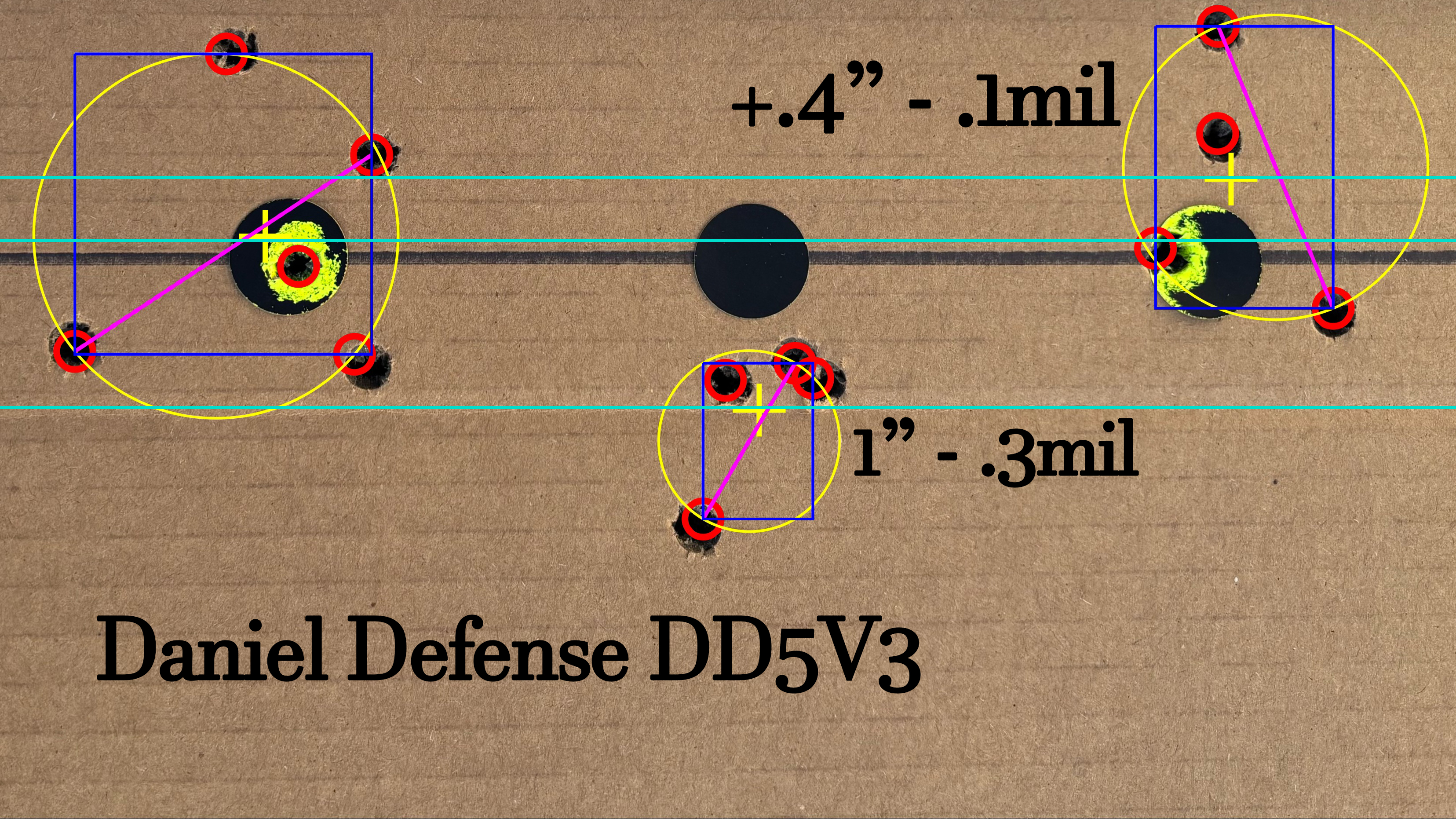

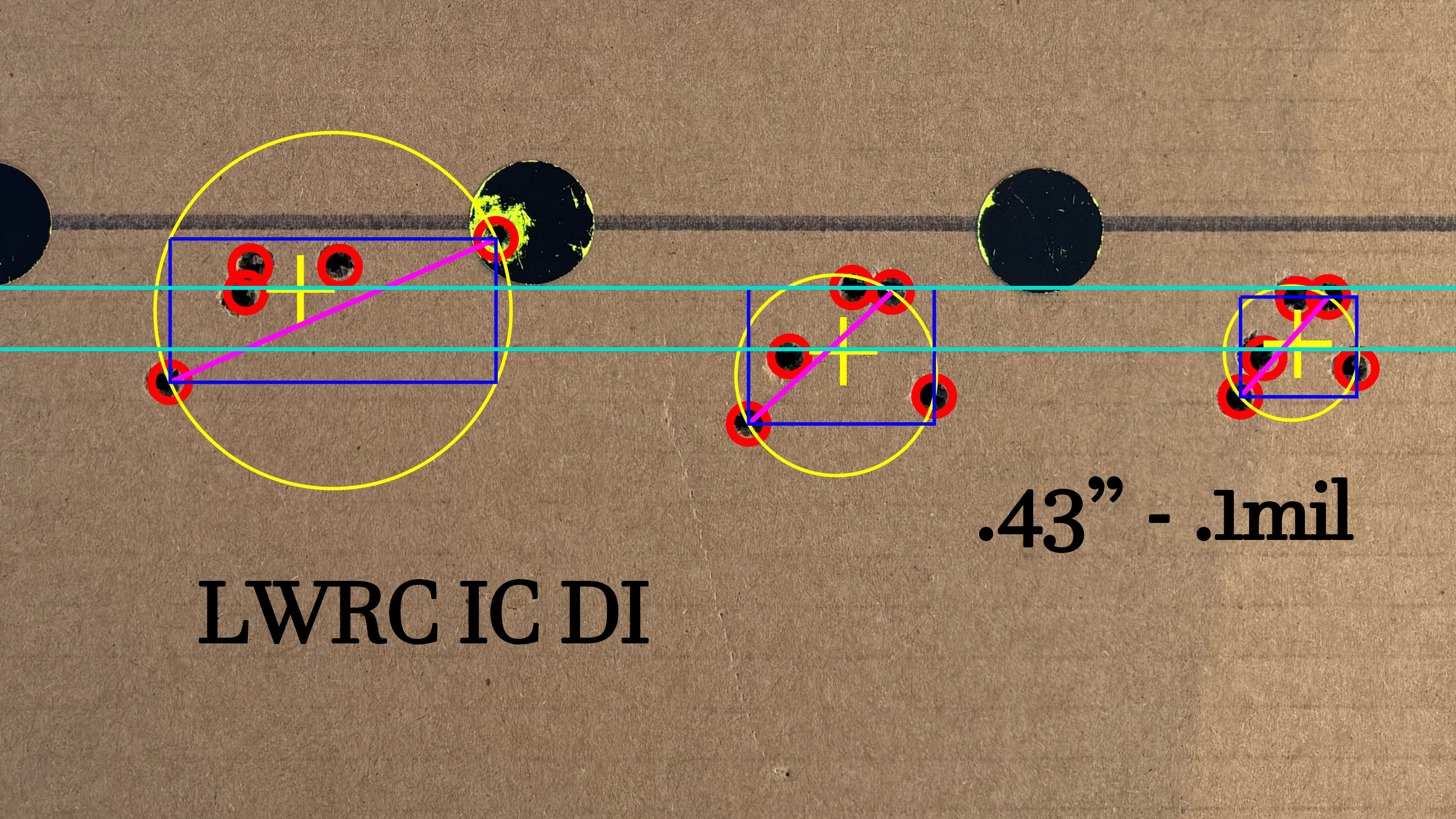

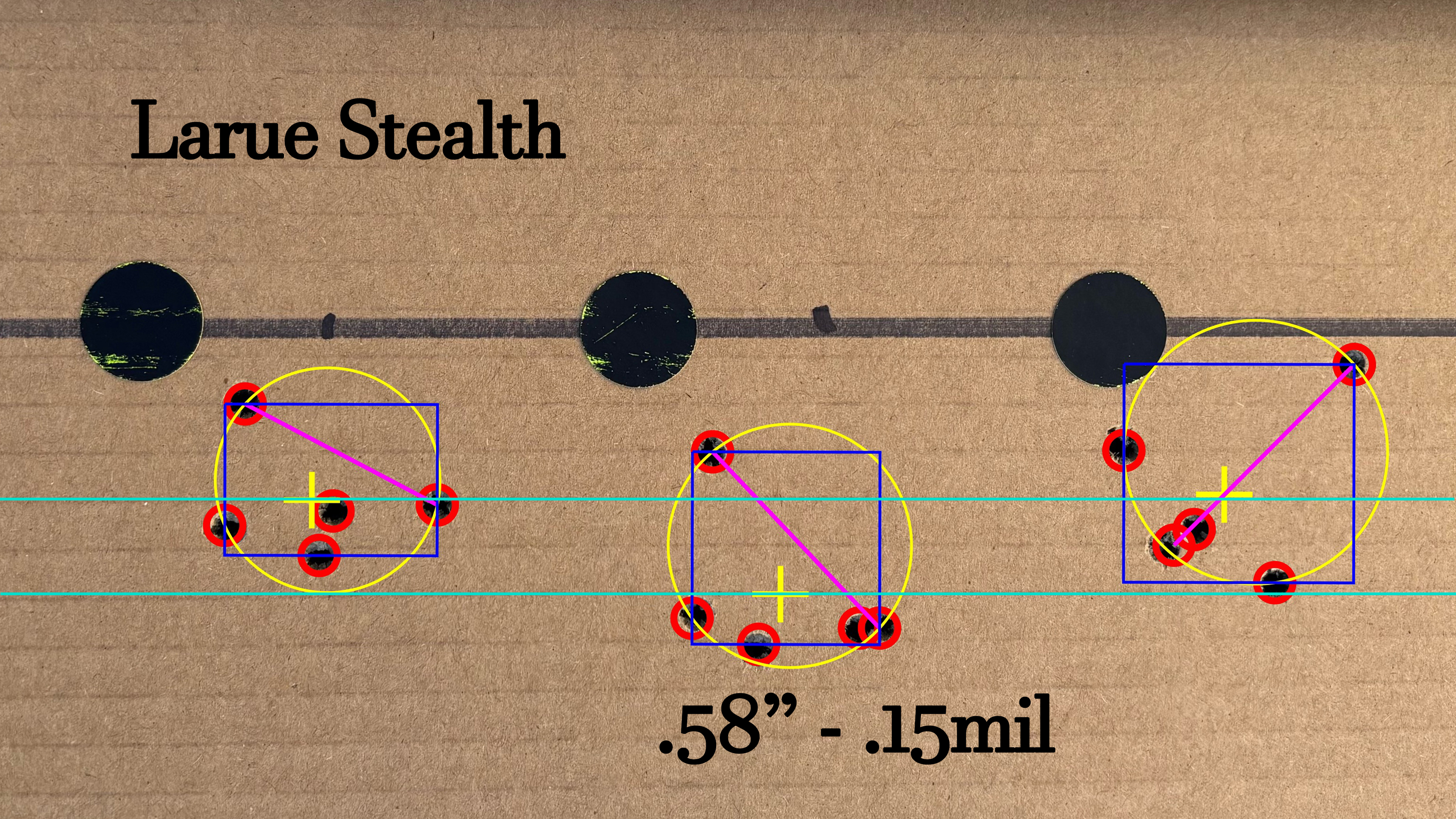

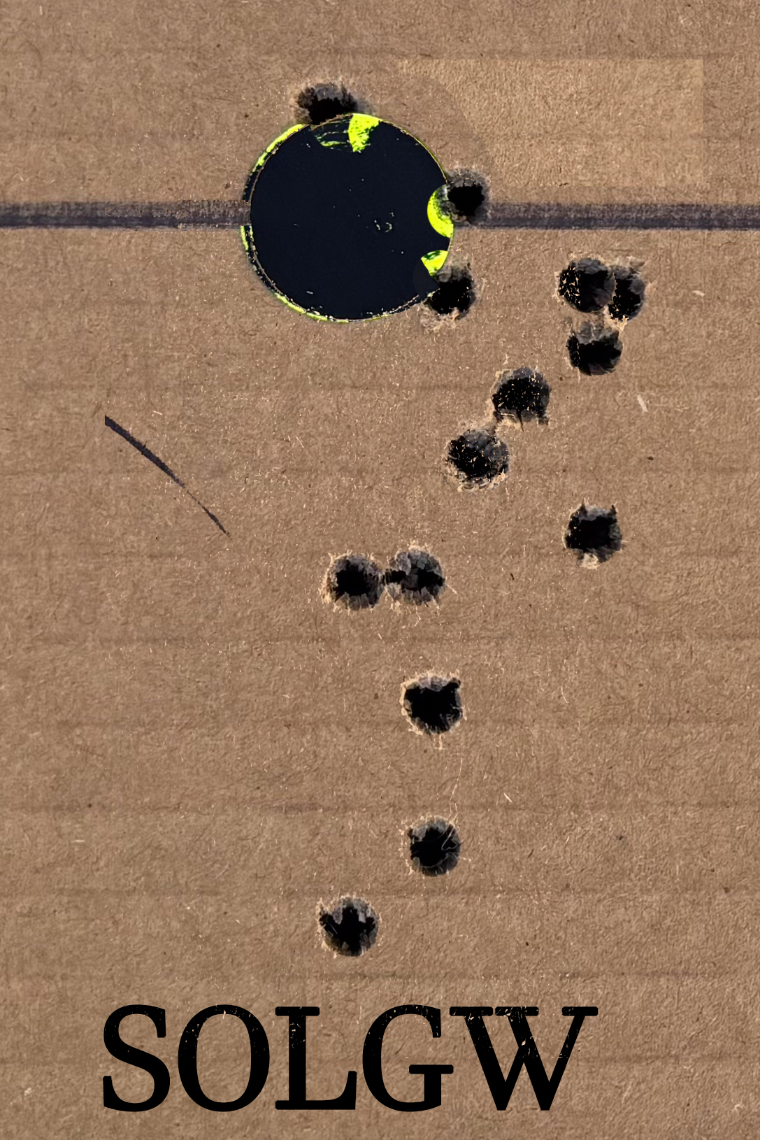

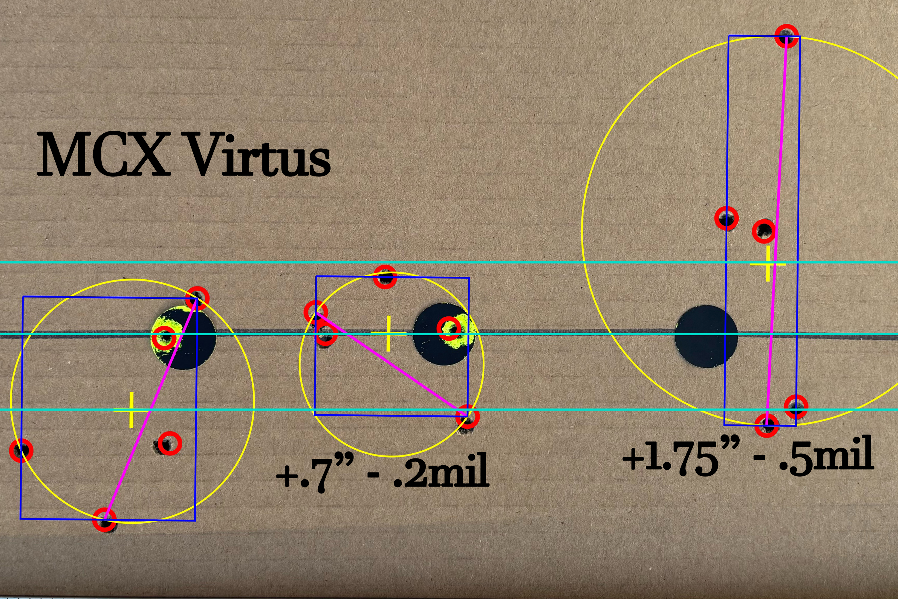

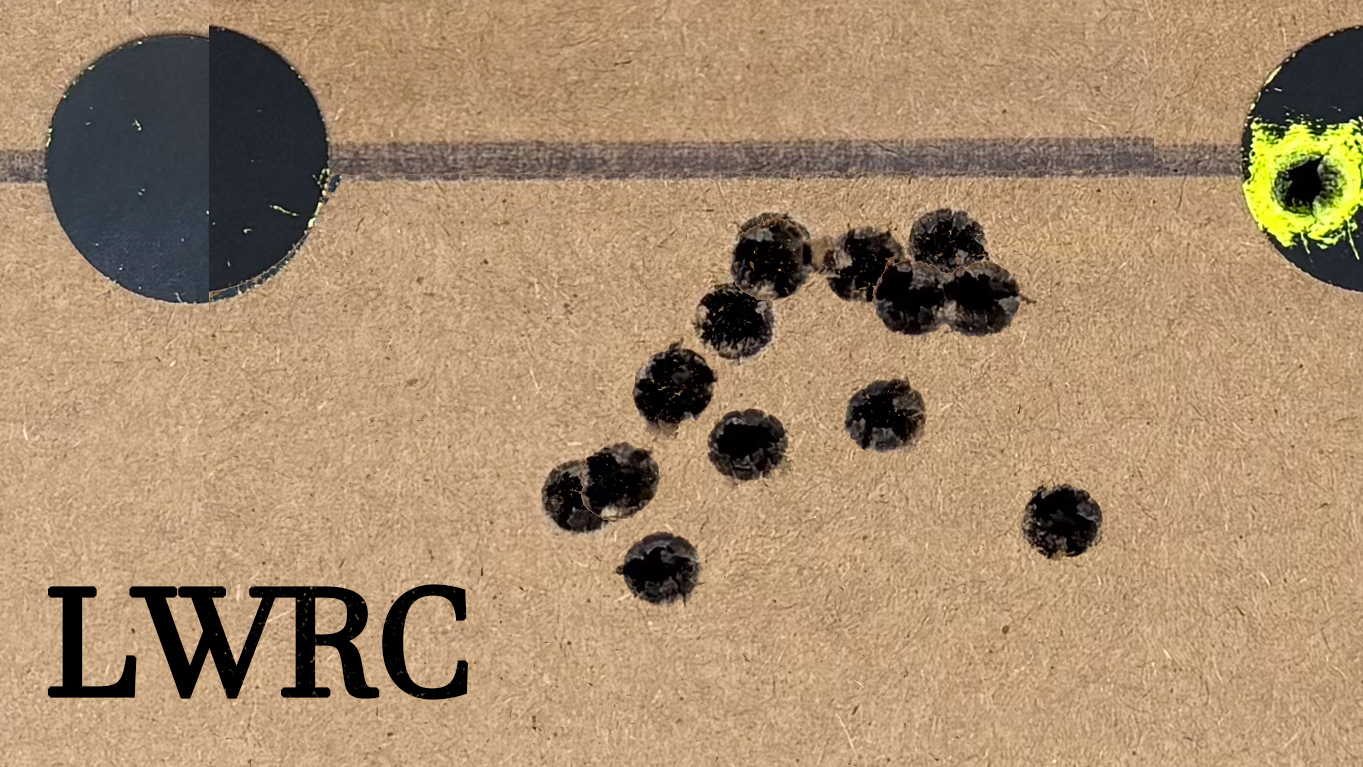

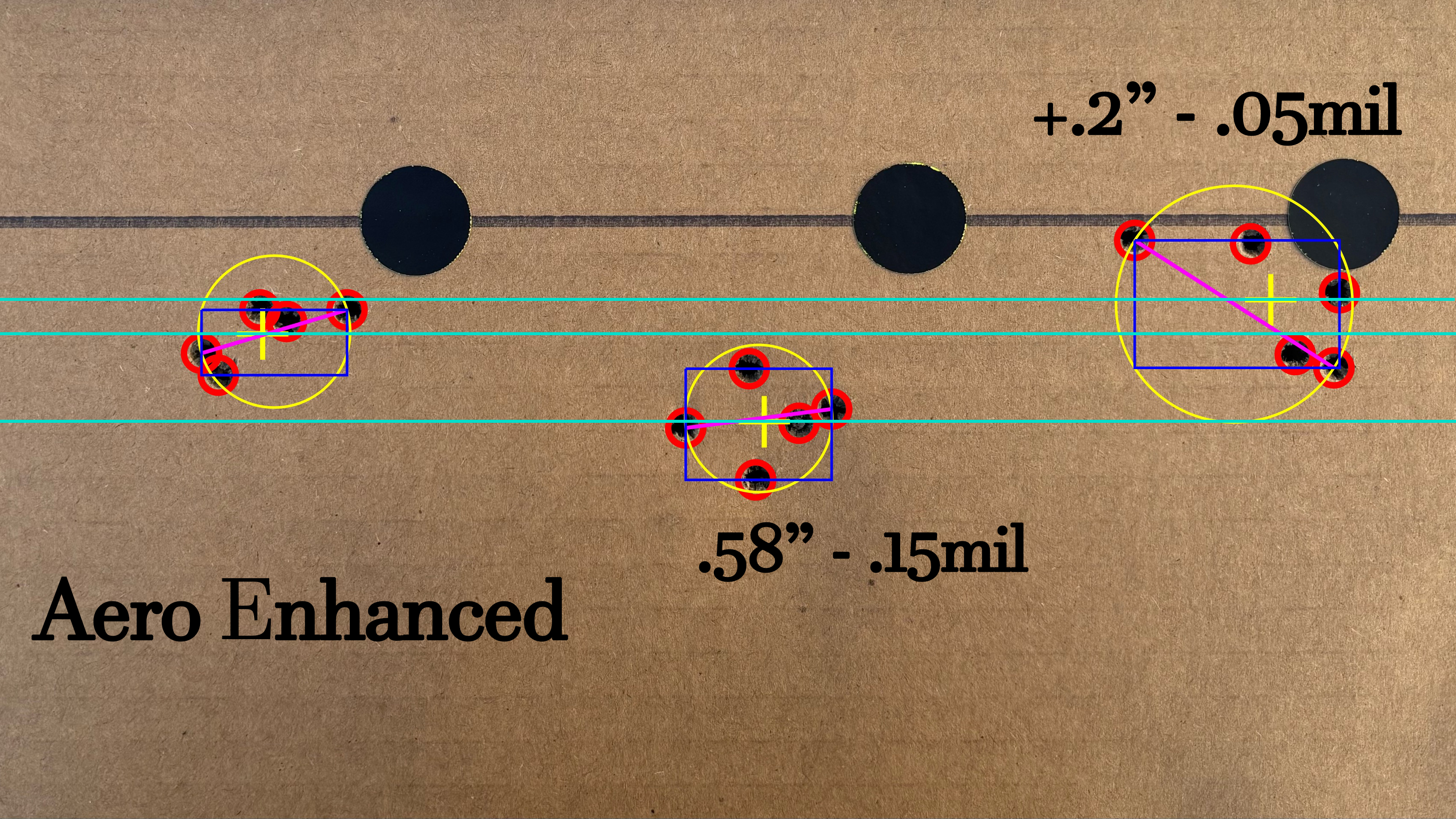

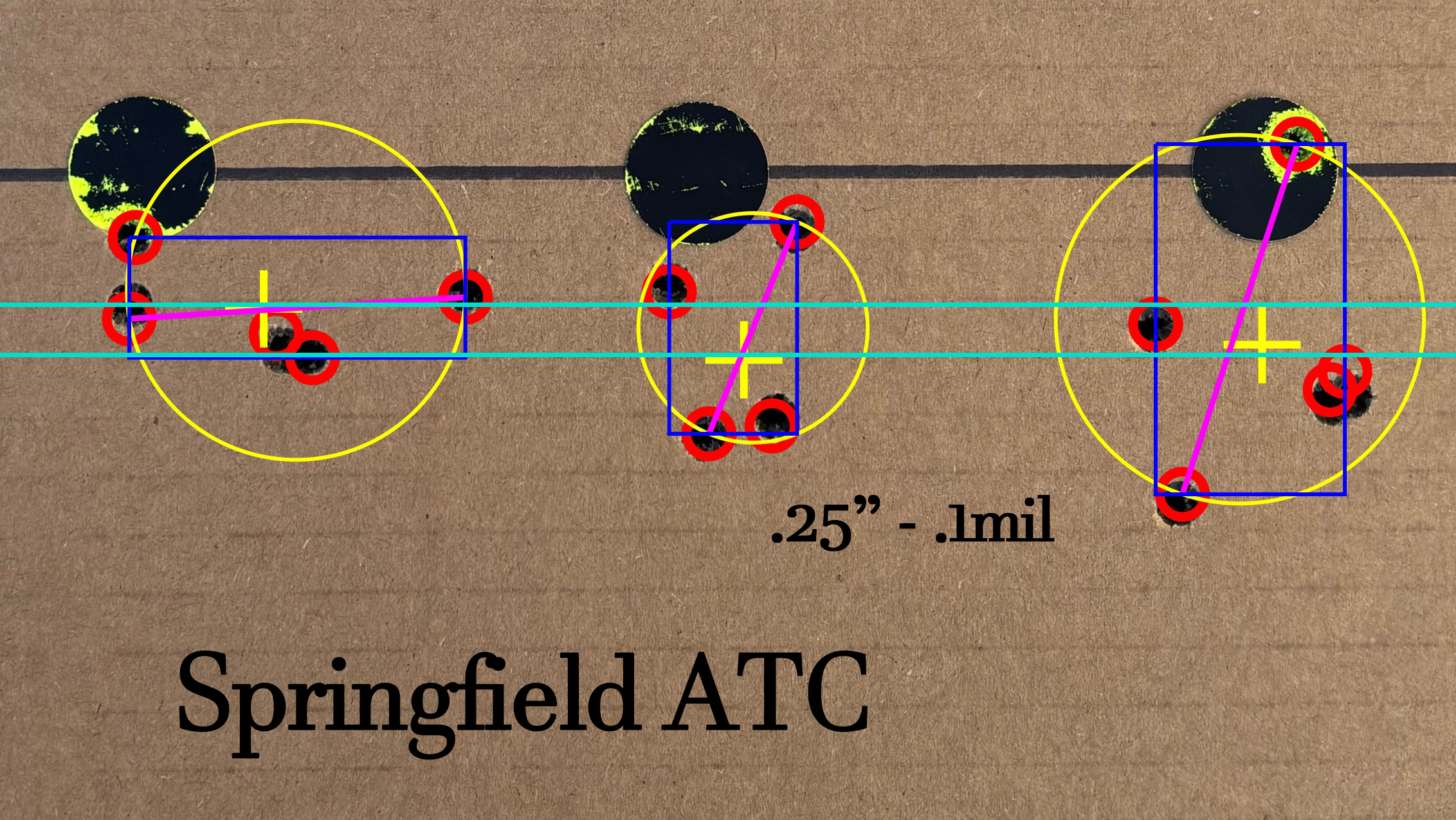

I tested the following for this yesterday:
DDM4V7
LPR
LMT MRP
Larue Stealth
Springfield ATC
Cobalt BAMF
SOLGW
DD5V3
Aero Enhanced
MCX Virtus
LWRC IC DI
and a normal BCM as a baseline
No major surprises. I’ll post the full write up here when I put the data together.
Was the Larue the original "Stealth" hand guard that can fit a conventional upper or the Stealth "2.0" proprietary billet upper+hand guard combo?

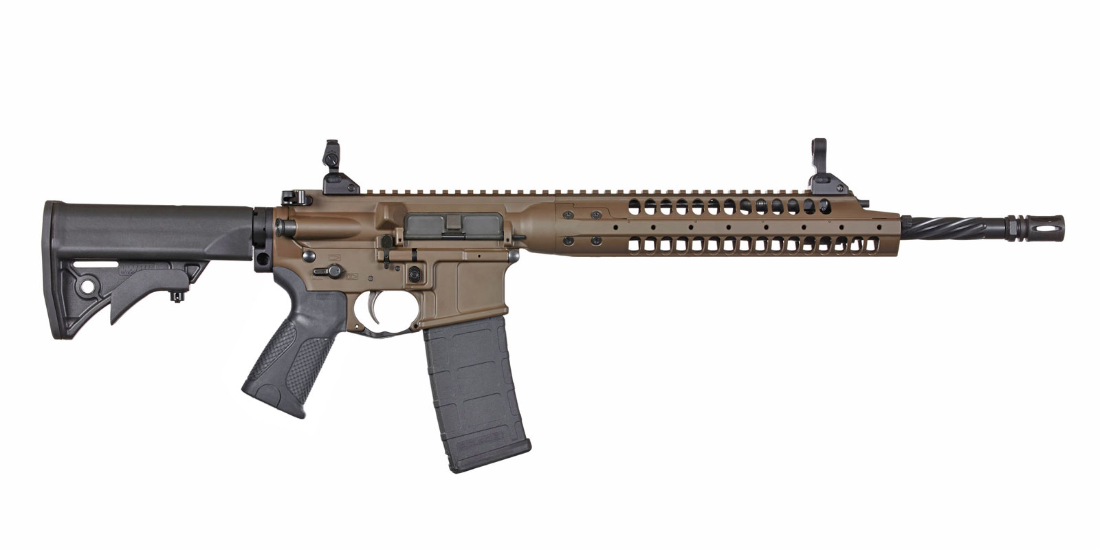

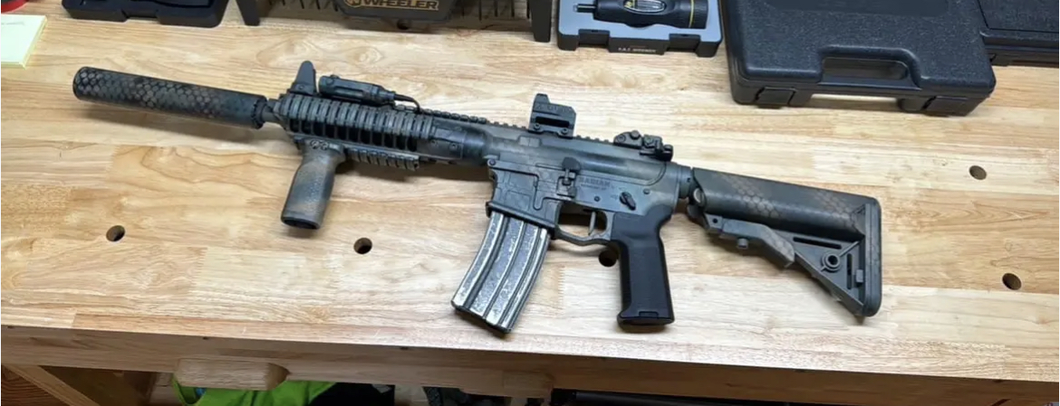

I've been really impressed with both of my LWRC DI's.
I bought them to be cheap ammo blasters but the 16" is very accurate, is Okay.. 1 MOA-ish.
I just had a custom Barrel nut Wrench made so I can swap barrels up to 1"
If anyone has ever used the LWRC Barrel nut Wrench you know that it is specifically contoured for the LWRC barrels only..
Thinking of swapping barrels in my 10.5" LWRC with a 11.5" 22 ARC
