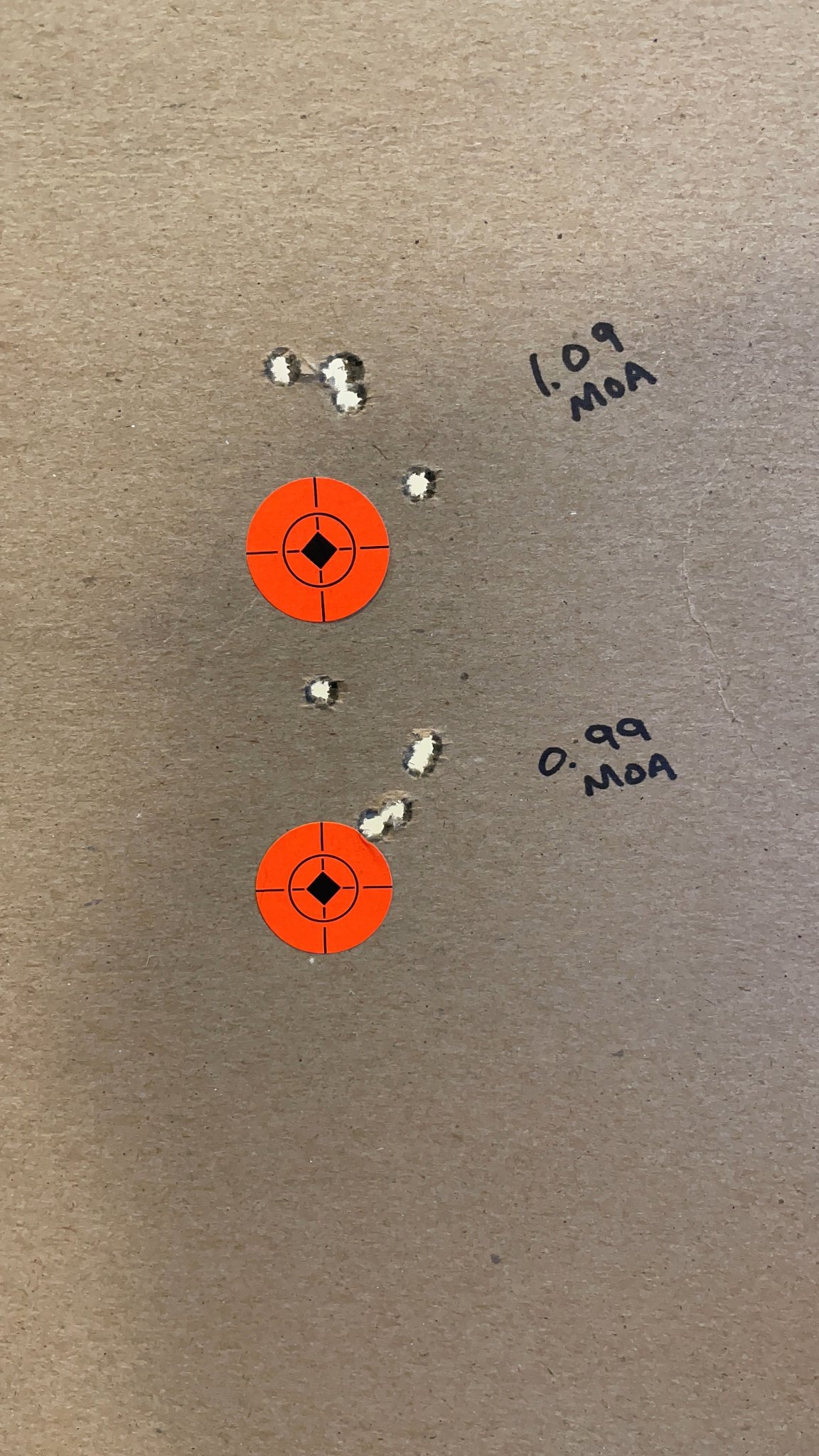

    I've been reloading for a while now, and have managed to put a load together for my 6.5 Creed (AR10, 18" Criterion barrel) that shoots 140 HPBT at 2589 fps with an ES of 25 and SD of 9.2. I've got multiple groups right at 1" at 100 yds with this rifle (same scope) so I think my technique is good. I am using the same process (different components obviously) to load for my 556. See attached photo on brown paper for 6.5 Creed groups.

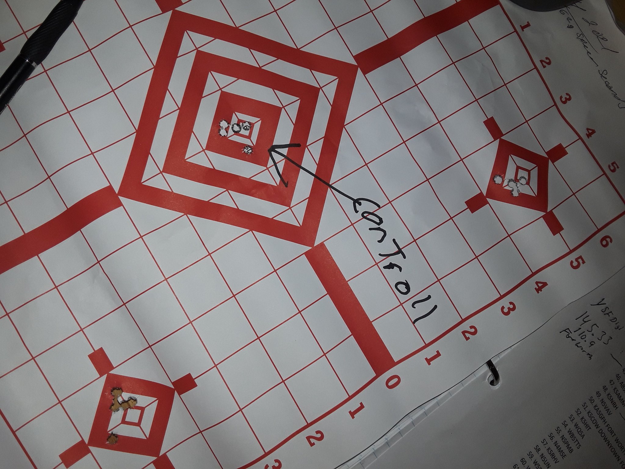

    I've done a ladder test with CCI 450 primers, RP brass, TAC and 77 SMKs. I loaded 0.2gr increments from 23.8gr to 24.8gr (max). Along the way I was able to find a couple good nodes for speed speed (ES of 35 to 50 fps and SD of 8.6 to 20). However, all groups were 2 MOA or larger. I have had similar results from factory ammo (match grade) and even sent the barrel back to Larue when it was still a 16" barrel and they sent it back with a target proving it was under 1 MOA.
    After dry firing a bit, I thought maybe my technique was off with the AR15 and somehow I'm shooting the 6.5 better than the 223. I loaded up 2 sets of loads today with the same components as above but I substituted 77gr Hornady HPBTs. I practiced dry fire until my reticle didn't move and then shot the 10 rounds I had loaded up with 25.6gr and 25.8gr of TAC. ES of 41 and 47 with SD of 15 and 16.8. See target attached on white paper. This group was at approximately 80 yards and is 1.66" (2.1 MOA).

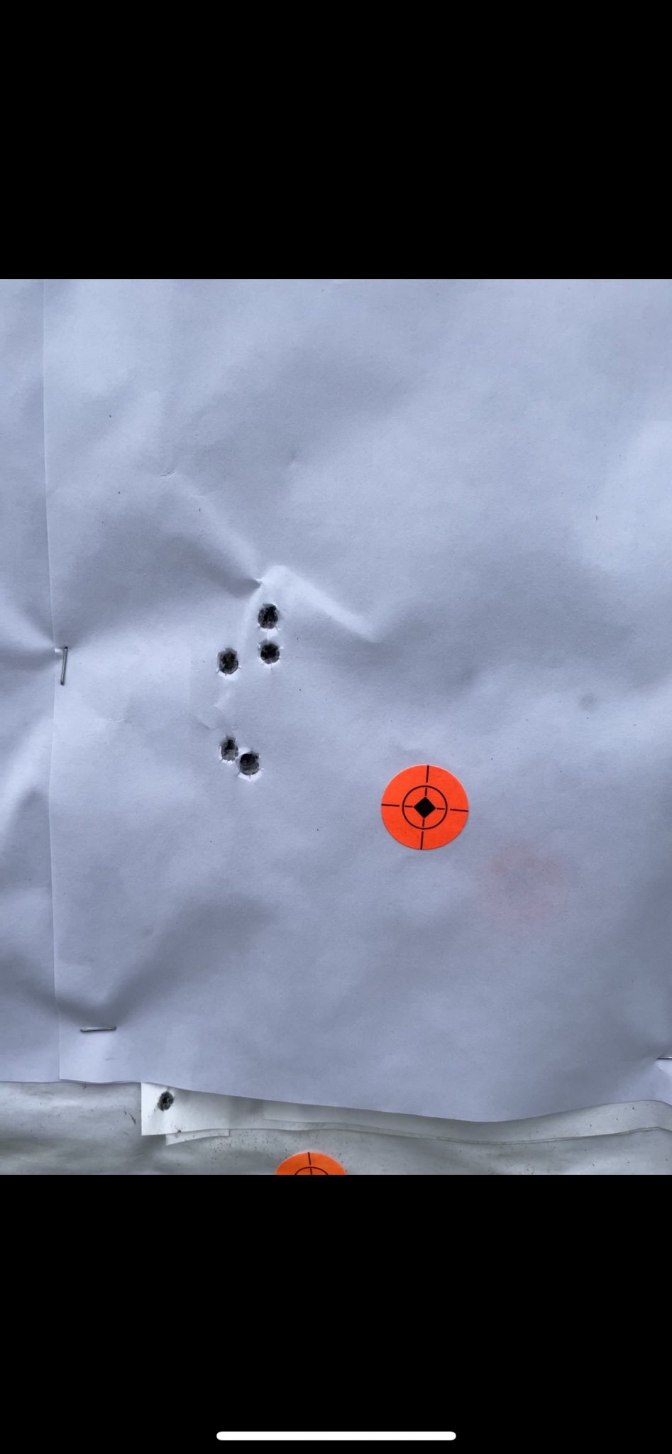

    As you can see in both pictures, I will sometimes get a group with two pairs almost touching and a fifth somewhere on its own. This leads me to believe I may have a technique issue, but I'm not sure what else I can do to lock things down.
    The fact that I haven't found a good factory or hand load leads me to believe I may have a 1.5 to 2 MOA barrel. I could try a different powder, but I've got so much TAC that I would probably be better off buying a different barrel as I was hoping to load about 1,500 rounds of the SMK / TAC combo. I'm very close to having Compass Lake spin up a 13.9" Criterion and have them install / headspace it to this upper and be done with it but want to make sure I'm not missing something before I spend that money.

    I don’t do a lot of gas gun shooting but if I had a bolt gun doing that I would blame it on technique. You, or sometching you are doing is changing between your small three shot groups and your suddenly bigger 4th or 5th shot.
    That appears to be an issue on both the brown and the white paper targets above.

    As for the groups, I actually end up with shots 1 & 2 almost touching and then 3 & 4 almost touching. I hardly see a good 3 shot group open up due to the last 2 shots.
