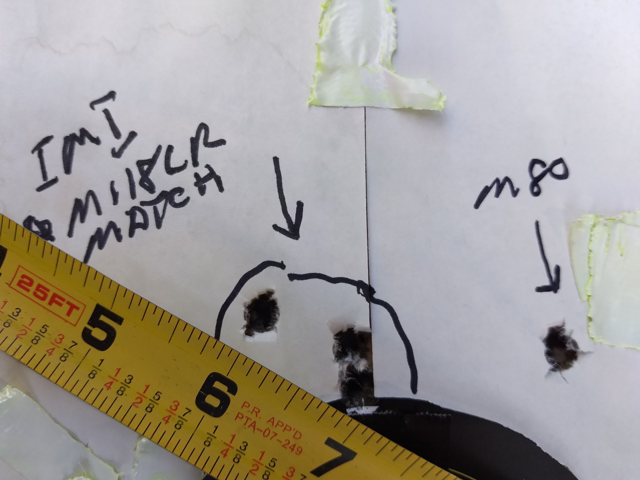

I'm not trying to spoil your success, because it looks like you are having some. But, here's how my stock-out-of-the-box M1A National Match iron sight gun shoots M118LR. This is shooting from the shoulder off of one pack at 100 yds:
Because it is shady and dim where I shoot, I have to shoot at a 4" black circle to even see it through those National Match sights. It's hitting where I want it to hit: about 2 MOA high. This gun will shoot Lake City and IMI about the same. The M80 round was the first one out of the magazine. That's where it usually goes. The far left hit was number 2, and the stacked hits were 3 and 4. There were 6 more rounds left in the magazine. Would that gun shoot tighter than this from a vice or sled? You bet it would. But, the events I shoot require shoulder firing.
