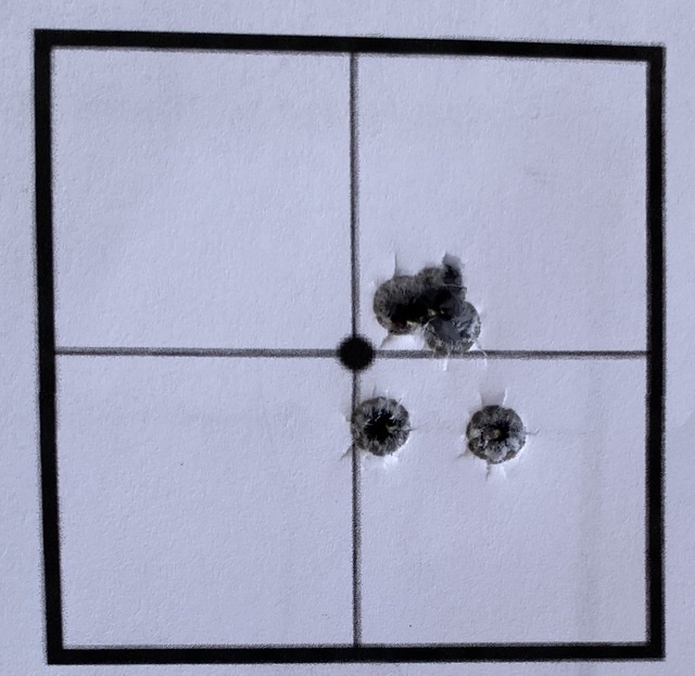

There was nothing wrong w the rifle. No loose parts, or bad scope, or brake... just a bad barrel on its way back to the manufacturer. Same rifle, same ammo, but a new White Oak Armament barrel... Amazing !! Consistently 3/4 - 1/2 MOA !!
sweet...glad you got it sorted out and I’ll remember both of those barrel manufacturers names

There would be other things to consider if you were getting 1-1.5 moa and wanted to improve it, but at 2+ moa I bet you've got a bad barrel. White Oak, Rainier Ultramatch, and Compass Lake are all good choices to consider IMO.
This ^^^^^^^^^^ BA barrels are hit or miss; some shoot groups, some shoot patterns & there will be none of them in any of my guns ever again.

The WOA is an amazing barrel, 1/2 to 3/4 MOA w/ IMI.
The BA it's on its way back, hopefully they'll send me a shooter one. Hell, today I shot consistent 1.5-2 MOA groups w/ a factory Colt 6920 w/ an ACOG at 100 yds w/ crapy reloads.
