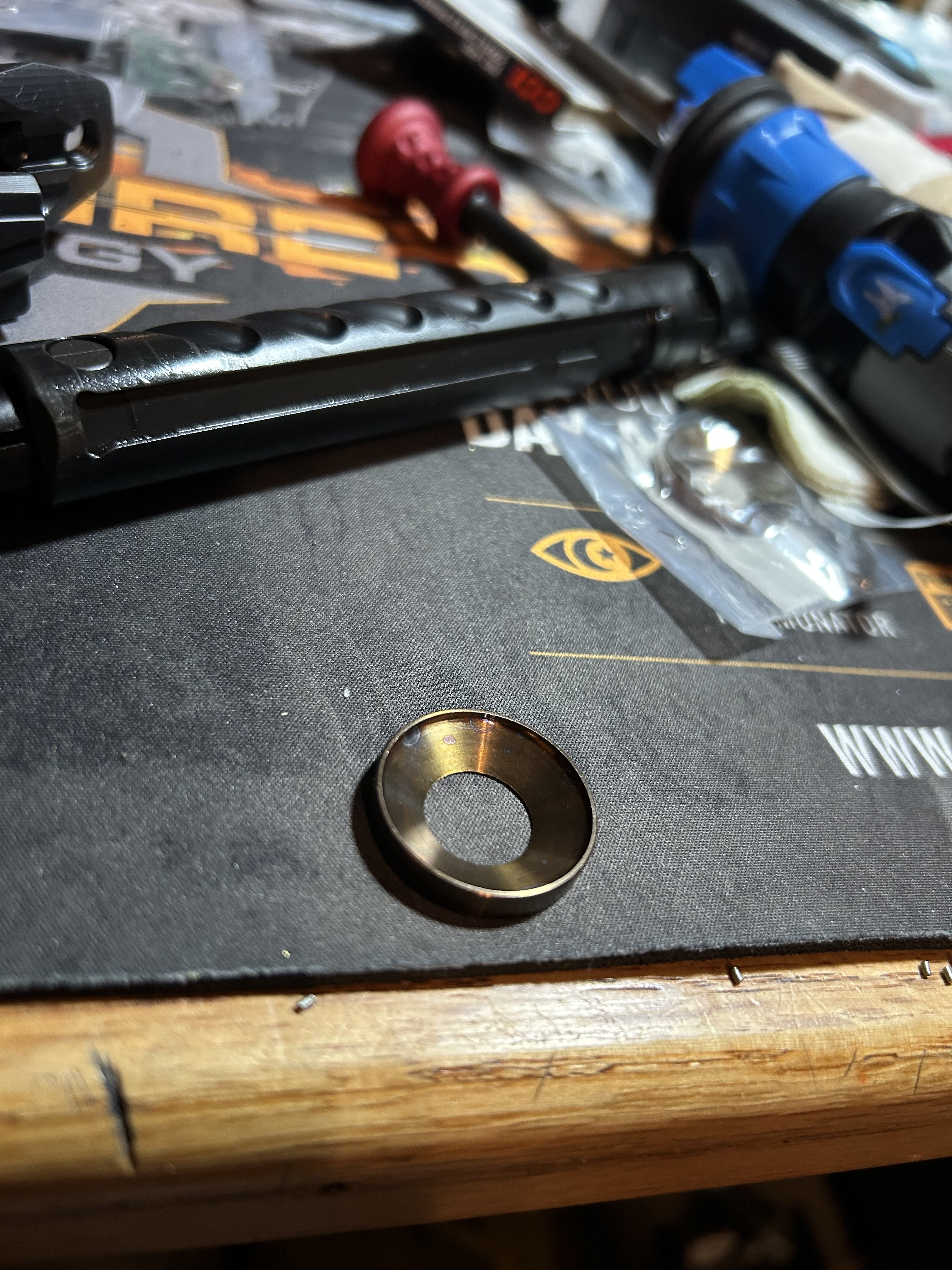

New Coup De Grace owner here. I’ve not seen any photos or discussion of the conical breech adapters for flat faced barrels, but I just got mine in last night.
Torqued my original 6.5cm Mausingfield shouldered barrel on to the Coup action, with adapter in place, and all seems to headspace just fine. I’ll be seeing how she runs this weekend, but wanted to post up the adapter pics.

Do you have clearance between the extractor and the conical adapter? This is the first time I've seen this.
Me too.

They're $30 on ARC's sight. I just saw them last week & was curious what it looked like.
@personalbest - Thanks for posting and let us know how it works. Please confirm this adapter just locates off shoulder in action & then barrel pins it in place once torqued?

Yes. Just have to wobble it down(it fits snug inside the threads)to the shoulder inside the action to make sure it’s “seated”. Then the shouldered barrel(mine is 6.5cm) spins up and torques like normal. Adapter washer is pinned tight as far as I can tell.

Took the 6.5 creed to the Range this weekend, and had no problems using the Mausingfield shouldered prefit barrel on my Coup De Grace action, implementing the conical breech adapter. Headspaced with go/no go gauges perfectly, and held sub moa accuracy out to 1000 yards. I'm super pleased with the results, as this will let me purchase prefit criterions and shilens(barrel nut type) without having to wait for shouldered barrels(at a higher price). I'll eventually spin on my 223 barrel with conical adapter, just to try, but believe it will probably work just fine, as it's working fine on my Mausingfield action. I'd say buy with confidence.

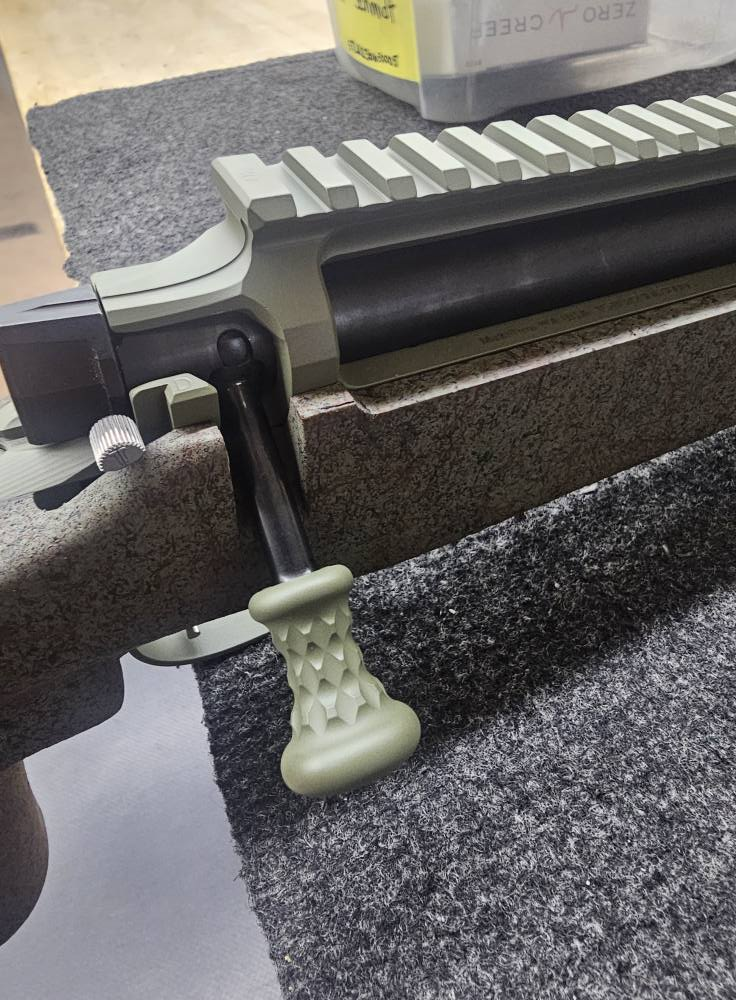

Anyone with a non-pivoting bolt handle noticing excess slop/play in the fit of the handle to the bolt? I've got 250-300 rounds on my new Coup De Grace action, and noticed today that the bolt handle has got excess forward and aft rock inside the bolt. I sent ARC a video, but curious if I'm the only one experiencing this.
BTHOM. I would not call mine excessive, but then again, I have not shot it much since I switched to the fixed handle. Maybe 50 rounds.

I guess the question in my mind is how they are secured in place? If the barrel is screwed down to headspace against a chamber gauge, the barrel nut tightened - which should pull forward slightly - does the spacer/adapter just rattle around in between the bolt face and the flat breech of the barrel? Or is it a close enough fit radially that it doesn't matter?
Gotcha. I picked up a CDG this summer, and should be picking it up from the gunsmith today from having a barrel fitted. But like @AllenOne1 I have a number of Savage pattern barrels from my Origin(s) that I'd like to be able to use on the CDG.
I have the same question but don't have an answer yet. The adapter is very nicely machined so the fit should be good but I do wonder if it will move a little bit and if that even matters.
