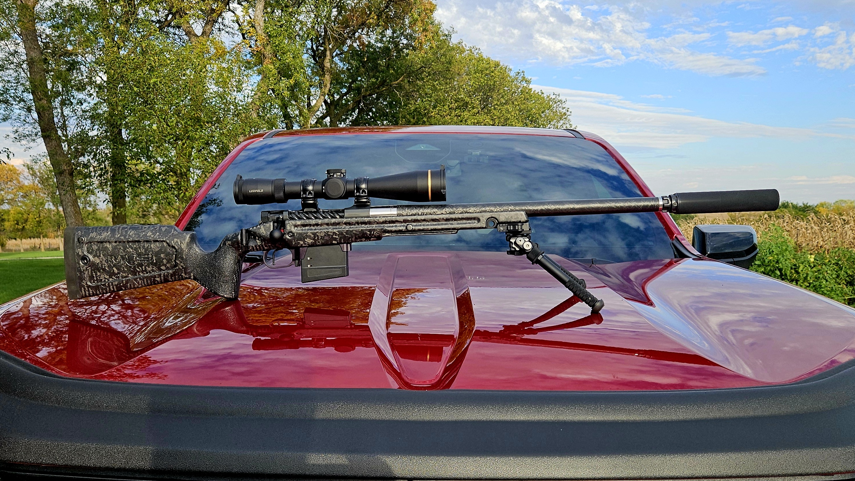

ARC Coup de Grace Builds

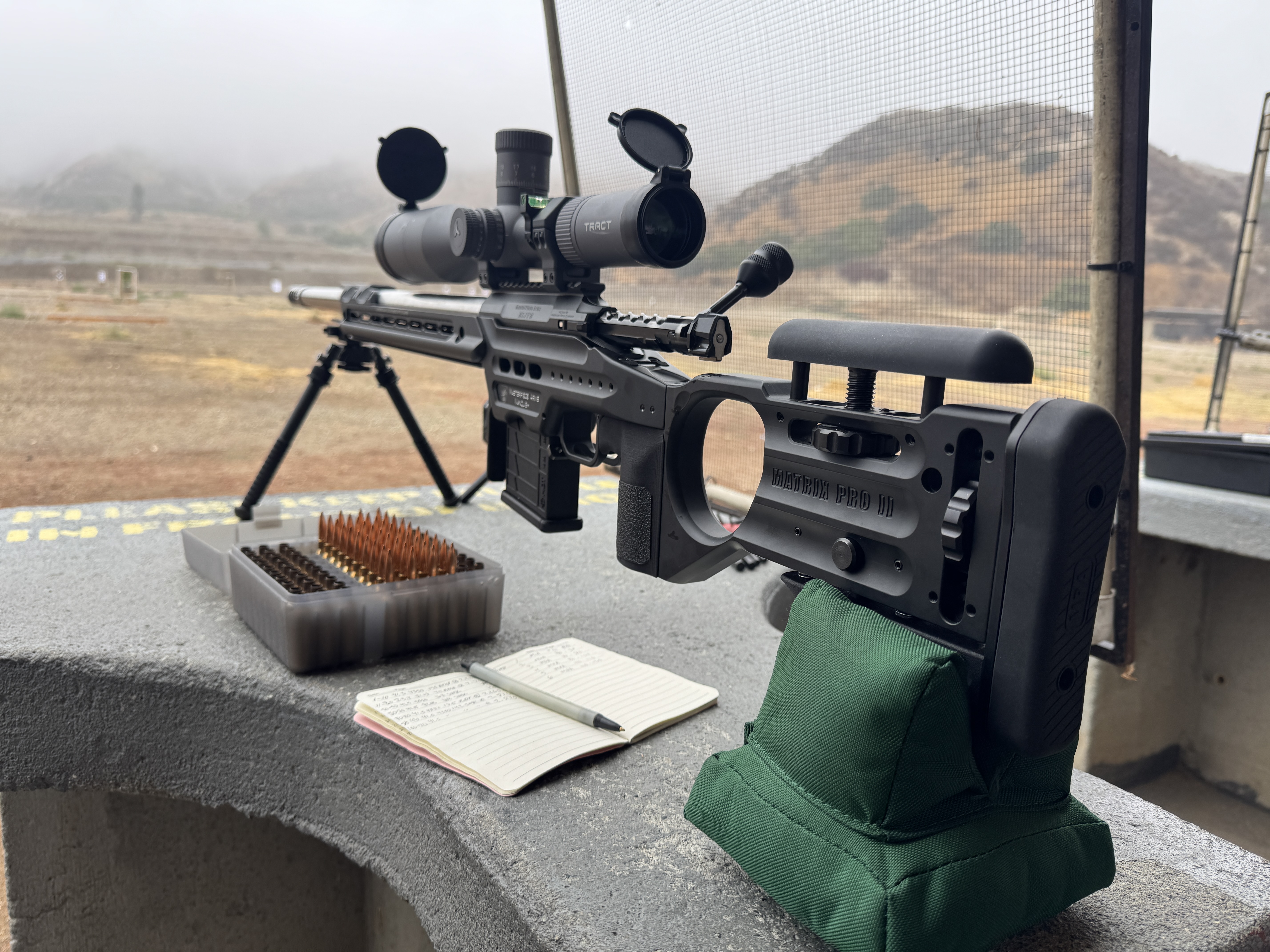

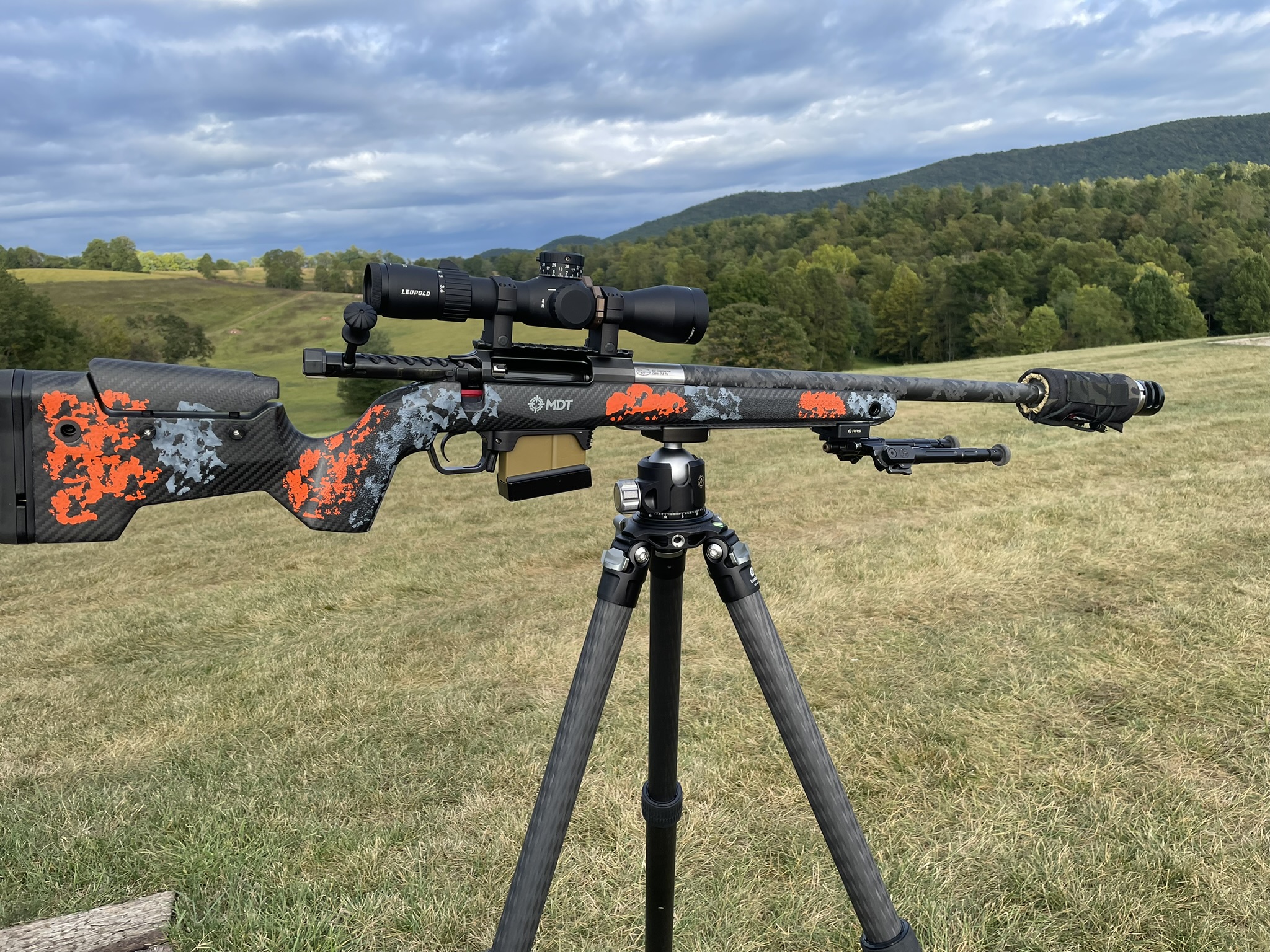

May as well throw this one in here.
22" 6.5C carbon by @bohem
MDT CRBN
SiCo Scythe Ti w/ RecoilX @Patty brake
TBAC bipod
MK5 3.6-18 in MK4 rings
14 rd. AW mag
Tips the scale at 11 lbs. 9 oz.

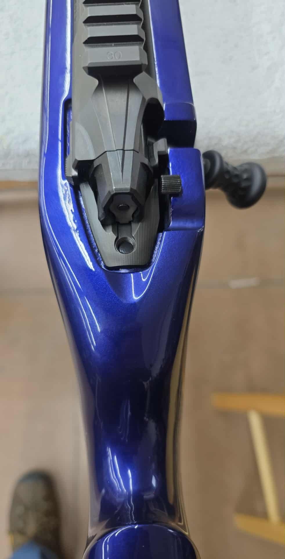

This is a fantastic rifle build. Do you know if the MDT VERTICAL ADJUSTMENT BUTTPAD is compatible with this chassis? I think having that vertical adjustability would be nice. I am still trying to select a chassis for my rifle build. Did you have to modify the chassis for the action to fit properly?
Reactions: kindabitey
No idea about the butted.
I’ll have to admit I initially panicked about fitting. The adjustment screw for the trigger hanger was hitting a “cross bar”. After getting everything the trigger installed and adjusted it dropped right in.
