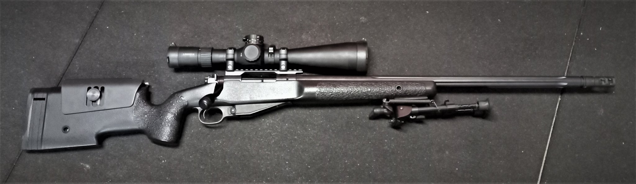

Seeing all the recent activity on this thread made me decide to get some range time in with my SPR. I forgot how much I like this gun.
FN SPR A5M XP 24" barrel
TBM Kit
Surefire SOCOM 7.62 Brake
Leupold Mark 5 5-25x56 scope with CCH reticle
Leupold Mark 4 Scope Rings
Flatline OPS Bubble Level
Harris 6-9 BRMS with KMW Pod Lock
Easily one of my most favourite rifles but I found it to be very picky with Projectiles.
All ELDM's shoot really well out of it but Berger and Optimus bullets didn't.
It has a long throat which doesn't help but I have it sorted now and it's a hammer.
Settled on 168gr ELD-Ms at 2730fps. I've had it to 800m but no further.
Only dramas I have with it are the FN Mags.
The rounds are "loose" in the magazine compared to Tikka and AI mags - this means they rattle and can actually shift in the mags which can cause feeding issues. Other than that, to me this is pretty much the perfect precision rifle.

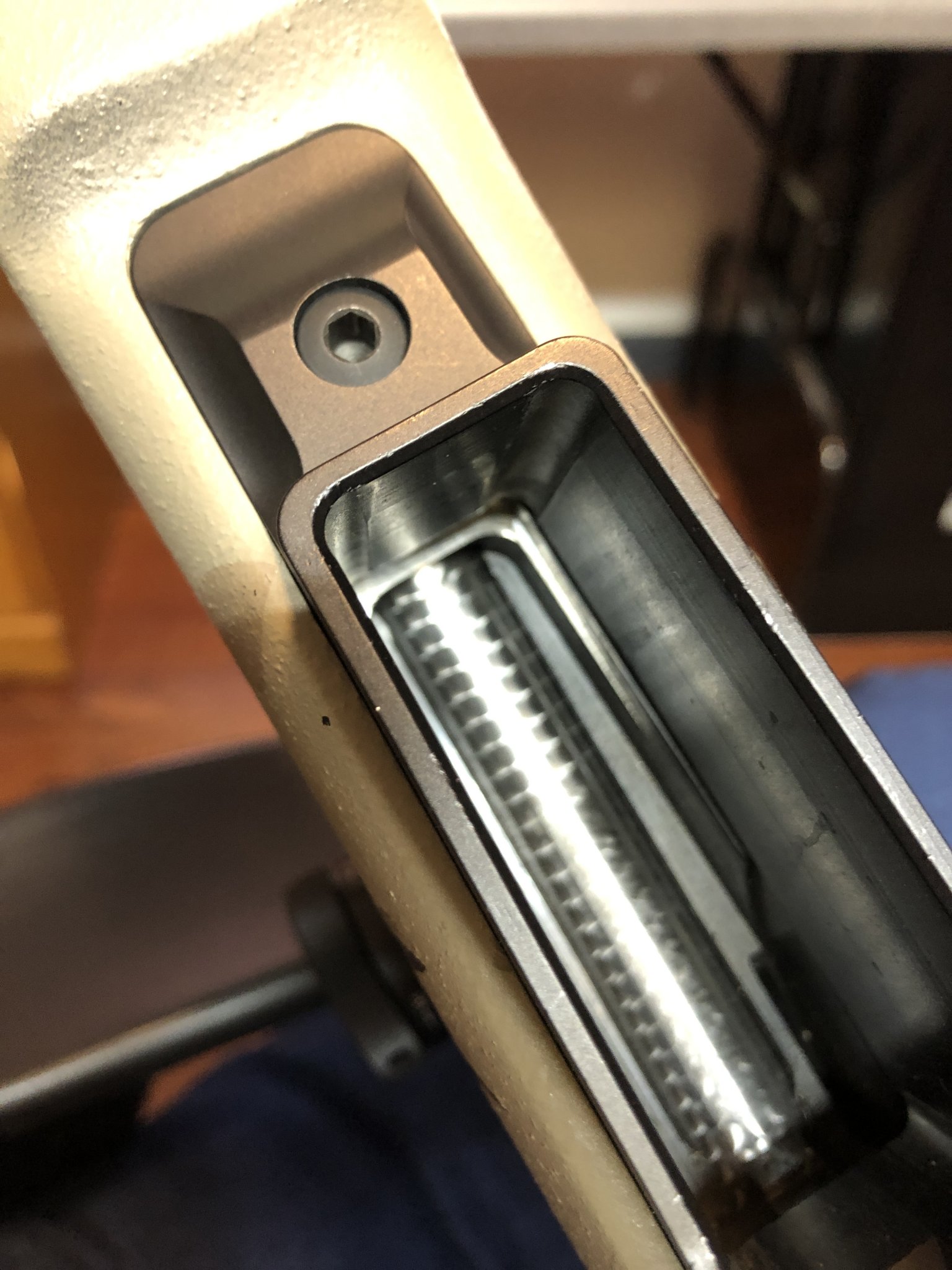

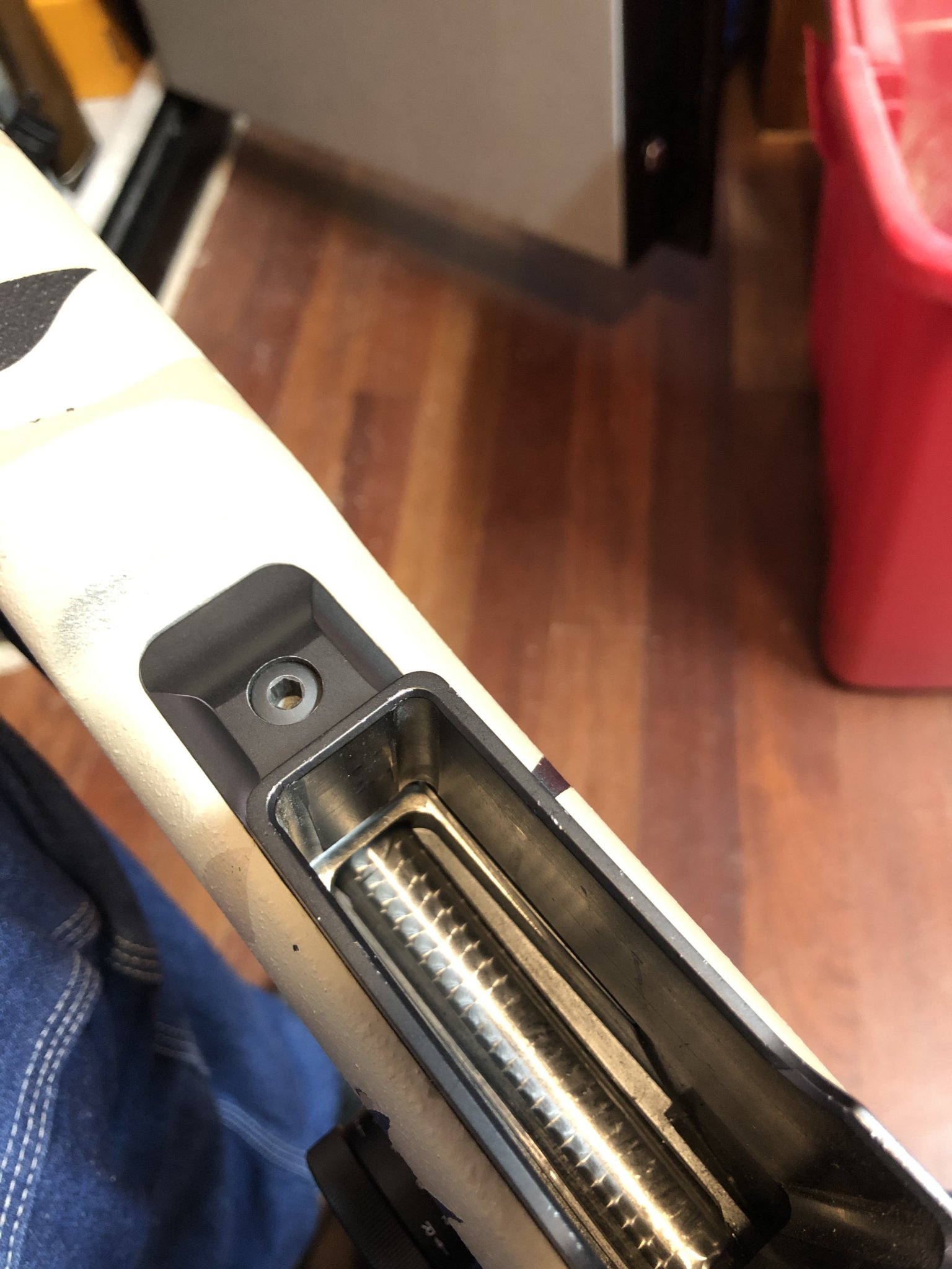

Anybody know which of these two bottom metals works with AICS style mags?
The first one linked above has a disclaimer at the bottom saying it comes with one of their mags and only that mag works. Any other AI mag will not work. That is kinda weird.
The second one doesn't mention any of that.
I know some of you guys here run a PTG bottom metal with AICS mags. Can you guys check which one it more closely resembles?
Thanks
@stello1001
I have the 2nd one listed in your post, which is the big mouth.
It runs flawless with standard AICS mags.
Although mine is on a G prefix Win 70.
Also the receiver was milled when I ran the CDI bottom metal prior to the PTG.
