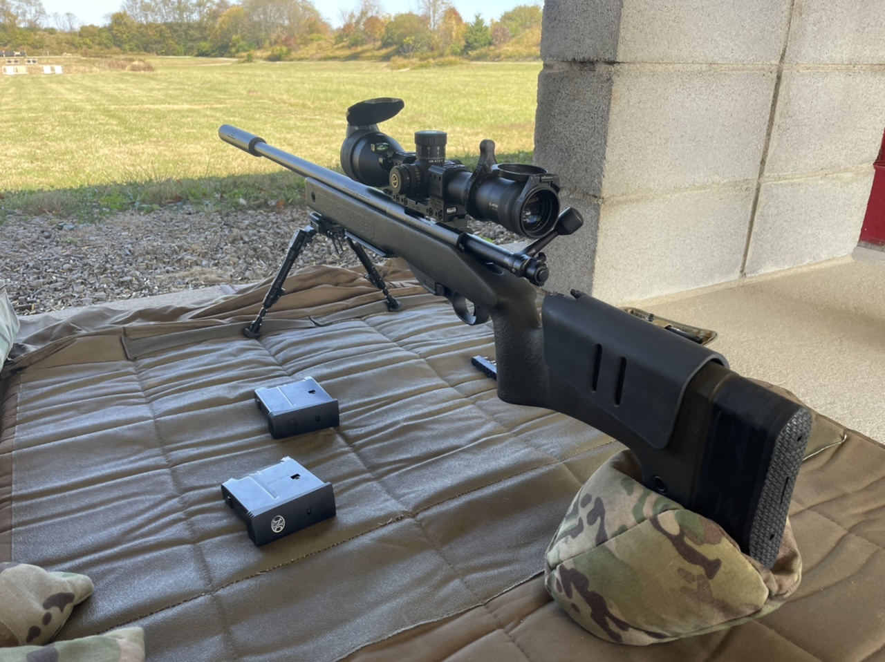

I honestly think the window mags from MDT may just work without modifying them. They are made slimmer up front specifically for win70 actions. Although I haven't tried that combo so take that as you may.
I've tried other AI mags in my SPR and they all hit, except for these that I mention.
It may be worth a shot!
If not, then yeah, the bottom of the action where the magwell is will have to be opened up but most smiths can do that. I may have the PDF file somewhere that shows a drawing/blueprint of dimensions to machine the action.
