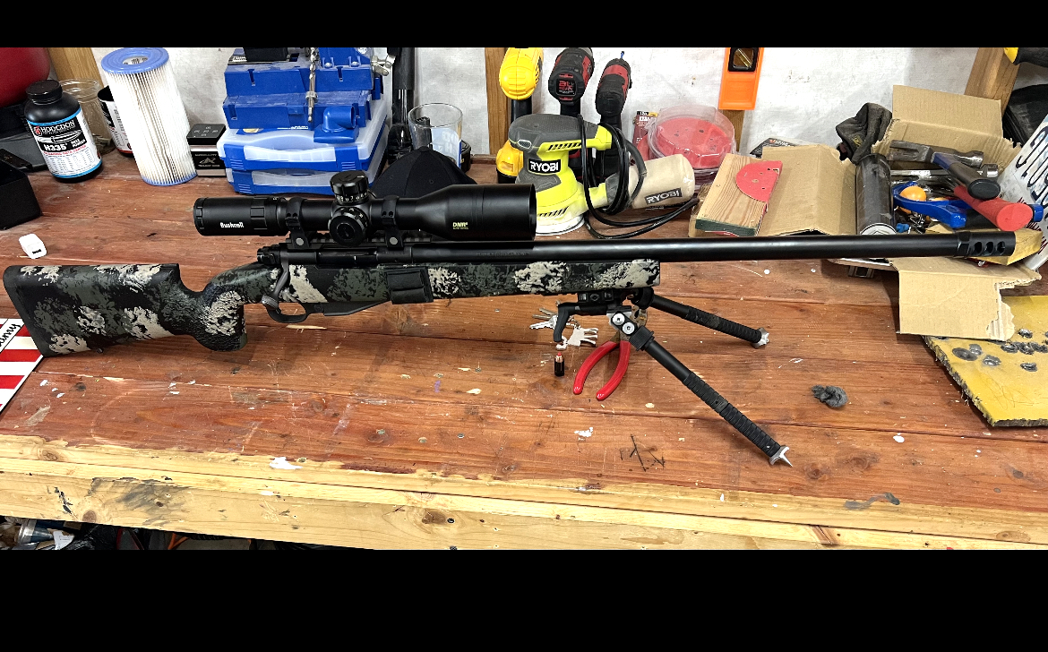

Here is a pic of the group.

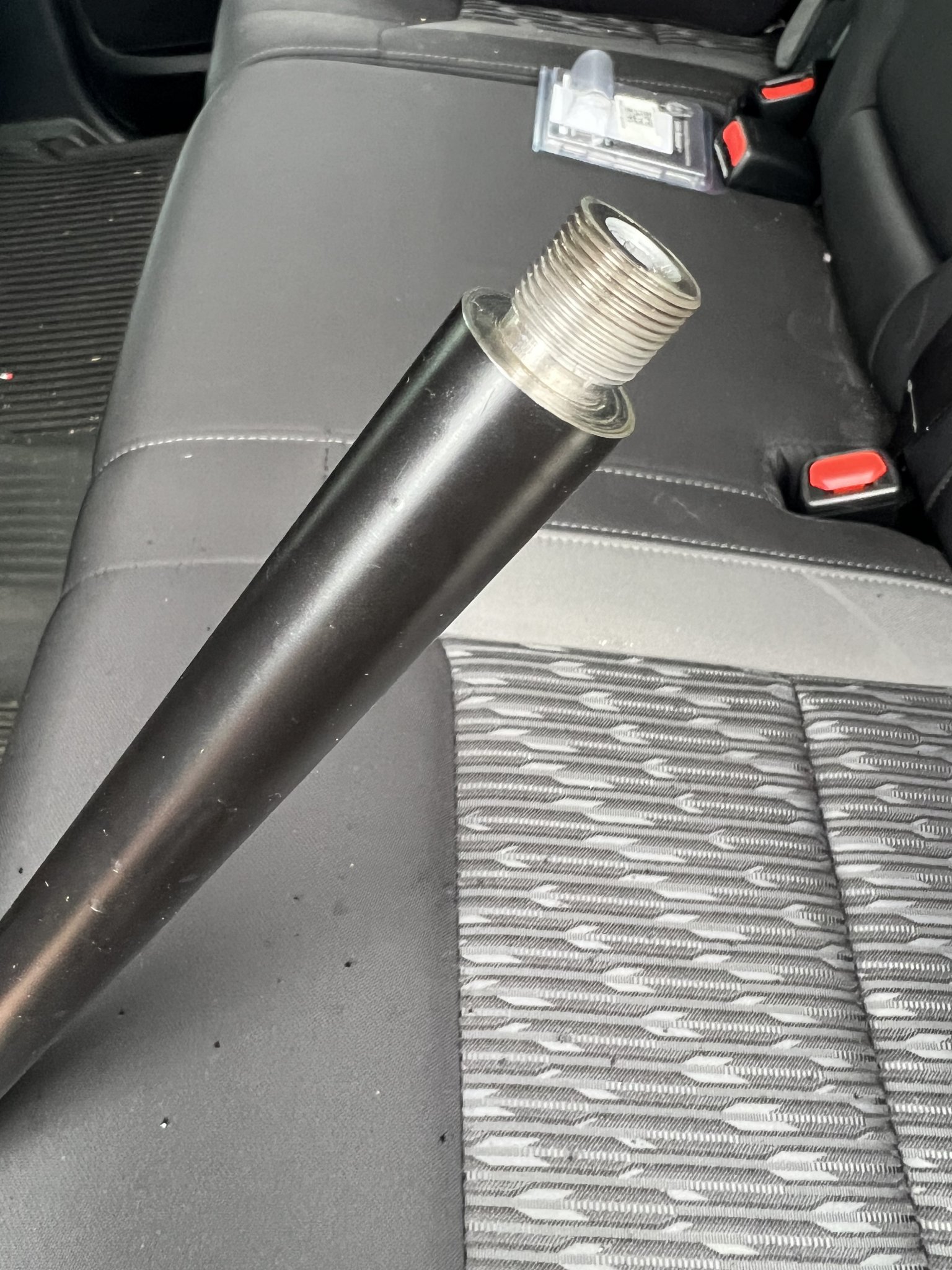

The muzzle was threaded by a local smith. He does very good work. I have pictures of the threads when he was done.

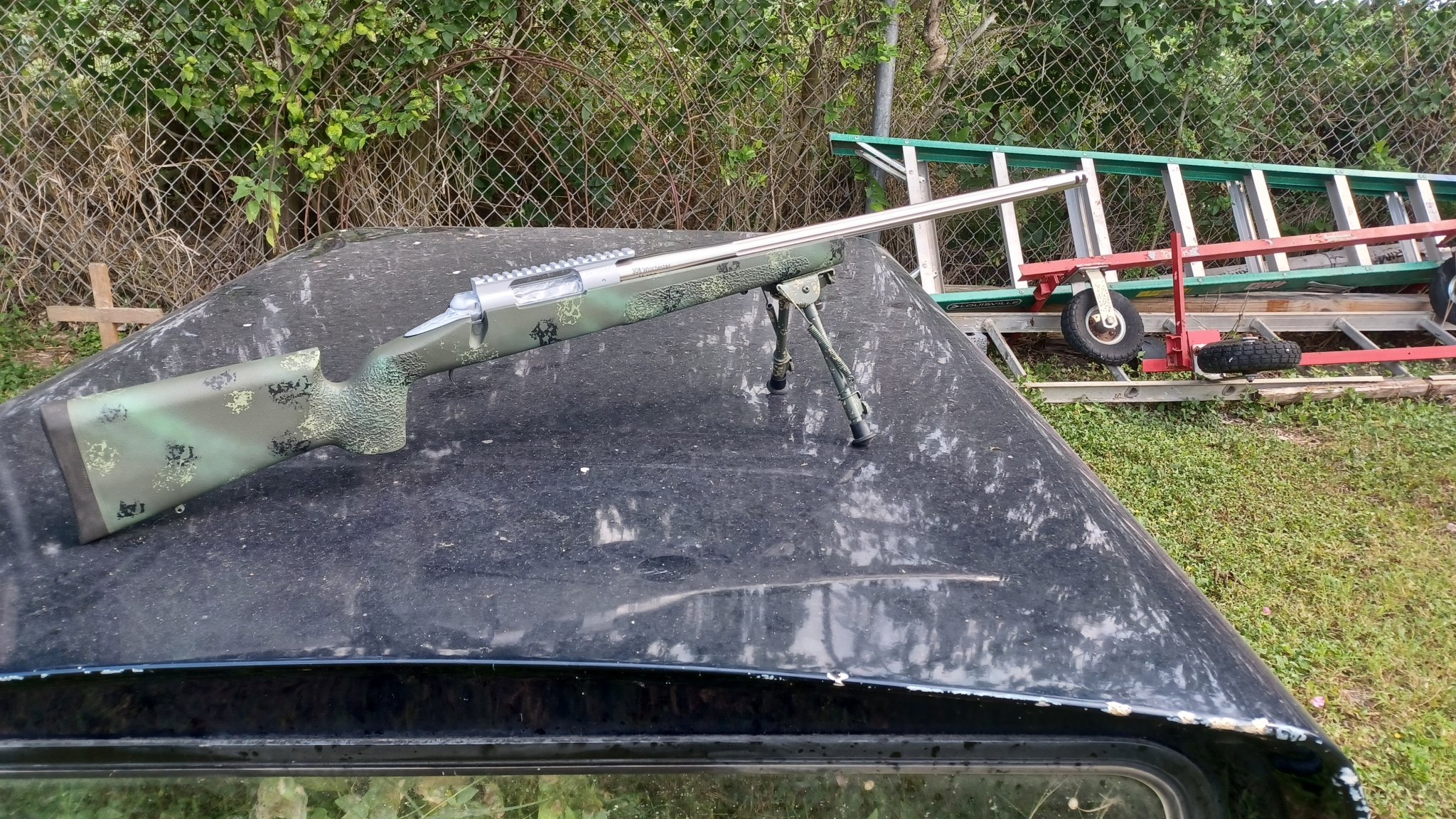

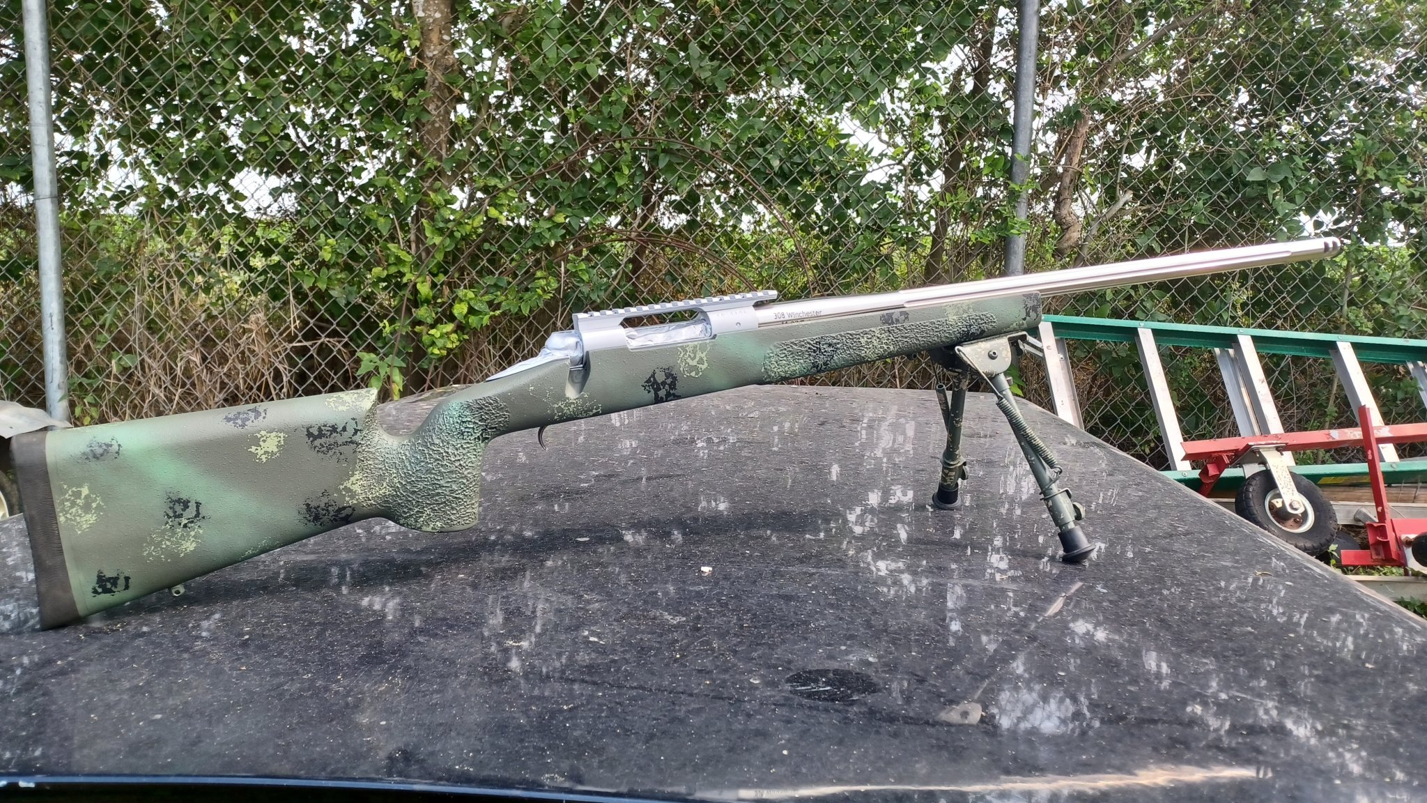

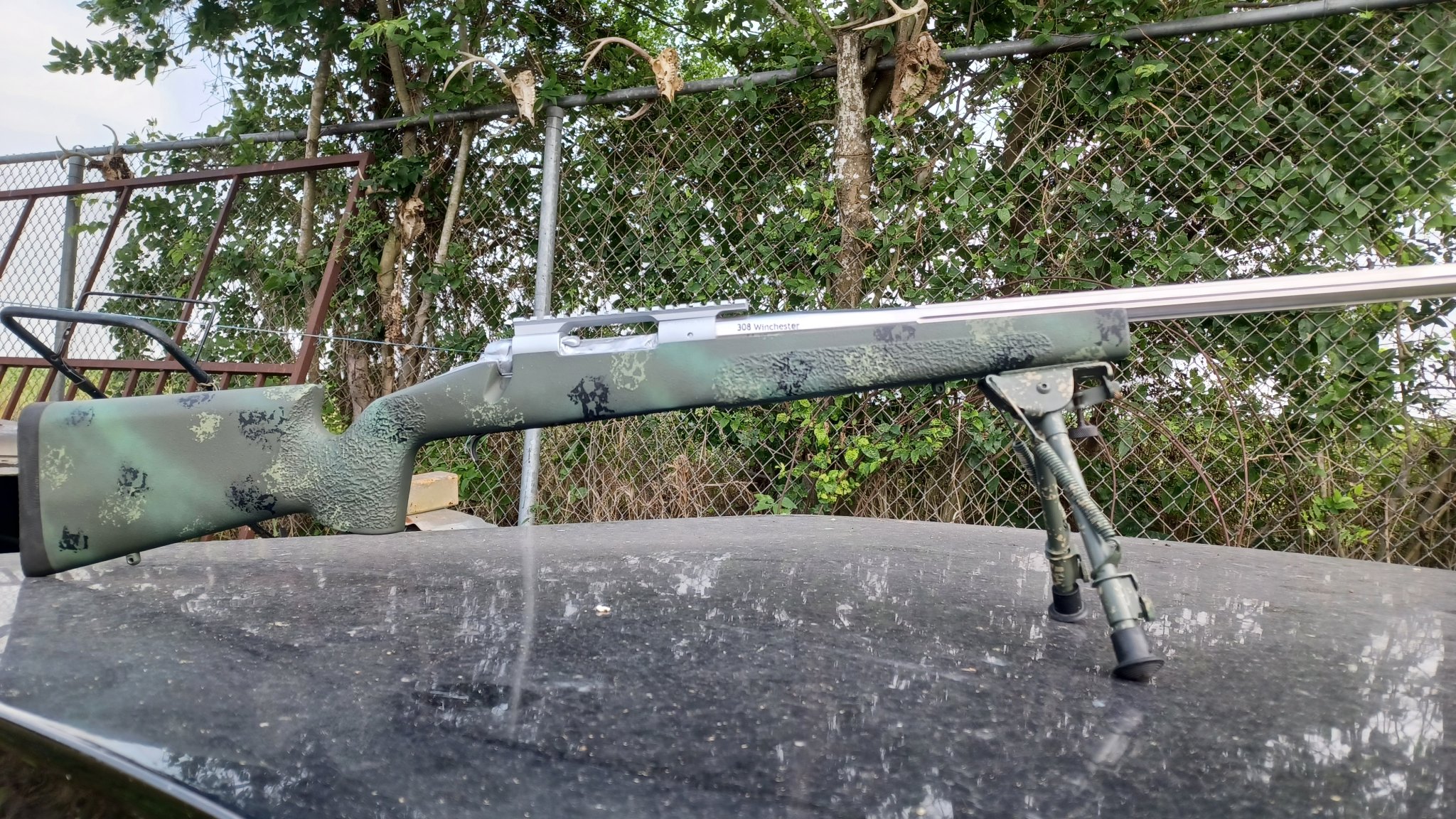

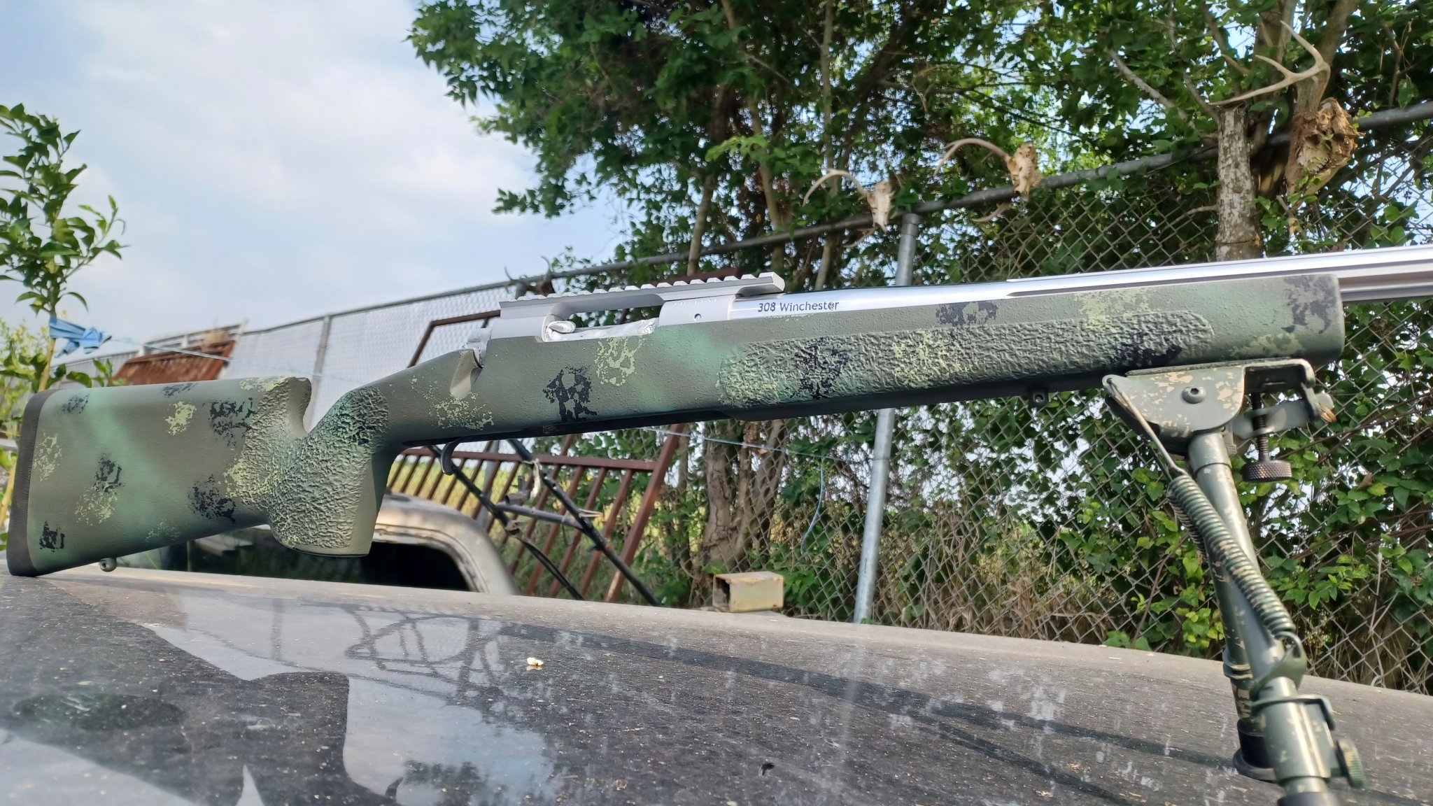

Just finished up painting this SPR. It's the latest one i bought. Decided to try something different than what I normally do. I went with a silver finish on the action. Don't know if I like it or hate it. Maybe I should have done the barrel as well. Oh well, here she is. Just something quick and simple.20240522_164000.jpg20240522_163908.jpg20240522_163804.jpg20240522_163751.jpg
