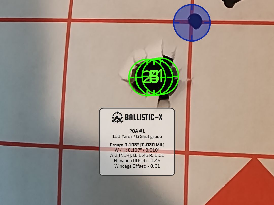

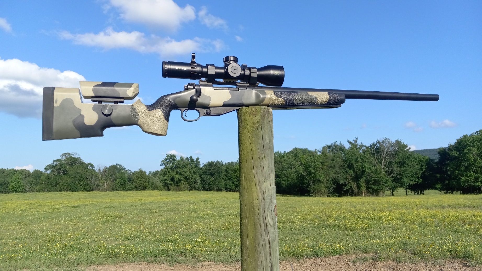

22" Bartlien heavy varmint GA match 308 reamer. Rebuilt by GAP back in March. Blue printed. Pillar and glass bedded. OD green painted mcmillian it came with. Fn TBM. Mcarbo trigger spring. Josh at GA tuned up the trigger. Badger base. Warne rings. Bushnell XRS3.
Factory barrel had a little over 8000 on it, most of it with little cleaning and pushing 175 smk at 2750.
Don't think I missed any thing.

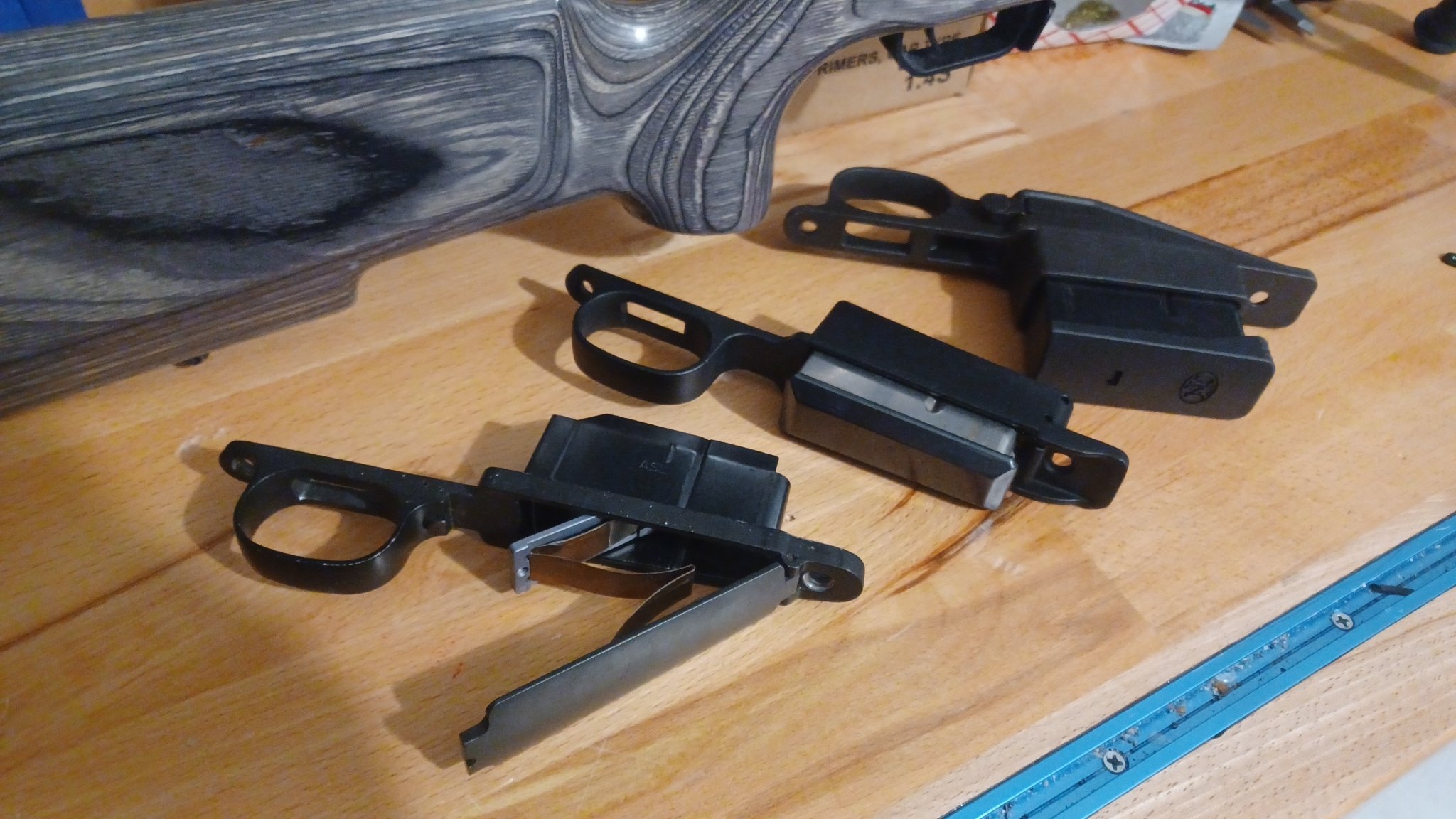

Xlr made a chassis for them for a while
View attachment 8480480View attachment 8480482
That's true, I almost forgot about this one. Mine sits in an MDT ESS which they also made for a good while. I didn't have to open up my action to run their chassis and AI mags.
Heck, you can run any bottom metal or chassis that you can find for the m70 that takes ai mags without opening the action as long as you run the mdt mags.

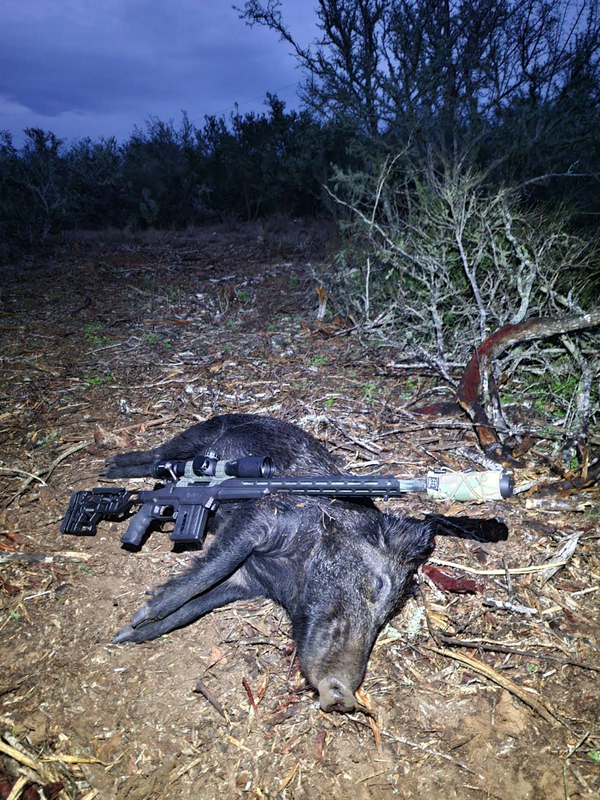

Also, south texas deer are small. I want this build to be my dedicated hunting rig so I'm sure the horsepower out of the 22 dasher will be adequate for our game here.
With that said, I obviously prefer using AI type mags, which I have a bottom metal for. But I also have a couple TBMs and a bunch of Mags, I have the BM with a flush-ish fit mag, and the internal mag with hinged bottom metal. I wouldn't mind using either if I had to since it'll be a hunting setup. But I do think the AI mags will be best.

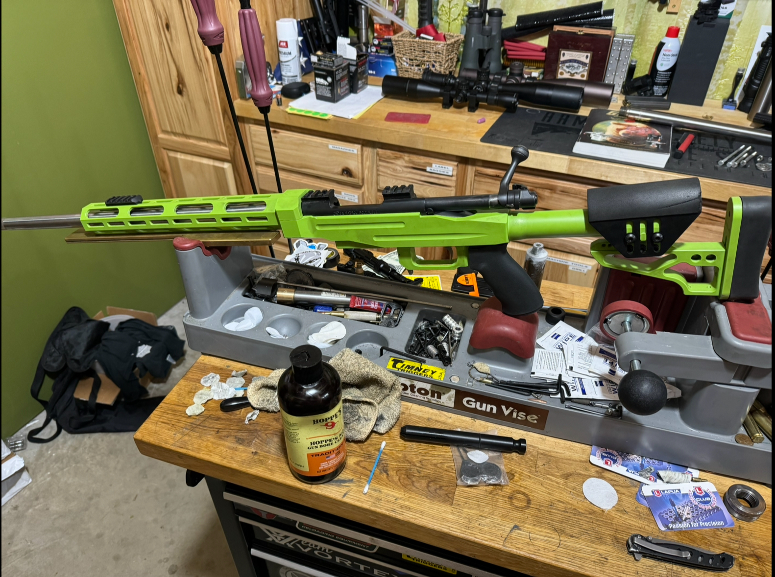

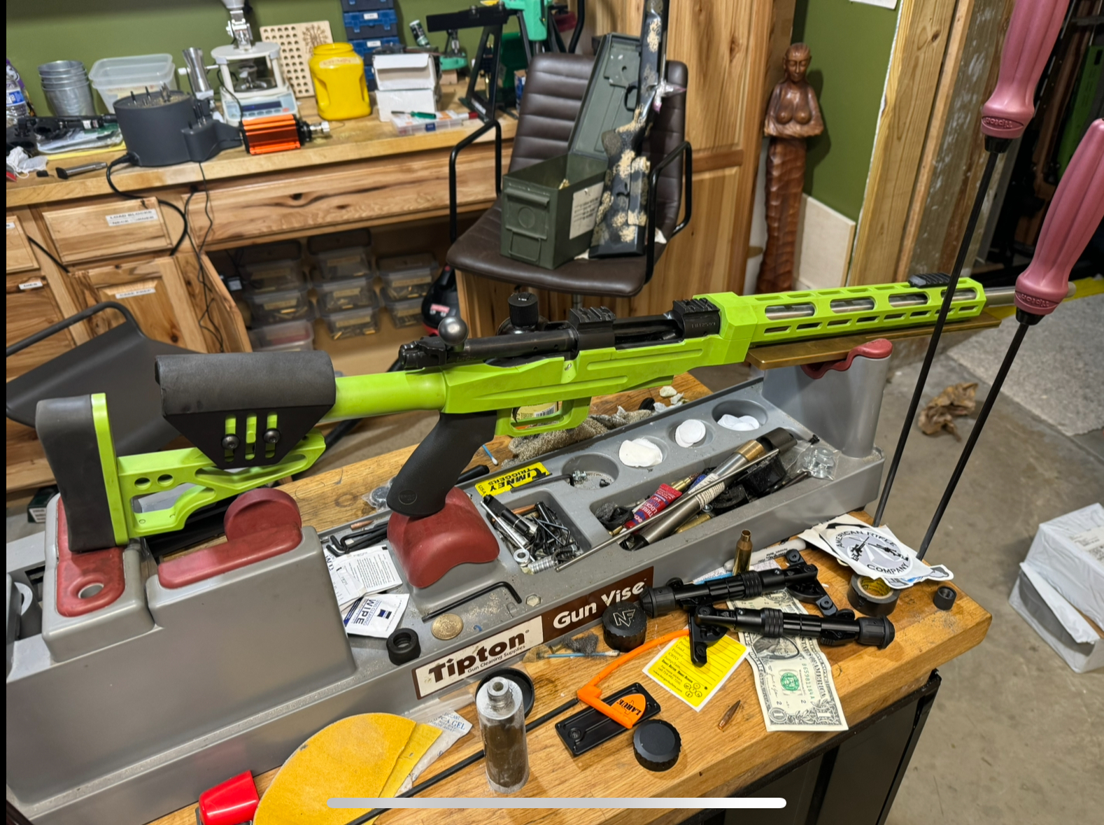

MDT chassis for fn spr, get it while you can...
$300 chassis base
$100 chassis handguard
Now go find a buttstock of your liking and you'll be into a badass chassis for about $700 ish. All you'll be missing is a pistol grip.
And no, you do not have to have the action opened up to run AICS mags if you buy MDT poly/metal mags with the window. My SPR feeds flawlessly that way and it's not opened up.
You're welcome!

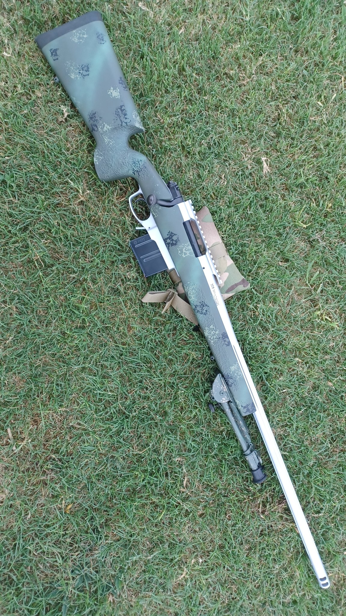

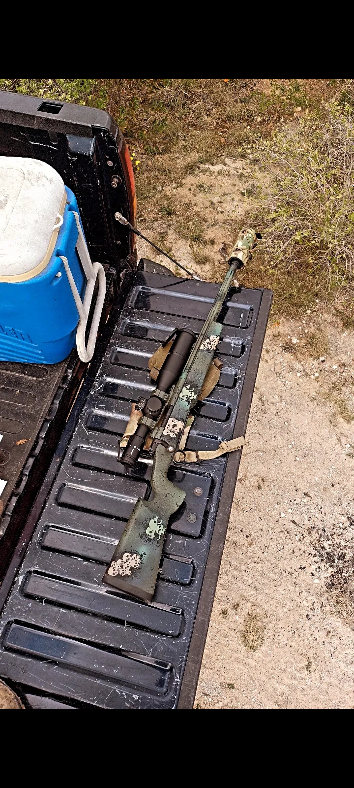

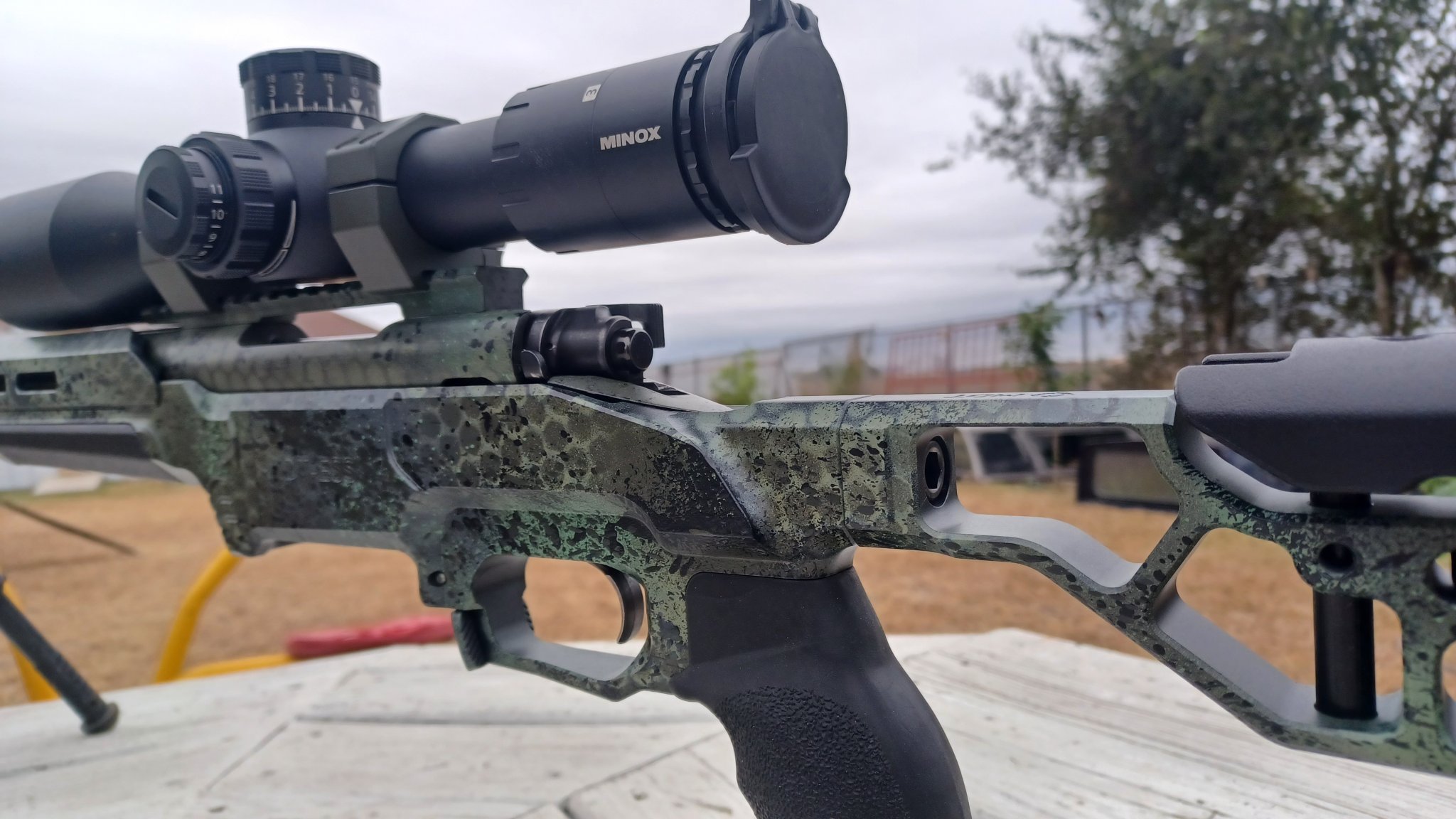

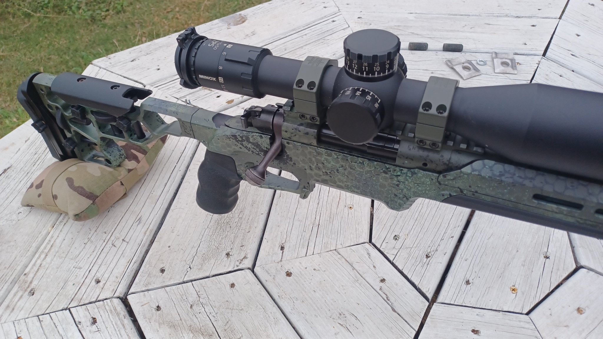

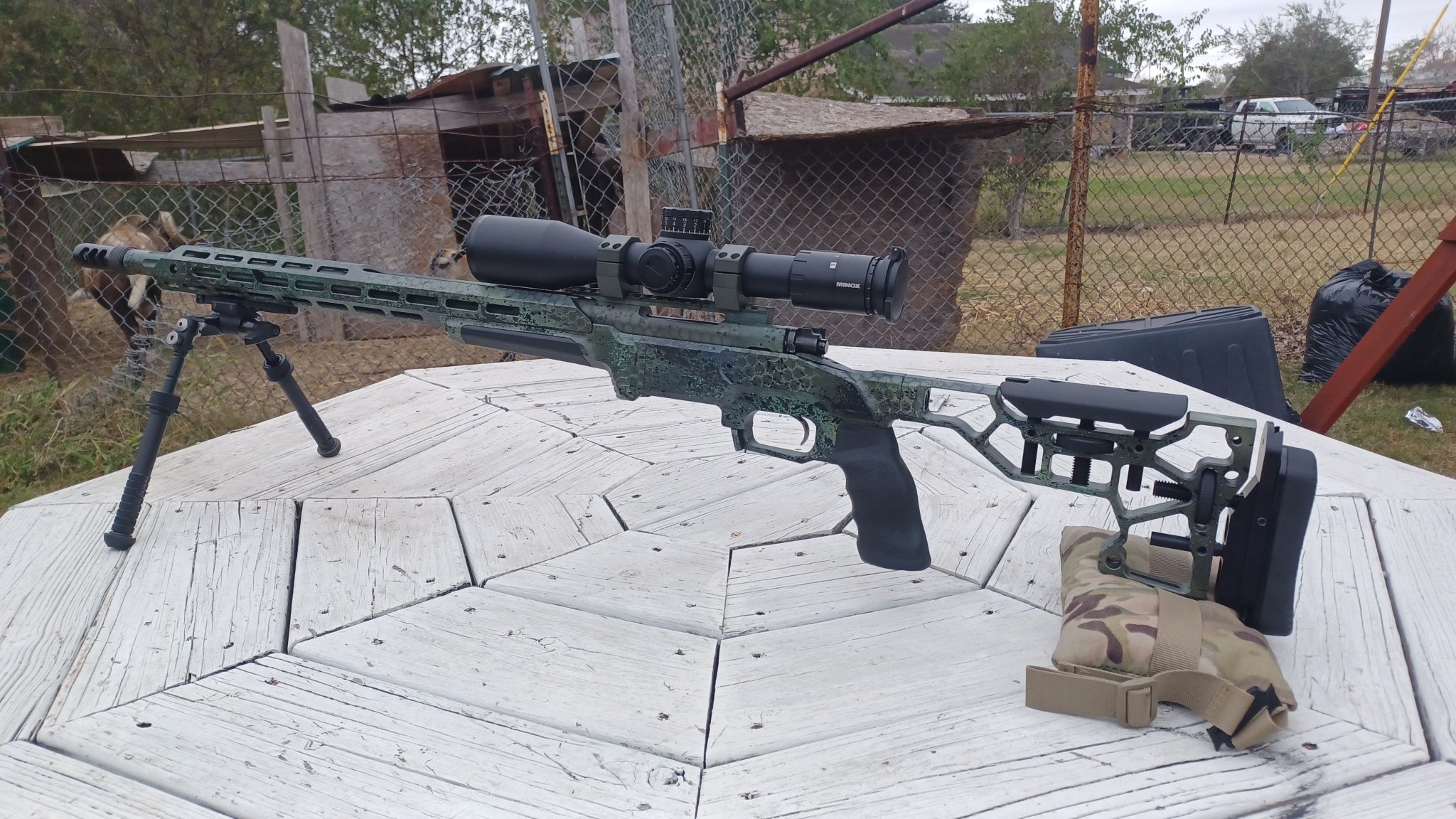

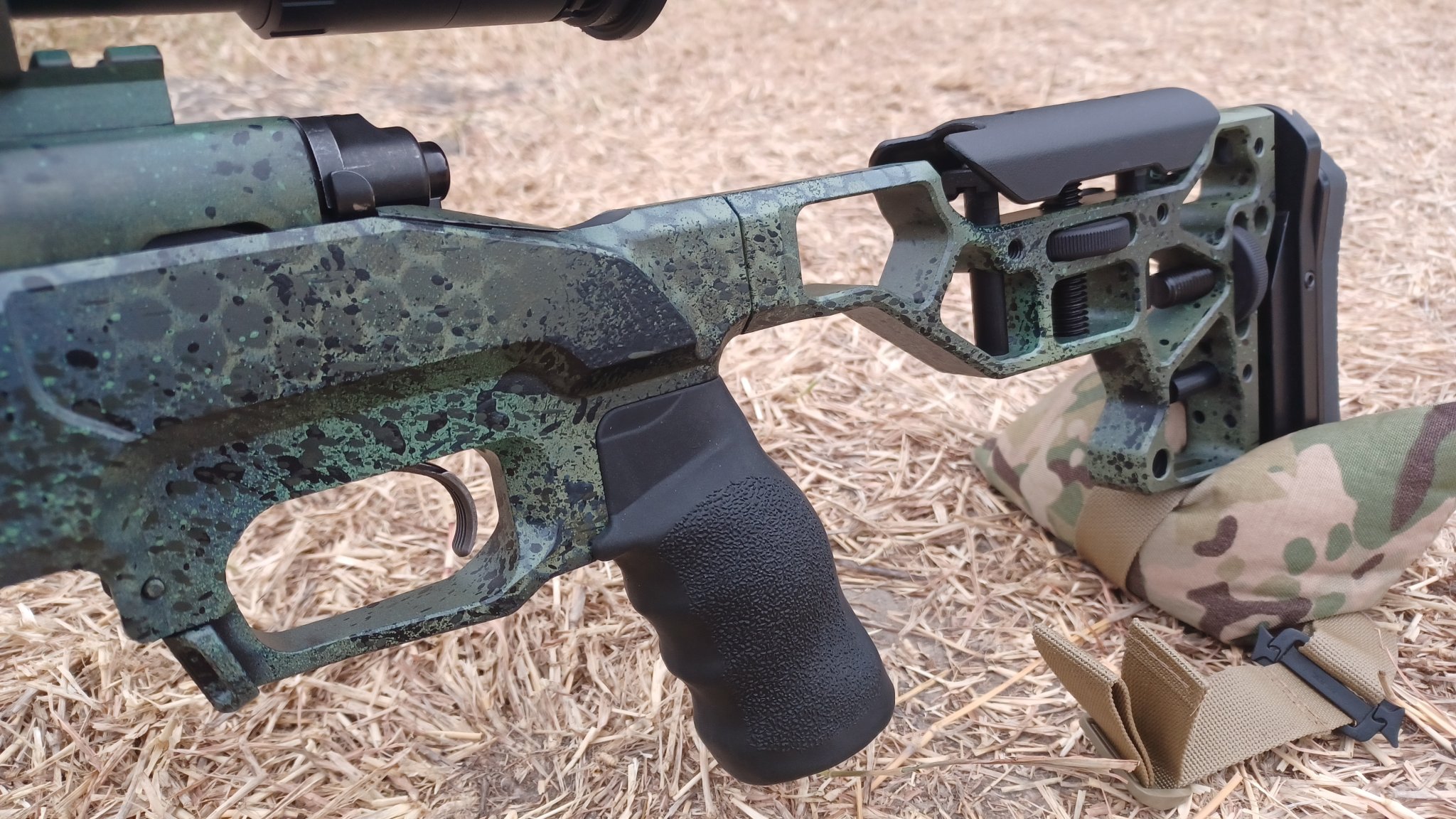

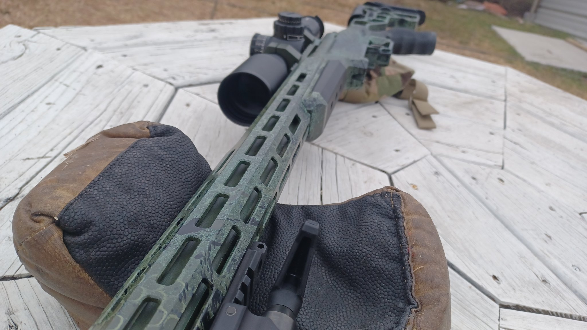

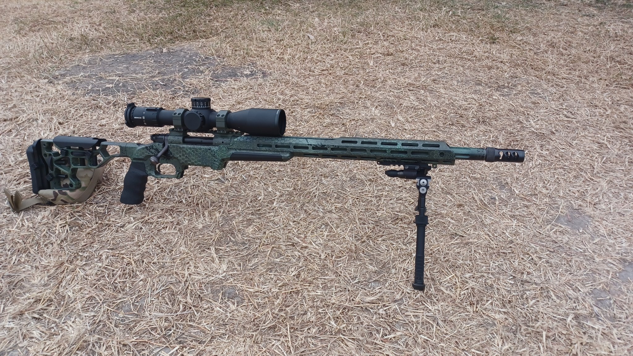

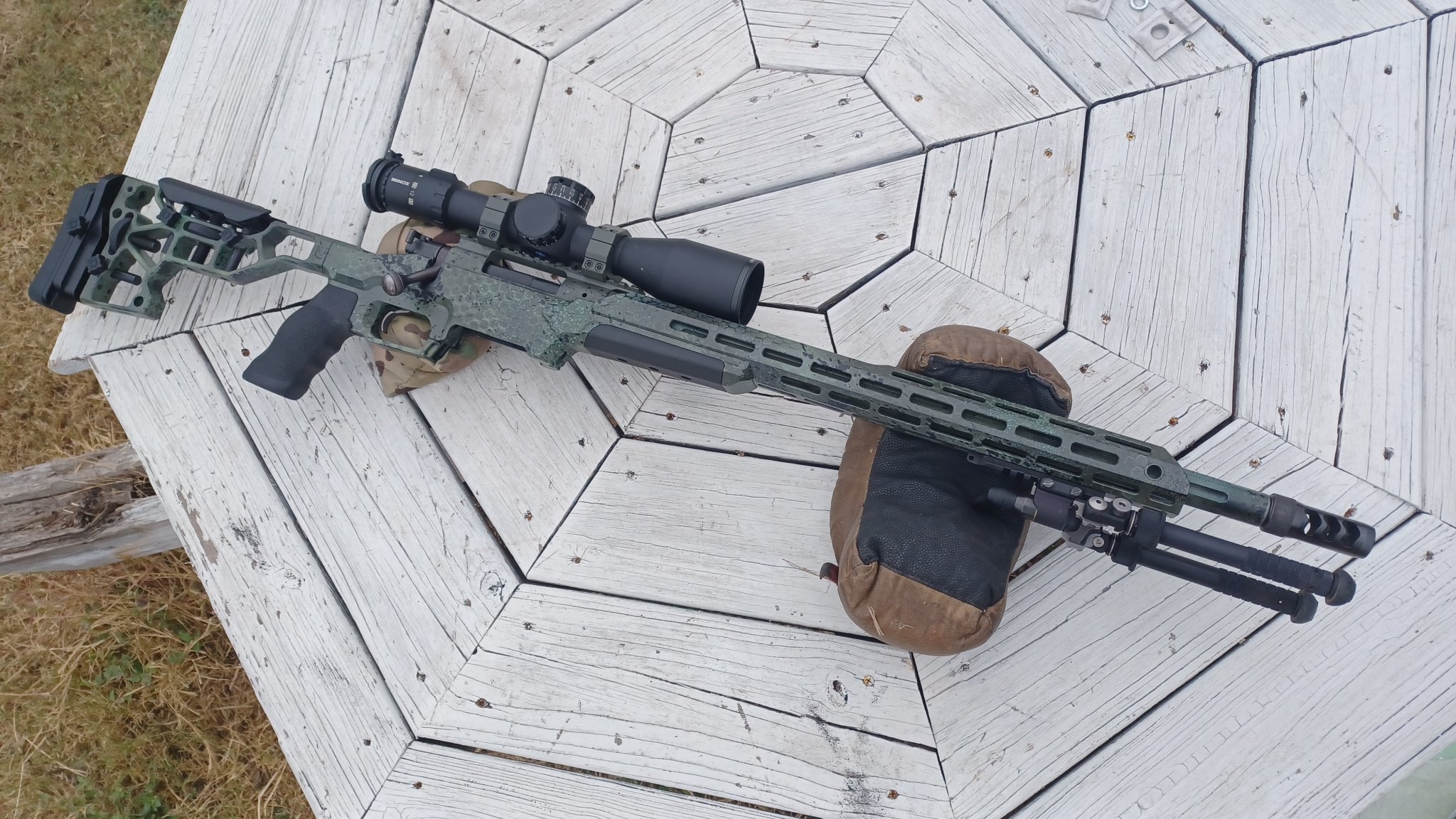

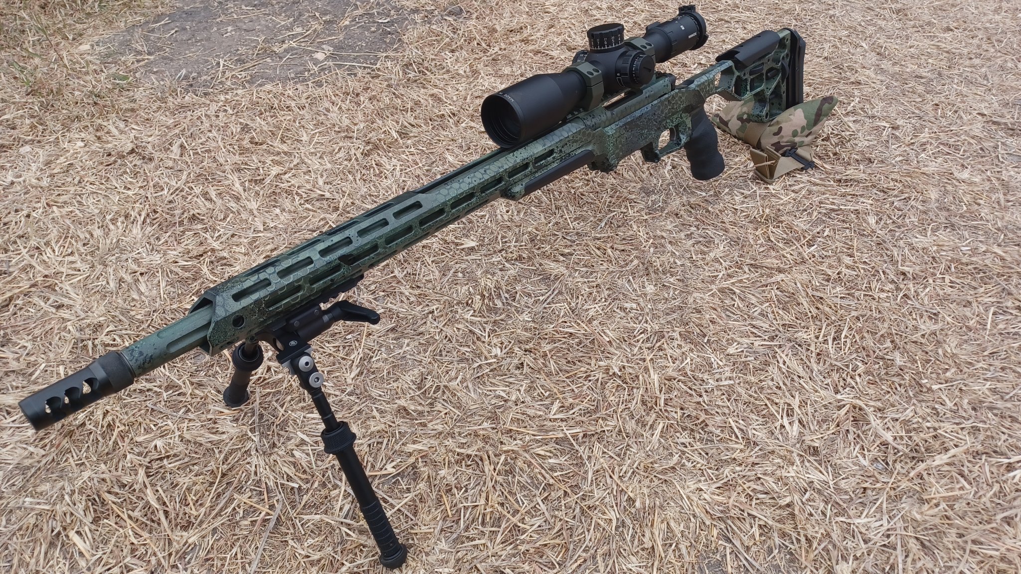

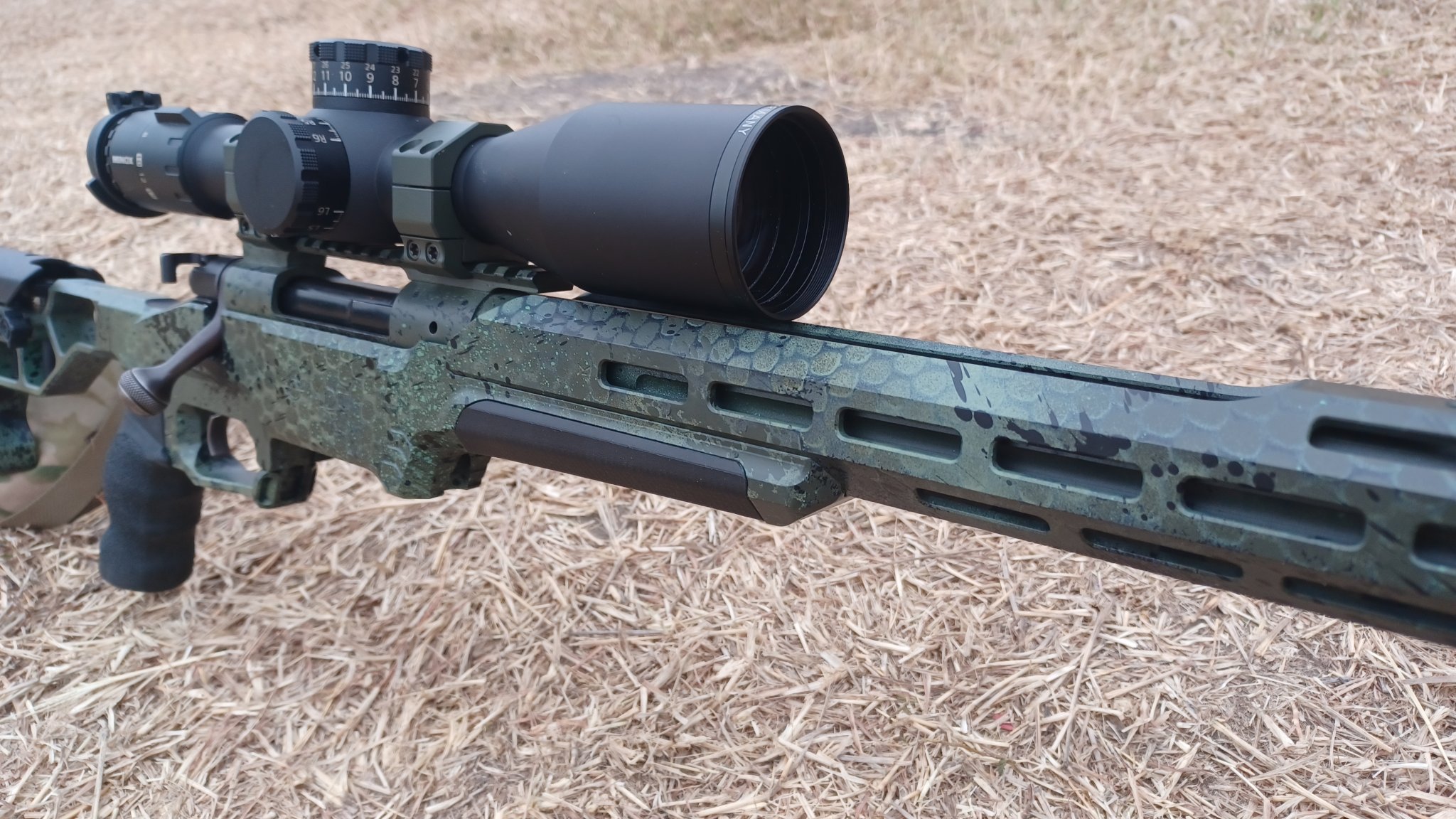

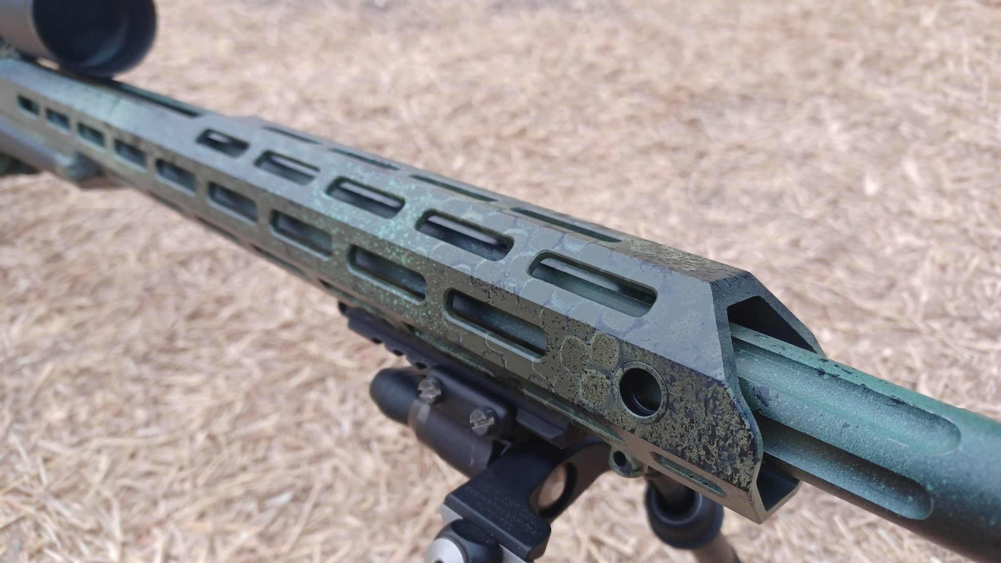

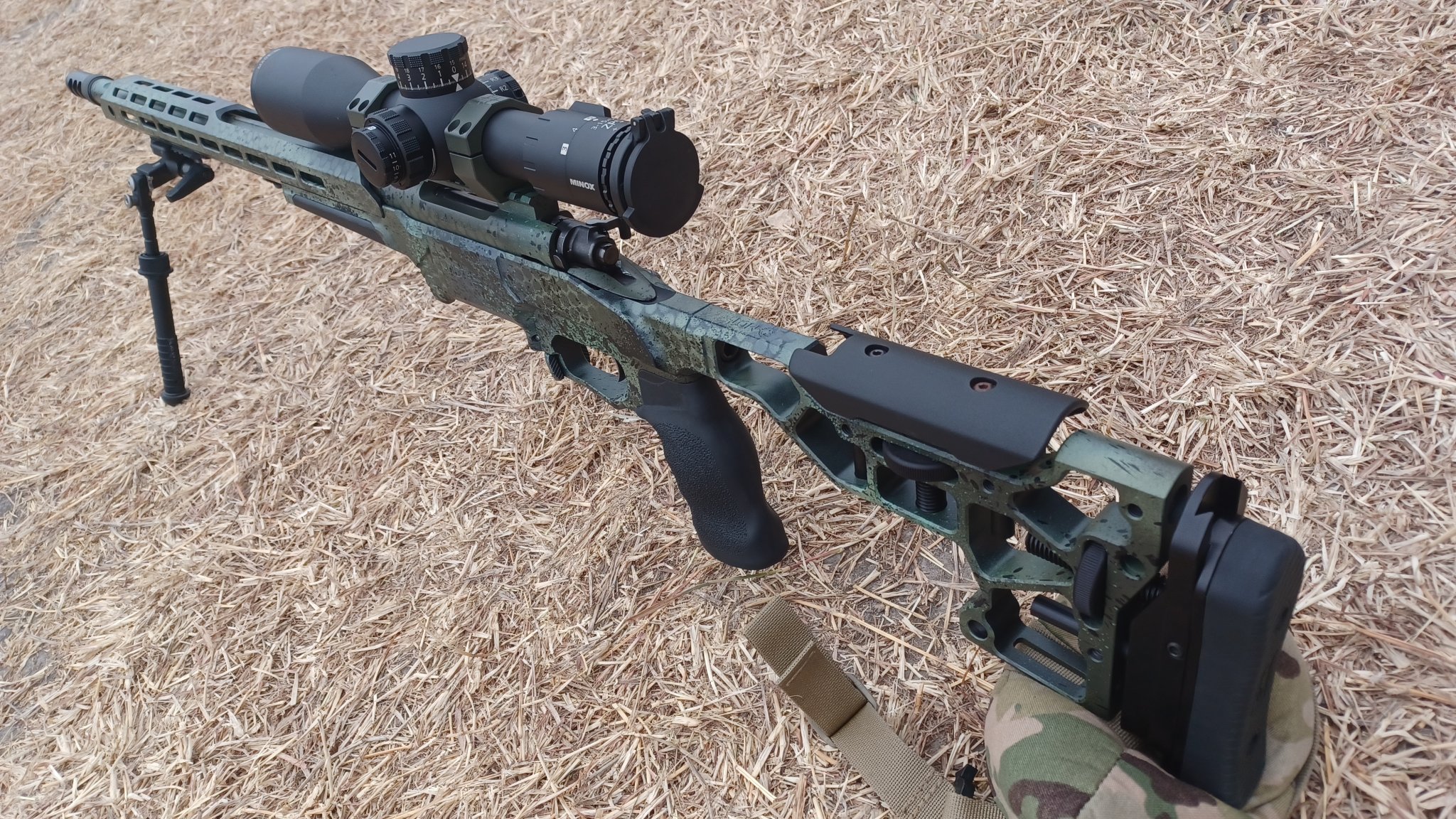

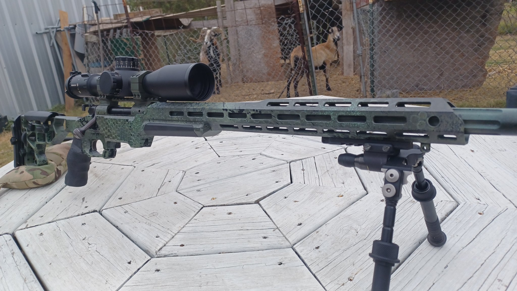

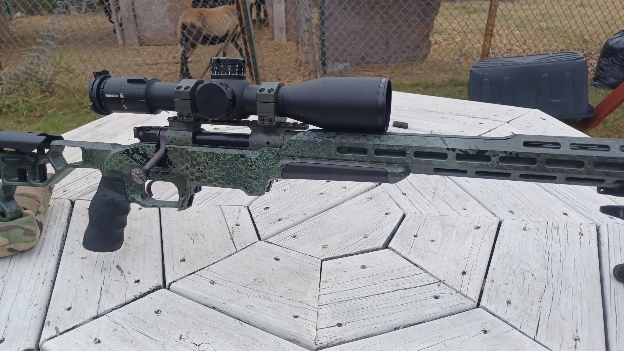

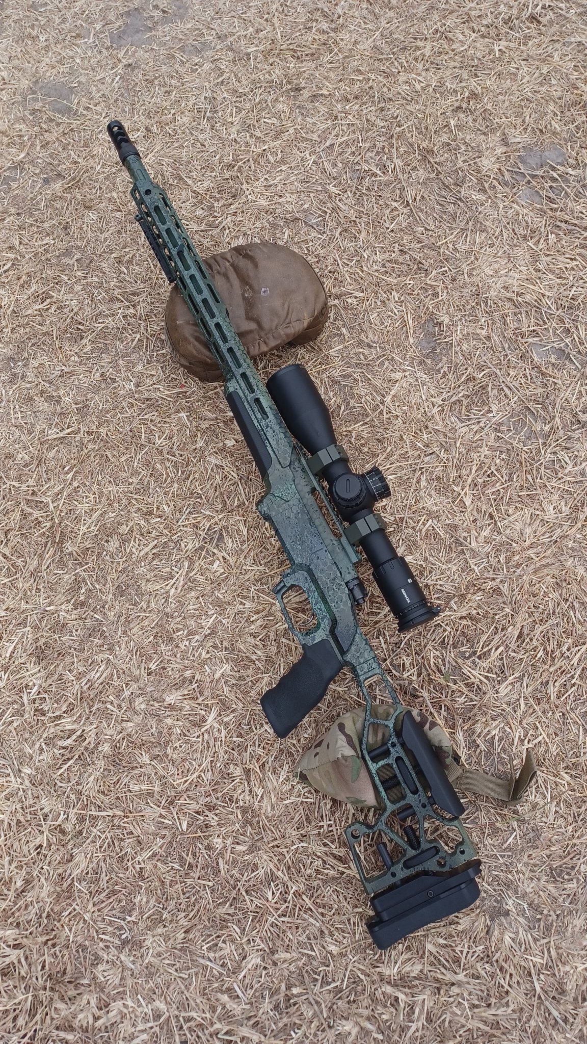

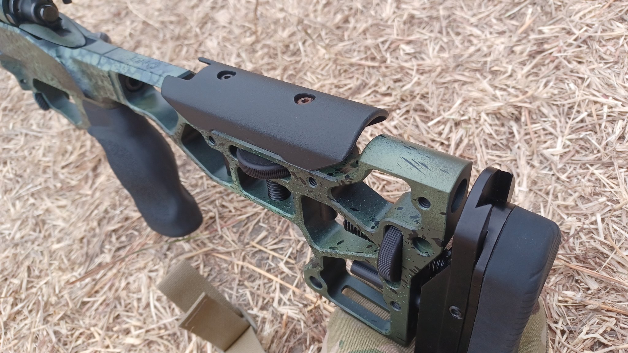

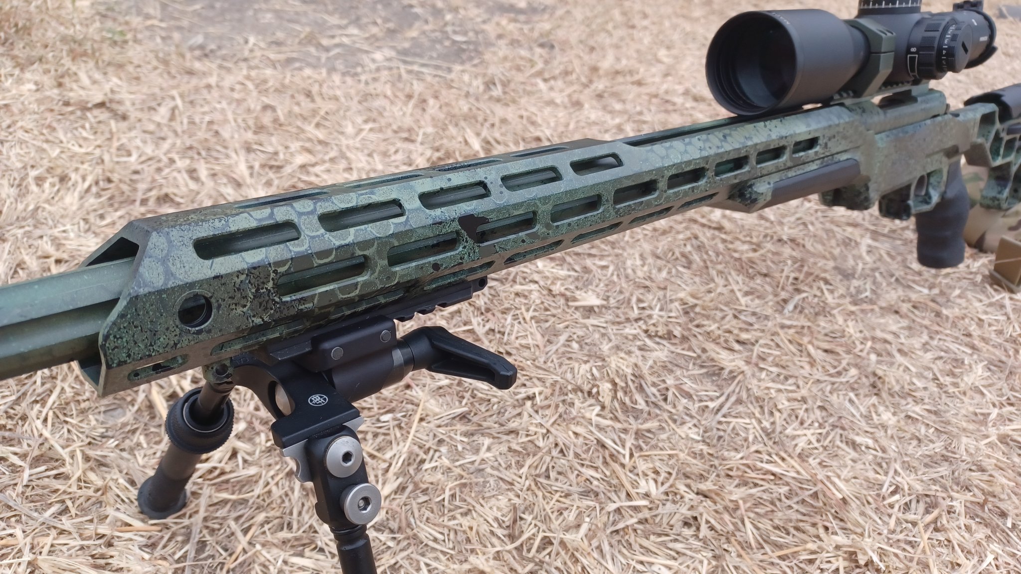

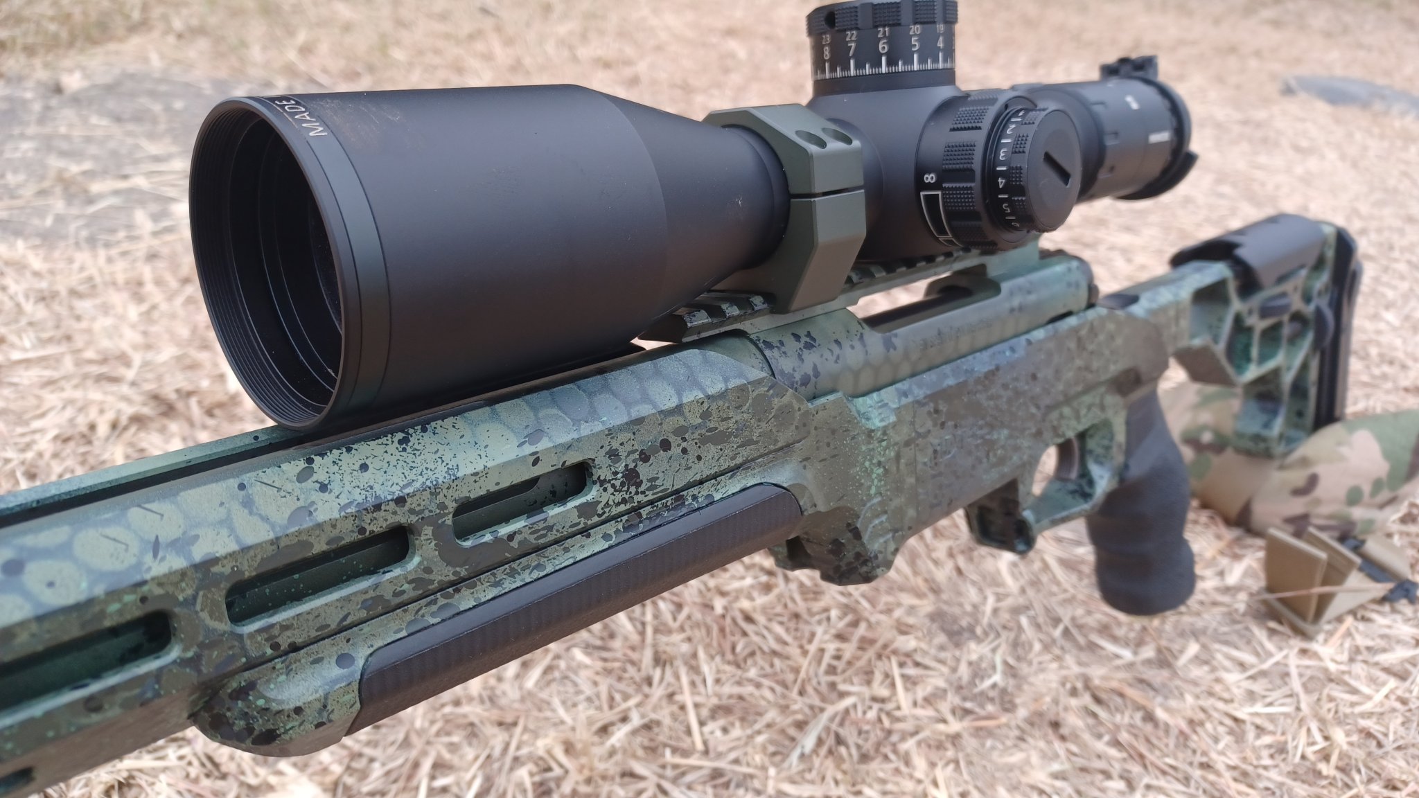

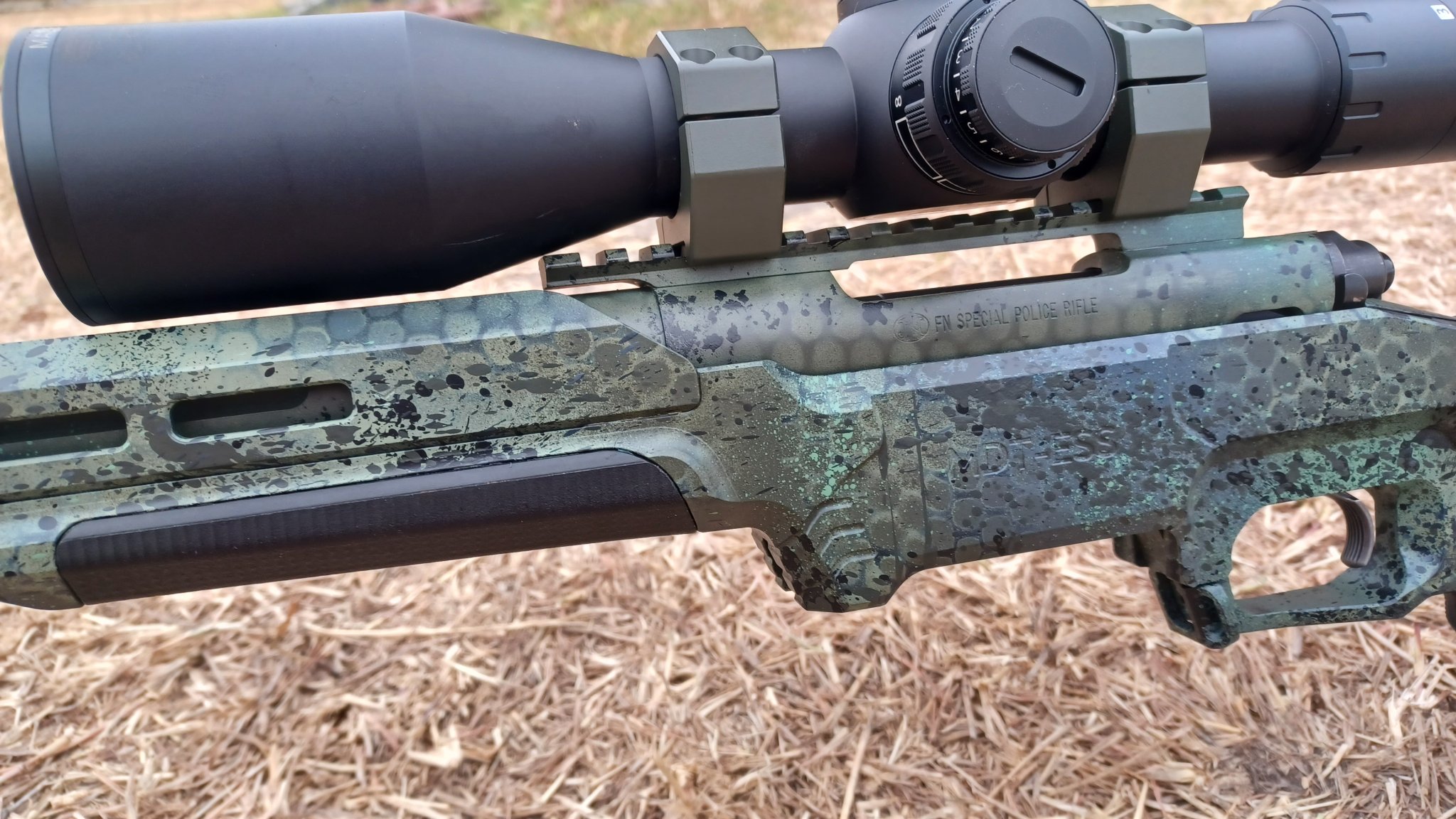

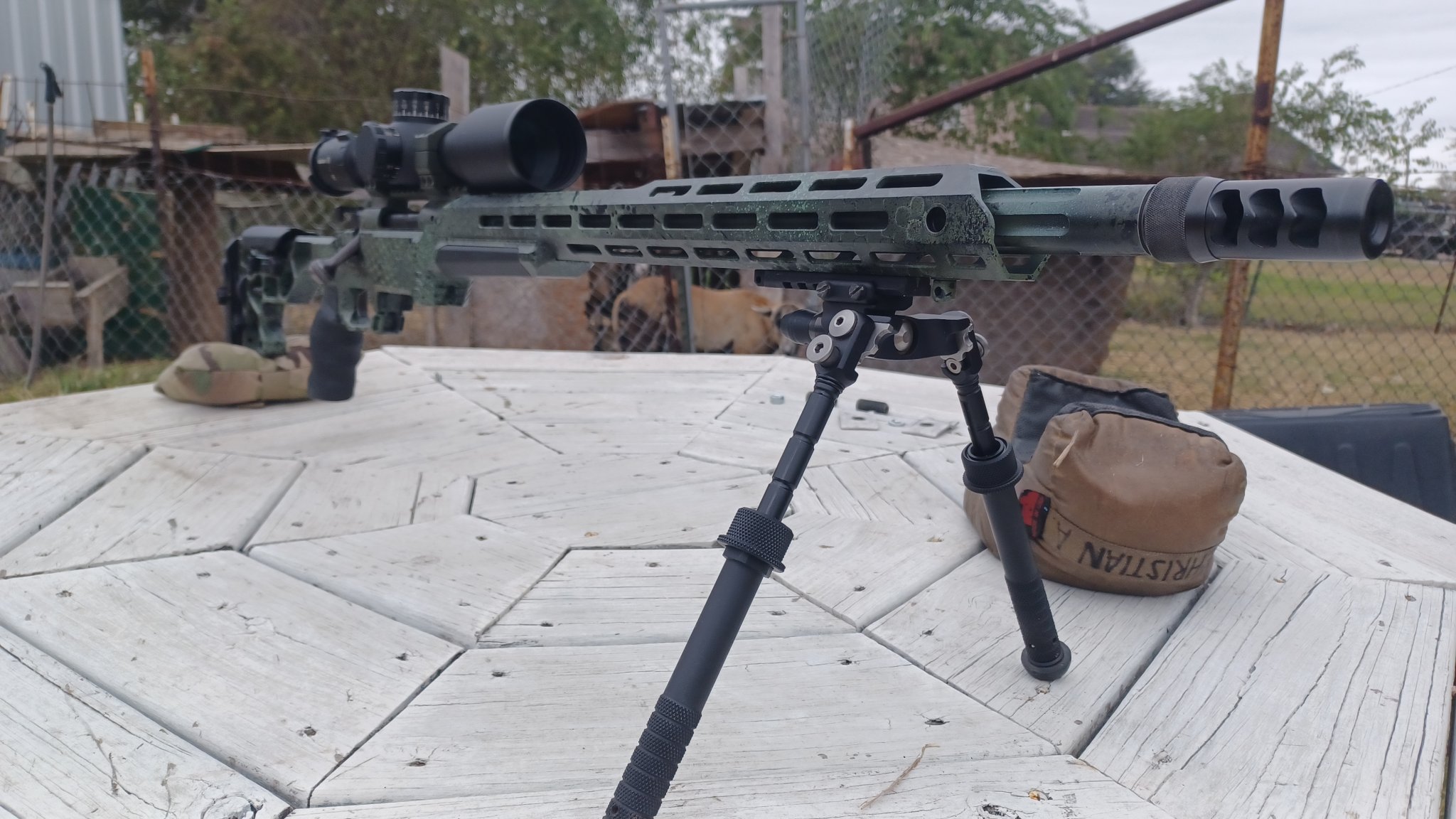

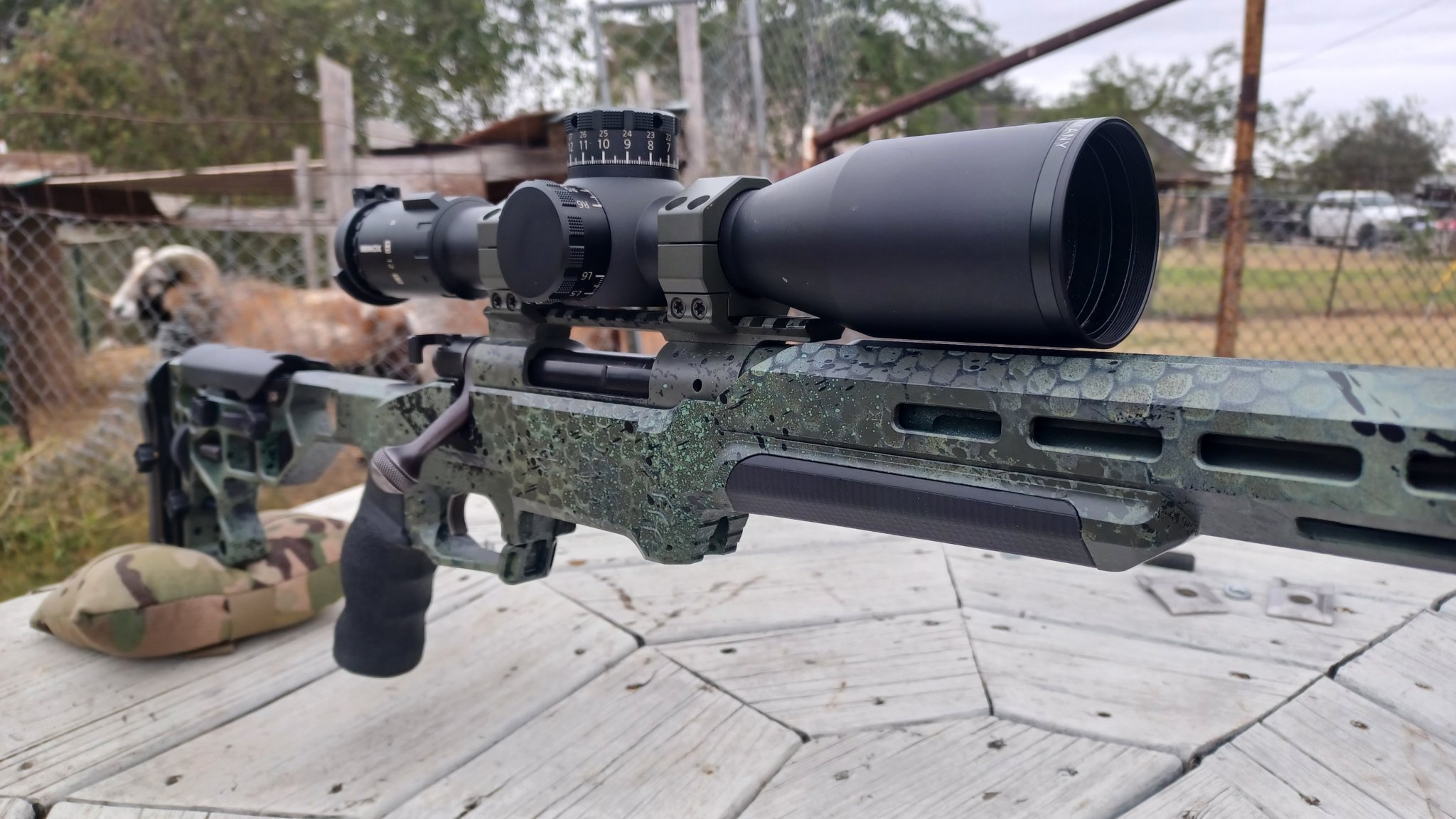

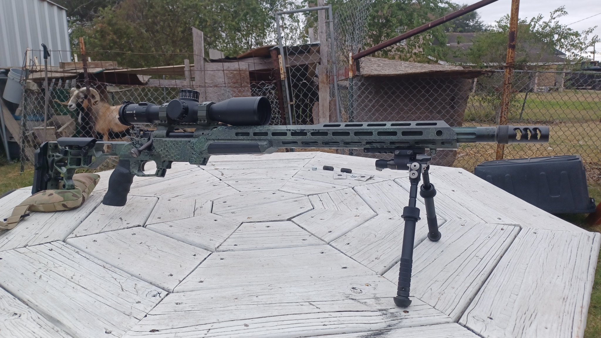

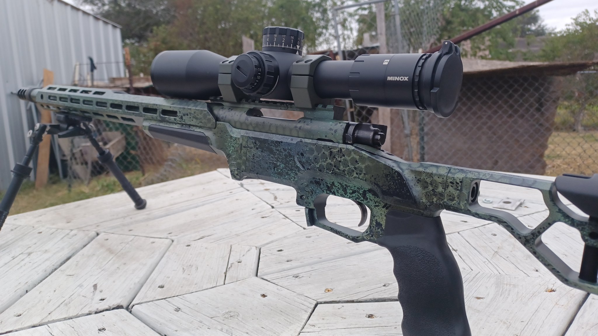

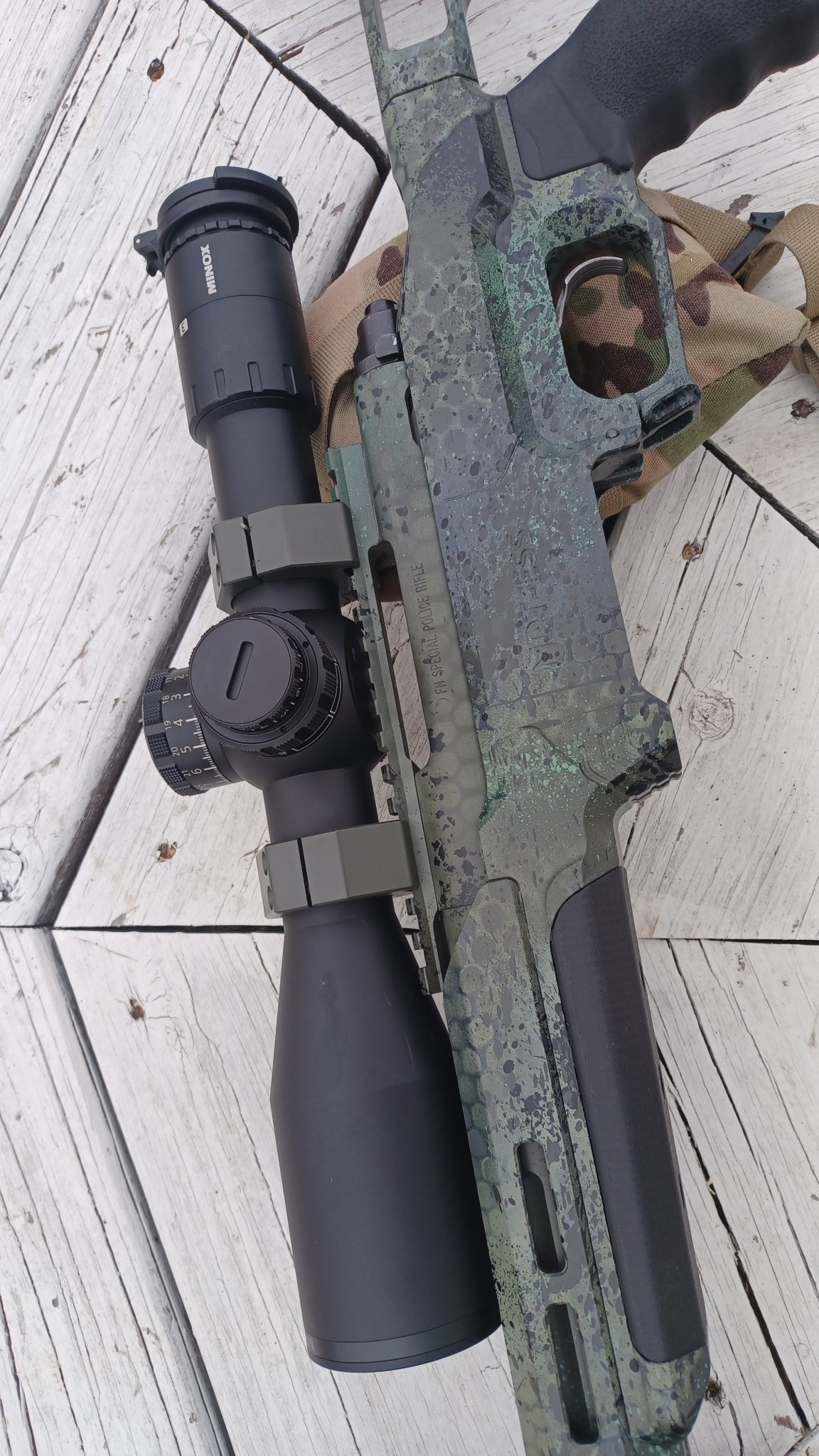

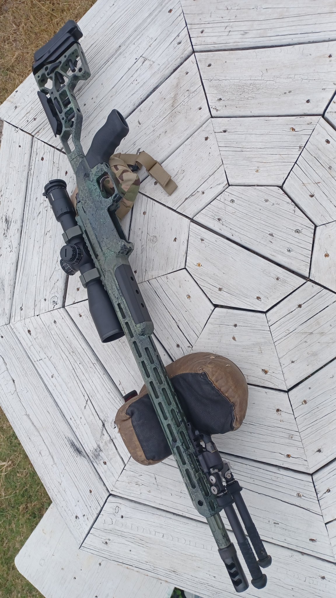

I decided to paint mine today. Quick Lil job, nothing too extravagant.
I had the barelled action painted from when I painted it in the old stock.
I took it out of the stock a few years back and put it in the mdt chassis. Today I said fuck it and painted the chassis as well...
20241130_153705.jpg20241130_153651.jpg20241130_153639.jpg20241130_153548.jpg20241130_153534.jpg20241130_153528.jpg20241130_153643.jpg20241130_153522.jpg20241130_153452.jpg20241130_153412.jpg20241130_153405.jpg20241130_153344.jpg20241130_153255.jpg20241130_153248.jpg20241130_153142.jpg20241130_153133.jpg20241130_153121.jpg20241130_153101.jpg20241130_153054.jpg20241130_153048.jpg20241130_153043.jpg20241130_153013.jpg20241130_153005.jpg20241130_152955.jpg20241130_151942.jpg
@308pirate do I still hold the krylon king of Chicago title?
