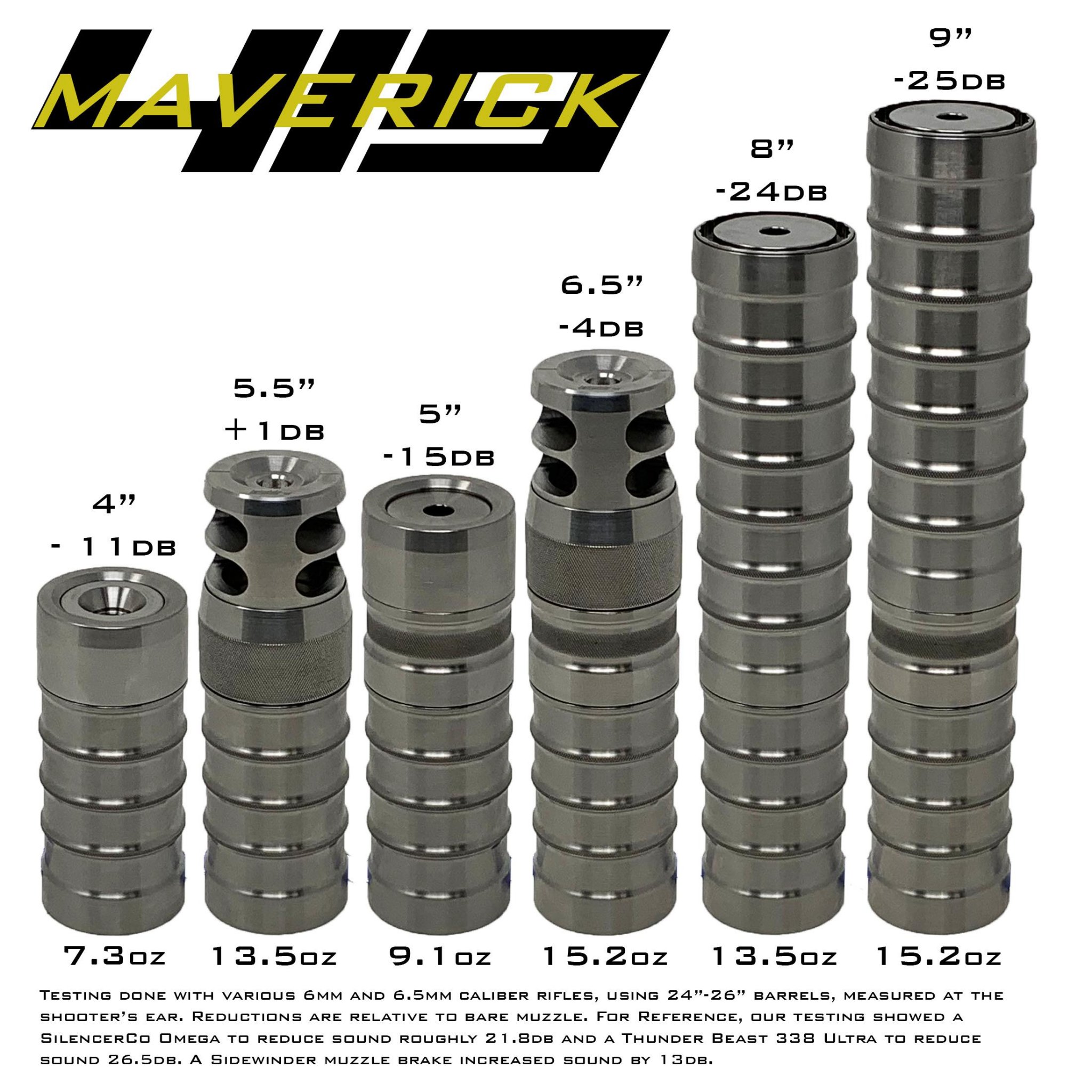

So all of the baffles, except for the blast baffle, will be Grade-5 Ti. It's the standard in light/durable baffles for a reason. The blast baffle is 17-4 Stainless, as we wanted the extra durability. The brake itself is all 17-4. This is a material we have more experience with, and it also works out nicely to balance weight in the brake and the Stage 2.
We aren't welding because with Jon's taper/skirt design we don't have to, and it remains serviceable for us. This helps in two scenarios:
1) There's a baffle strike
2) We find a way to improve the internals and want to offer re-cores (more on that later)
We didn't want customers to be able to take them apart because of what we think will be an inability to assemble them correctly. The can is designed with the baffles that compress into one another via taper, and we have a specific torque we want on each end cap. Unless you have a collet system to hold the suppressor, you would not be able to replicate this torque (and not damage the can by crushing it in a vise).
We did very little CFD, as we started to play with models, realized they were likely junk as CFD doesn't include a vital part of the equation - the bullet - so we confirmed this with some other people in the suppressor business and they confirmed the issue with CFD. The only way to do this modeling is incredibly arduous and costly. It's something we are going to push into, but are still skeptical of the relevance.
Real-world testing was a fairly long process. We have a bucket of different baffle designs, lengths, angles, clips, mouths, etc, that became a testing project. We bought a capable sound meter, and surrounded the rifle with open ears, and kept good notes, and it led us to a design we were happy with. Something about suppressors that's hard to deal with is the idea of tone. While dB ratings are what everyone wants, talk to anyone with a lot of suppressor experience and they'll tell you that 1-2 dB can be far less important than the ear/tone test. Hard to quantify, but we paid as much attention to it as we could. That said, the shop-serviceable design would allow us to re-core in the future if we found something that was better in a worthwhile way.
For cleaning/service we intend on customer being able to send them in annually for a cleaning. We will have simple downloadable cards to be filled out (we want to know how many rounds you think are on it, what calibers you shoot, stuff like that. Helps us track can behavior) and shipped in with the suppressor in its supplied hard case. We will disassemble the can, clean it, check for damage/wear, and return you a unit that is ready for more work.
What did I miss?
The goal is to be wholly transparent on this process, as we think customers deserve it.

We have a batch of samples that will be in circulation very soon. We are also selling the first batch to shooters specifically, starting with those that competed in the PRS Finale this weekend, as we know they will actually end up at matches and in front of guys. This weekend at the zero/train-up I offered every person I saw the opportunity to shoot a Maverick on a demo gun, or if their match rifle had a Sidewinder they could screw one on (all of the current units are Sidewinder mount, production will also have Hellfire) and shoot their rifle. Lots of effort is going into making sure guys get to demo the units, as we know that you'll love the feel.
Making these non-NFA has come to mind, but would require a redesign that don't have on the schedule. We would need to ensure that there's no way a guy could take a Stage 2 and get it onto a non-NFA Core. That means altering a good number of parts, as well as dedicating valuable lathe time to a project that would take away from Maverick production. Part of the allure is also being able to shoot/train suppressed with the system and see no POI shift. That's obviously lost with a non-NFA item.
We have a 338 Ultra, Ultra 7 (6.5) and an Omega that we have been using as test/comparison cans through the whole process. You're going to see footage and numbers relative to all by the time anyone can spend money on a Maverick.

Based on what he said above...
Right now, the sound at the shooter in the braked maverick configuration is a couple/few dB less than a bare muzzle.
I think it would come down to how the ATF wants to measure it - at the shooter, next to the muzzle, or in front of the muzzle. If it's at the shooters ear, I think it would require design changes like Craig mentioned.

Fellas - as promised, here is our update to the system.
We added one functional part, as well as a thread/taper protector, and your Maverick can now be configured six different ways, from 4" to 9". It's also been getting a little lighter as we get into production and can tweak every final surface for strength/weight. Check out the YouTube video, and the graphic that shows config/weight/sound specs.

I got to take mine out to the range today and run 100+ rounds of 308 through it. I've run brakes for years because I didn't like the long push off target of typical suppressors.
I won't be running brakes any more, or any other cans for that matter - at least for anything match related. The Maverick actually exceeded my expectations, which were pretty high. Shooting it in "match mode", even shooting off a wobbly-assed tank trap tip 5ish feet off the ground, I was easily staying in the optic through the recoil and watching my impacts at 300 yards. The recoil on my 308 was very minimal - far less than expected. Concussion is non-existent, and standing even just a foot or so away from the muzzle was not a problem - definitely not something I could say about any brakes I have run.
I only put a few rounds through it with the extra baffle and the full suppressor stack installed, but adding the baffle made it feel more like a traditional can - but with less drive off target. I was also surprised with how good the 8" suppressor configuration sounded.
The Maverick is a keeper.

That's kinda the thing here, though - you get both in one package. Recoil reduction with no blast, AND a pretty damn good can. All you have to do is swap the front module depending on what you want.
A few points - the Maverick is only $1500 if you get the extra module, it's $1300 without - and that puts it damn close to a TBAC on price. Recoil difference between the Maverick and my Ultra 7 is WAY more than 1 mil, too. Welding a brake to the front would require a complete redesign to allow for it to be timed correctly, and I doubt the ATF would approve it, even then.

How does the Maverick attach to the rifle? I guess I assumed they could make it interface and self-time exactly like their brakes, just with a much larger locking ring/collet. That would allow the baffle section to time if the brake section was welded on.

I'm getting less push off target with the Maverick on my 308 than I did with my U7 and a 6 Creedmoor. I haven't gotten a Sidewinder adapter for my U7 yet (that's in the plans) to do a direct comparison, though.
Today, the suppressor pieces just screw on and end up where they end up. The brake piece times just like a Hellfire or Sidewinder but on the end of the 1st suppressor section or the extra baffle. (note - I don't have one in front of me, but it seems pretty clear on the demo videos, etc)
You're right that if it's welded on, you'd have to time the whole unit, which then requires that they redesign at least the back end of the unit (to allow for new ring, etc. They might have to design a completely new adapter, too. It's a different design problem all the way around.

I tried a buddy’s maverick on my 25 creedmoor this weekend off the most rickety barricade on the planet. We did a direct comparison of my silencer tech to the maverick. We also did a direct comparison of the 25 creed to his 6BR in the match configuration.
The maverick was amazing. It controlled the recoil impulse (in match configuration) on the 25 creed the same as my Insite heathen without the over pressure. The recoil pulse was strait back, allowing me to stay on target better than the silencer tech. The noise in the max silencer mode was better than my silencer tech, although more in frequency than volume. (Very subjective).
Shooting prone in moon dust the maverick blew nothing back on me or my scope.
In the match configuration we found that noise was not a problem for bystanders outside about 50 feet.
I would say the perceived recoil on the 25 CM and the 6 BR felt almost the same. The most impressive thing was the flat nature of the free recoil (no shoulder on the gun)
I really like my silencer tech, but if the maverick was available before I bought it I would get the maverick as my do all one can especially over an almost equally priced TBAC.
