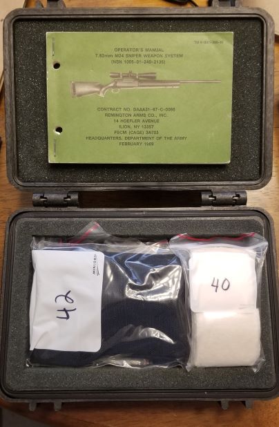

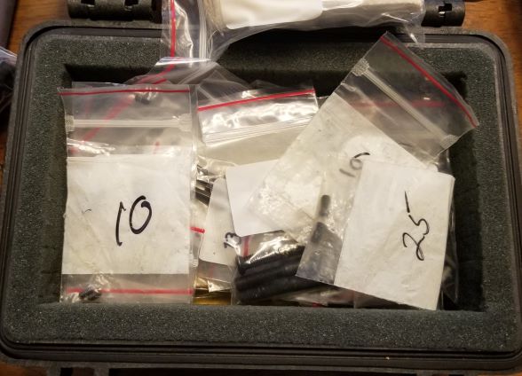

For all you M24 enthusiasts out there that are in the process of building up your M24 Sniper Weapon System, here is a photo of the the D Kit contents. It's a little nicer to see a photo taken from the original TM from Remington rather than the line drawings that are in the later technical manuals. This is laid out exactly as they are drawn in the TM. This kit is the early style as evidenced by the Redfield Big Bore Sight Inserts, the Optics Cleaning Kit, the Day Optic Ring Screws, the Day Optic Windage and Elevation Dials, the Cleaning Rod and the Front and Rear Sight base screws. All of these changed when Remington changed the iron sights to OK Webber, the Day Optic changed to the M3 LR/T, and the Otis M24 Sniper Cleaning Kit replaced the cleaning rod.
This is what it all looks like packed up. Its a tight fit.

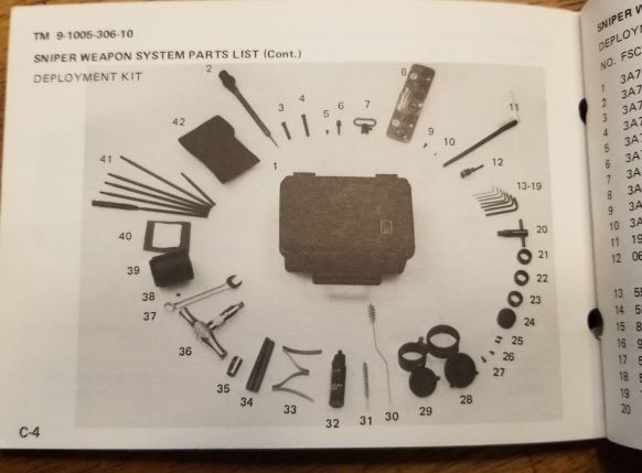

Remington was good enough to pack all these small parts and pieces in bags they numbered to correspond to the numbers on the line drawing in the TM.

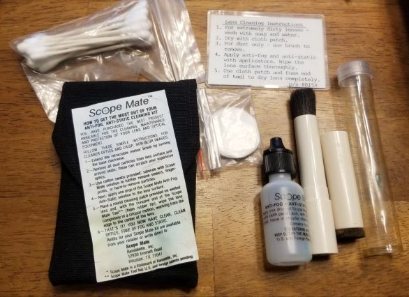

For those curious about the Optics Cleaning Kit, here is a photo of what's inside. Mind you, this is the early kit and has been replaced by the LensPen. Otis also makes an Optics Cleaning Kit very similar to this one.

<div class="ubbcode-block"><div class="ubbcode-header">Originally Posted By: EODsix</div><div class="ubbcode-body">For all you M24 enthusiasts out there that are in the process of building up your M24 Sniper Weapon System, here is a photo of the the D Kit contents. It's a little nicer to see a photo rather than the line drawings that are in the technical manuals. This is laid out exactly as they are drawn in the TM. This kit is the early style as evidenced by the Redfield Big Bore Sight Inserts, the Optics Cleaning Kit, the Day Optic Ring Screws, the Day Optic Windage and Elevation Dials, the Cleaning Rod and the Front and Rear Sight base screws. All of these changed when Remington changed the iron sights to OK Webber, the Day Optic changed to the M3 LR/T, and the Otis M24 Sniper Cleaning Kit replaced the cleaning rod.

Did you get the box along with the parts from Remington? Can you order these parts from them? Looking to add to my parts collection for my M24 builds.
Thanks
Re: Army M24 Build Thread
This box did come with the full SWS from Remington as did all the parts. This is the early DKit that was provided in the SWS. Back on page 12, Lockedandloaded posted a pic of the late model DKit. The older Pelican Box and later the Pelican 1100 boxes are no longer in production. The late model boxes are Pelican 1120 boxes.
As for parts, no you can't get these parts from Remington directly unless you can provide proof of ownership of a genuine M24. Most of the items can be had thru various sources, i.e. Brownells, Midway USA but some of the items are peculiar to Remington. That being said, the screws and other metal parts are parkerized and the cleaning rod (a standard M16 cleaning rod) is powder coated just like the barreled action on the M24. These parts in aftermarket will be blued, or in the case of the cleaning rod, parkerized.
I have a Pelican 1100 and an incomplete DKit that I'm preparing to sell off. I need to inventory it before I list it. If you're interested contact me PM.

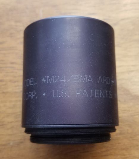

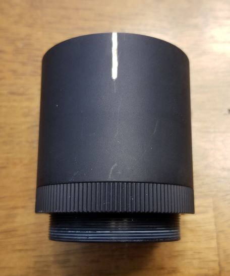

To update and somewhat correct the previous posts on the EMA and the ARD for the M24 I present the original issue EMA made by Decilog, cage code 2F218, part number 12950986, NSN 1240-01-380-6326.
This rarely seen laser filter is made of aluminum unlike the current and more common plastic version. It is issued with red plastic protective end caps and has threads and lock ring to fit the M3a scope on one end and 50MM threads for the ARD on the other, it also has the white line index mark. The issued ARD for this EMA is the large aluminum version made by Tenebraex, model number M24/EMA-ARD, NSN 6650-01-456-6515. The ARD is dual threaded to fit the M3a and the EMA.

This is the EMA and the ARD that is in the M24 Tech Manual. This EMA was added in Change 4 and the ARD was added in Change 7 though the NSN is misprinted. The actual Change 7 page has the correct NSN but the TM that has the changes thru Change 8 posted, both printed and digital, has the misprint.

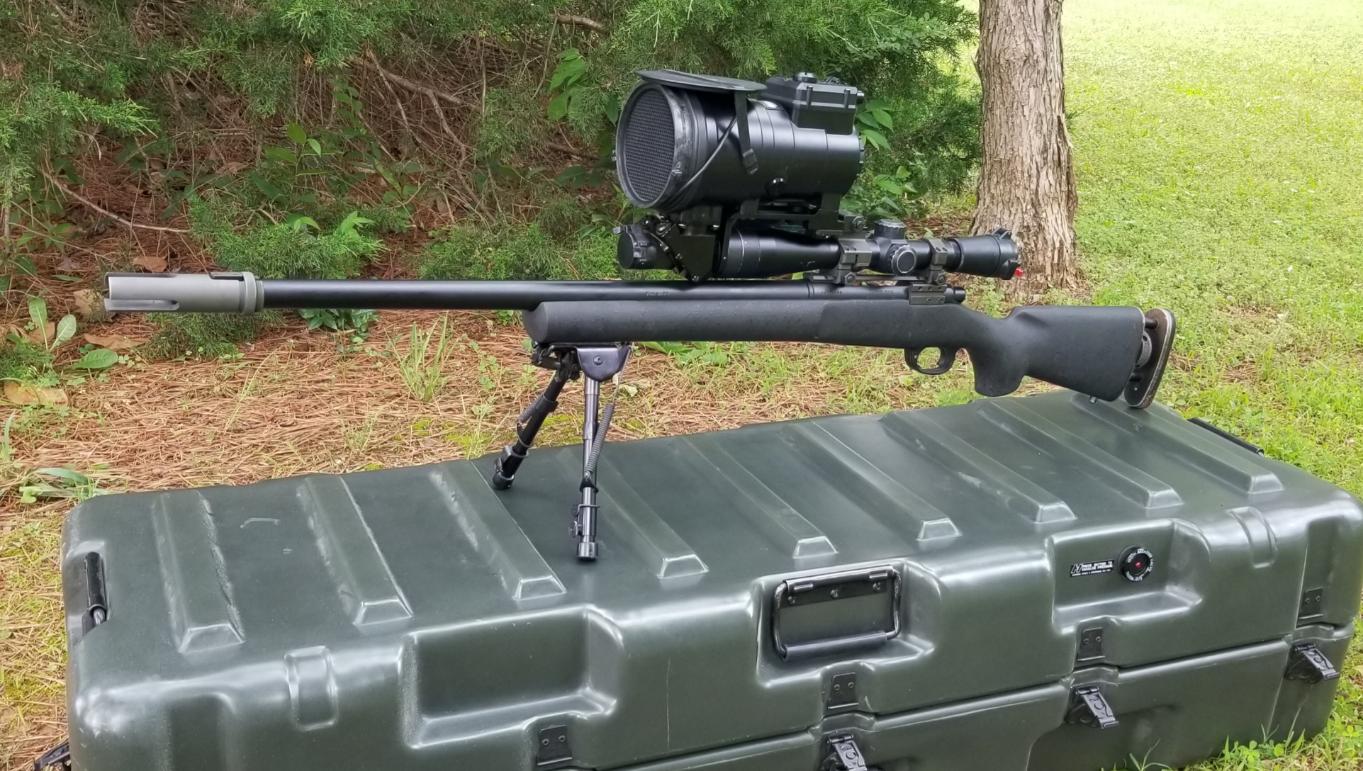

OK M24 sports fans, here's something that will take your M24 build over the top. What M24 would be really complete if it didn't have night op capability. Here's a chance to get a Simrad AN/PVS-9 for your weapon. They don't show up often so someone needs to jump on this one.
http://www.ar15.com/forums/t_7_163/10068..._kit__4500.html
Here is a shot of mine with my PVS-9
