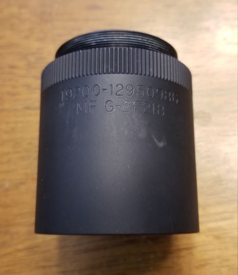

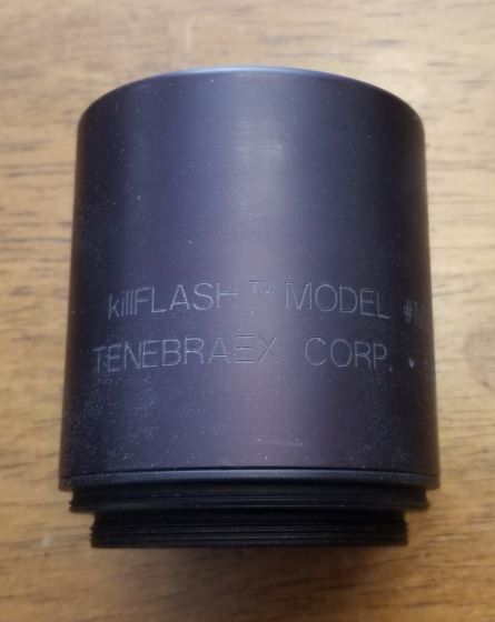

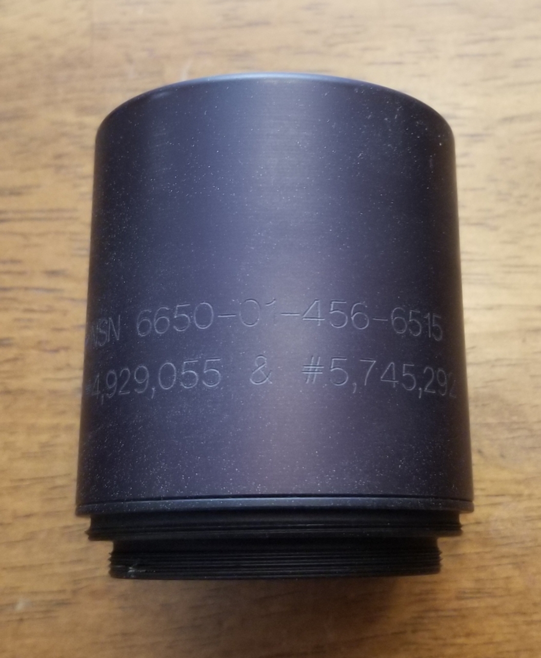

In addition to Lockandloaded's post on the EMA/ARD, I'd like to add the earlier EMA/ARD. Produced by Tennebraex Corp, it is a honeycomb only device, no glass. Seen here on top, it alone is as long as the newer version. It also has two sets of threads, one for direct connection to the M3A scope and the larger one for attachment to the EMA. NSN for this item is 6650-01-456-6515. If you're curious about the finish in these pics, don't worry. That's baby powder I used to make the engraving pop out. The finish is identical to the M3A/M3 scope.

DFOOSKING, Tennebraex manufactures ARD's for scopes, binoculars, spotters, etc.
Yours has a lock ring in the middle. Can the front section be unscrewed?

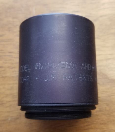

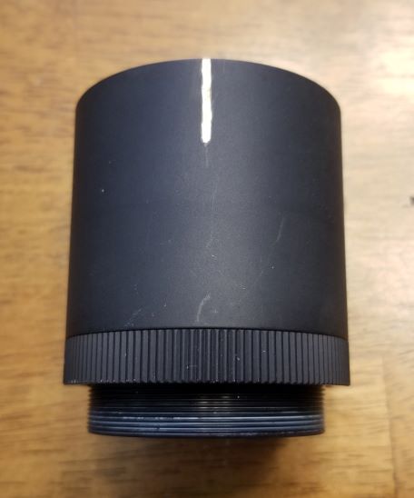

Both these EMA/ARDs fit both the M3A and the M3. Both are periodically available on eBay, AR15.com, Sturmgewehr.com or here on Sniper's Hide, you just have to catch them when they become available.

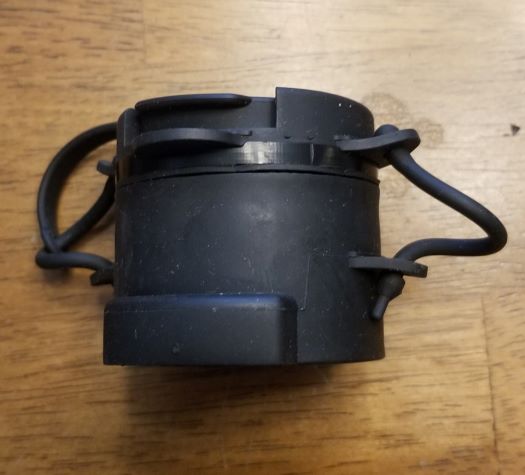

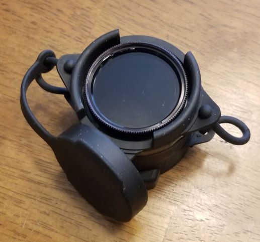

We've covered the ARD and the EMA/ARD for the business end of the M3A/M3 scope but let's not forget an accessory for use on the eyepiece side of the scope. The Polarized Filter from Tenebraex Corporation. It is made almost entirely of rubber and may be used in place of the Butler Creek flip up scope cap. I don't do it but it can be done. Used for shooting into a highly glared areas like windows and windshields, the shooter need only to rotate the bezel of the filter to "polarize" the glare out. The filter also darkens the view much like a neutral density filter would on a camera so if you don't need to use the polarizer you can unsnap it and place it out of the way. There is no NSN for this part, the M24 TM change 8 provides the contact information that the supply clerk may use to "local purchase" the filter.
