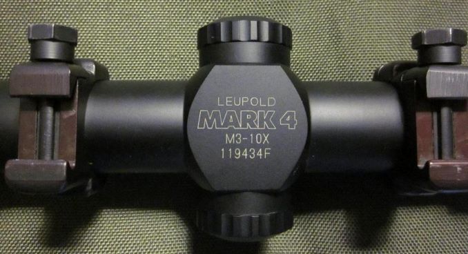

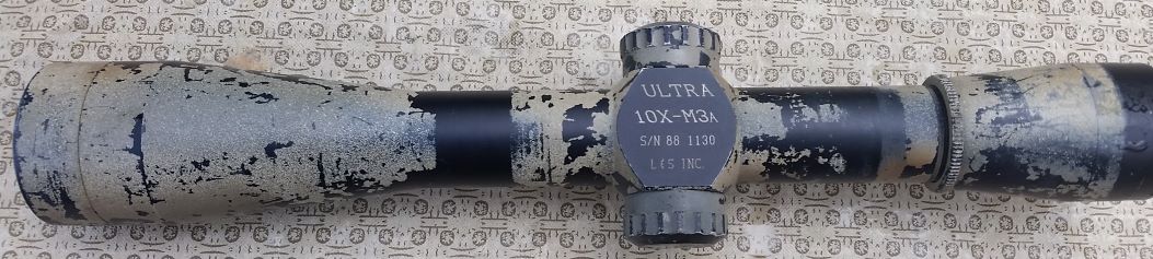

A question for the Army Snipers, are there any day optics in use that are marked "MARK 4 M3-10x" on the bottom?
I know there are the Ultra M3a marked scopes and the newer LR/T M3s with only a serial number that are in use but the MARK 4 marked are in question.
Thank you in advance for the information.
Re: Army M24 Build Thread
What Red6actual is asking is if anyone knows if the early Mark 4 M3 scopes were mounted on US Army rifles. We all know that the M3A was the first batch of scopes to come with the M24.

Later scopes that have been issued on the M24s have been the Mark 4 M3 LR/T scope that have nothing on the bottom of the turret than the serial number like Lockedandloaded showed us back on page 10. What he's asking is if anyone has ever seen this type of M3 on the US Army M24s

The Dec. 1992 Precision Shooting had an article I wrote about the Leupold Ultra scopes. This was prior to the internetz, and could be considered the 'dark ages' regarding sniper optic technologies.
But common knowledge at the time was the primary difference between the U.S. Army reticle, and the U.S.M.C. version, was how the reticles were manufactured.
The Army used a laser-etched glass reticle in the M3Alpha Ultra 10X. The Marine Corps used a wire reticle in the Unertl 10X.
To the users eye, the major difference is with the shape of the mil-dot. Army dots are circular, USMC dots are eliptical (football) shaped. There were also differences in the thickness of the stadia.
However, at some date, Leupold switched their reticle manufacture over to the wire-formed design. They also changed the name of their scope lineup from Ultra to Mark 4.
Not knowing the exact year Leupold changed over, I cant guess when the M3-10X was dropped from M24 production. However, I have documentation from John D. Rogers of Remington, stating the M24 contract had been finished circa 1995.

I have personally seen M3-10X LR/T scopes on US Army Sniper rifles, recent production runs as well with the Weber sights, 2 piece Leupold bases, etc.
I also own a Mark 4 M3 and M3 LR/T that have glass reticles, and had a wire reticle M1 at one point.
The Ultra M3a may have been dropped from production since Leupold stop producing them and started the MARK 4 line, and then the M3-10X LR/T came along and has been issued and is in use.
I even have 2010 production M118 CCW elevation cams for the M3 LR/T.
The question remains, any confirmation that "Mark 4" marked scopes were issued?

Nice information on the date codes but it should be noted that these codes do not apply on the M3As as all guesswork was eliminated by actually engraving the date as part of the serial number.

I'm not sure of the date that the Ultra M3A changed to the Mark 4 M3 10X either but I'm fairly sure that the Mark 4 M3 10X changed to the the Mark 4 M3 LR/T and that was 2000. In that change the dials reversed their rotation from clockwise to counter-clockwise. A change that I found counter intuitive but that's just me.
Not sure of the dates that changed the reticles from glass to wire but they have since changed back to glass, another date I'm not sure of. Both the M3A and the M3 10X above are glass reticles confirmed by Leupold. The M3A is circa 1991 and the Mark 4 M3 10X is circa 1998. A friend of mine has a factory M24 circa 2006 and it has a M3 LR/T circa 2006 and it too has a glass reticle.

I have seen the MK 4 M3 variable 3.5-10 on a students rifle at Benning, do not know about any others like the 6.5-20 used on the M2010.
You might find a MK4 M1 in use as well as those are in the inventory but I have no evidence of use on the M24.
