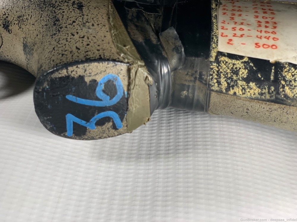

Sorry if this is already covered in this or some other thread, but I’m going to be lazy and avoid scanning through 24 pages of posts by asking here and now.
The M24 Rebuild that I have has some numbers written on the butt pad of the formerly issued stock. Does anyone know if this is common and if there is any significance to the numbers? Rack or team number perhaps?
Thanks in advance.
My guess is a maybe a student gun number from a school house, like as in “rifle #52” (out of…well at least 52 😂)but the number isn’t in a local that I’ve seen durn my time at SOTIC/SFSC. and the location is kinda weird, like you couldn’t likely read it from the rack but that orientation is perfect for identification of the rifle from the firing line BUT seems like it might wear off quickly through. 🤔
It may possibly fit the 3 digit team numbering convention of SF, as in “0 = 10th SFG(A) 5 = 2nd BN/B Co. And 2 = 2nd ODA. It looks about right for the mid-2000’s which is when the change over to the 4 digit convention occurred. SF held on to the 24s all the way end but it is totally possible that a M24 could have been marked in such a way in the mid-2000’s and survived updated alterations by some junior Bravo will a paint pen. The SR25 was gaining a lot of favor in Iraq for DA support, so sidelining the M24 was understandable for that period.
But honestly 3 digits is pretty vague unless someone has some personal insight.
Rudy that's a great description, and it could be the best guess. mjh30 said maybe the last 3 digits of serial # which I agree with, but the M24R doesn't come with original rec'r or bolt handle to confirm. kft101 disassemble the bottom metal and look if the original serial # is engraved on the mag box or floorplate.
Thanks for the advice! No serial numbers or other markings on the bottom metal that I can see, unfortunately.
Hmm, the stock from this M24 Rebuild also has 3 digits marked on it, but on the right side of the butt this time. So looks like mine isn’t just a one-off. 🤔
I think it's fairly common. I have one as well with numbers on the right side of the stock, also marked on the bottom of the grip.

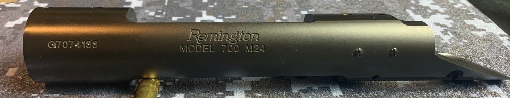

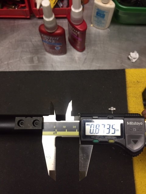

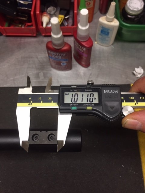

Can someone measure the center of the front sight base to the muzzle? I picked up a M24 marked receiver and am building my rifle in 30-06. I need to know where to place the front sight. I guess I should add that I have a bunch of M-2 Ball thats why I am doing this build in 30-06. Thanks!
Looks to be around 1.375
Reactions: superdave269
Thanks Whitetailnut, So centerline of sight to muzzle is 1.375 got it and Thank you!! Thata a big help for me.

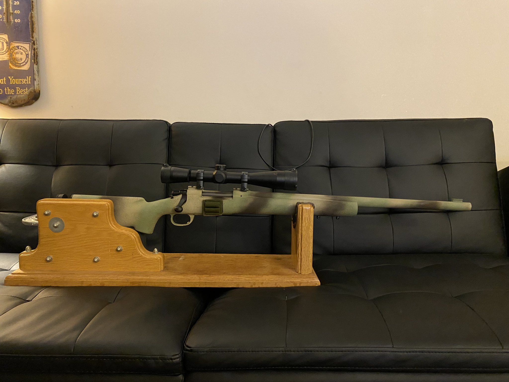

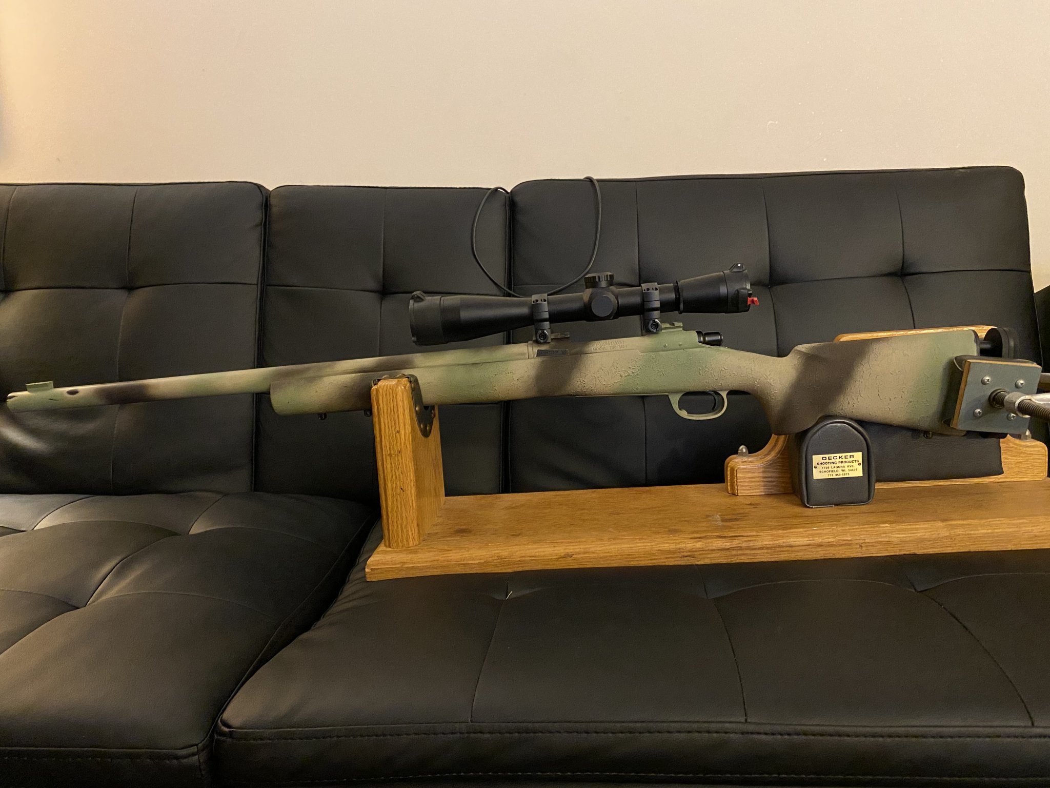

I really don't have any pics to share at this time so I will start with my receiver. I'm leaning towards using my 700 30-06 long range rifle as a donor to get things started. I will cutting the barrel to 24 inches and now I know where to place the front sight base. It's a heavy barrel but Not a 5-R barrel like on my other Remington long range rifles. So at some point I will be changing the barrel out most likely to a 300WM, time will tell on the later caliber.

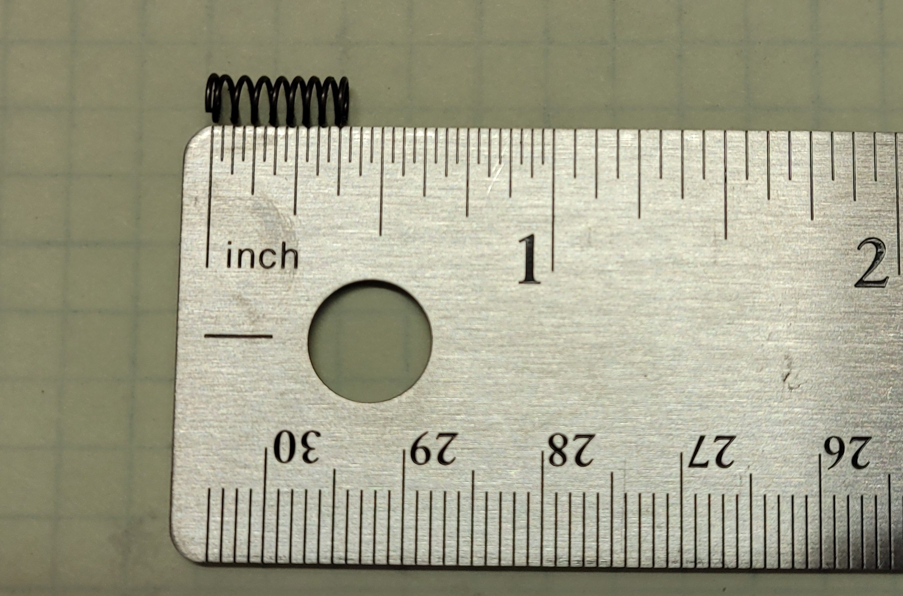

If anyone has a spare M24 trigger, could you measure the length and width of your sear spring? Mine went flying when I went to install it, and i want to make sure the spring i found is correct.
It's around 3/4" long and 3/16" wide.

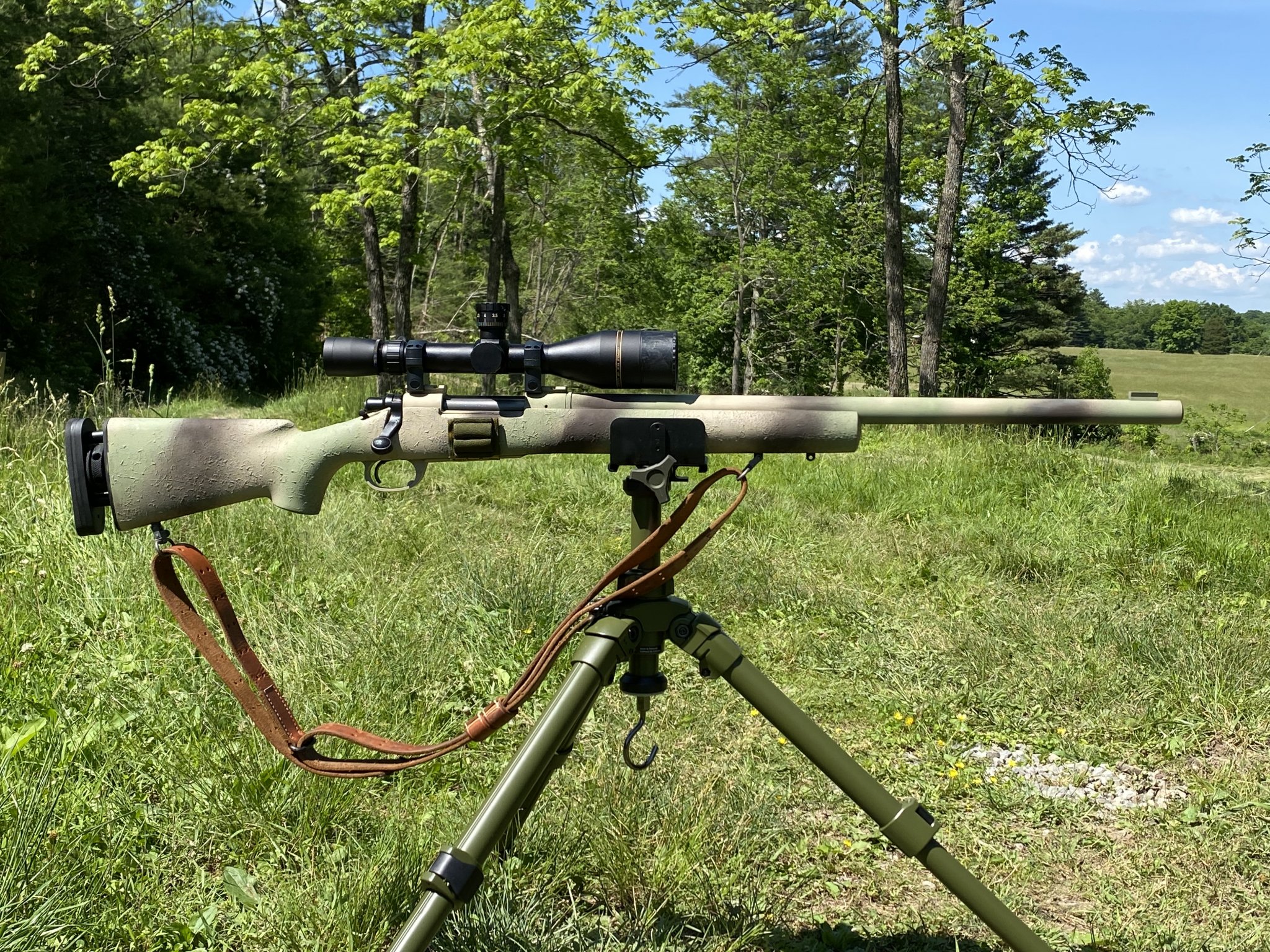

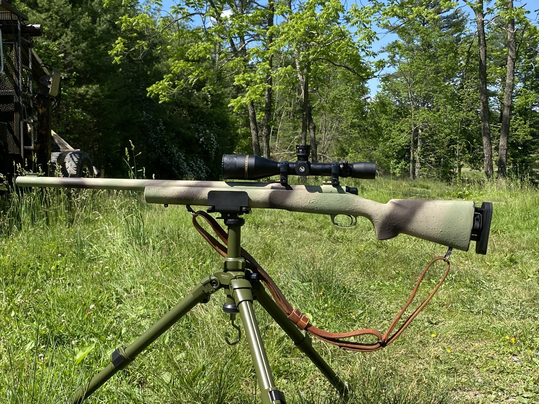

I ended up getting one of the Eurooptic M24s at the beginning of last year, finally got around to getting a scope on it. It's not correct for an M24 but I'm happy with it anyways. I eventually want to get the iron sights but that seems near impossible since I don't even know what rear base is supposed to go on this one.
Looking good .
