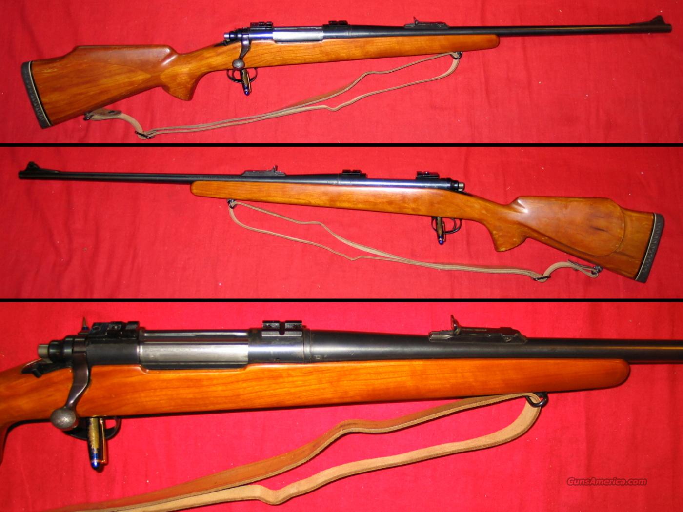

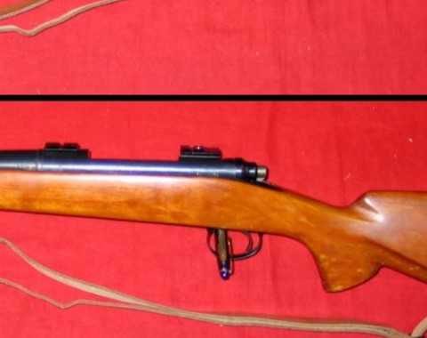

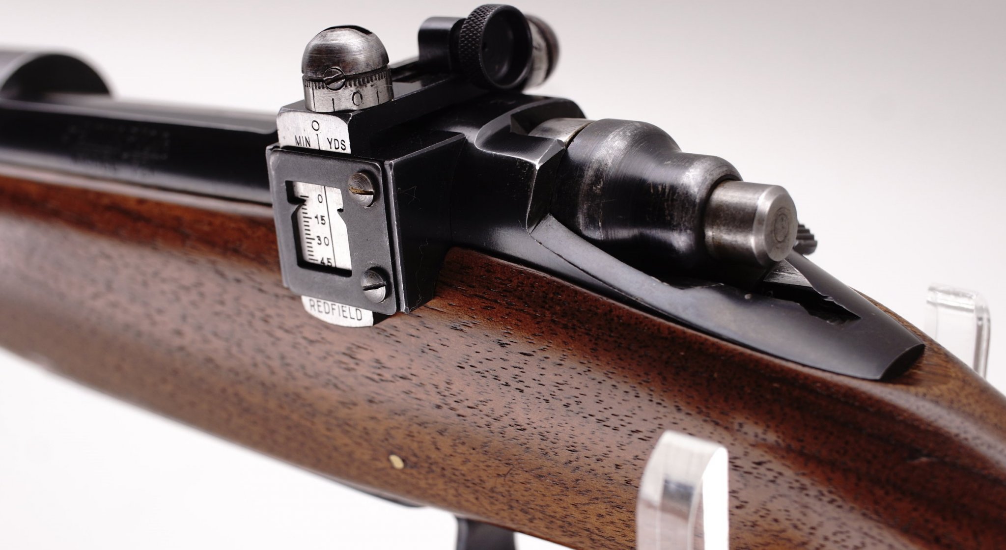

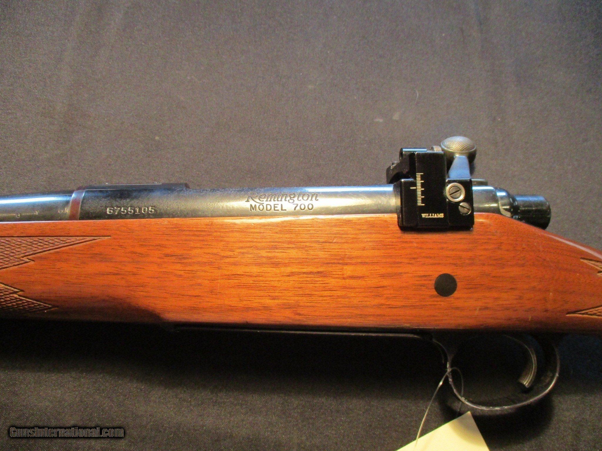

Did they have provisions for a front sight as well?
Yes. Look at any hunting rifle from the 40-70's. My grand father had a similar Peep on a sporterized 03.
Blurry zoom but shows the screws.

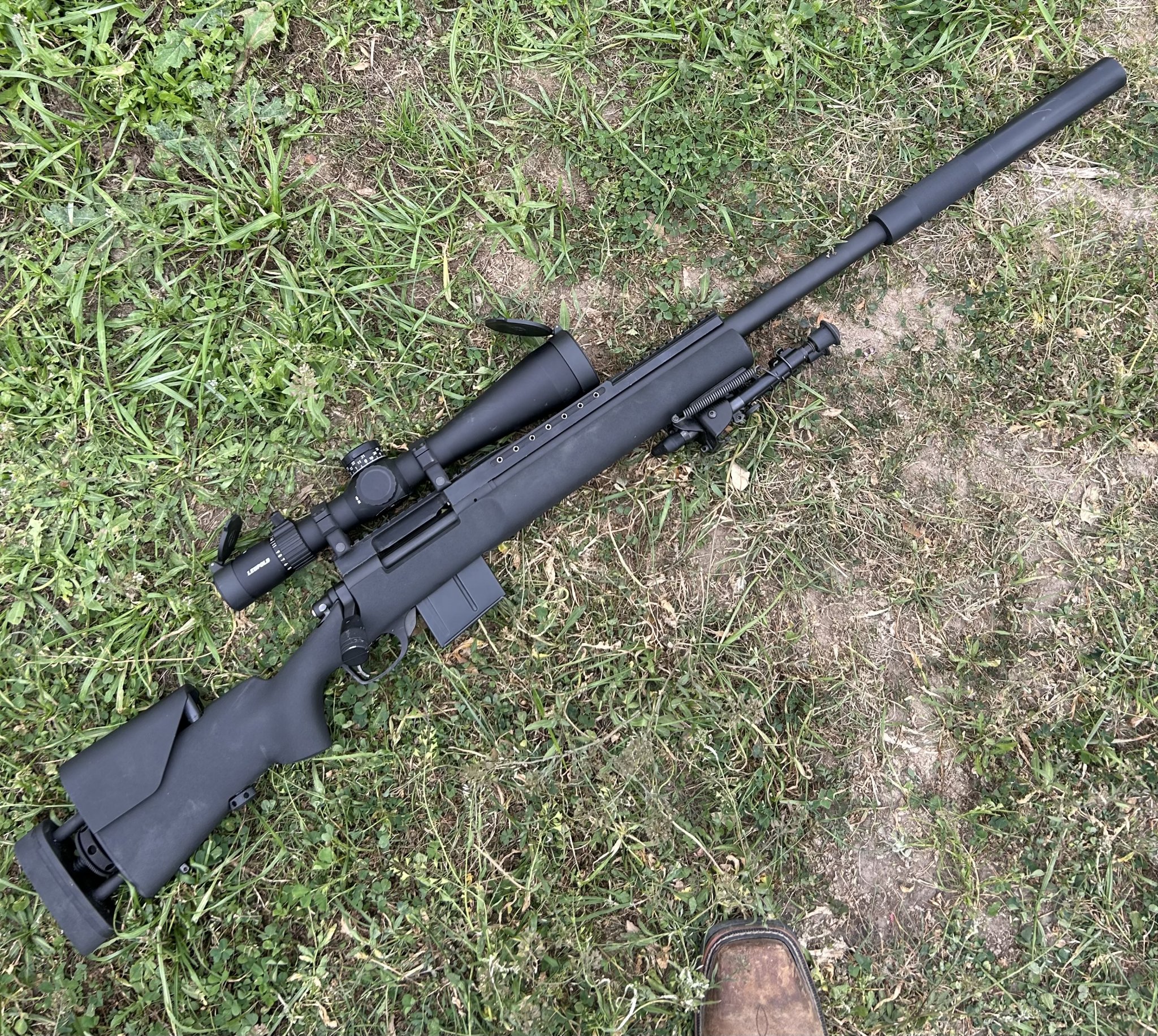

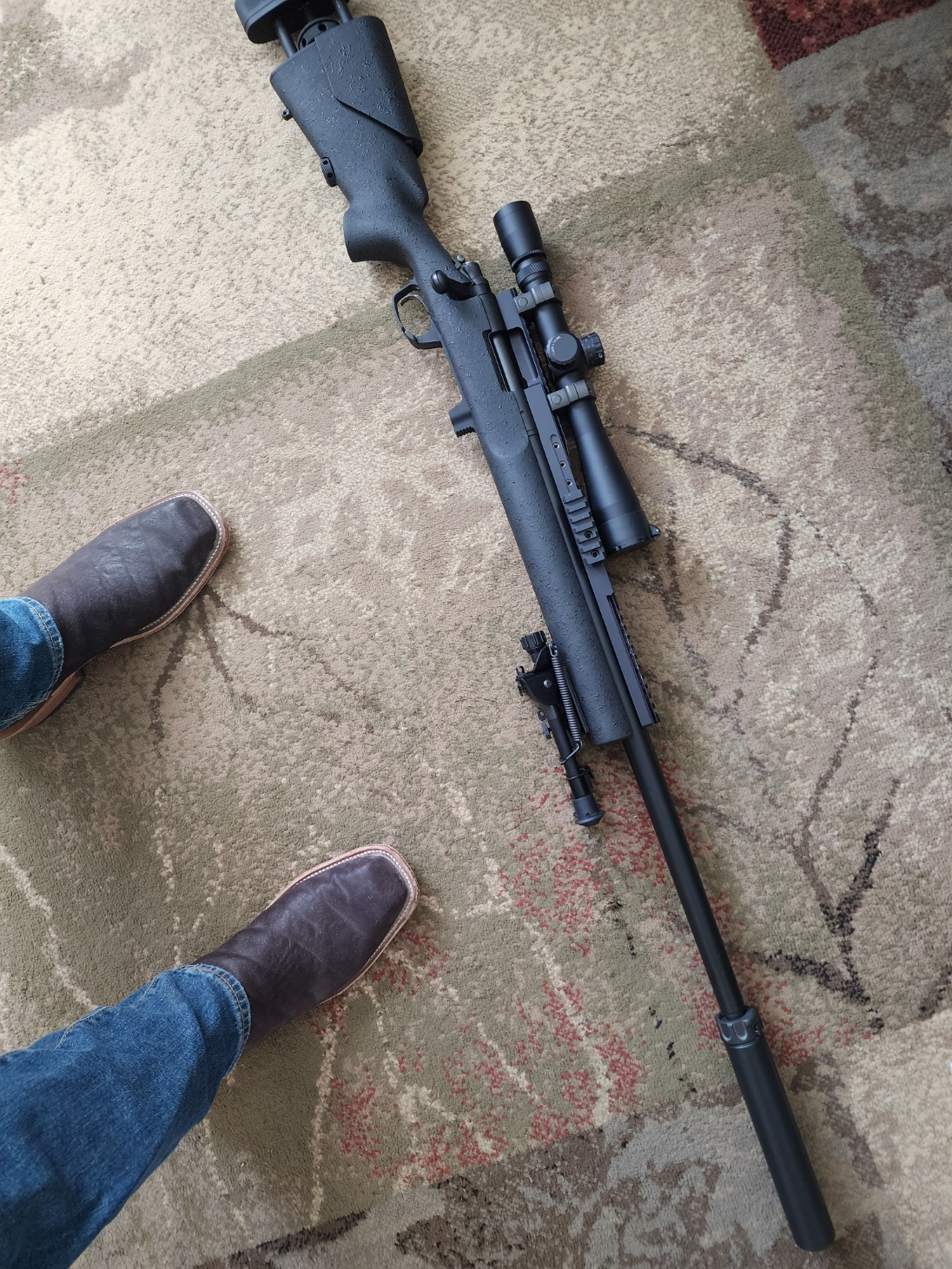

Finally finished up the my short action m24 build. Picked up the barreled action from ilikebmxbikes, has all the m24 markings on the barrel but was threaded from factory and is a short action so kind of a cool oddity from the liquidation. Now just trying to figure out whether or not to try to build out my other m24/xm2010 action or to sell for a different project lol
That turned out really great!
DW
Reactions: sinister
Dude just build it out. Do it.

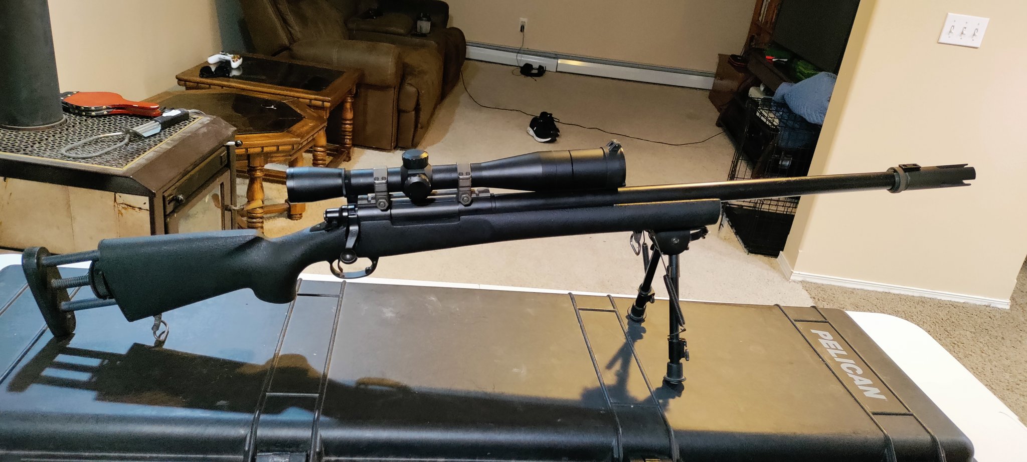

Looking for an OK Weber front sight for my M24 project and a Flash hider.
Any help would be appreciated.
Thanks,
Lu
I believe the front sight came from RPA, although I am not sure which model. With regards the actual flash hider, I for one have never seen one for sale that actually fits the larger front sight base used by the RPA.
The Redfield
version of the flash hider would be fine, the difference is the lock ring which is taller.
