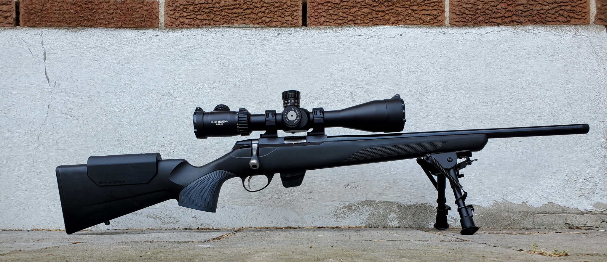

I have not used the DB tactical, but I do own a Gen 2 Argos [ MOA 6-24x50]
For the price tag it's a nice scope
Decent glass, especially <50yds. Not great, but decent
Turrets are good, audible, crisp clicks
Side focus ring is very good, precise and accurate yardages
Zoom focus ring is very rigid. It works fine but it's not butter
Eye relief is short
Eye box is tight, especially at higher magnification.
Bonus : comes with flip caps, and most vendors will send "free" sunshade.
All in all for the price-point I wouldn't hesitate to recommend it as long as you know it's not the end-all and be-all scope.
