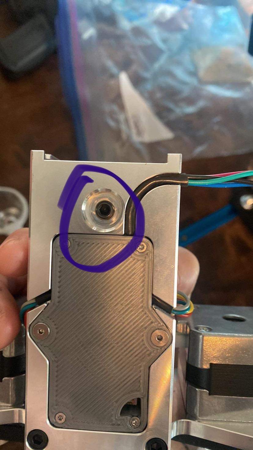

The fact that there is no way of adjusting tilt other than tape, cards, Legos, etc. is another issue. The prototype units that Adam showed has a setscrew in the bottom rear of the unit to do this. Production units do not. Kinda defeats the purpose.
The Beta units have the set screw. I really like it and have recommended everyone drill and tap a set screw there. Is a shame the production units don’t have it.

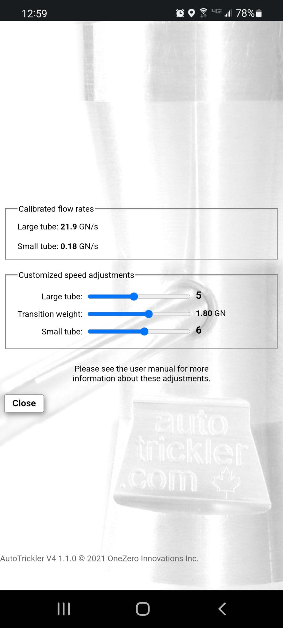

Video is a little long. But does it look like my trickler is not adjusting speed regardless of me changing the speed or shims.
Terrible device worse than my charge master lite. Maybe someone can offer some resolution.

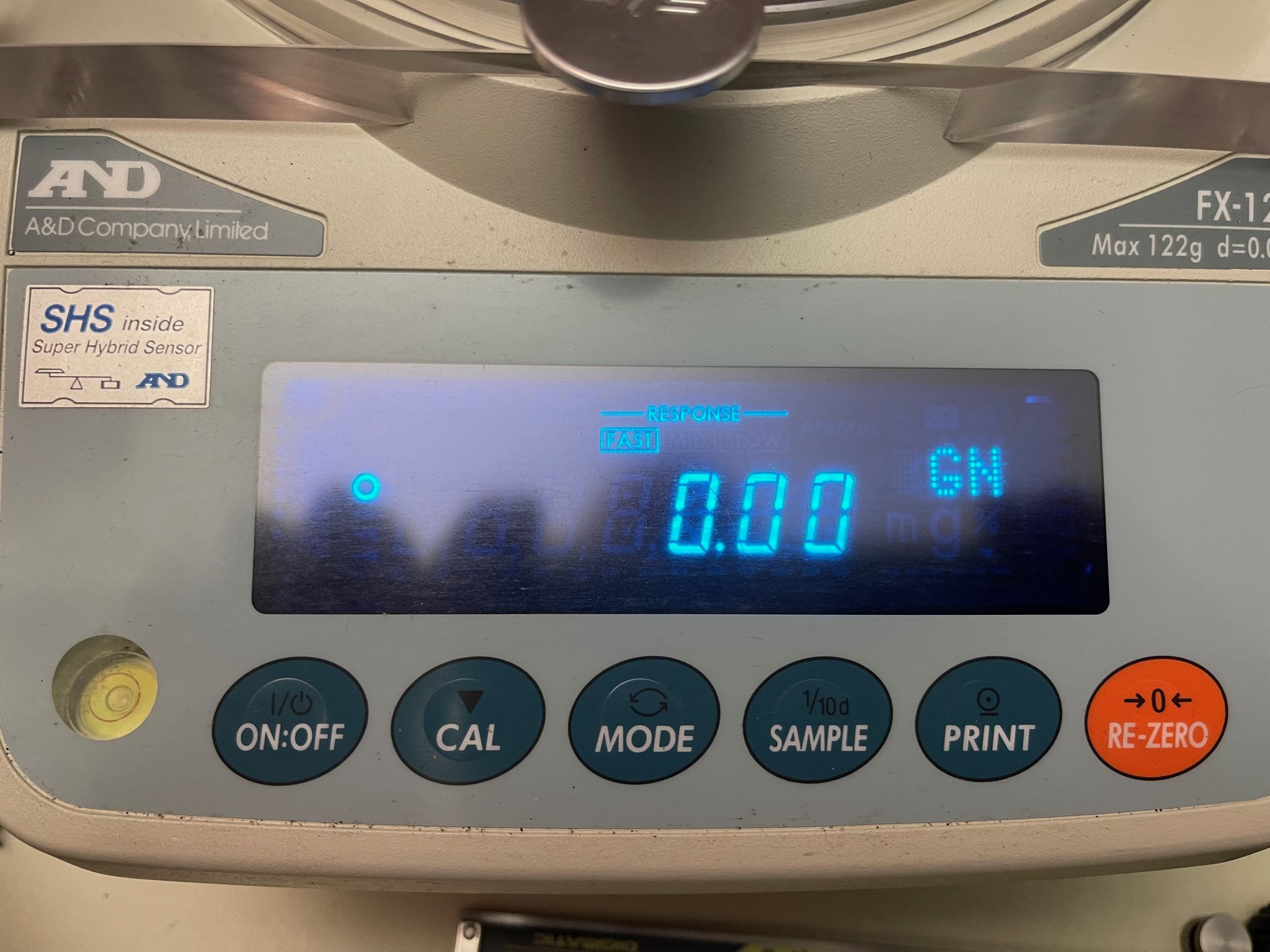

Yes. Scale works fine. I actually started over and took everything down. Recalibrated the scale internally and external weights. I will try to send to Adam I guess. If he responds.
I am not aware of anything else I need to do with the scale.
And did you come from a V3? Again I apologize if you mentioned this already. I know for the V3 - unless you got it from CE Products - you had to go into the menu and reconfigure the serial port. I noticed in your video that I dont see the FAST icon on the display - so you might want to check that its configured as per the instructions below (notice what my display looks like when turned on).

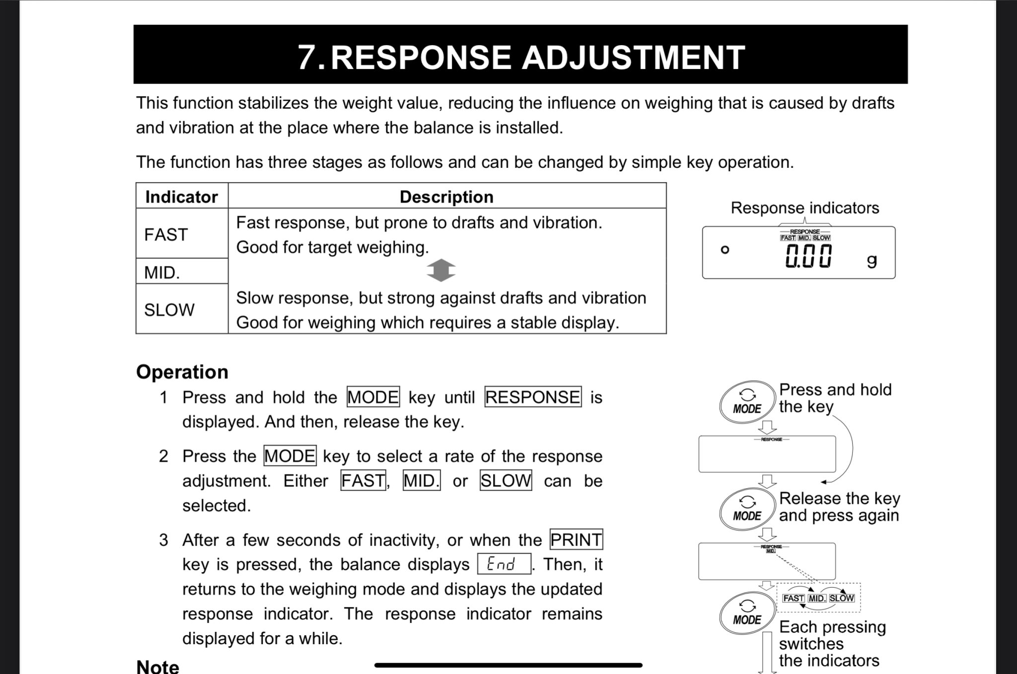

I think @Sebrock may be on to something. Your scale isn’t sending updates fast enough to Autotrickler to get it to make useful use of the calibration. I bet that’s why you have an overthrow.
give it a shot and maybe it’ll help.

adjusting the tilt is the whole point of that set screw in the back.
Understood. But mine was overthrowing all the time. And it appears everyone who has commented has suggested some degree of overthrow. So I was suggesting that perhaps the device never underthrows to cant it up from the back with a set screw.
.11 on small tube is not normal. .15 to
.2 is nominal range. I also watched the stall during the calibration. That is a flow issue. You shimmed the wrong direction. You shim in the back, tilting the tube forward so it will flow without stacking in the small tube.

I hard reset scale to nominal and reprogram as @sebrick suggested and it is working well. Appreciate all the help. Will see how things work tomorrow and whether my scale will hold these settings. I may have a faulty scale since my original throws the first day worked. And then this happened. I Appreciate all the input and help. If it works again or if I have to reset scale again then at least will assuage other members angst about buying this trickler.
If the scale resets itself I would disconnect the auto trickler - reprogram the scale and see if it holds. This way you can isolate the issue to one or the other. My guess is that its the scale though. Happy its working for you now though.
