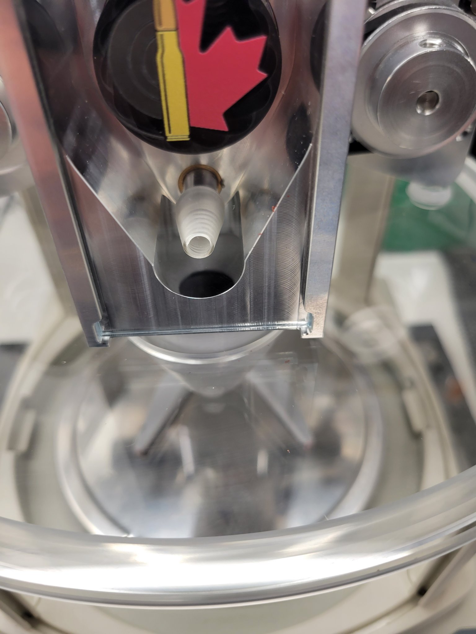

I have been using the @jthor tip here recently, and it has seemed to add a bit of speed. I'm going to fire up a live stream on the Primal Rights youtube channel in a while. You can tune in to see it in operation with a variety of powders.

I finally tried to set mine up tonight. It is way under on the small tube flow rate. I’m disappointed in the design. It’s not obvious to me how to shim the back, nor does that seem like a reasonable design. I’m not interested in another tedious hobby, I want a device that just works.
You can tap a screw wheel. Or, like me, use blue painters tape... 😆😆😆
Currently testing reducers for the small tube.

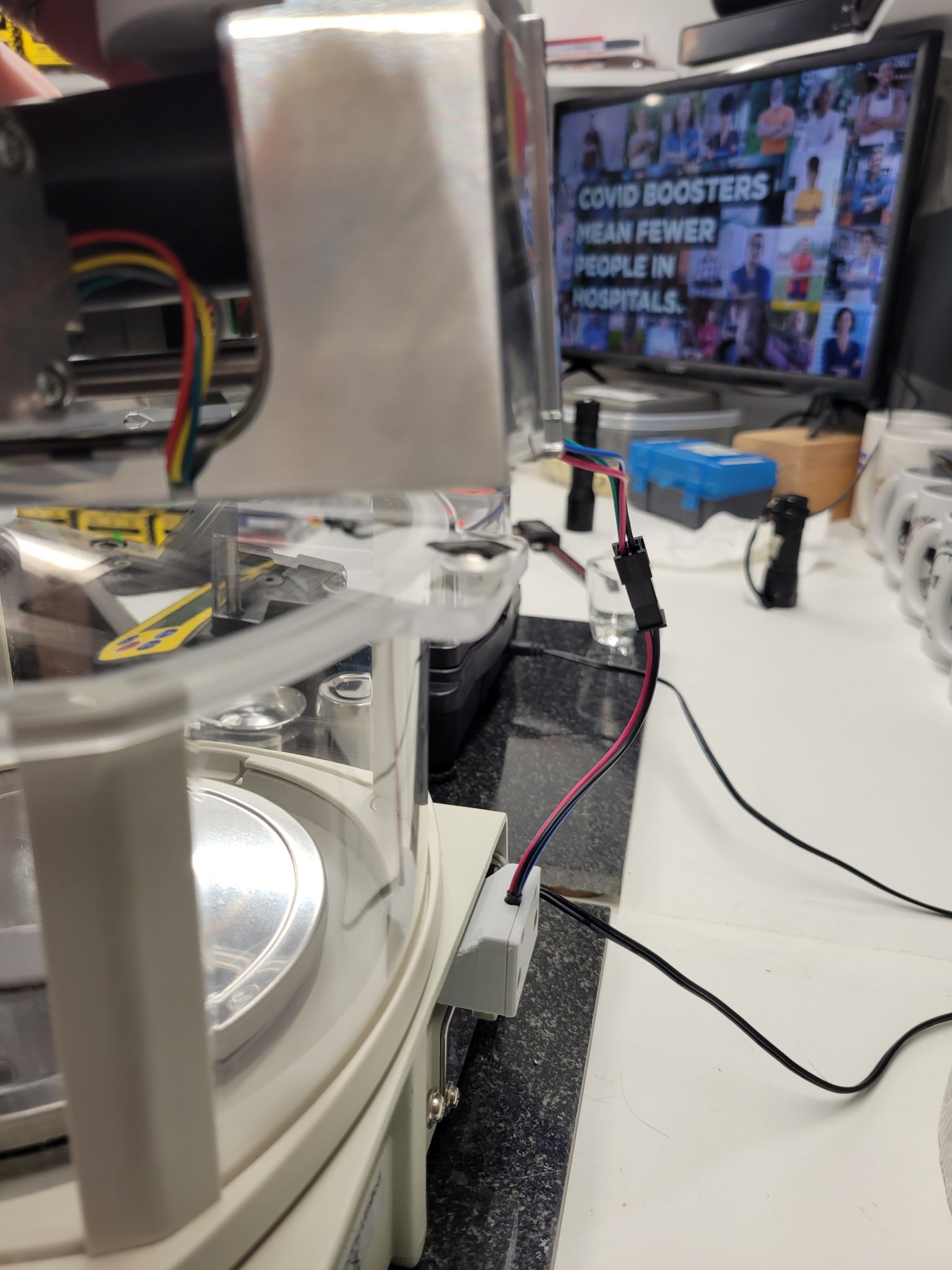

Where exactly do you shim it with painters tape? Do you have a picture that you can share? Thanks
Why not just use the scales feet. It already has a bubble level built in and the scale really doesn’t care if it’s not perfectly level, as long as you leave it that way. I’ve had no problem with minor adjustments using the scales built in feet.
