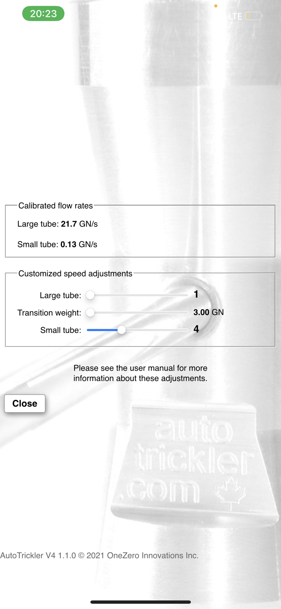

Mine is really struggling with overthrowing. Settings below still inducing overthrow at least 30% of the time. Scale is level and all setting confirmed per the manual.it’s significant overthrows from the large tube never even needing the small one.
Mine is really struggling with overthrowing. Settings below still inducing overthrow 30% of the times. Scale is level and all setting confirmed per the manual.it’s significant overthrows from the large tube never even needing the small one.
Tilt it forward, from the back. Get the small tube flow rate to .15-.2. Mine runs better closer to .2. I am at .18. Then you can adjust speeds to get 10-12 second throws that are accurate. Mine speeds are set at 5 and 6 and transition at 1.8.
It’s not even using the small tube when it overthrows so I don’t think it’s the small tube flow rate…
