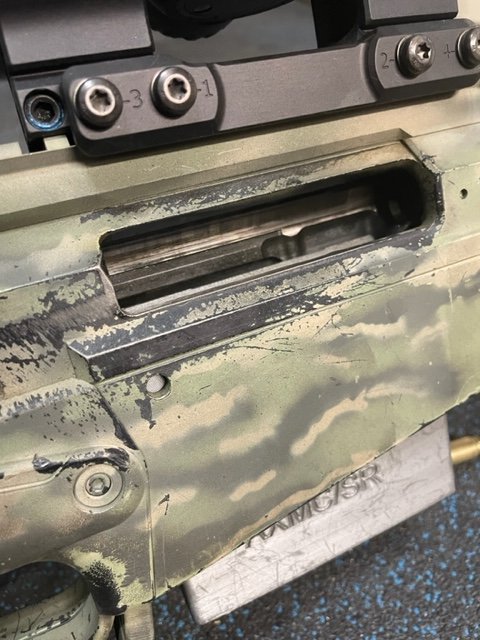

As far as to where the cases hit or expected ejection marks, my MC has over 8000 rnds through it using these calibers,6.5CM,308,300WM,300PRC,300NM and 338LM, here is a picture of the ejection port area.
Damn that’s nice. Nothing like beauty from natural wear and tear. I was just curious because having had my rifle go in for work and the ejector and extractor being worked on I just wanted to make sure that was normal and nothing regarding my extraction was weak.
Nice rifle, What colour did it start as?
Isn't that a mechanical ejector? If so brass extraction and patterns all depend on how you operate the bolt. Limp wrist it and they dribble into the action
Reactions: 37L1
