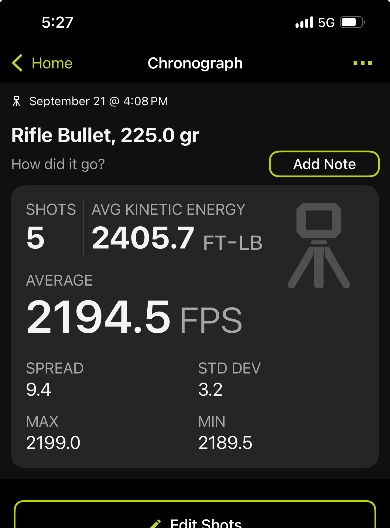

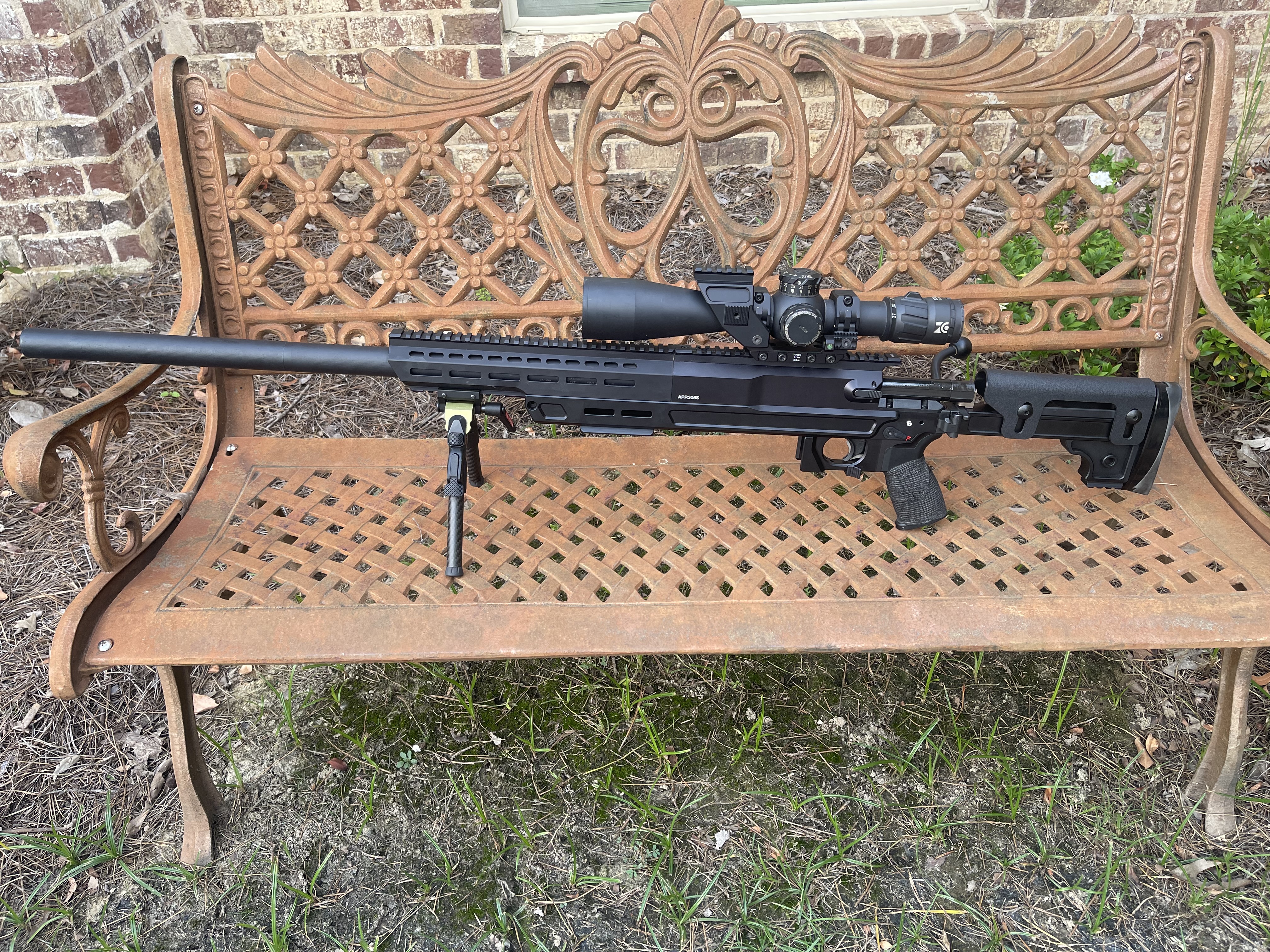

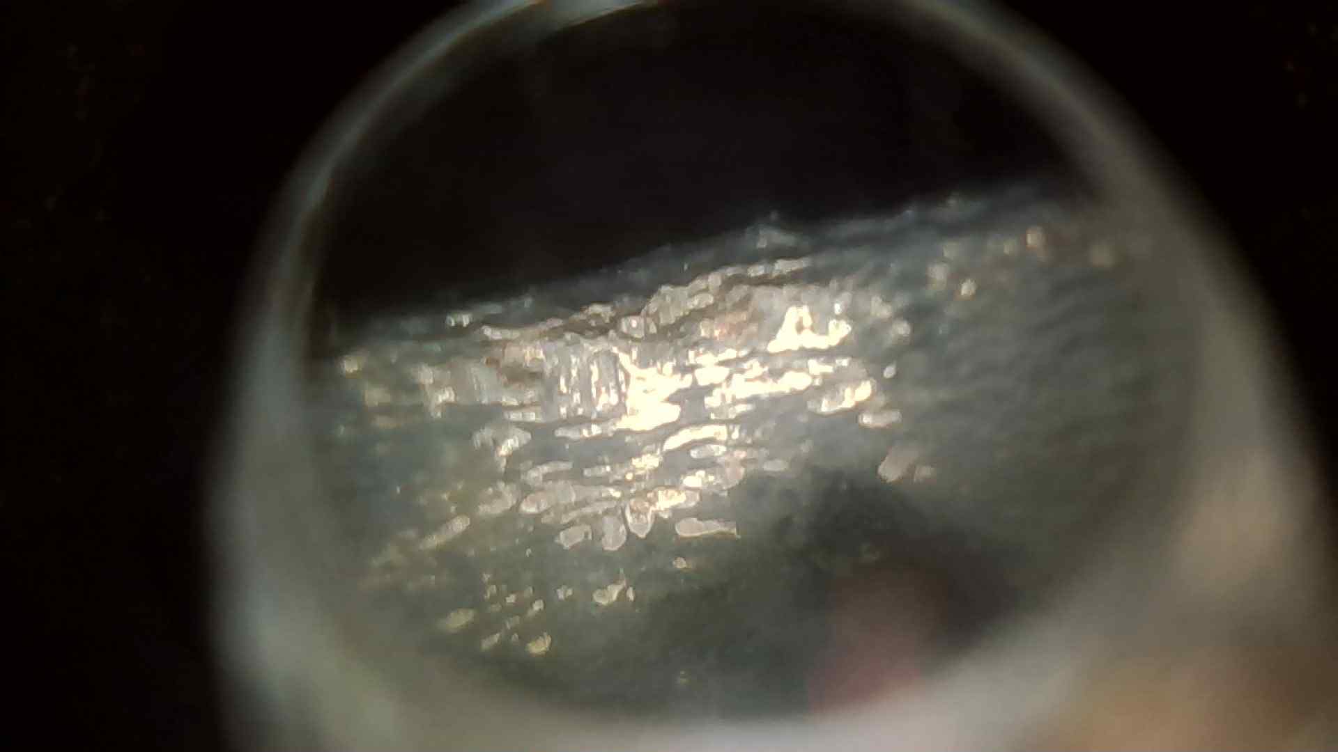

So first off I can’t believe I’m about to say a gun that cost 8k is at best getting me between 8-24” groups at 100yds 🤦🏼‍♂️ after figuring out the barrel is 1:8 twist an not 1:10 like the manual says it is I started trying heavier bullets. 175,180,200,225. Even subsonic ammo is about a 50/50 shot of hitting a ipsc steel @100yds. Everything seems tight. No baffle strikes and what bullets have impacted paper are not keyhole.
My loads are consistent with nice SD’s. I am at a loss here. Thinking about paying the pro shop at the range to see if they can zero it. Take myself out of the equation.
So first off I can’t believe I’m about to say a gun that cost 8k is at best getting me between 8-24” groups at 100yds 🤦🏼‍♂️ after figuring out the barrel is 1:8 twist an not 1:10 like the manual says it is I started trying heavier bullets. 175,180,200,225. Even subsonic ammo is about a 50/50 shot of hitting a ipsc steel @100yds. Everything seems tight. No baffle strikes and what bullets have impacted paper are not keyhole. View attachment 8772262
Do you think the guns lack of a zero causes it to shoot 8-24” groups at 100?
Reactions: Terry Cross
Try some factory ammo, but if you're getting single digit SDs, you probably know how to reload.
Contact B&T. There's clearly something wrong with the gun. It can happen to anyone. Their US customer service used to be lacking, but these days it's generally excellent with a dedicated office.
