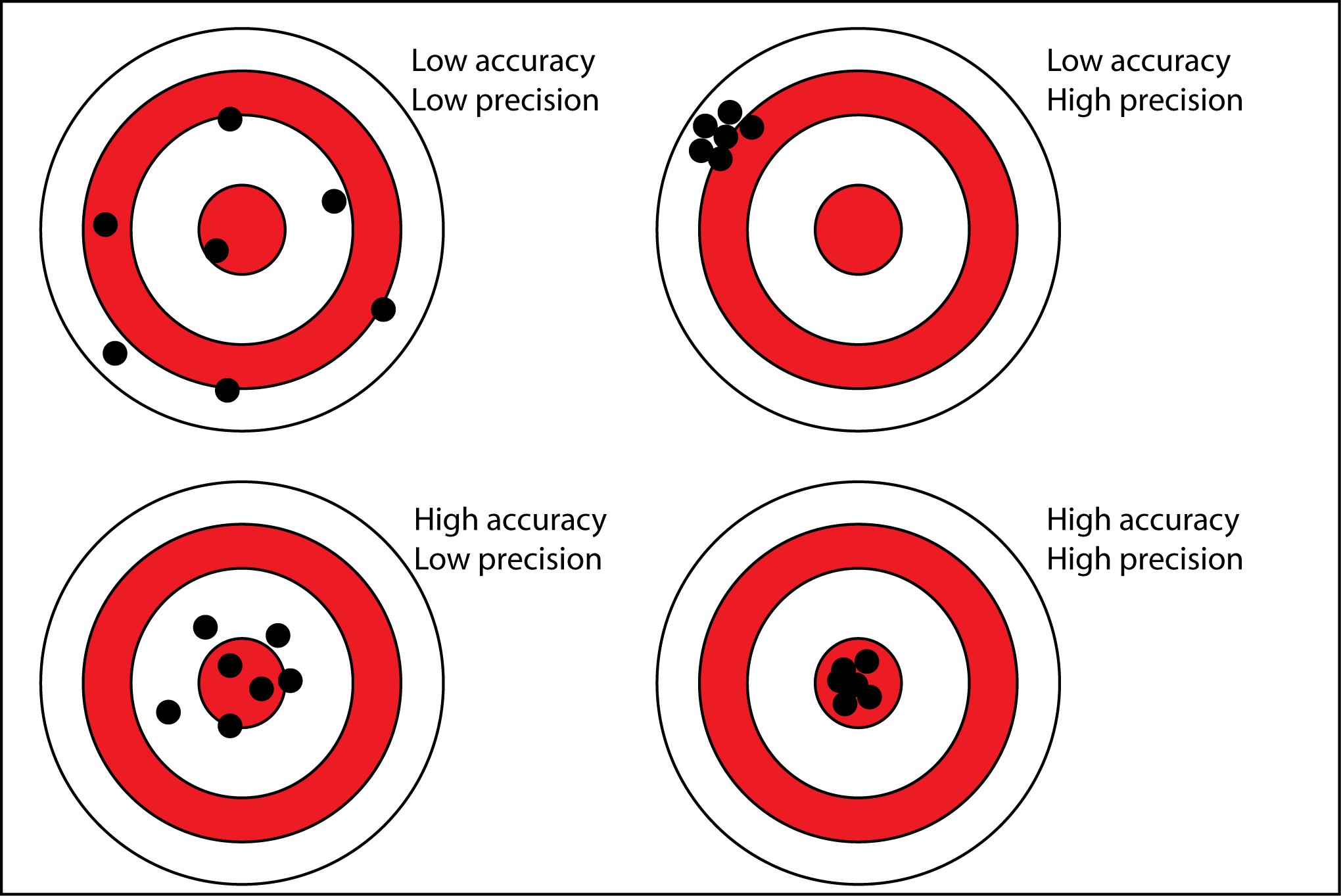

Me to Me. So why work on a new means of boresight and zero? How accurate is a rifle, or a good scope, and good ammunition, whether factory or a hand load? Well, define accuracy and precision. So, what is the accepted standard for a good rifle, a good scope, and good ammunition? All these should get you within an inch of your point, given manufacturing tolerances, if not, why not?
