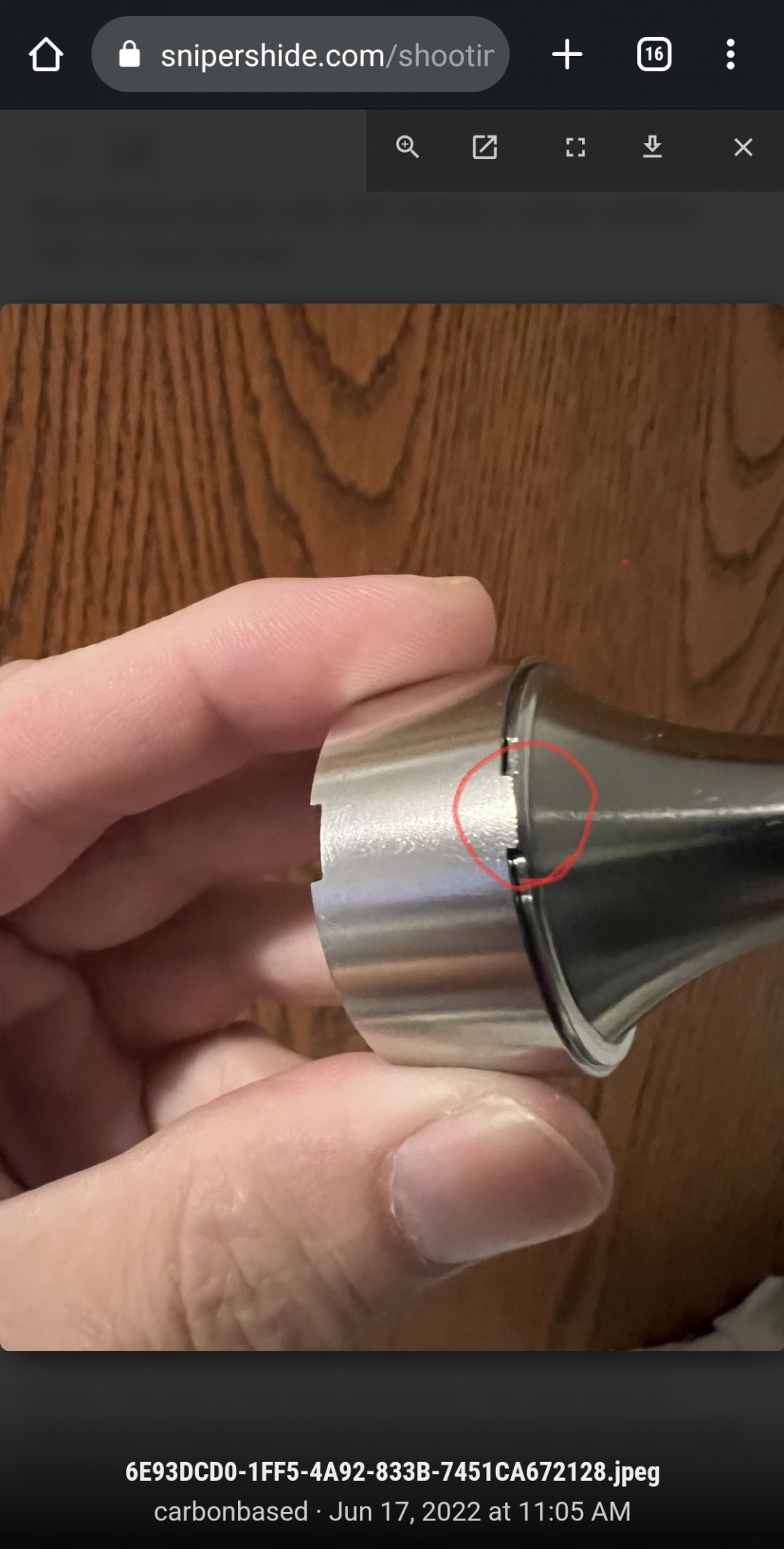

I'm sitting on a plane... so I can't take a picture of the actual baffle. But basically the circled tab broke off.
So what I am trying to say is on this baffle, the tab is really a shelf. It’s a simple right angle with material relieved from the right and left of it.
I’m trying to wrap my head around someone grinding off an entire shelf off of baffle (vs a freestanding tab). Love to see a pic.

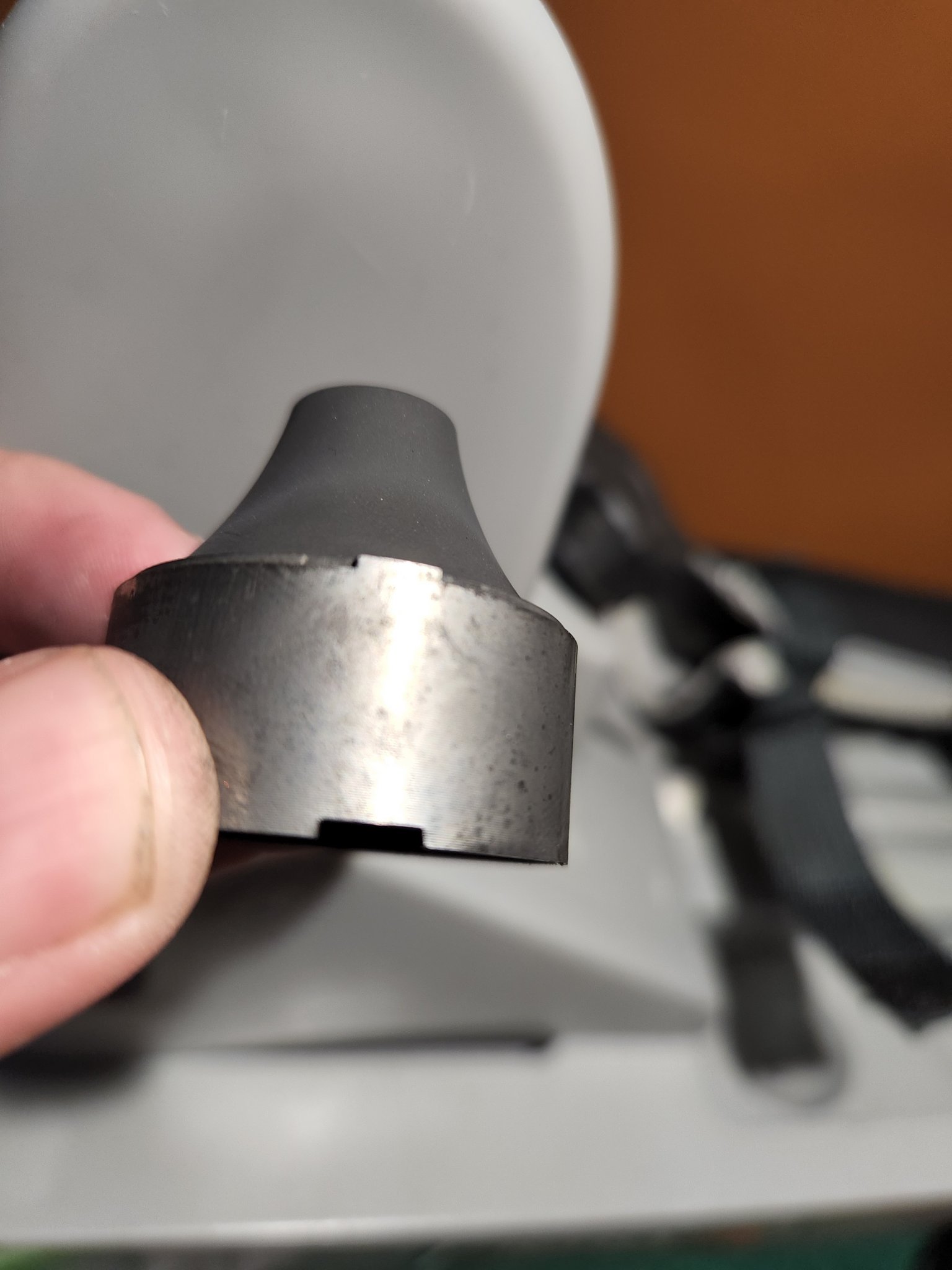

Here is a picture. The alignment tab is broken off... vs one that didn't break off.
Reactions: carbonbased
Therefore that one will not seat and keep the alignment of the baffles. Currently I am using that one as the first one into the can, so at least the baffles will align correctly, but the whole baffles set can still spin. Not sure what the affect on accuracy is because of this? I've been hesitant to keep shooting it like that.
Whoa! That looks like a straight up warranty issue. I’d reach out to Silencer Central. Don’t call Mack Bros, as they will just refer you back to SC to start the process (been through this with a non-warranty issue).

I have a Banish 30. Somehow I broke one of the tabs on one of the baffles. Not sure how. I emailed the company to see about a replacement for it without a single reply. I'd like to see better customer service before recommending.
They have a warranty.
Those guys are super busy selling new cans for commission(reason they shouldn’t have them in commission in my opinion) just call and talk to customer service
Called 3x so far and one email. They keep telling me they will send me a warranty return kit... must have gotten lost in the mail... guess I'll call again, and keep you all informed of the progress.

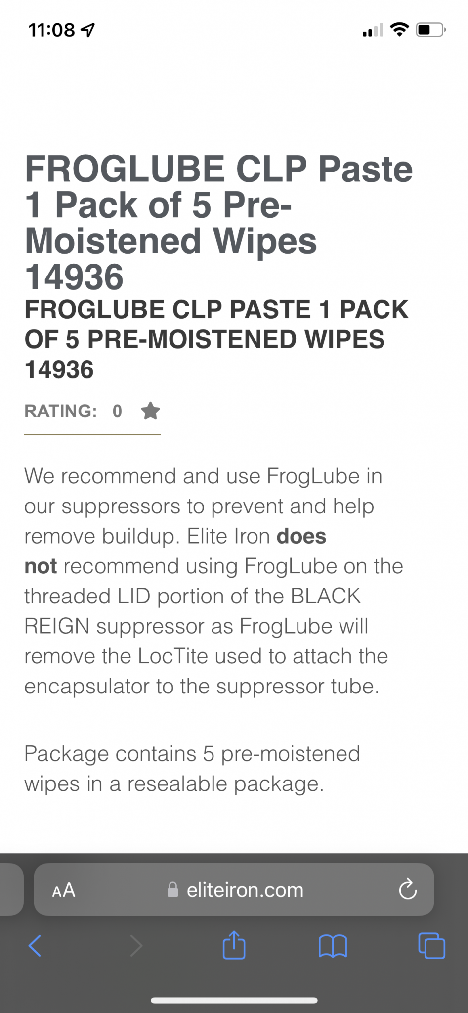

I really like the frog lube for cleaning cans
Reactions: MarinePMI
Well, son of a gun. I used Froglube to lube a stubborn brand-new Savage A17 (17 HMR), which was my first and only Savage. It was a complete POS that didn't cycle more than 5 rounds even after a trip to the factory. I just remember that Froglube overwhelming minty smell and I guess I associate it with that darn A17.
I guess if Elite Iron likes it then it is probably good. I have a bipod of his and it is nice.
Reactions: BTap
I guess if Elite Iron likes it then it is probably good. I have a bipod of his and it is i
I trust elite iron as their products have been as good as any that I’ve used
Another cleaner I want to try is the new boretech suppressor cleaning system but they are a little proud of it 89$ for cleaner or 250 for system and if froglube keeps working as good as it does I’ll stick with the that.
I like boretech for cleaning my rifle also had good luck with kg industries cleaning products. Hell even Lucas worked great for me. Guess if you maintain your rifles m/cans witb half decent products that’s all you need it’s the people that don’t clean until their stuff is half not functioning then do a rush job
Their pods are top of the line. Probably the best for elr prone that I’ve used personally

Update on my can... I got it back after warranty work. It indexes... but that single baffle didn't really get replaced. Just a minor "edit" (which I can't really tell what they did) but it's still missing the full indexing tab. It indexes now... but only time will tell on how it holds up over time.
