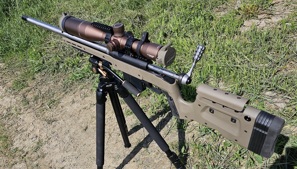

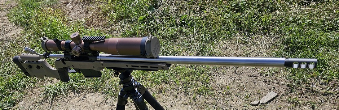

Hello All.
Finally the finishing touches on the bucket list boom stick.

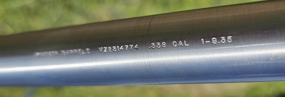

Barrel came in and rented the reamer kit from 4d.
Took about 3 hrs start to finish to chamber and crown it. It now comes down to performance and praying i dont have to shorten, rethread the muzzle and crown again. would be nice for it to run correct on the first go.
still in recovery from walking pneumonia and a hospital stay, but looks like i can finally go out and have a go at it.
Ive got some PPU 250 grn for sight in, and Barnes Precision Match 300's for first runs out to 500yrds.
not a lot of 338 available up here in my area, was lucky to find what I got.
I know she aint nothing much compared to the awesome Builds Ive seen here on the Hide, but I am happy to have gotten done without busting anything or shipping stuff all over the planet to have others do it.
For the good or bad of it, Its all on me.
Kinda long here, thanks for reading it. 20240613_152058.jpg20240613_152114.jpg20240613_152126.jpg
Savage 110 Large Magnum action.
Bartlein Stainless Full Bull no taper
Muzzle Brake Off the factory Savage Rifle
Athlon Ares UHD 4.5 - 30 x 56
Tier One Rings from right here on the Hide
MDT XRS Stock
Im open to suggestions on a Trigger kit

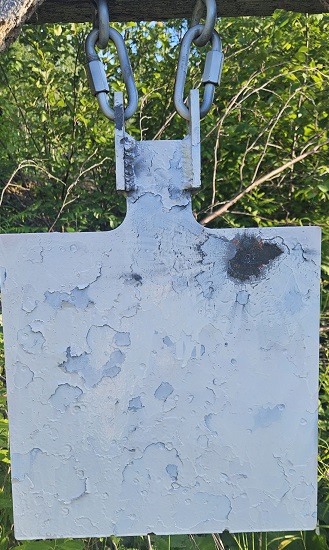

Range update.
Range layout, elevated shack 12ft above range level., 50 to 600 yrds, steel squares, steel silhouettes and paper racks every 50 yrds
I suck .
I made 2 rooky mistakes Ive admonished others for over the years as follows.
1. knuckling the trigger, ( blade in the joint instead of mid pad)
2. Get comfortable behind the gun. I couldnt get comfortable or set in my position on the gun, My Buddy talked me into coming out to his range vrs my own setup. This proved to be a very bad move, seat height was too high to to the table, Hes a 5'8 Marine Scout built like a Tree, Im 6'2 and towards the slim side hence I was bending down to get behind the rifle on his table. even with his bags and nine, couldnt get it done properly. very bad position.
Those 2 issues alone were enough for me to chew myself out afterwards.
with that said, the rifle performance was excellent. Aic's Mags were temperamental but some dressing will take care of that.
Getting it on paper, 2 shots, first round missed second was wide left but on the cardboard.
I used the draw down method. locked the rifle down an dialed the Ret to the hit. next shot was a bull.

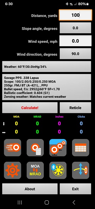

Ammo for sight in an testing .
PPU Blue Box. 250 gr bt hunting. web page lists the BC at .605
Link - https://ppu-usa.com/ppu/338-lapua-magnum/
Glass, ARES ETR UHD 4.5-30×56 APLR5 FFP IR MOA Brown.
Trigger and pull, stock savage accu trigger, factory setting.
20 rounds,
2 to get on paper.
17 in the target.
last round, dialed up 38 and went after the 550 yrd steel. no windage adjustment.
Hit 4 inches off center level with aim point.
My Norma doesnt have a Brake, this rifle is tame by comparison to shoot.
Paper target 9 OClock position is actually a 5 shot group.
Other than my bad habits from being excited to get here,
I think she's a dead on Keeper.
