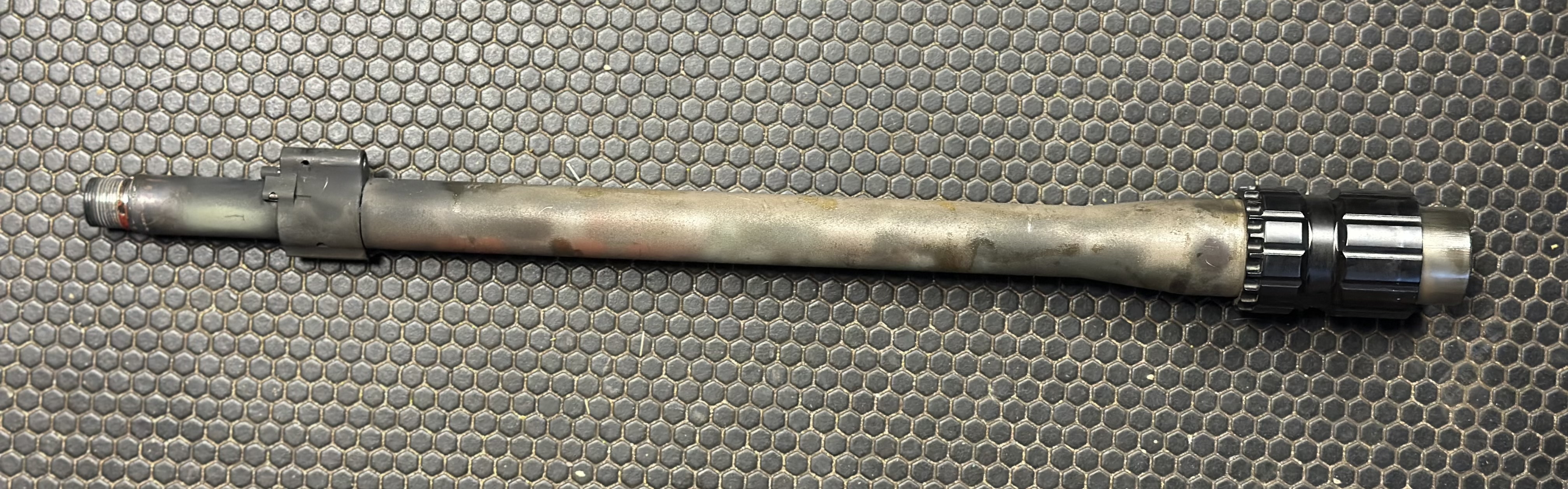

Just a sample of one, but my first MODBB barrel was this 16” 6mm Creedmoor barrel Craddock put together for me in 2022, and it’s finally reached the end at almost 3000 rounds. Granted, I didn’t push it as hard as my bolt guns, but still it lasted longer than I expected.
One of my customer/buddies and retired SS shoots 6CM on his PRS guns. He gets about 2500 on his. He takes care of it... but he uses it also. He's had I think 3 in a row now and all ended around 2500. Prior to the BB material he was pulling them at about 1200-1400 rounds. I think 1400 was a stretch.

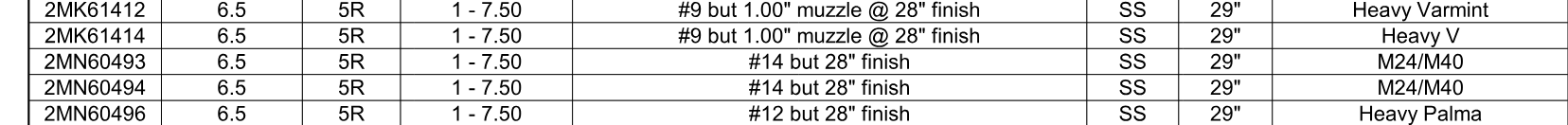

Theres a variety of heavy target (m40, Max-HV, HP) blanks in 7.5t x 6.5mm bore in their OEM inventory page. Why MTU vs other very close profiles isn't in stock this very minute...if that's the question... I think the answer is, in part, going to be... inventory changes daily/weekly etc...
Good luck either way, I'd maybe give them a call on Monday.
