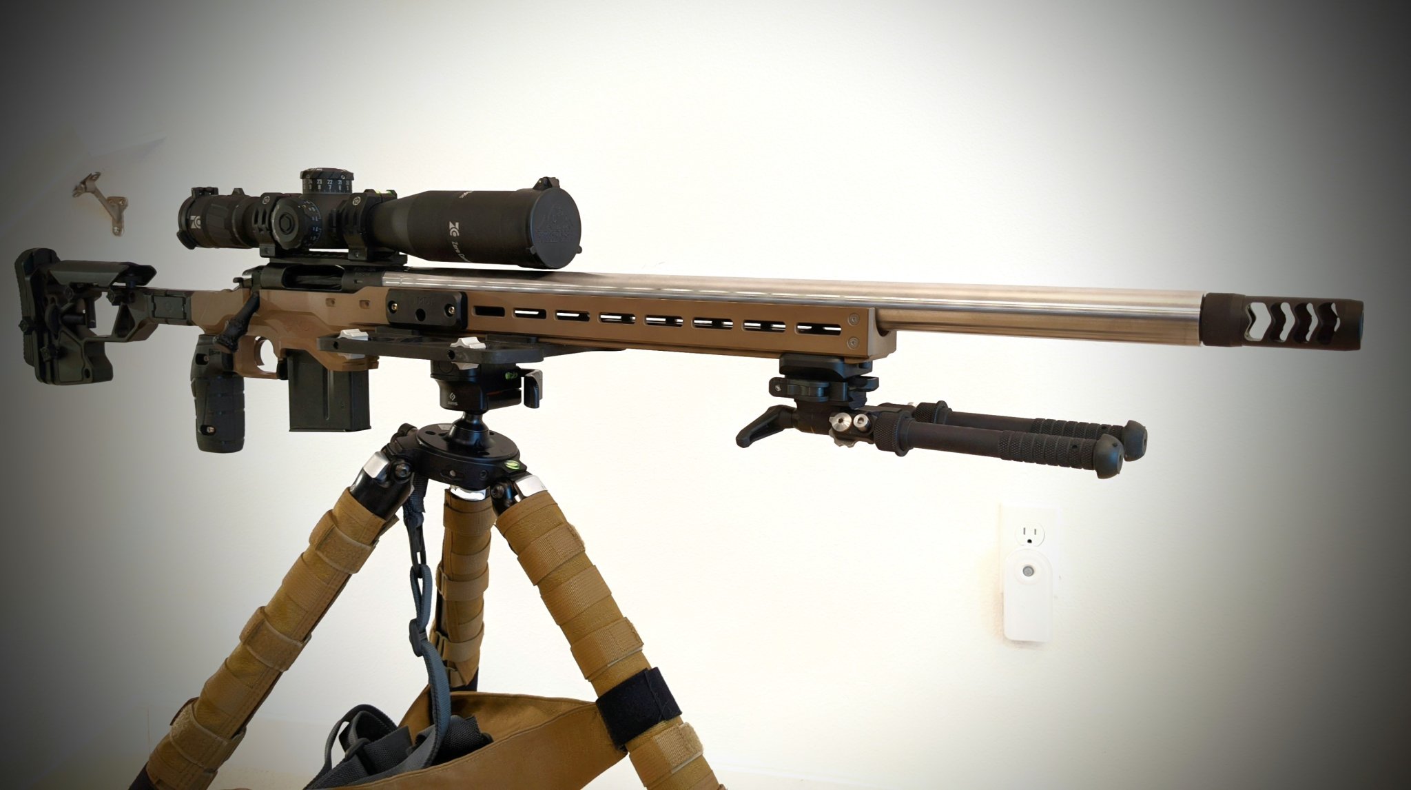

Finally got one of the bbls installed. Love the 1.25" contour!
Chambered and threaded by SPR-BigHoles

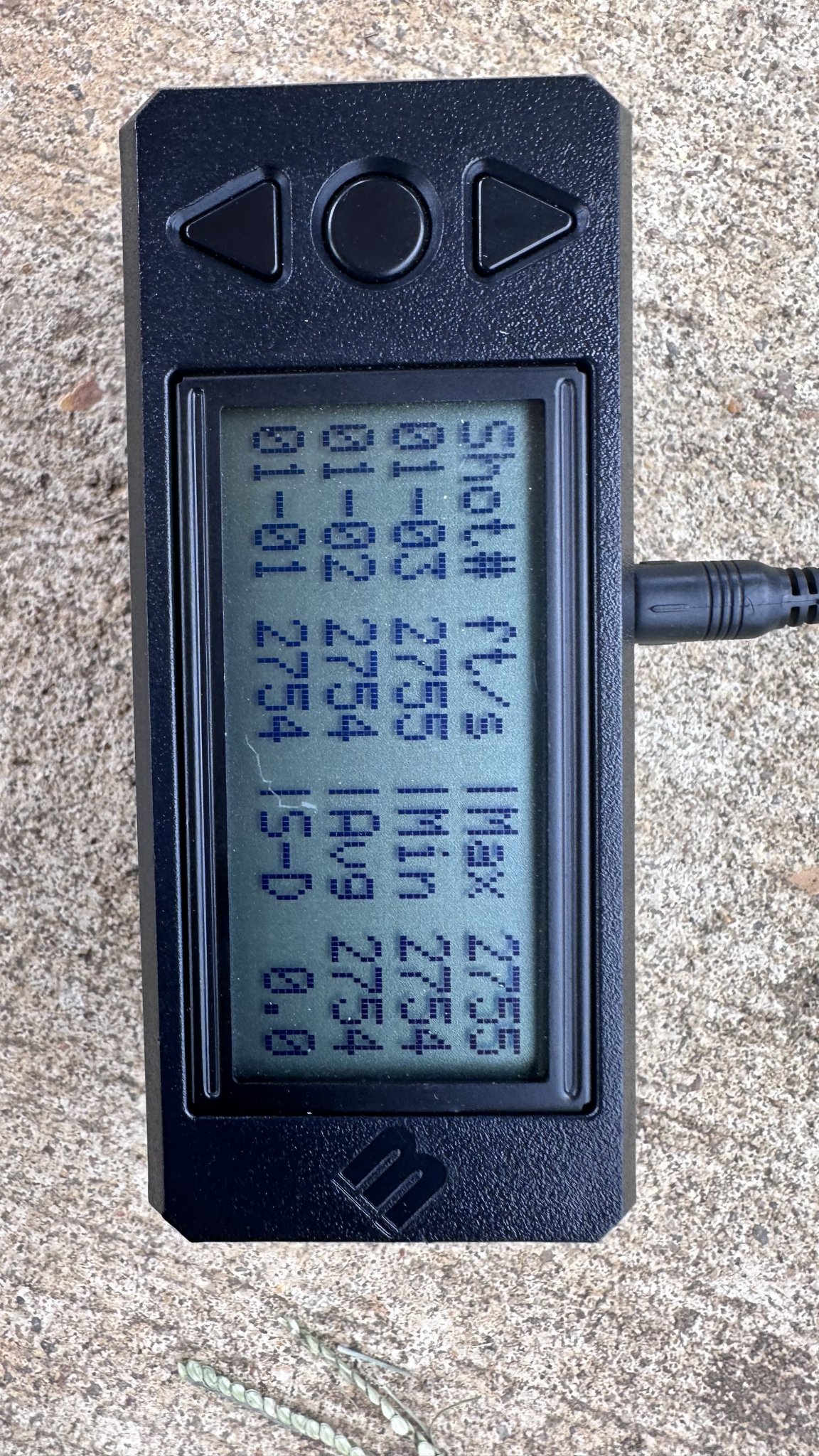

I'm at 3780 rounds after this past weekend with my BR. Still shot a one hole group at 100yrd after cleaning and fouling. Still planning on shooting it all next season. Zero really hasn’t shifted. Velocity is in its usual range but this weekend was cooler so it was slightly slower. Still shooting 105hybrids with Varget. But about to switch to some 108s. Bought two more at the Grind. Sorry that this really doesn't offer much.
