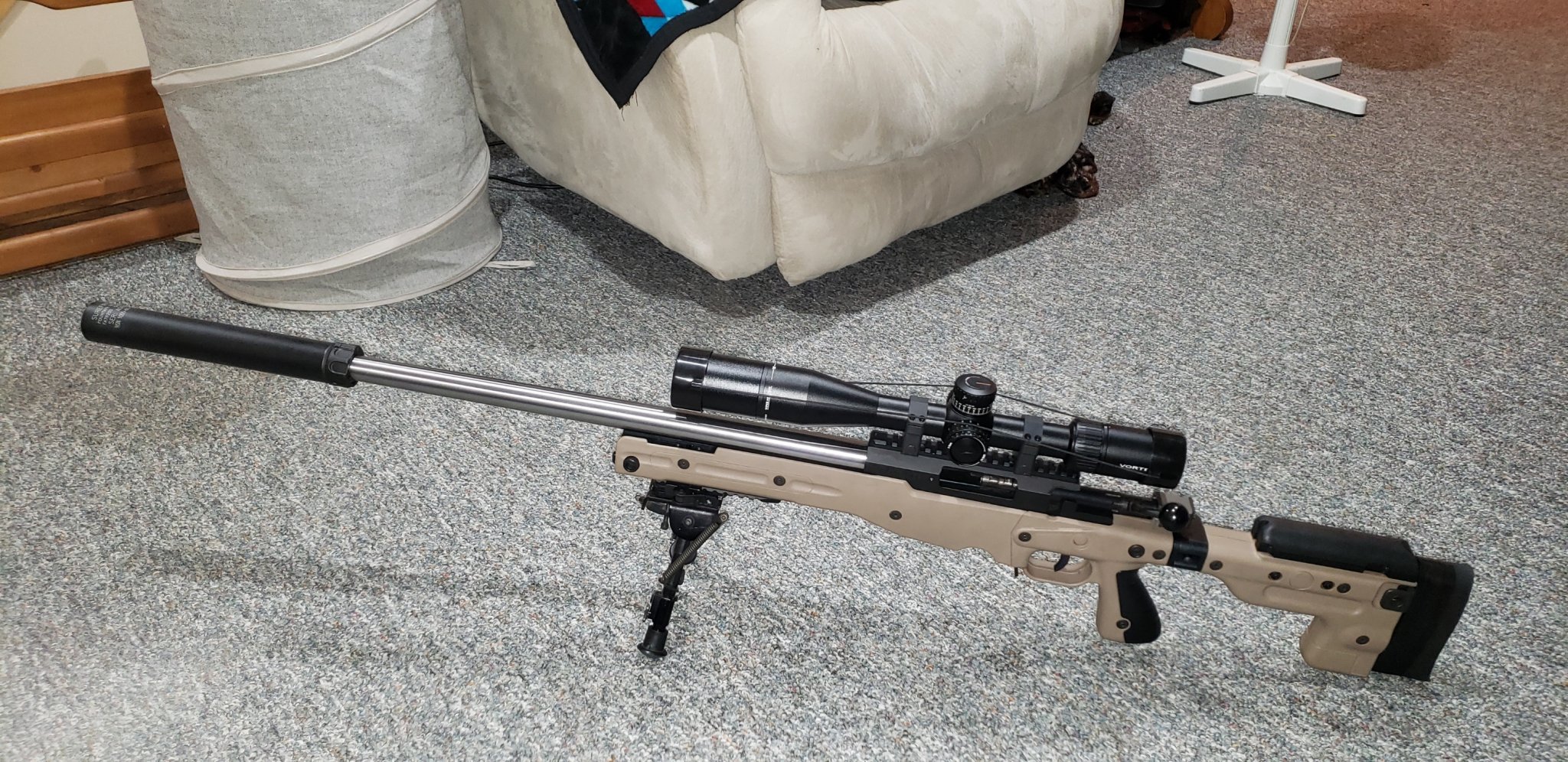

My AIAT with the 6.5CM barrel on it. M24/M40 contour... 23" finish length (not including the suppressor).
Not a 7mm but is a 30cal....and chambered in 300 Norma. Barrel currently has 2530 rounds on it and is still hammering and no velocity loss. It's suppose to get more rounds on it starting next week.
Not only is it BB material but CFW as well.
