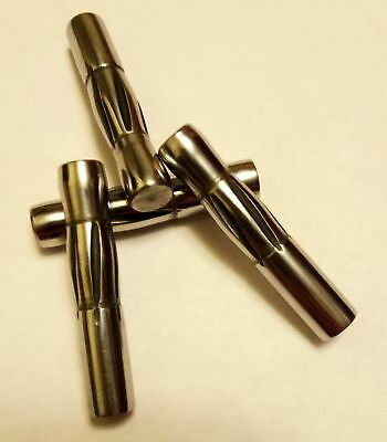

There is no such thing as "button cut". There is cut rifled and button rifled. Cut rifling utilizes a rifling machine that literally cuts away material inside the bore, a little bit at a time, over many many passes to physically cut the rifling into the bore. This takes a lot of time to cut each barrel.
Button rifling, a literal "button" is pulled through the bore that displaces metal to form the rifling. Nothing is cut out. This process is fairly quick compared to cut rifling. This process induces lots of stress into the barrel because it is physically displacing metal so button barrel makers utilize stress releaving processes to remove as much stress as possible.

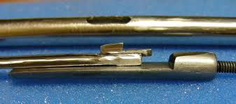

To illustrate the cut- one groove at a time
Vs a button- does it all in the same pass
