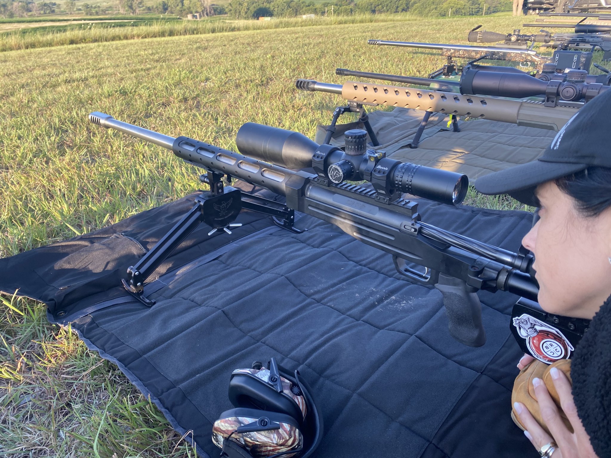

Looks like any other rifle in a xlr chassis 😂
