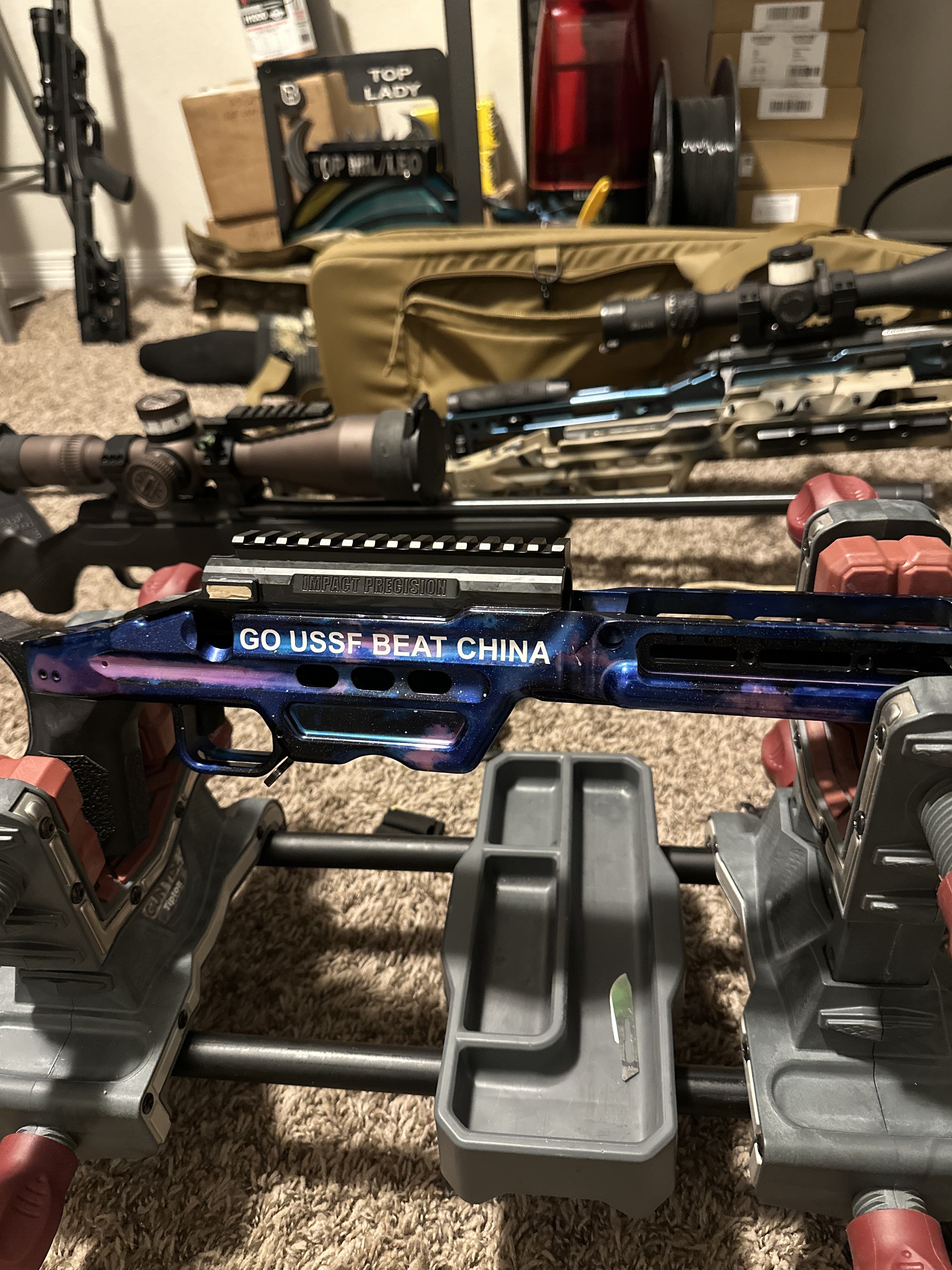

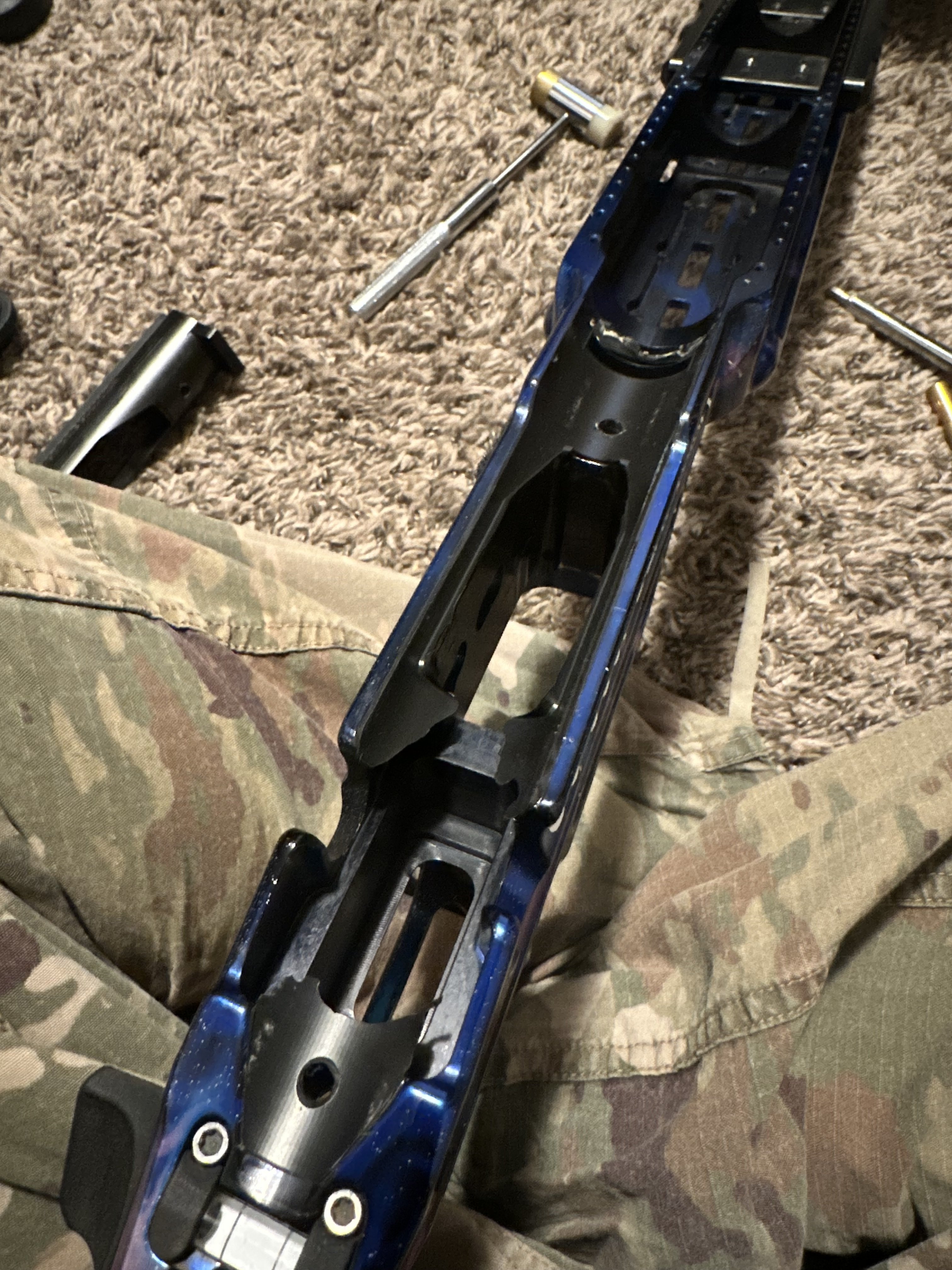

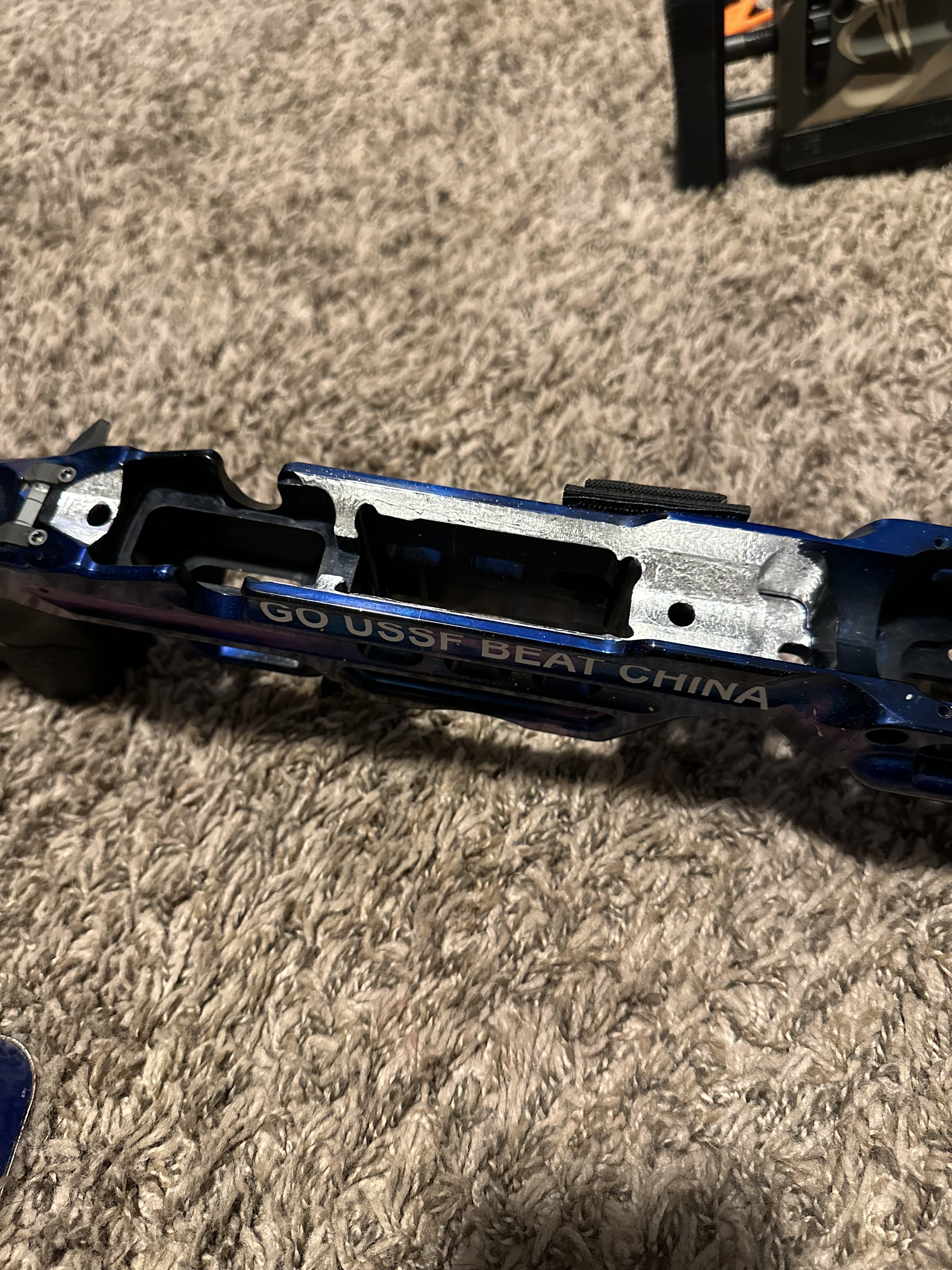

Recently did a few of mine after I discovered stress in my “main” prs rifle. Just Dremel the area to rough it up, take out .050” behind the recoil lug area on the chassis with a mill and degrease the area before bedding.
