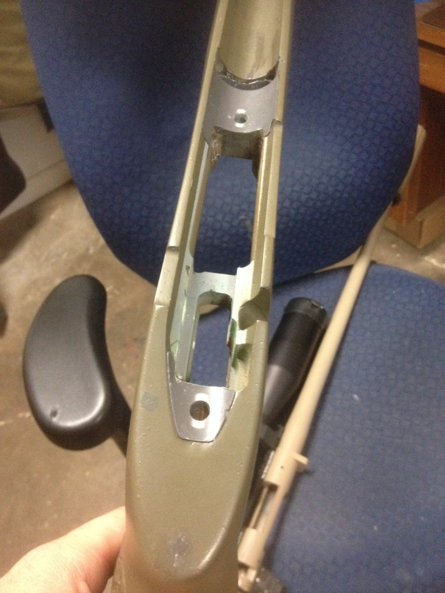

    I drilled out for my pillars with a cordless Dewalt hand drill. Really ugly.
    After bedding was complete you couldn't tell unless you pulled it all apart.
    Rifle shoots great too.
