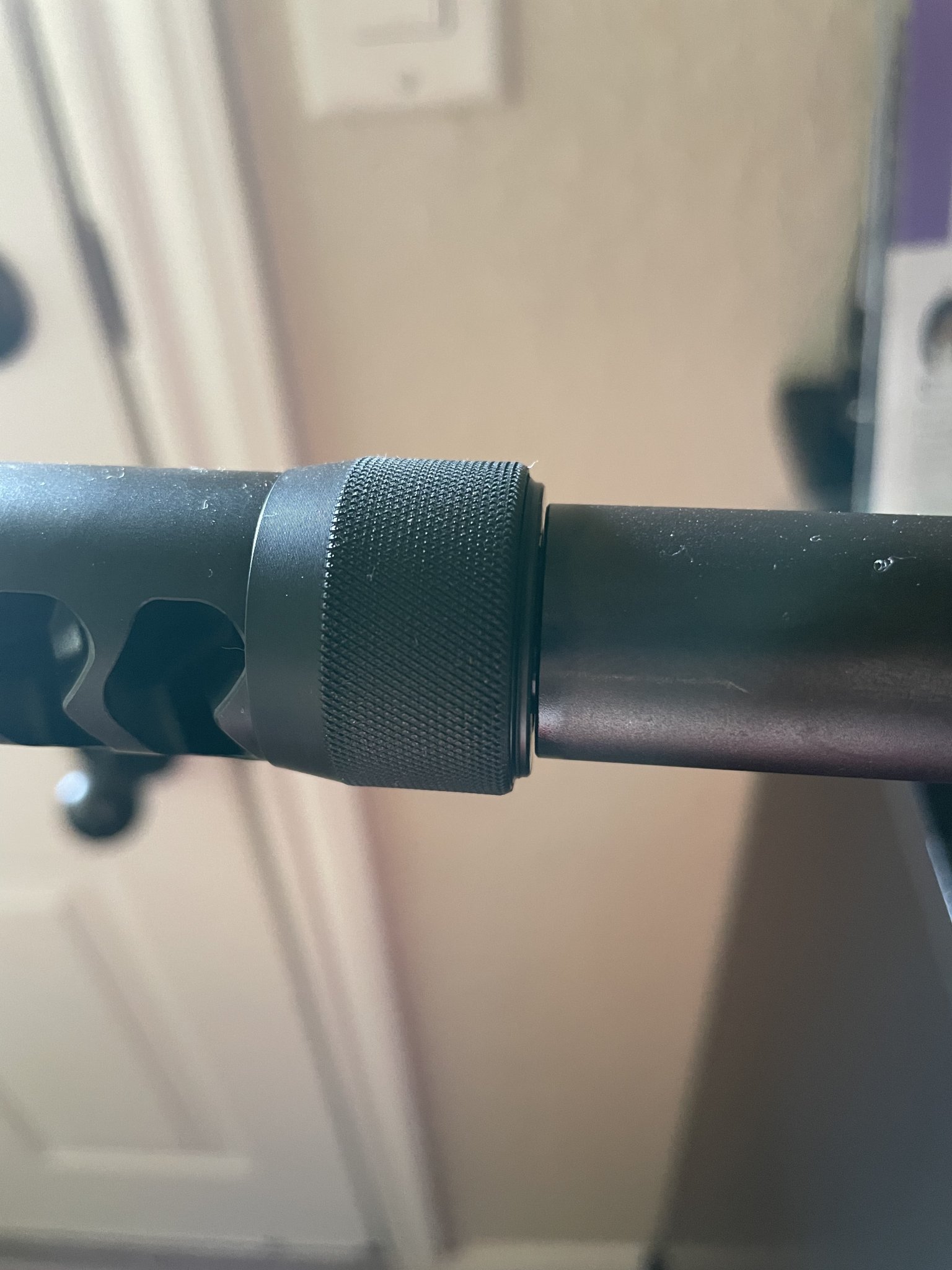

Anybody else with a hellfire? My mount is about a thousands from sitting flush… doesn’t bug me until I look at it closely.

The 419 adapter on my B14 sits flush with the shoulder of the barrel, so there’s something up with either your barrel threads or the adapter they sent you....or both? Contact Bergara and go from there but 419 may be the quickest path for a “one off” adapter.
I contacted Area419 and turns out some adapters got a tight after coating. Getting sent another.

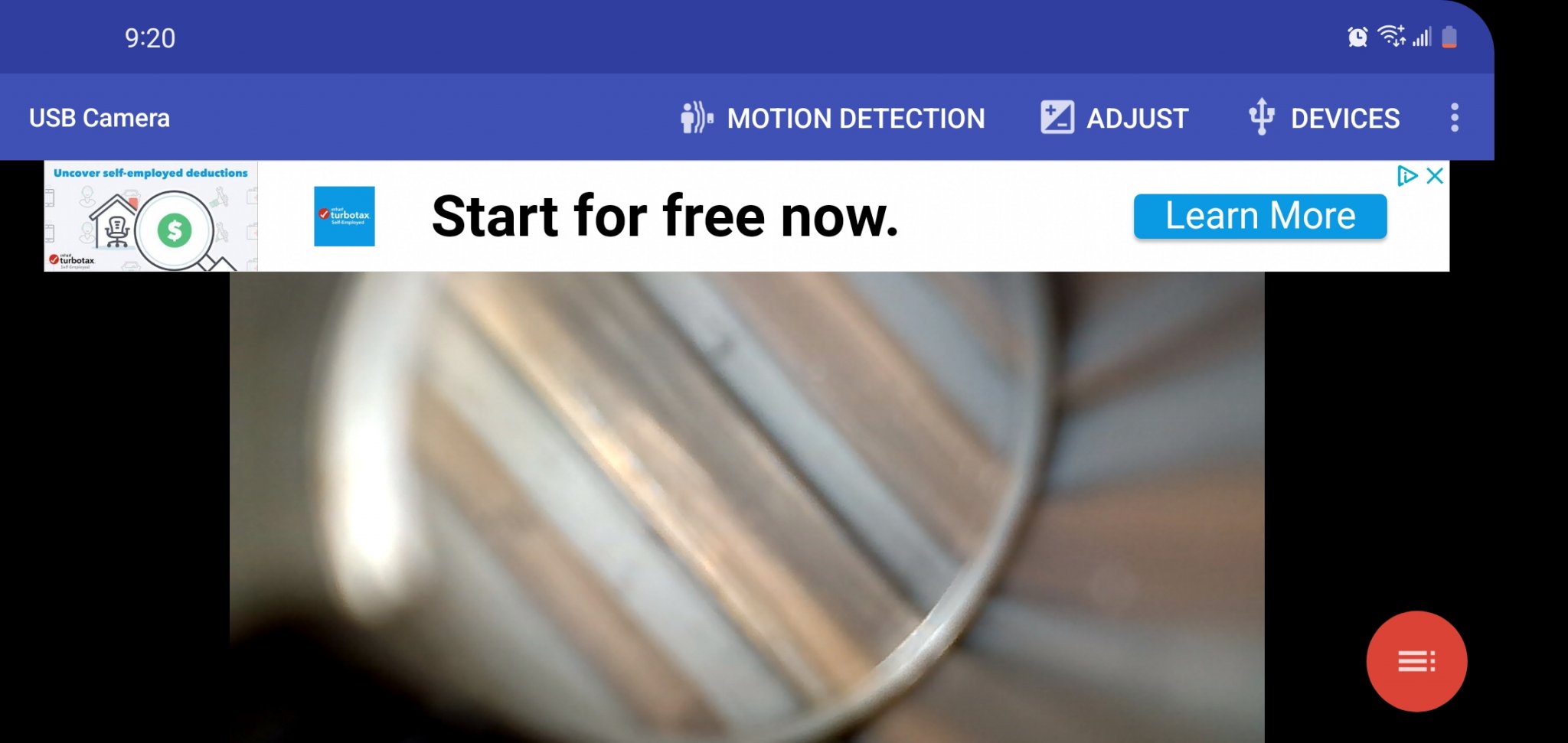

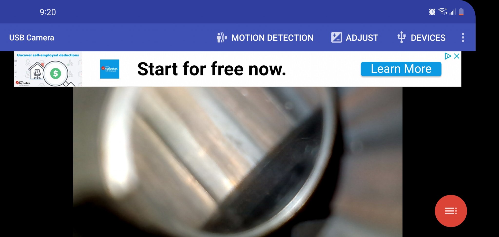

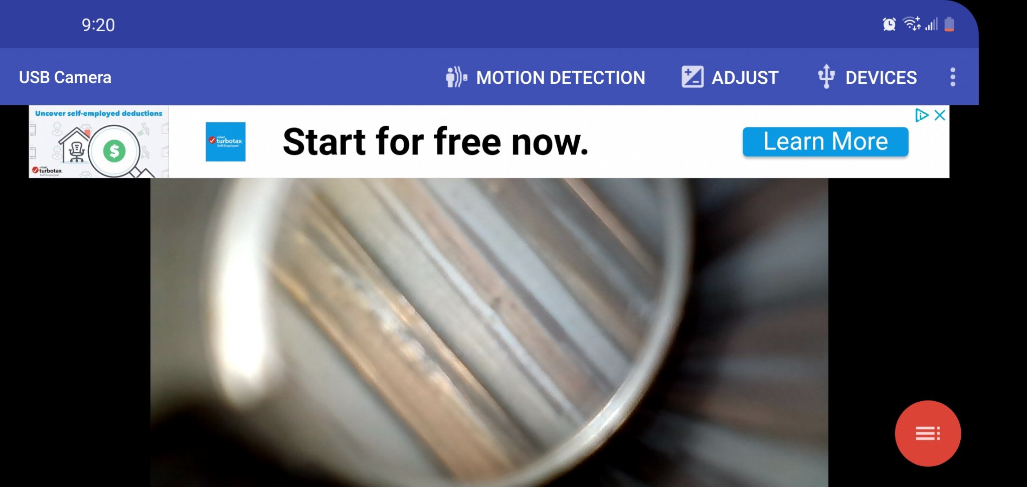

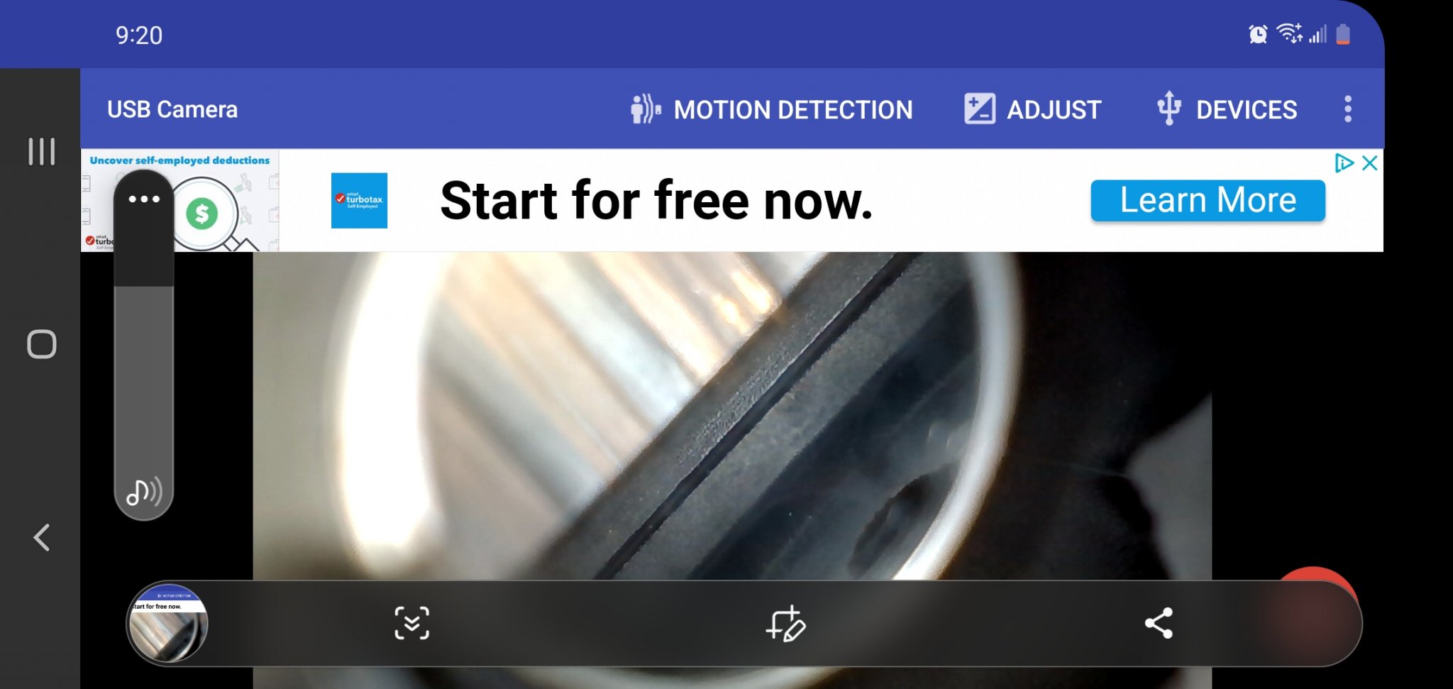

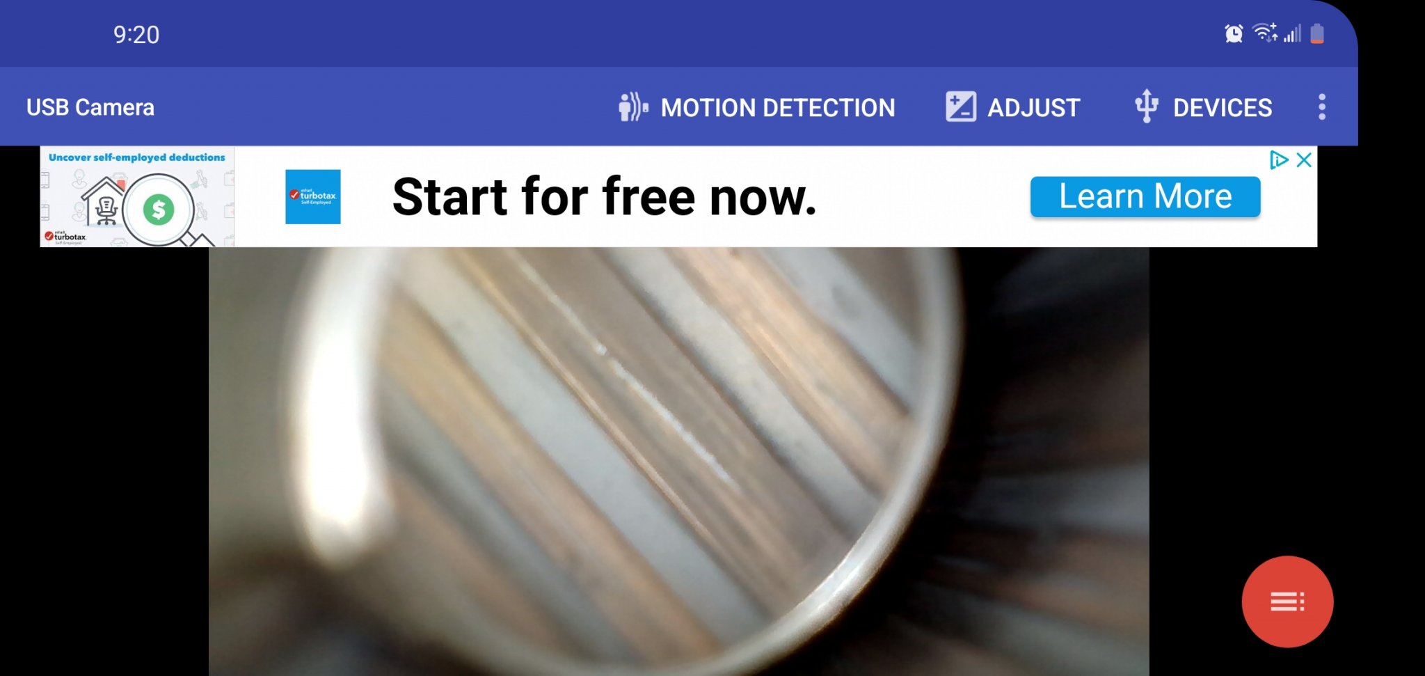

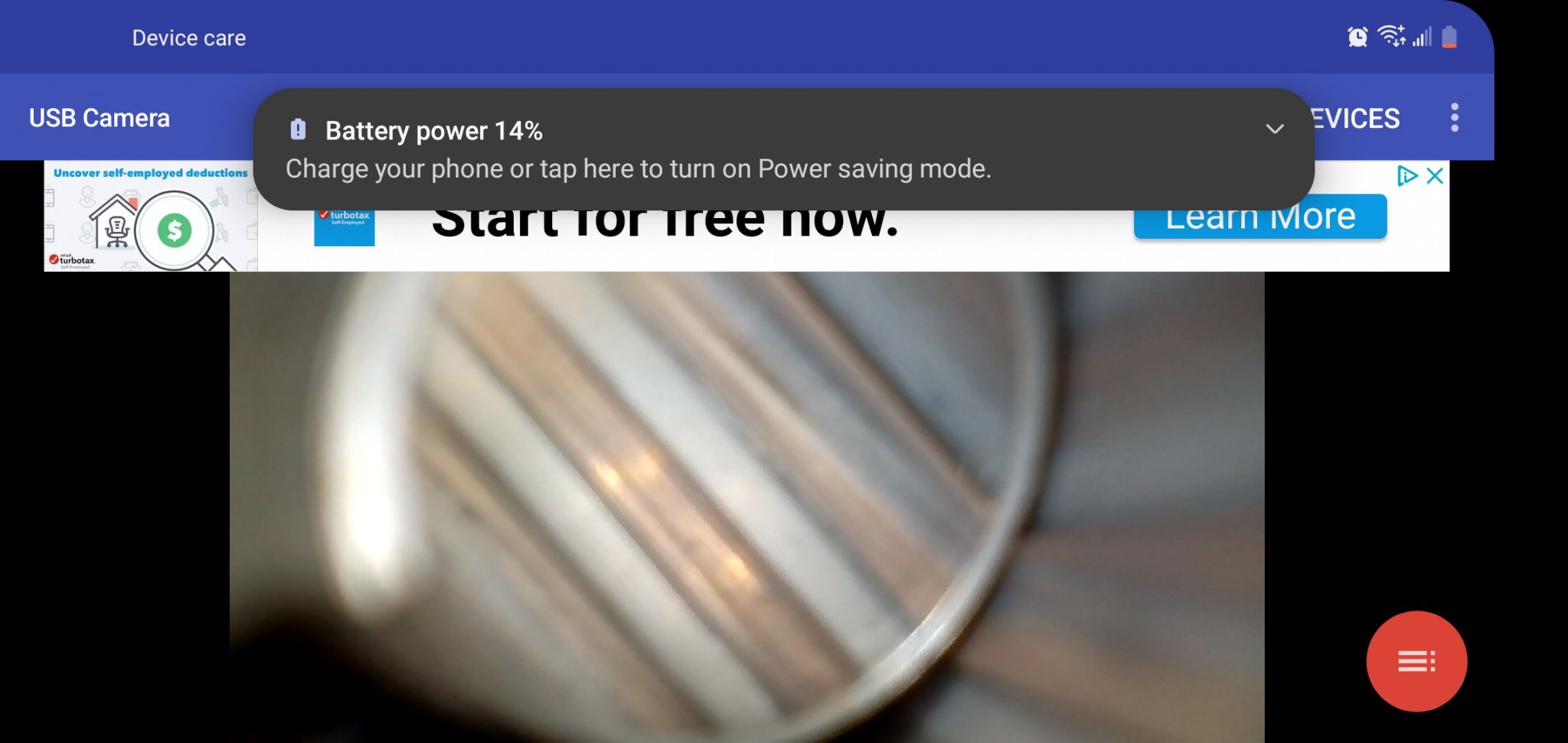

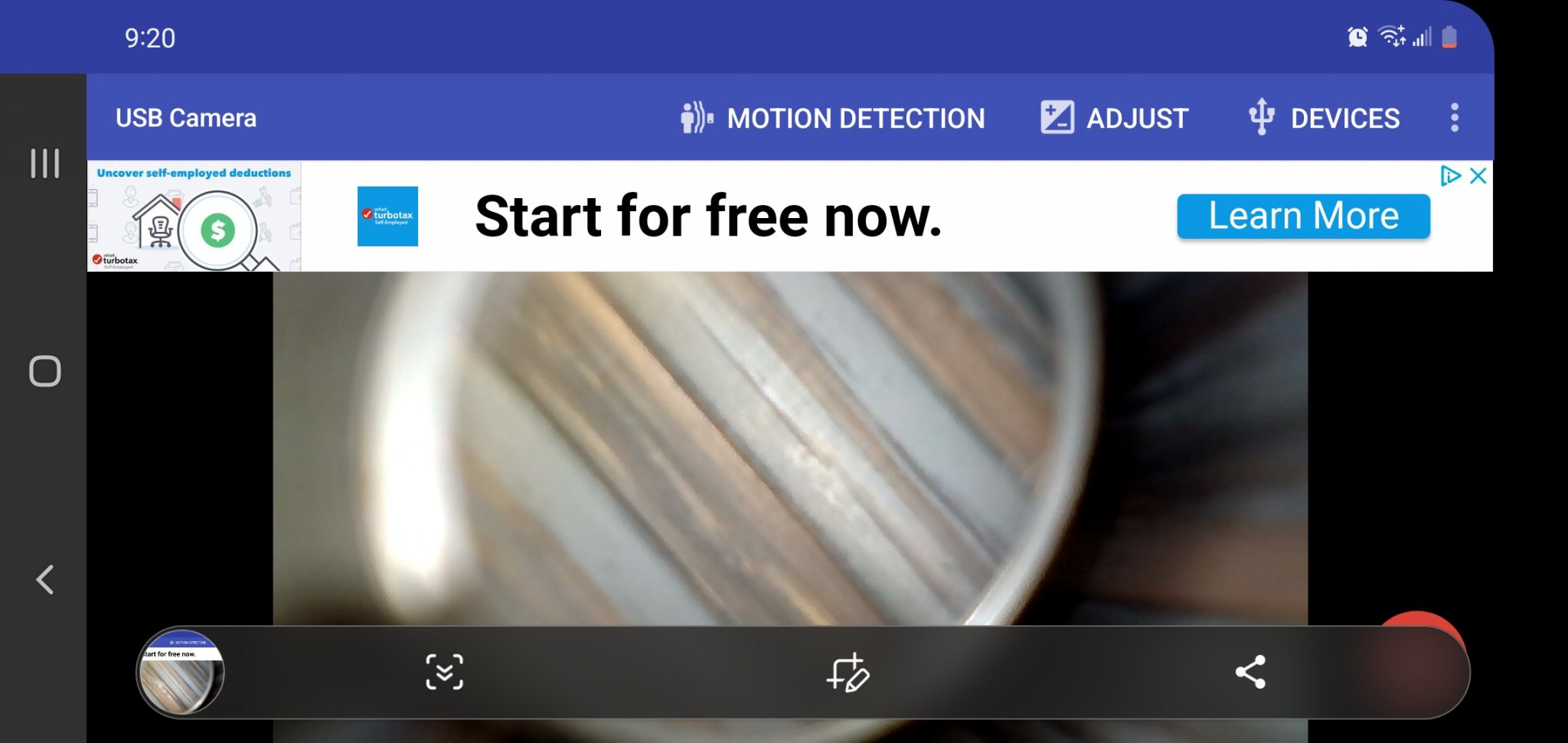

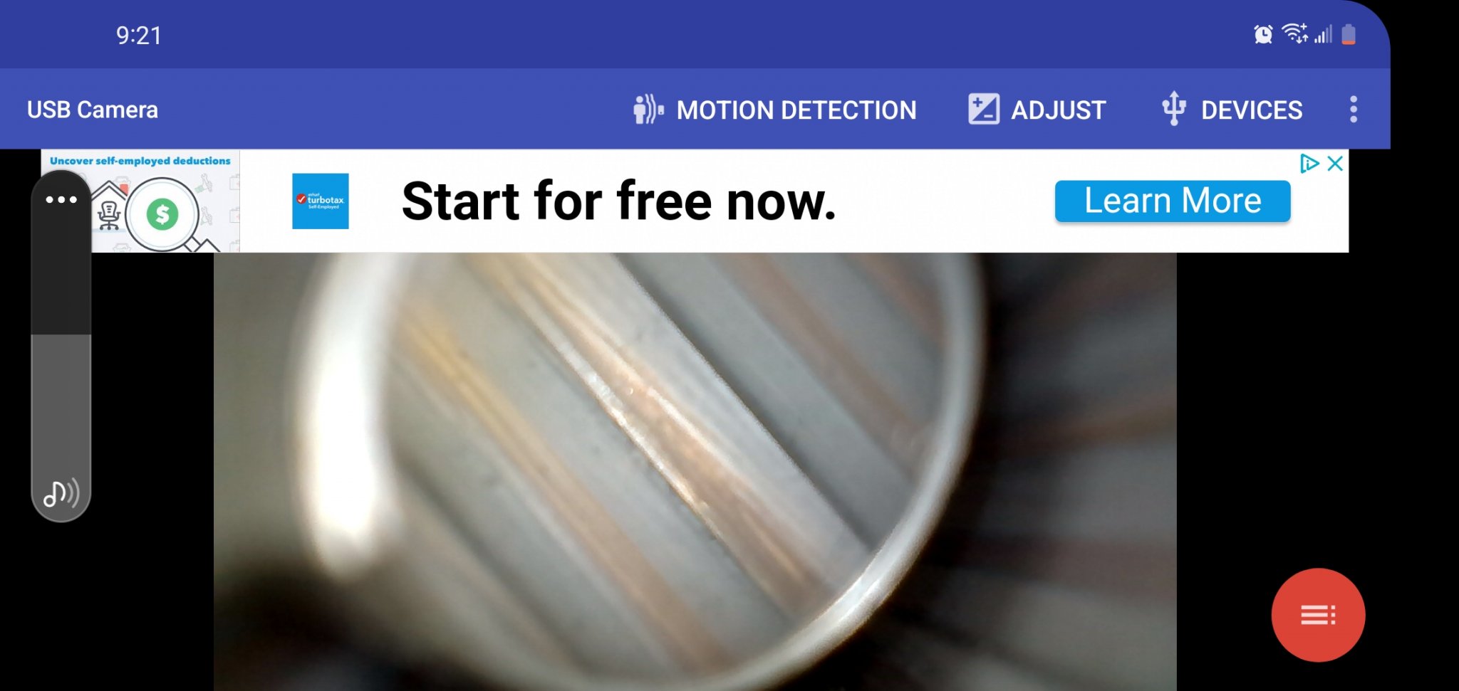

Man, i hate to do this but i have to put bergara on blast for this one. and the purpose is not to attack a manufacturer, but instead i need some tips from the crowd about how to improve the rifle, given the shortages of everything. things just aren't available these days and a rifle that is more than $1000 ought to not be the weak point in the equation.
so a friend just got a B-14 and ask for help to set it up. i cleaned and inspected with a bore scope prior to going out, and the bore was rough enough to rip a cleaning patch in half. i thought that was a bit rough for my liking and patch some more, and it didn't happen again. We went out to shoot and put some factory ammo in, hornady eld-x 143 gr. so i fired 3 rounds in a clean dry barrel, of factory ammo, and got 3 heavy swipes and 1 Smokey primer. i didn't like that at all. the labradar read, 2781, 2796, 2799. we went back and bore scoped it, and after just 3 rounds the bore had a lot of copper in it an it looked very rough. i cleaned down to bare metal, and went back to try again with some "different" ammo of a less hot variety, and i got an ejector mark on ever other case at the least. so now there are a total of 25 rounds through the rife, its been cleaned to bare metal 4 times, and the highest speed ive seen from anything out of this 6.5 prc is 2861 and its a 24" barrel. i called customer service, they were very nice, we had a great talk, and he said that lapping these barrels probably wont do much to help, and to just keep shooting it. im not here to insult anyone. but times being tough to get different ammo and reloading supplies, does anyone think that jb bore bright would help drastically? should the rifle go back or be sold? or are there any other suggestions? this is the only bergara ive touched, and the rest of the rifle seems great but it seems to me that the bore is dangerously tight or rough.
Thank you in advance to the internet experts that can help solve this problem.

that's exactly how i feel. talking on the phone with them was very pleasant, but i was surprised by the feeling that i got front them that made it seem like this was normal. i have some bore scope pictures here. these pictures take place after the break in procedure was completed, and then cleaned down to bare metal, and then 8 shots where fired. looks pretty rough to me.
