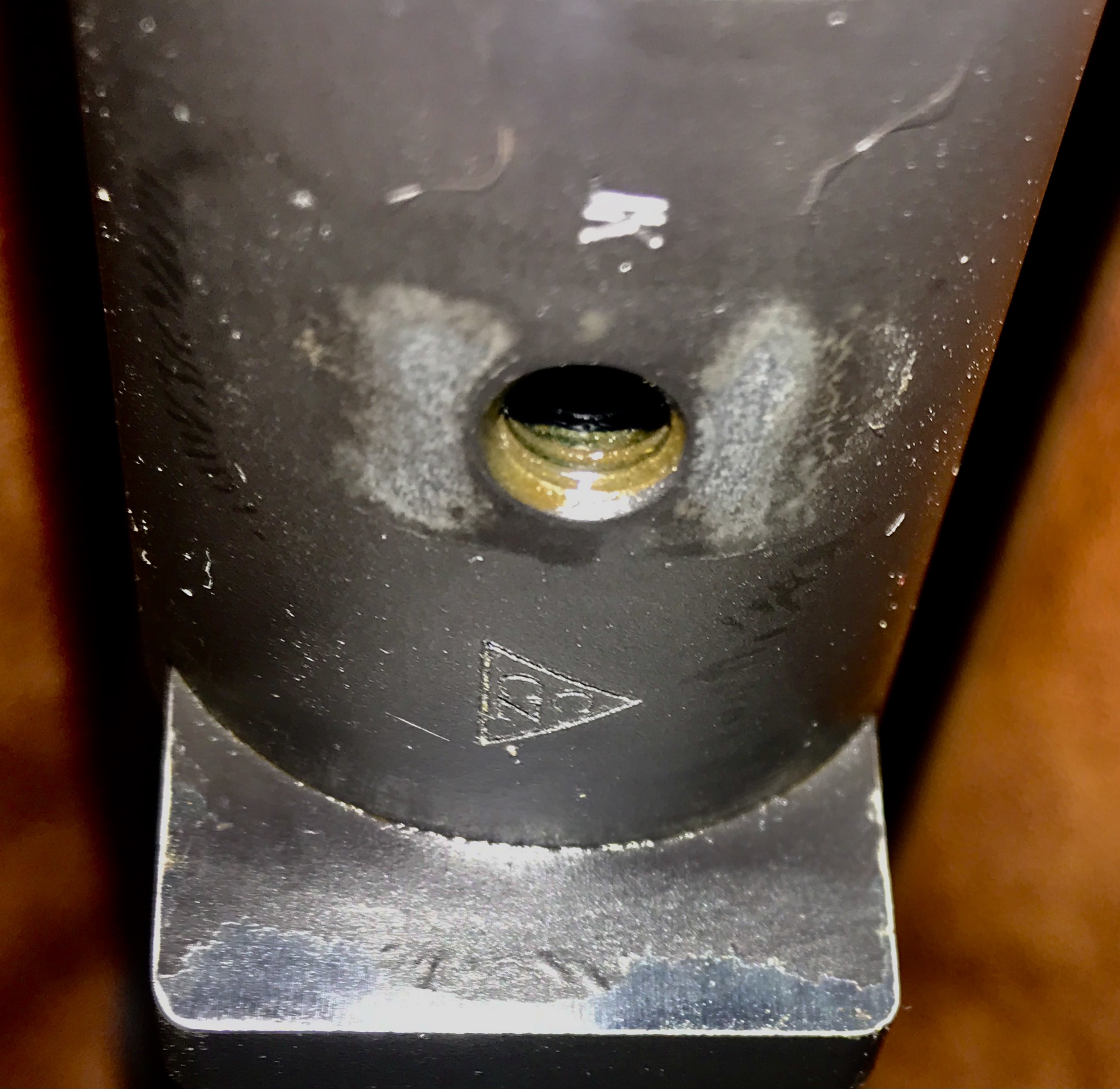

I bedded the recoil lug on mine. Based on the wear marks on the back of the lug and on the aluminum bedding block there clearly wasn't very good contact. Will it make a difference? At this point I'd say I give it a 10% chance of making it shoot better, a 10% chance of making it shoot worse, and an 80% chance of doing nothing whatsoever. We'll see this weekend if the weather permits, if not, then Monday.

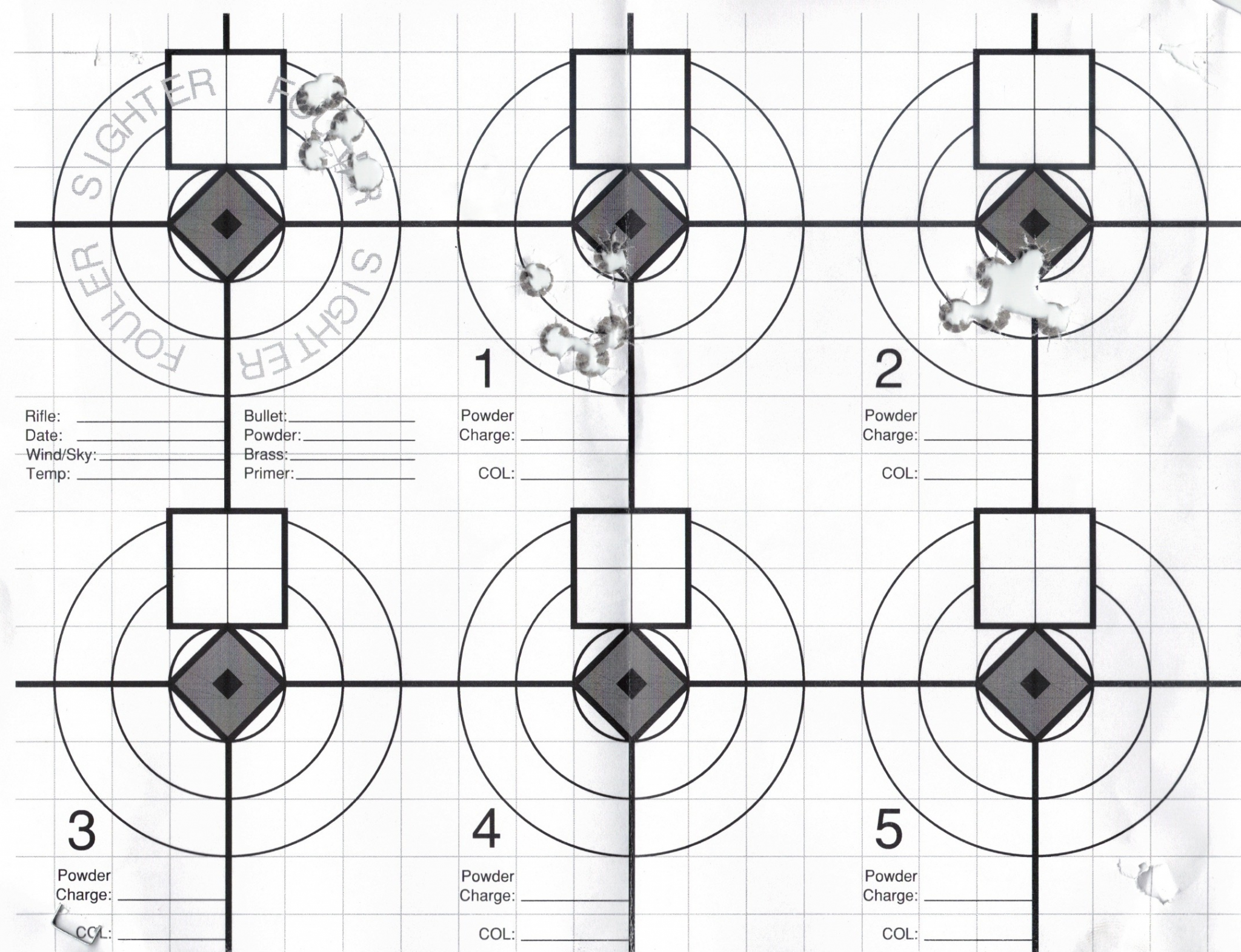

Update: I tried bedding the recoil lug last week and shooting some groups today after work. I only had enough powder for 3 5-shot groups. Anyway, I averaged 0.8 MOA and all groups were under 1 MOA. Previously I had gotten an average of 1.2 MOA with the same load.
Anyway, I have some more powder on the way. Hopefully I'll be able to give a more definitive answer as to whether it helped then. That said, at least things are trending in the right direction. I didn't have any crazy fliers today.
With three, FIVE shot groups, you have officially exceeded the Bergara Sub MOA guarantee specifications.

I used Marine Tex Gray. I just removed some material from the front aluminum bedding block, applied release agent to the action, applied release agent to the action screws, applied tape to the bottom and front of the recoil lug, taped the sides of the stock to make cleanup easier, put epoxy in the front bedding block, torqued the action screws to 55 in-lbs, and crossed my fingers.
Anyway, the load I used wasn’t the best load for the rifle, I used what I had on hand. Without the bedding I had maybe 30% contact with the recoil lug and bedding block, so it makes sense that bedding would help. I’ll give an update when I have more powder and can’t test things more thoroughly.
You can see the amount of contact I was previously getting below (the shiny silver part at the bottom…definitely sub-optimal). It shouldn’t have left the factory like that IMO.

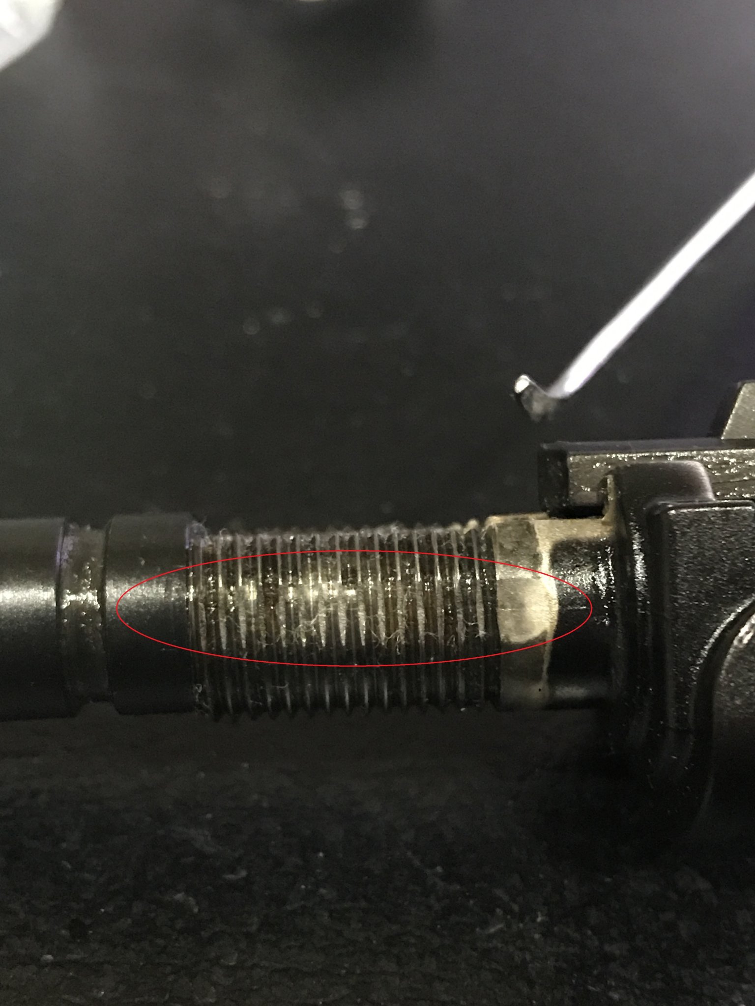

Interestingly, Bergara’s repair folks said my action screws were overtorqued (even though I went out of my way to torque to 55 in-lbs before sending it in). When they sent the rifle back to me and I tried to measure the torque they used, reversing the screws maxed out my wrench.
It took more than 65 in-lbs to reverse the action screws even though they are supposed to torque to 55 in-lbs. I'm not sure if it is something to do with the geometry of the screws or what but I have noticed that if you torque to a certain torque level and leave the gun for a few days, the torque required to reverse the screws goes up well beyond what you initially torqued it to. I don't claim this information is useful in any way, just an observation.

FYI, I was finally able to thoroughly test the difference bedding the recoil lug made today. My 5-shot group average out of 6 groups was 0.87 MOA. The largest group was 1.12 MOA and the smallest was 0.5 MOA. That’s nothing to write home about but it is definitely the best 6 group session I’ve had with the rifle so far and a step in the right direction.

After four weeks, I have my HMR Pro back from BPI.
The gunsmith notes indicate that:
  1. It was sent to production for rework.
  2. The action was completely replaced.
  3. It was sent to the range for test firing.
I received the test card with a three-shot .373” MOA result.
The bolt is nice and smooth now as expected.
I also received a one time 20% off coupon for use on anything from their website.
All in all, I am very satisfied with the outcome so far. Now I have to try it out myself.
Reactions: Dog Doc
I hope everything works out for you, but they sent me a 0.3 MOA 3-shot group (followed by a 0.98 MOA group) and that rifle is far and away the least precise rifle I’ve ever owned. 3 shot groups are a statistically meaningless measure of precision. I’m fairly certain I could piss more precise groups at 100 yards than what passes for “precision” at Bergarbage.
Reactions: RRW and Dog Doc
Update: I recently was cleaning my gun and noticed there are flat spots on the bolt shroud threads at the 9 and 3 o'clock positions. I am wondering if this is normal. I am thinking maybe inconsistent ignition could be the cause of my accuracy woes. Regardless, I don't think the threads and side of the shroud are supposed to be flattened like that.
They're not.
Iirc this was a recall issue. At the risk of sounding dense, contact Bergara.....
They're not.
Thanks. I did. They said they put a replacement “on order” for me…whatever that means. Sounds like I probably won’t be getting the replacement anytime soon.
One other thing to note, I was randomly getting popped primers even with loads well under max. This may well be why.
I see you are still battling this rifle! So has it started shooting any better?
I haven’t really gotten a chance to shoot it over the past few months due to work, etc., but I should be able to soon. I will probably do it after they send the replacement bolt shroud. I kind of doubt it will help but it’s definitely something that is messed up and replacing it definitely won't hurt.
Reactions: Dog Doc
They're not.
FYI,
I got the new shroud today. It turns out that the flat spots are on the new shroud threads too. It is from the 2021 version of the rifle, for reference. I'm surprised because that doesn't look like something that should be on a new shroud. I know that on older versions there was more extreme flattening occurring to the point that the shroud would jump back a few threads and cause ignition issues. Looks like the solution was to just pre-flatten the threads. Lol. Oh well. At least I have a spare now.
