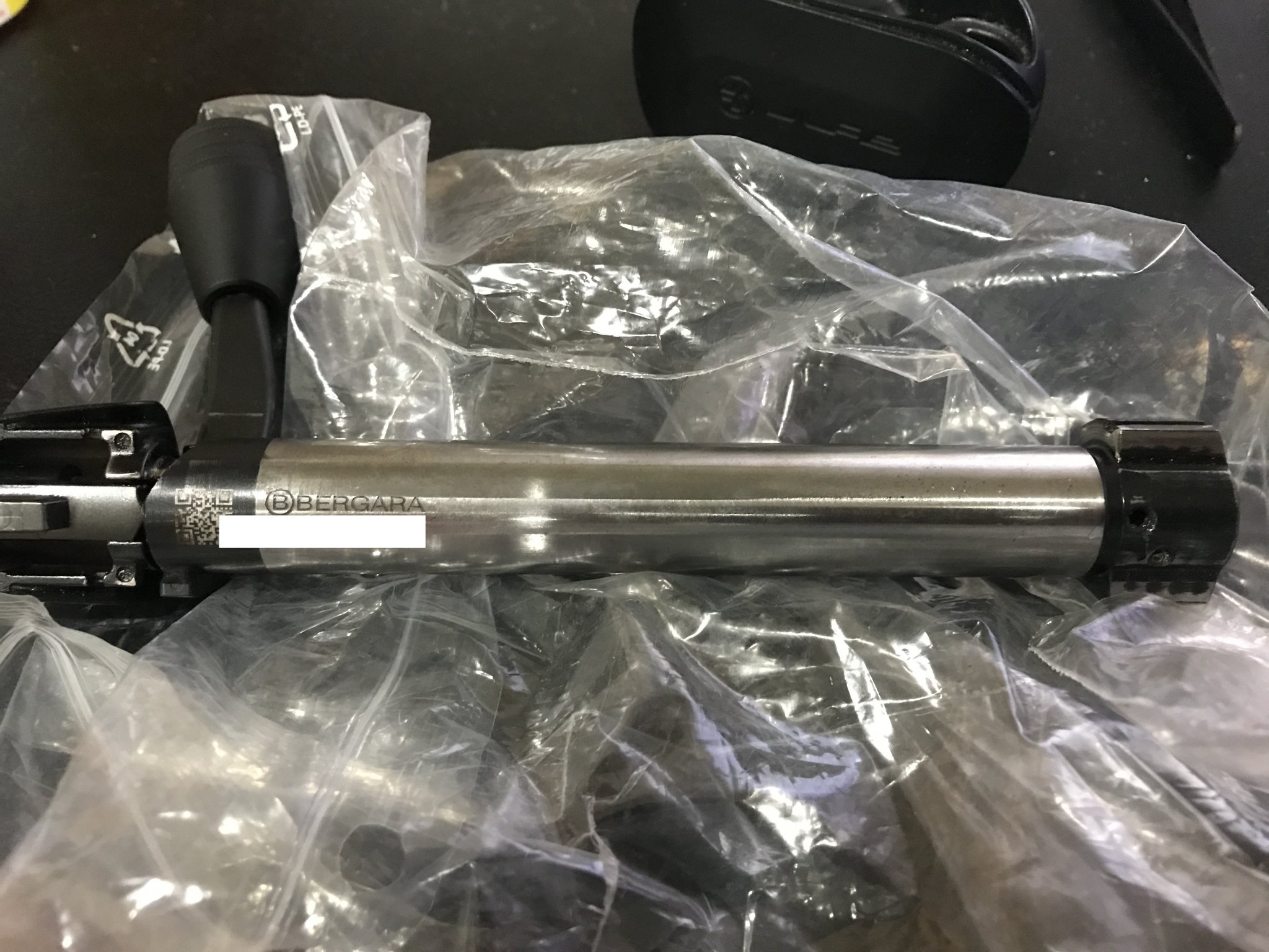

I had a really rough bolt on mine. It was because they laser etched a QR code on the bottom of the bolt though.
Really? No QR codes or laser etching of any type of my bolt or bolt body.
Seems Bergara can’t stay consistent with their production.
More examples than just this. For example mine didn’t ship with the QC ”inspected by” card, and they just threw the barrel sticker into the box instead of attaching it to the barrel.
Reactions: Hydrogen
Yeah. Mine has a QR code, "Bergara" logo, and serial number, etched on the bolt. It sure did make the bolt rough to start out. Running the bolt felt like pushing a rake over gravel. I smoothed it out with some 3,000 grit sandpaper and it's perfect now. I have no idea why they thought etching the bottom of a bolt was a good idea. I wonder if my version of the rifle was meant for distribution in Countries that require serial numbers on all major firearm components or something like that. That's the only reason I can think of for adding a serial number onto a bolt.

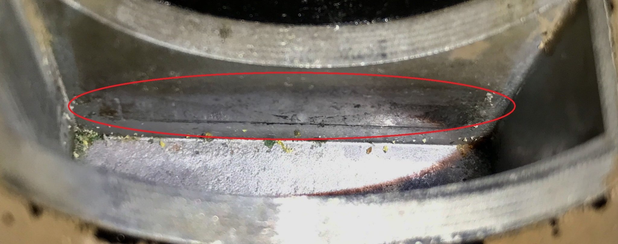

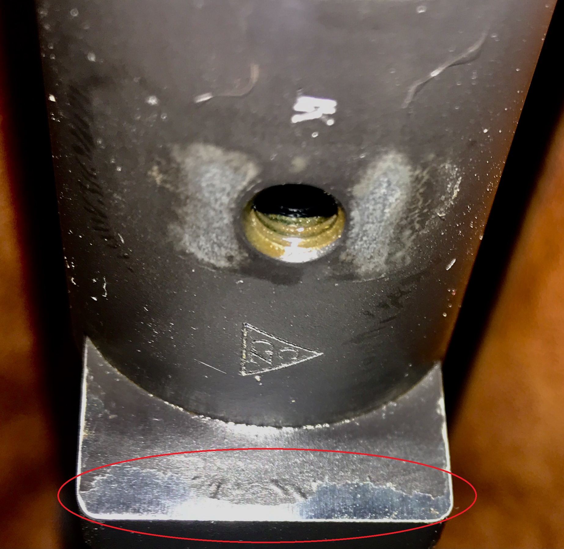

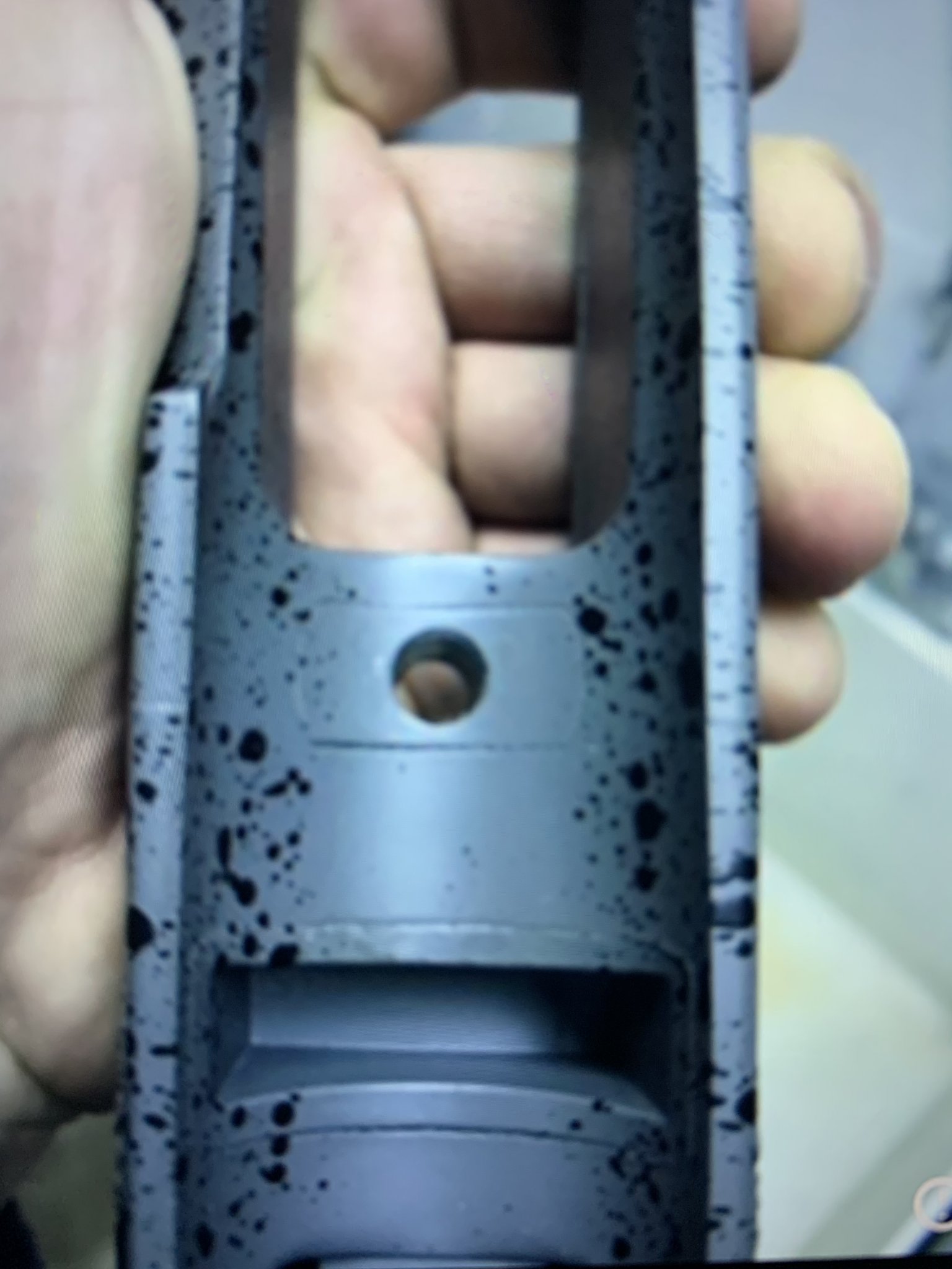

FYI,
I took a look at the recoil lug today. Looks like it is making minimal contact with the aluminum in the stock based on the wear patterns on the stock and rifle. Seems like bedding the recoil lug may be the ticket (assuming the issue isn't the barrel).

FYI,

I’ll add one more … and it may already be very obvious since the barreled action has already been removed from the stock. Removing any paint from the lug or the bedding pillars is wise to do too when it’s all apart.
You can see my regular HMR came over sprayed on all surfaces.
When I removed the overspray nothing changed accuracy wise but I’ve heard others have had luck with it.
Please do keep us in the loop how it turns out !
