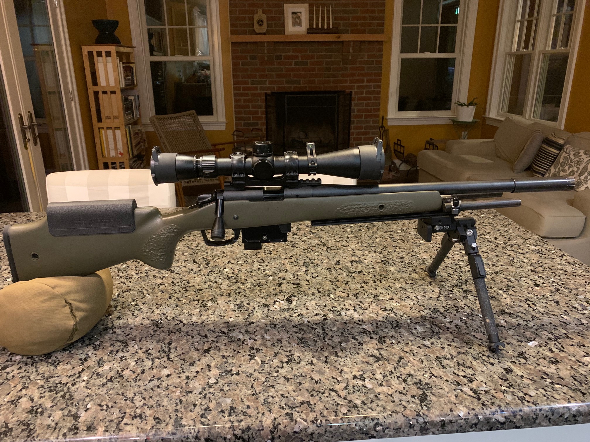

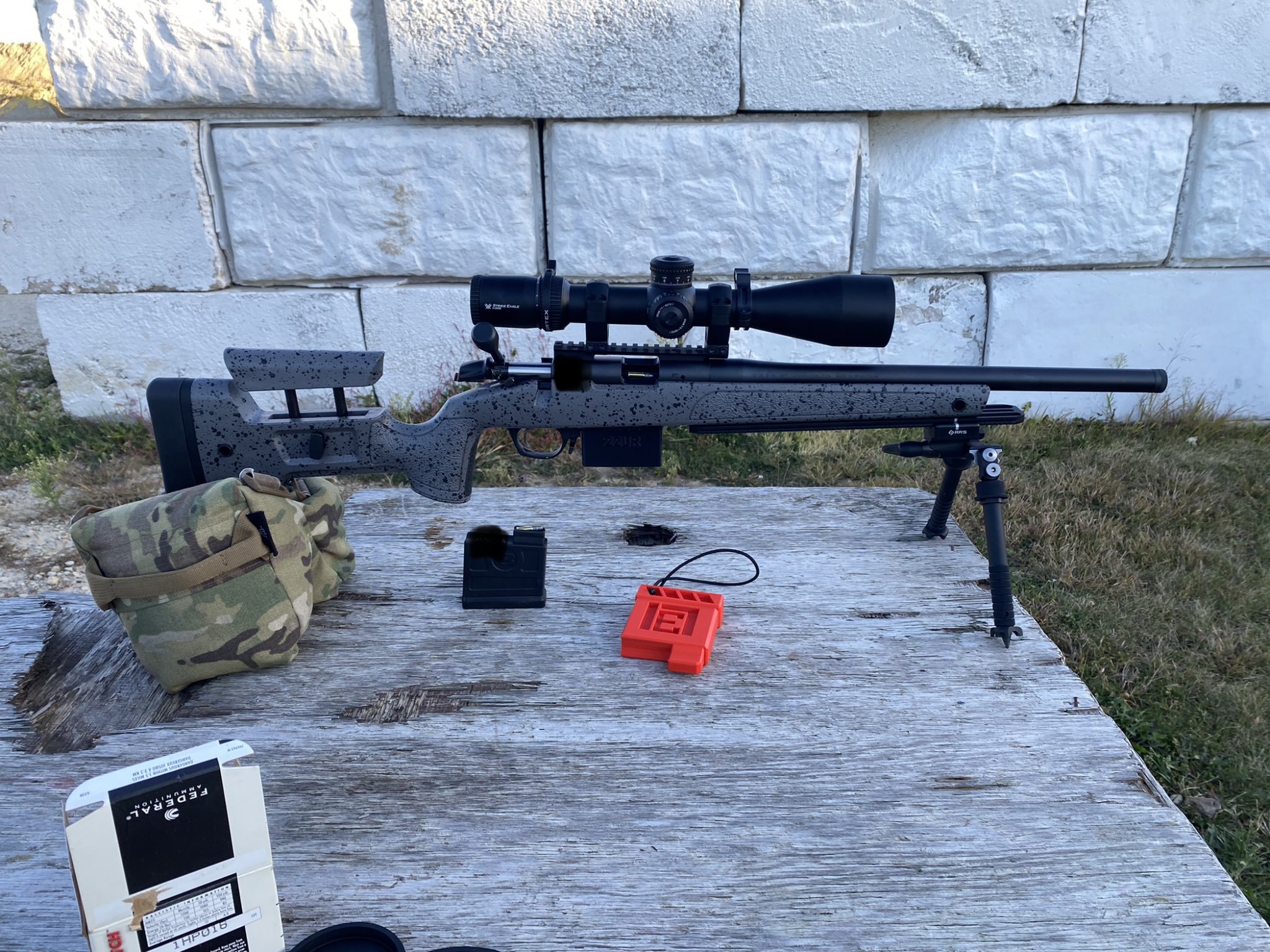

I swapped out the LHT 3-15 for the G2 4.5-27 in a 20moa Spuhr this morning. Switched the can out for my home brew tuner/dampener.
Was mainly load testing 224 Valk & 25 Creed today, but got the B14R re-zeroed with the G2.
On the way out of the driveway to the range there sat My Fed ex from Creedmoor Sports with the SK High Velocity Match.
Shot a group at 200 to see how far off Strelok was (pretty far). Group was 1.9" tall x 3" wide.
Tried it at 500y up against range closing & went 4 for 10 on a 10" plate with the SK HV match. 22.9 mil & .4 L spindage.
Next trip I'll tune the dampener for the SK HV & play more at 22 ELR distance.

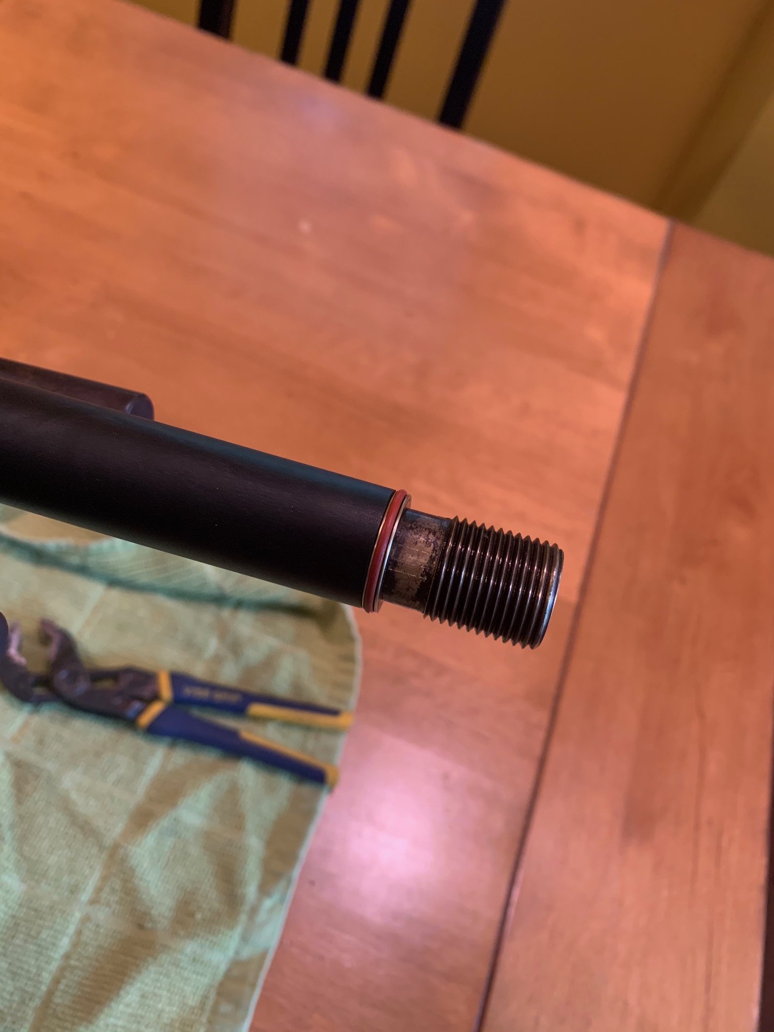

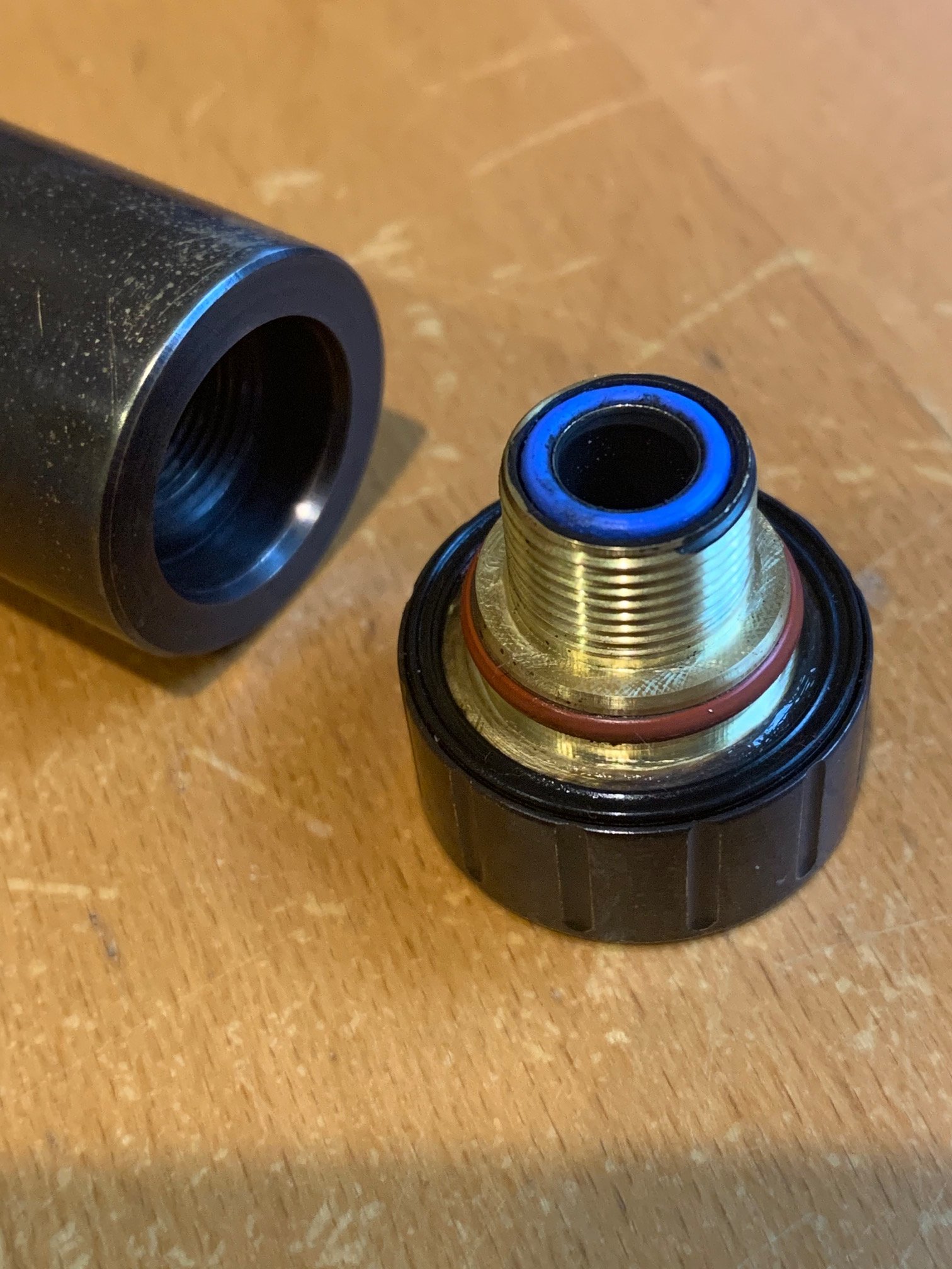

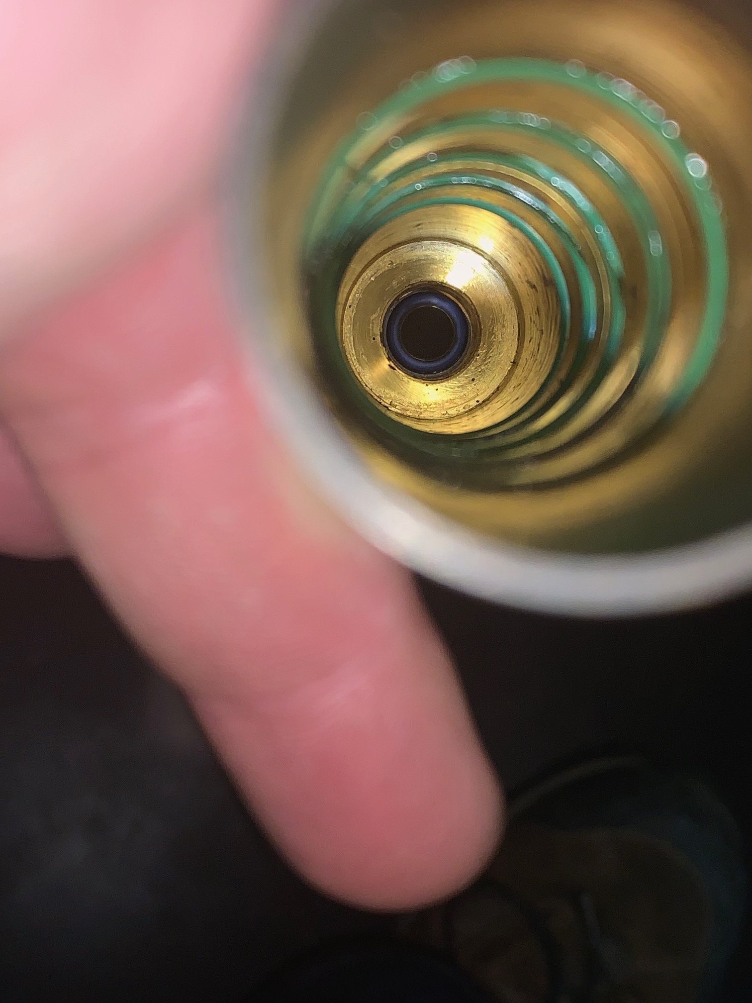

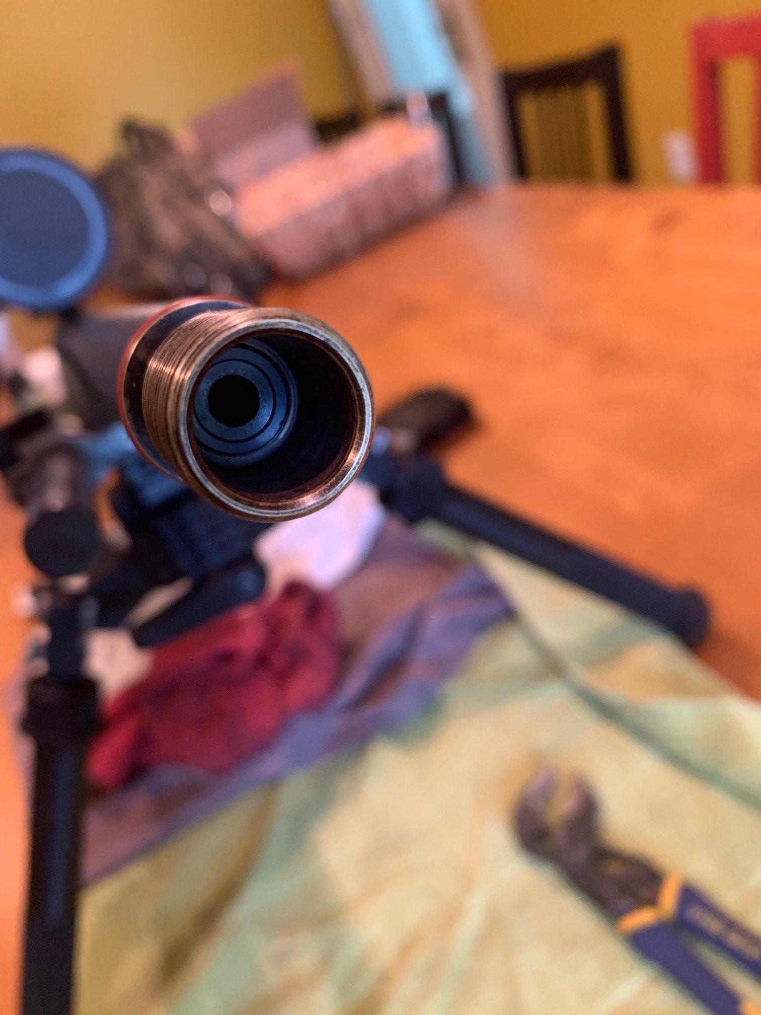

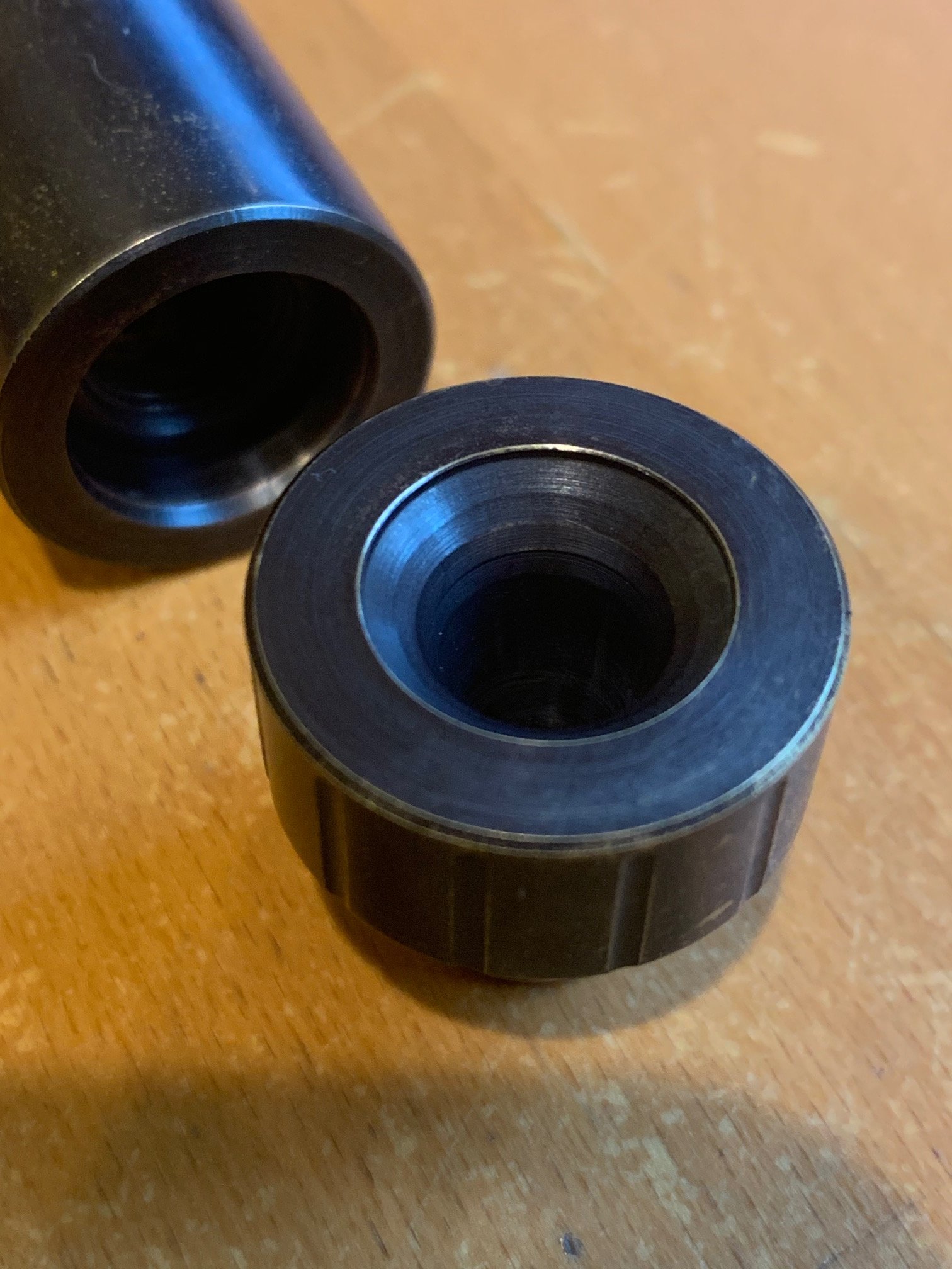

Dampener version #2 has worked well previously. Best results were .683 moa avg. 6x5 @ 100y with SK LR & .574 moa avg. 6x5 @100y with Eley 10X.
Today was the first time I've run it with all 5 o-rings installed. Had 3 installed for the previous best groups. Didn't have time for 6x5 today.
Dampener version #1 didn't perform any better then bare muzzle. I don't think it liked the 7 degree taper + 7 degree angle changes crown - exit.
This was only tunable via o-ring arrangement. It did have a unique report, but it's now in the spare parts bin.
Tunable dampener version #2 is a little simpler and more compact. Tunable in/out 1" & I got the o-ring tension tuned better.
This one has made a noticeable improvement (3 of 5 o-rings installed) & by luck was in the middle of adjustment range for SK LR & Eley 10x

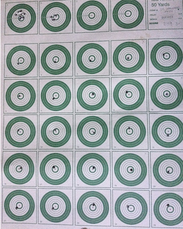

This was shot from my steel barrel B14 in a bravo chassis using sk long range match ammo. This is the best score I’ve ever shot on this target using any gun or ammo. The best I shot previous to my B14 was my savage BTVS and was a 243. I know the btvs isn’t a bench rest level gun but the Bergara shoots better with just about every ammo type.

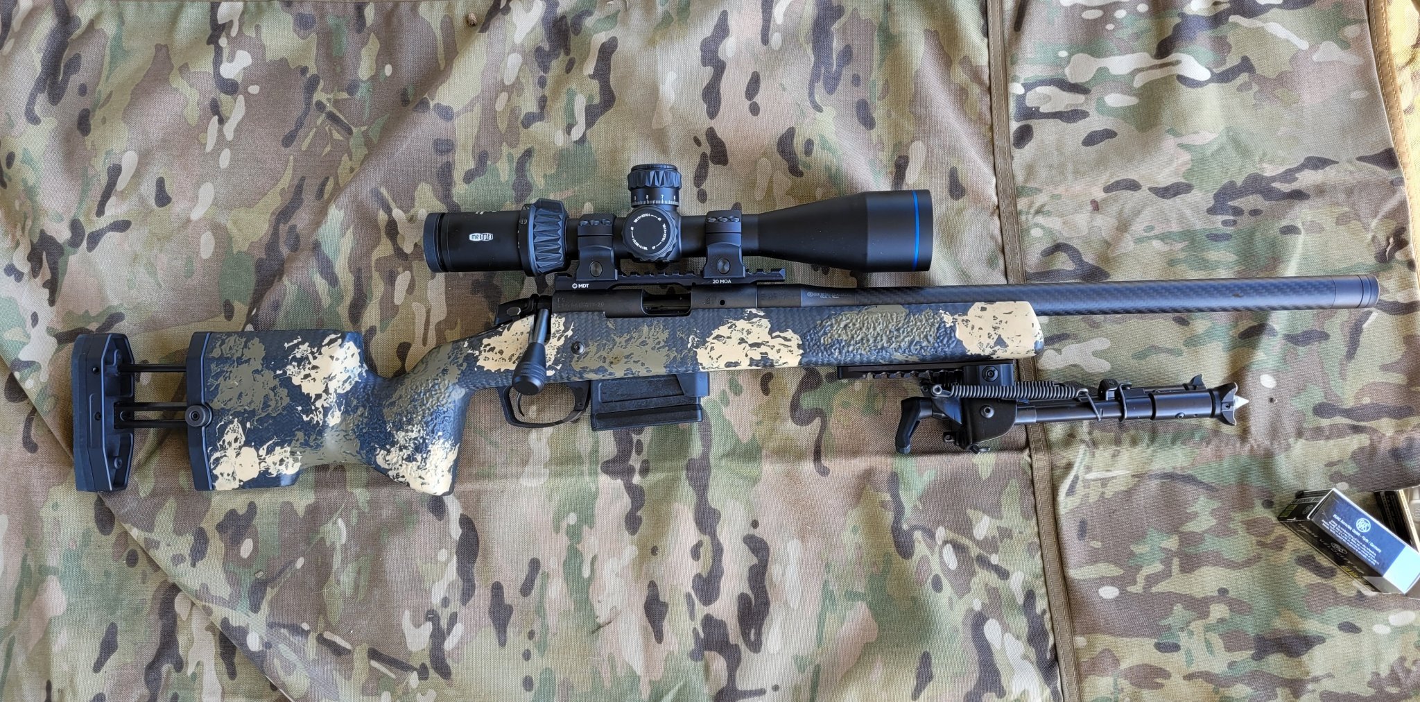

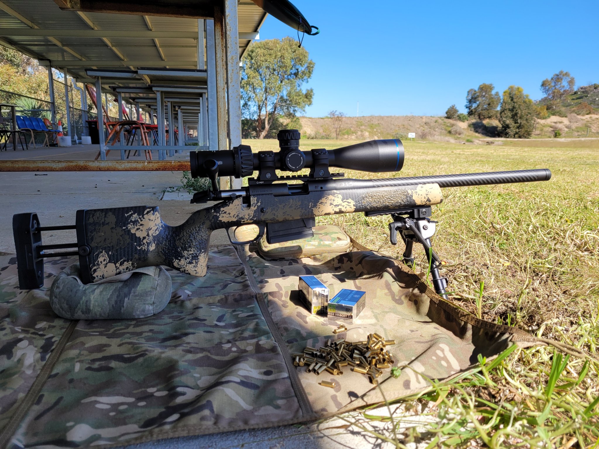

Just breaking in a B14 R carbon…. SK plus Standard best of the ammo I had available (Eley Edge, RWS Rifle Match, SK). RWS stuff was mediocre in an Anschutz too FWIW.

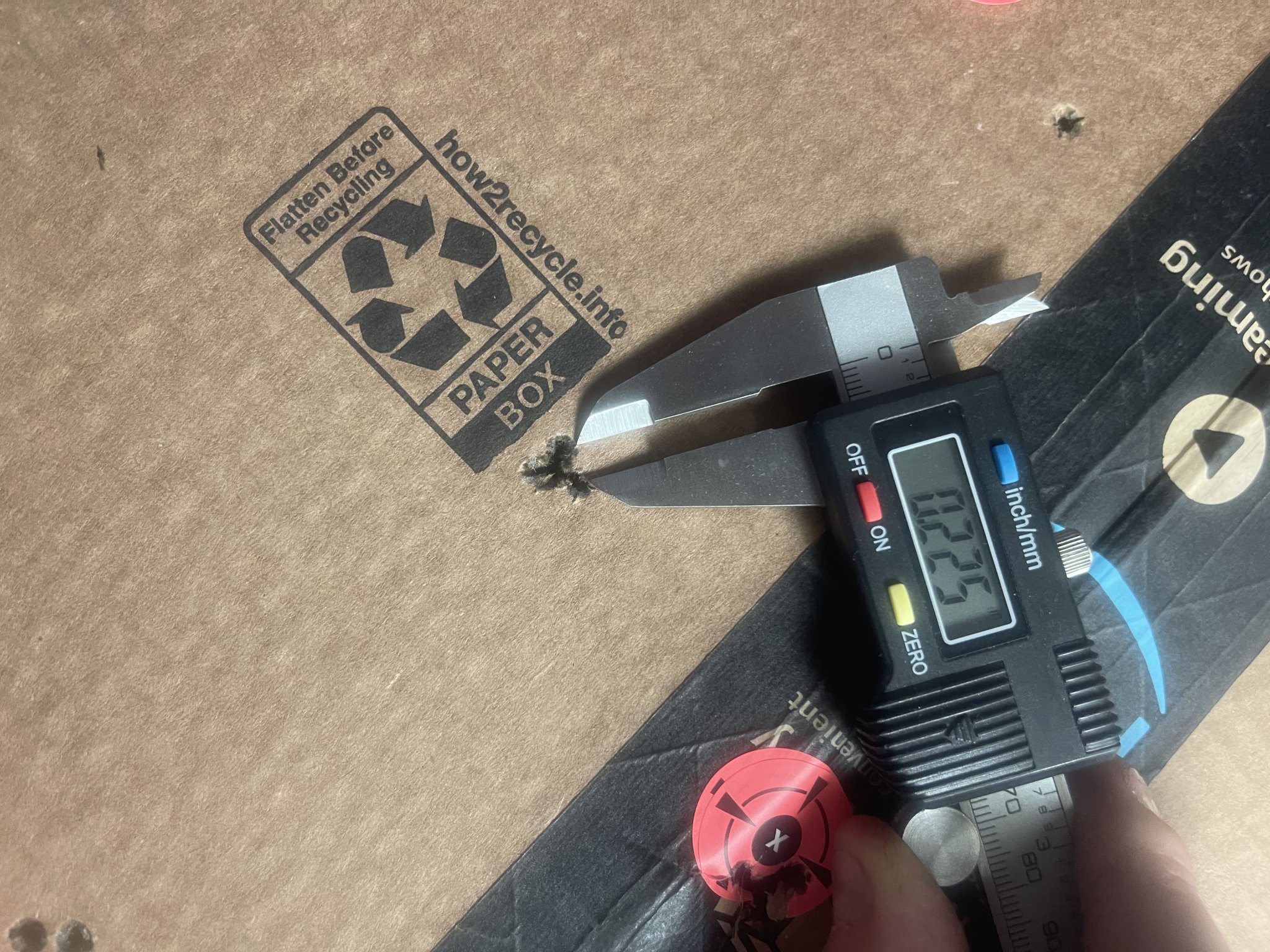

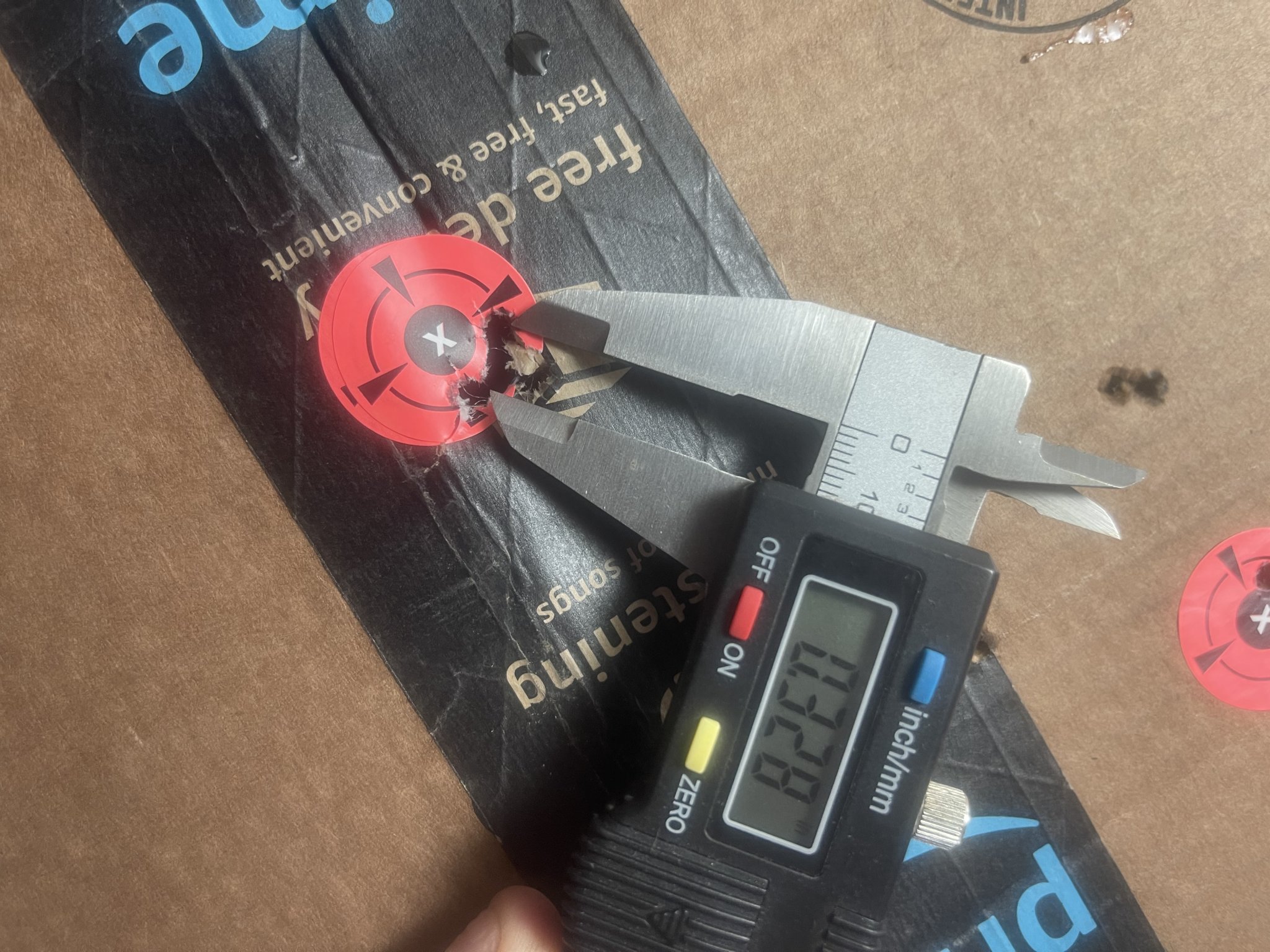

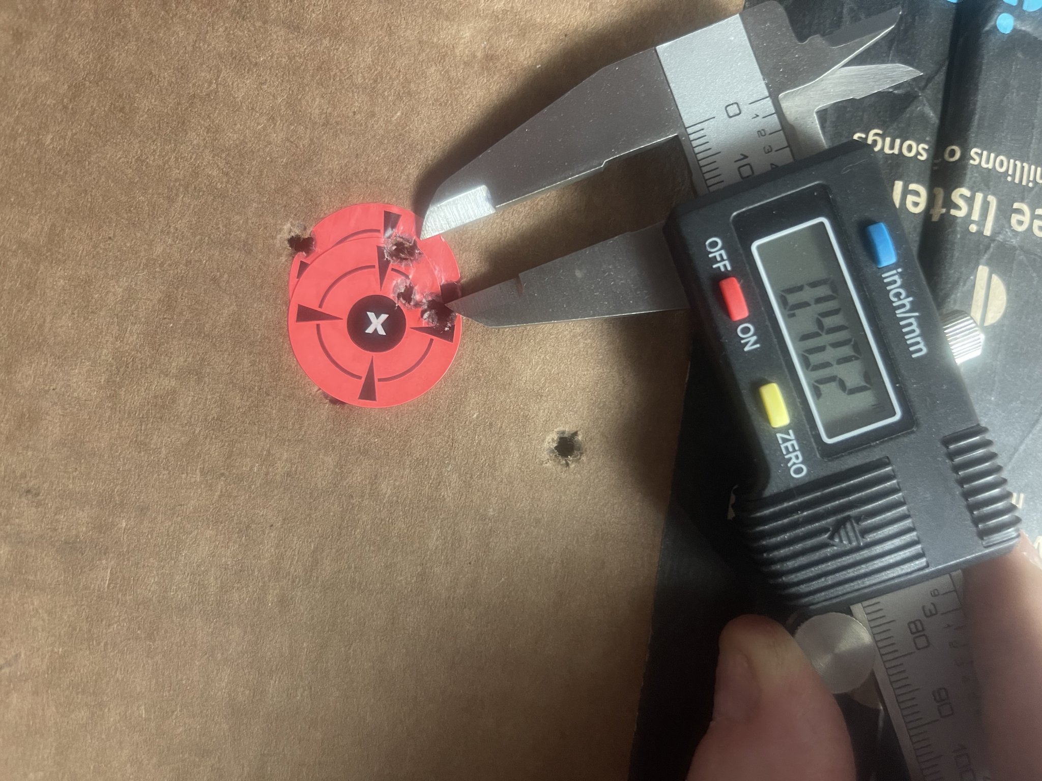

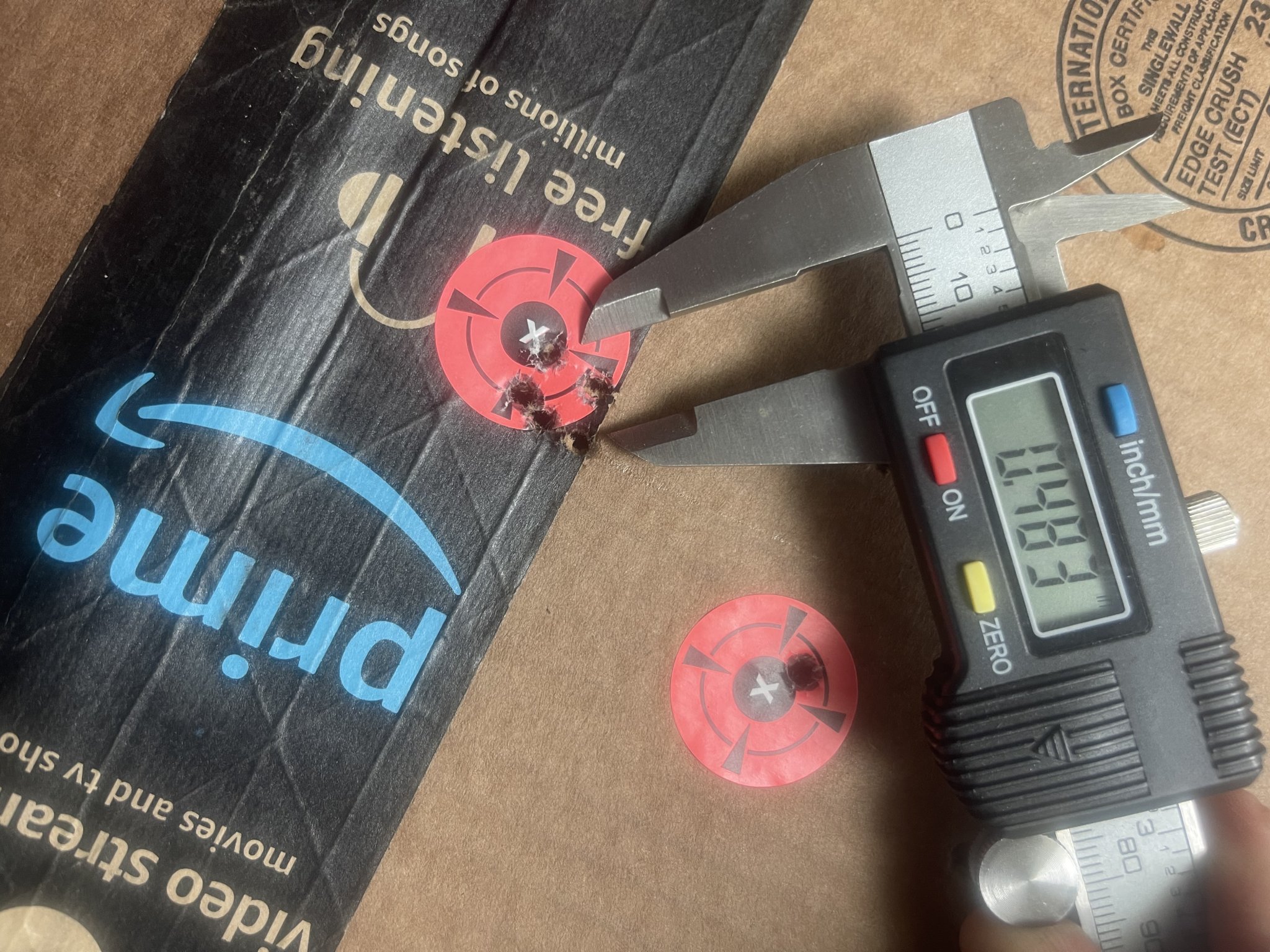

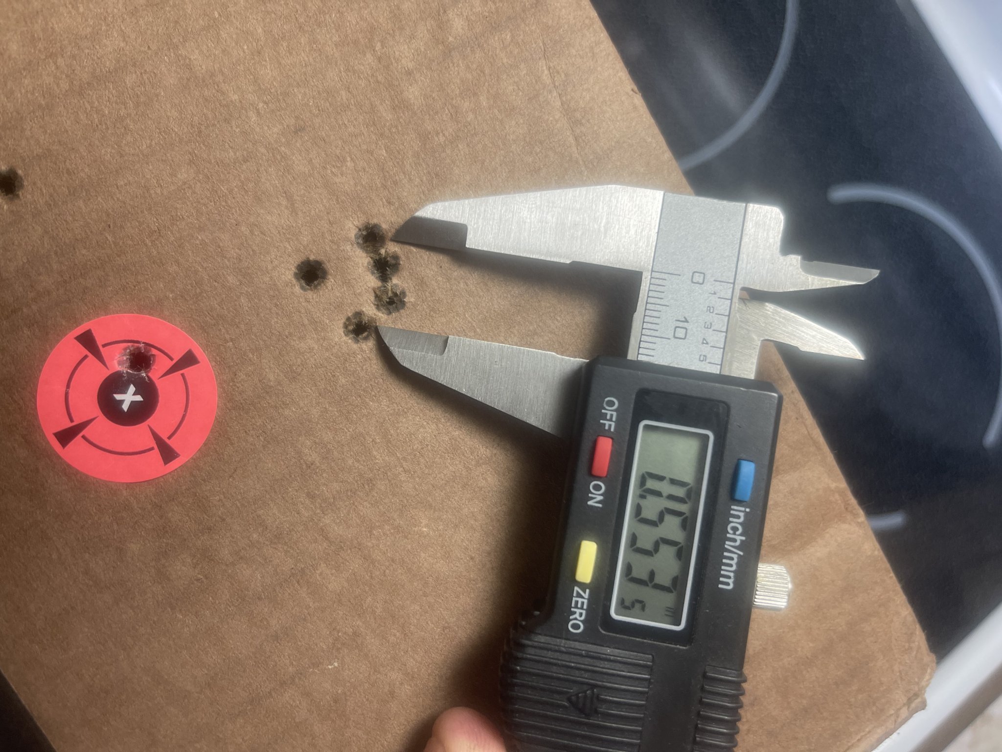

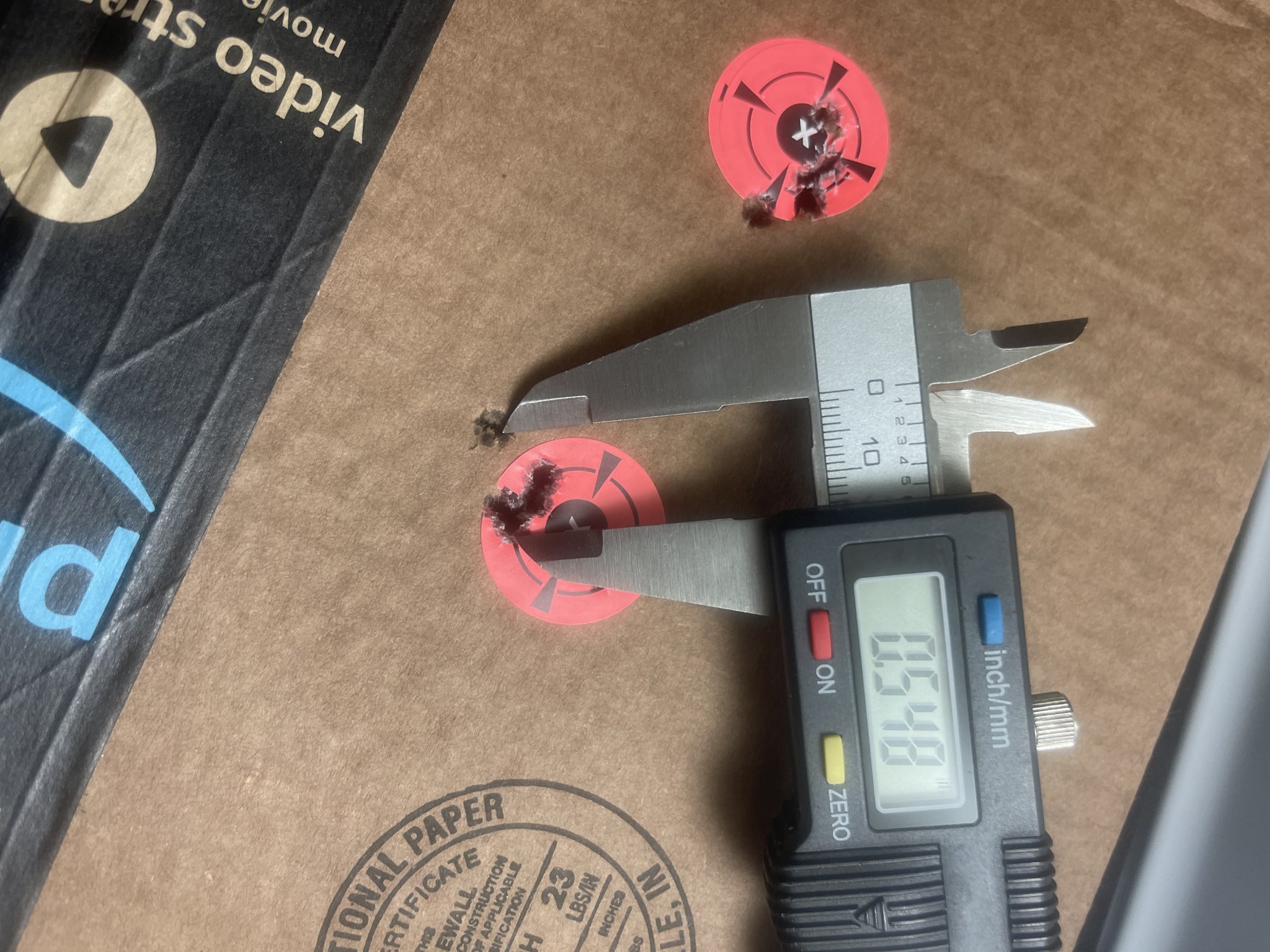

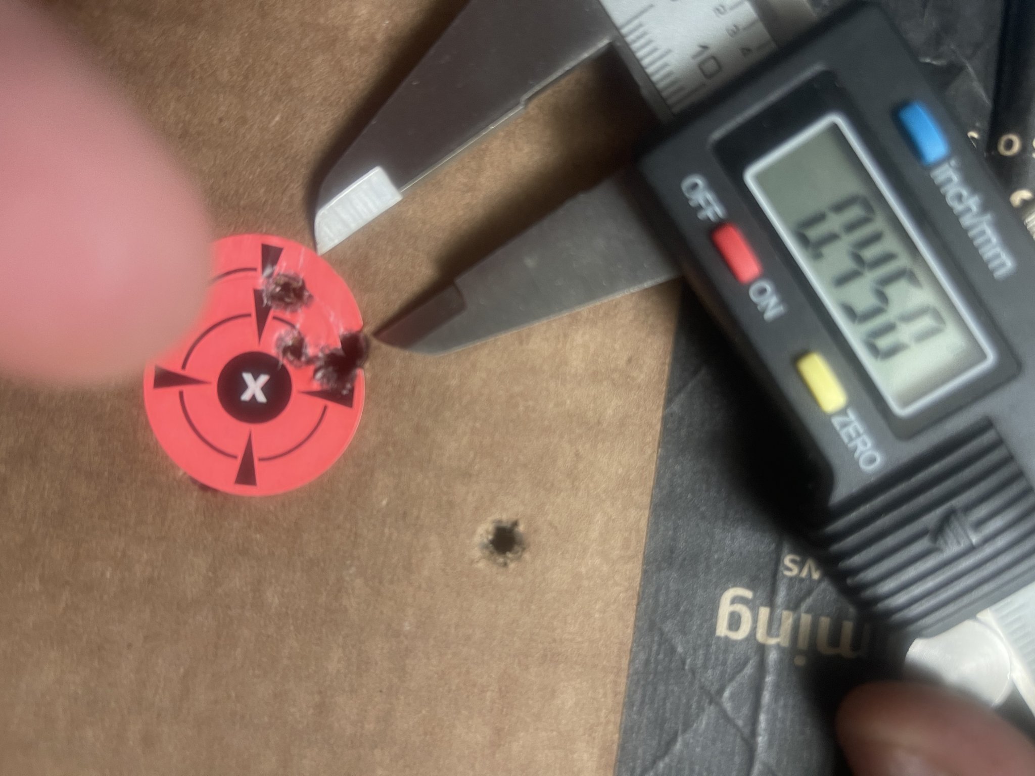

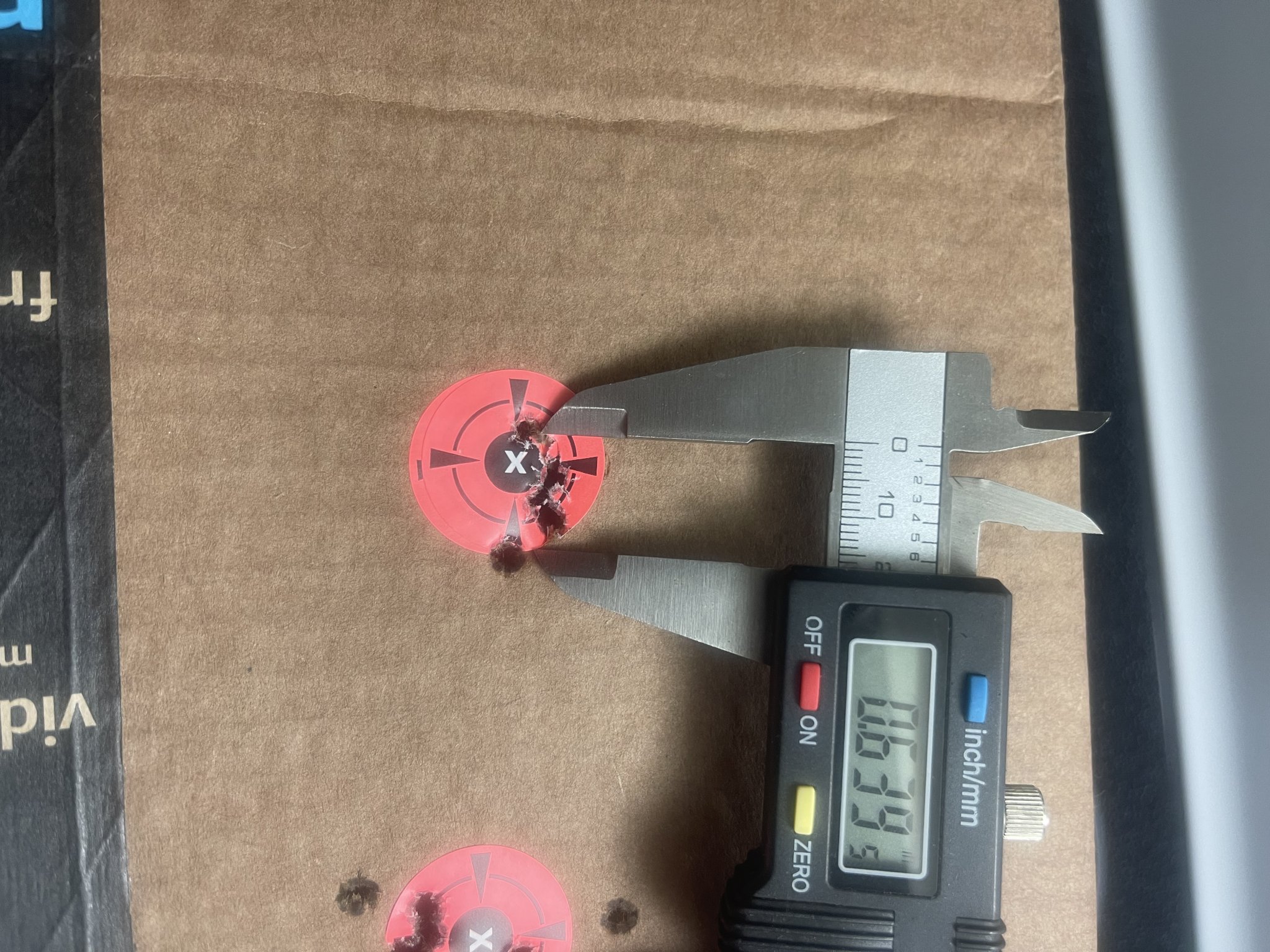

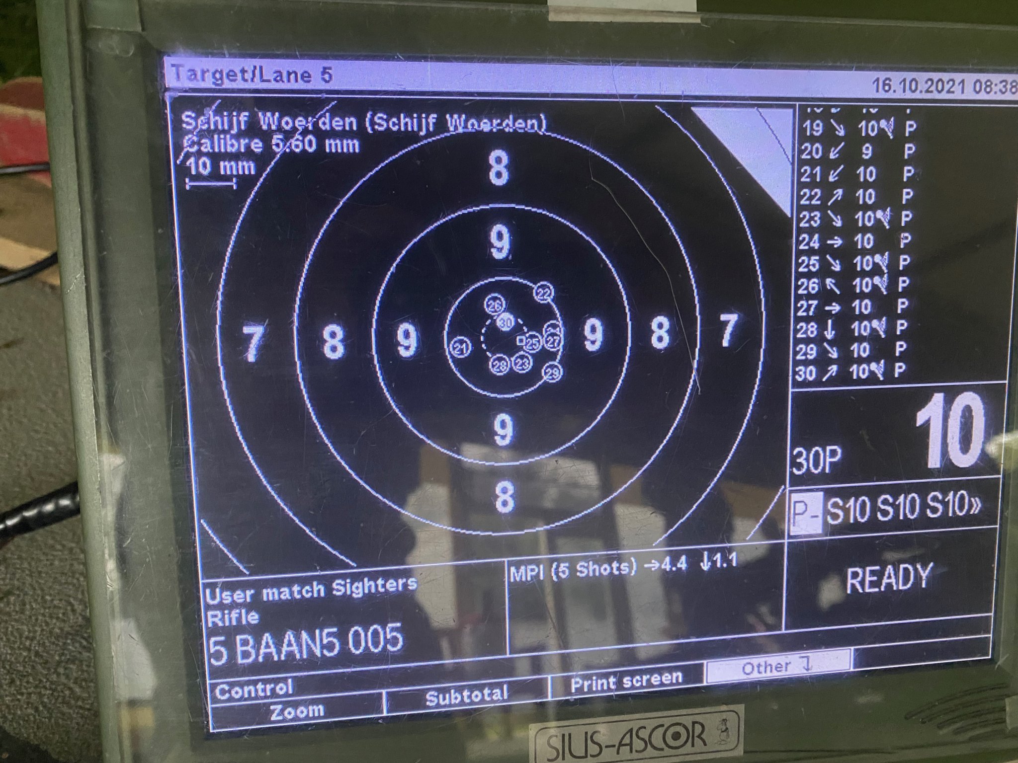

Shot my B14R for first time today. Few 5 round groups using SK LR Match
Before people jump on it yes there’s several shots around some of the groups. I sighted several rifles in today and just jumped on some of the targets that had shots around them to group the last 20-25 rounds I had
Seems to be decent. Gun did drop spent casings into the gun once and a while which got annoying when trying to shoot groups.
All 5 shot groups are inside the caliper,
50 yards
