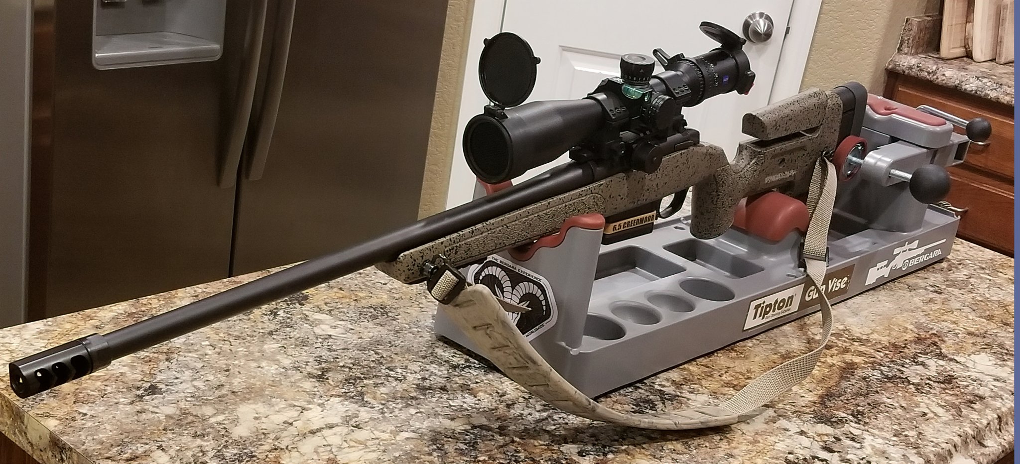

Bergara b14 HMR
Just picked one of these up a few months ago. I got my scope mounted last weekend can’t wait to see how it does

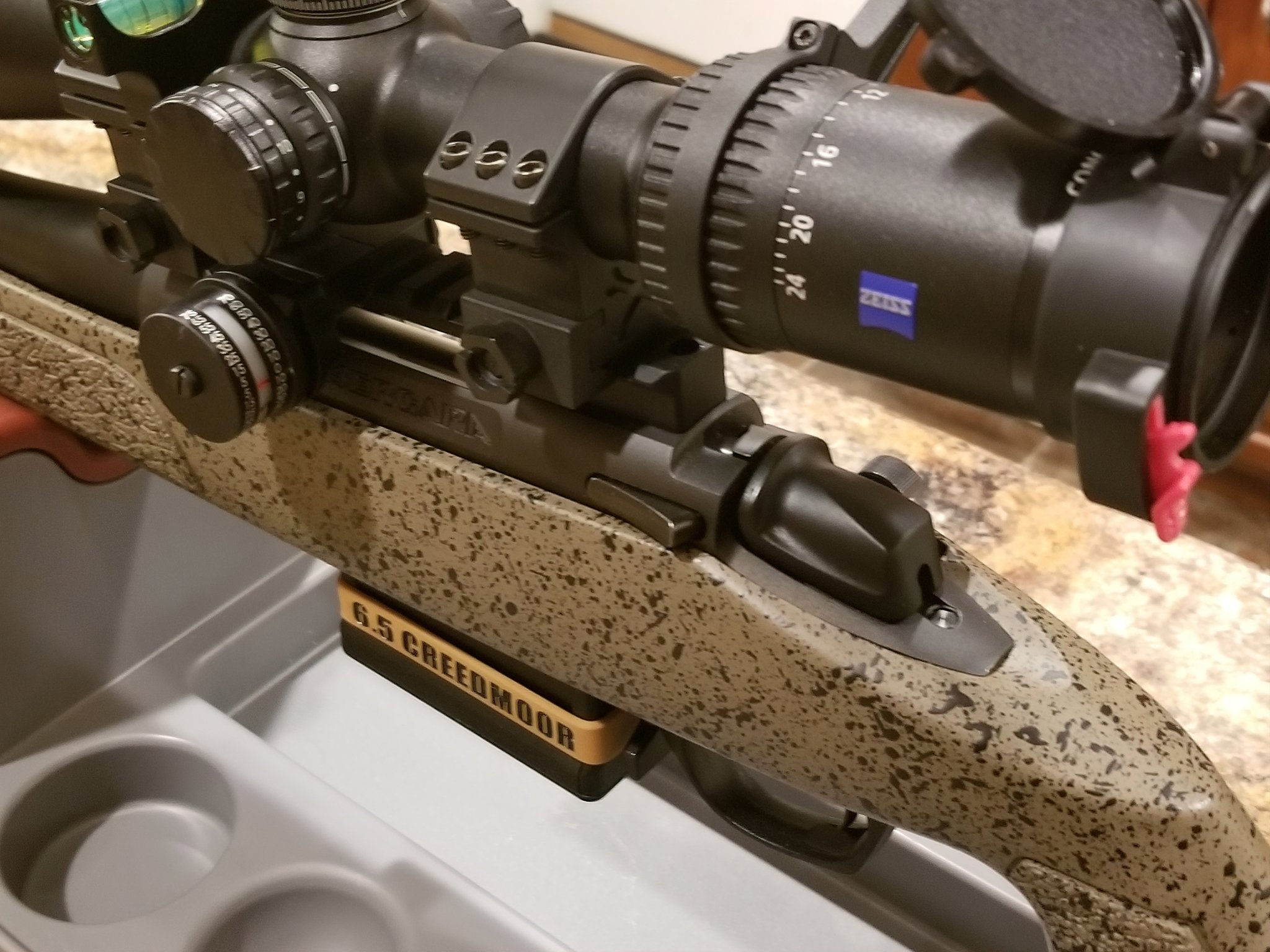

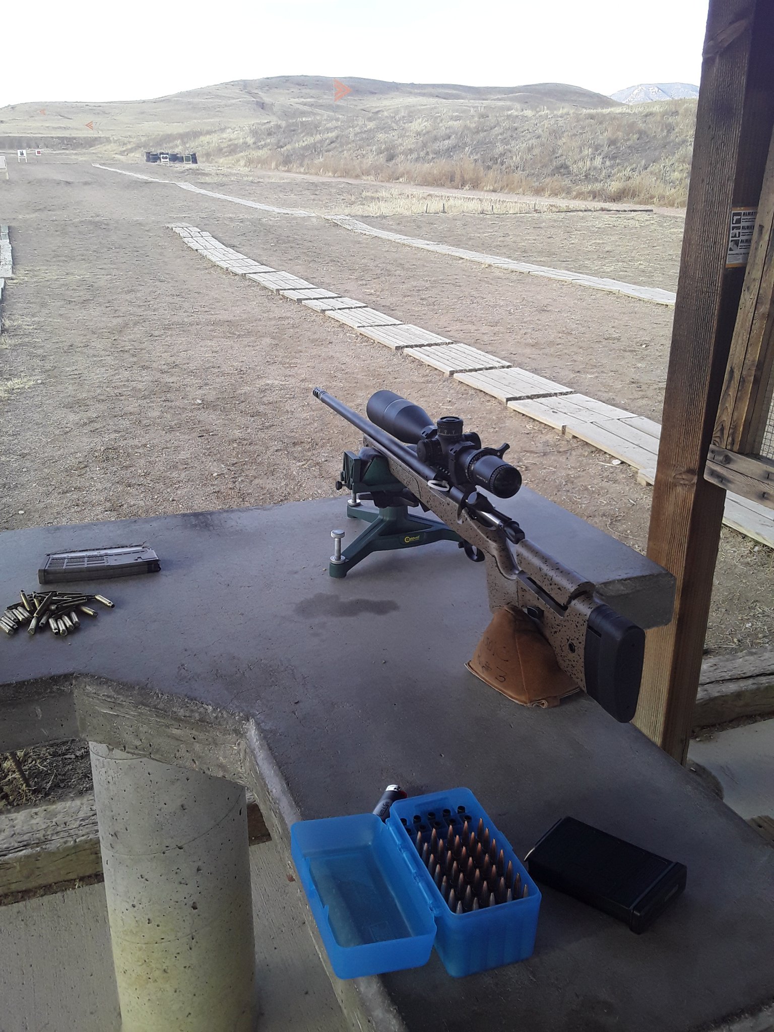

Mounted my base, rings and optic the other day and got her all zero’d in with 140g eld hornady factory ammo. Rifle is looking promising in the accuracy department. Cannot wait to get some handloads run through it!

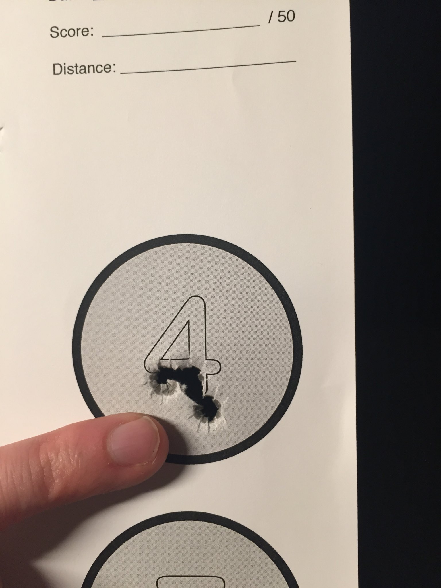

My expectations for my equipment can be a little high at times, but the Bergara HMR really has been better than anticipated. Is it as good as a 4k custom build, no, but it has a hell of a lot to offer at a sub 1k price point.
5 rounds of Hornady 143gr Precision Hunter @100yards.

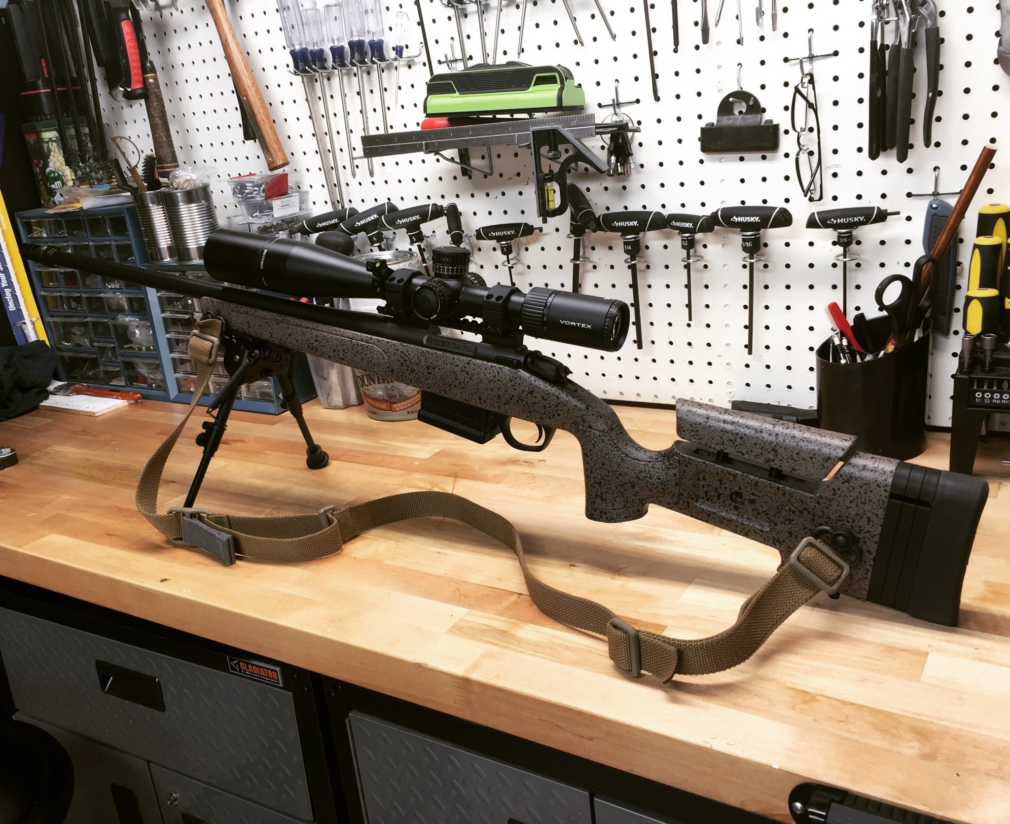

I recently received my new Bergara b14 HMR In 6.5 creed and I've received a ton of questions from people about it, but haven't seen much on the web outside of shot show coverage. So here's my rifle, and I'd be glad to answer any questions.
A couple observations....
The stock, though it is very reminiscent of a manners etc, is no where near as beefy, you can flex the fore end without a ton of effort. But it is quite comfortable and the adjustments are easy and solid. I probably won't change the stock until I rebarrel it and need to make room for a barrel nut.

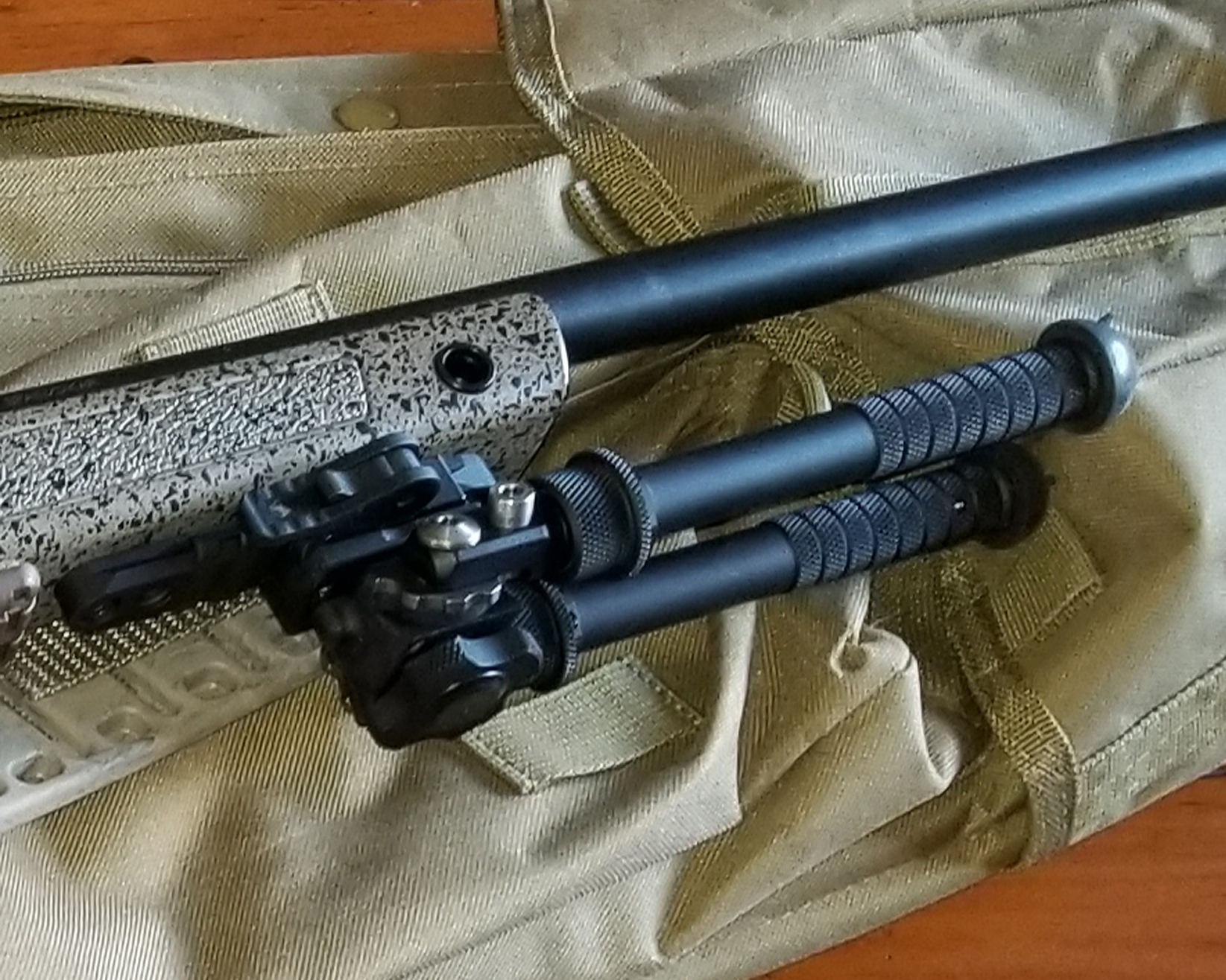

The front sling studs are a little farther apart than most, about 3.2" and will require an Accushot BT17 rail (waiting on mine) to mount an atlas bipod or any other pic mounted bipod.
i put a timney 517 in it, with zero issues. They say the stock trigger can only adjust down to 2.8 but it felt really good to me out of the box, crisp with no creep. If I didn't already have the 517, I would have let it be.
How did the Accushot BT17 rail work out? Any issues or are you happy with it?

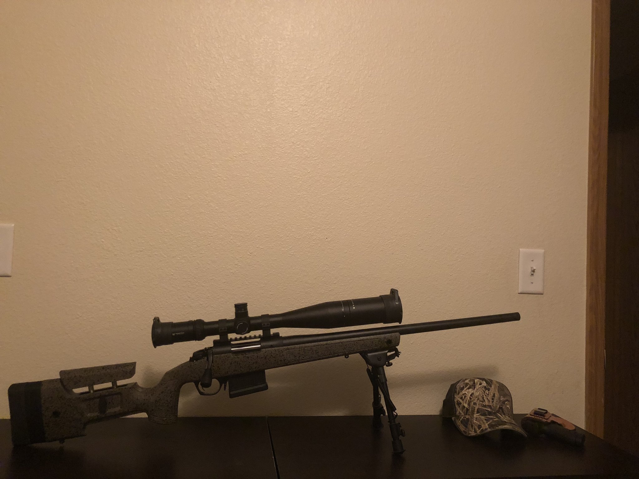

I’m a straight rookie who bought the HMR in .308 in March, 2021. It’s sub MOA all day long. Went to my first Precision Rifle class at Peacemaker NTC September 12th . Numerous hits at 950 and 1025 yards. I’m keeping this bad boy!

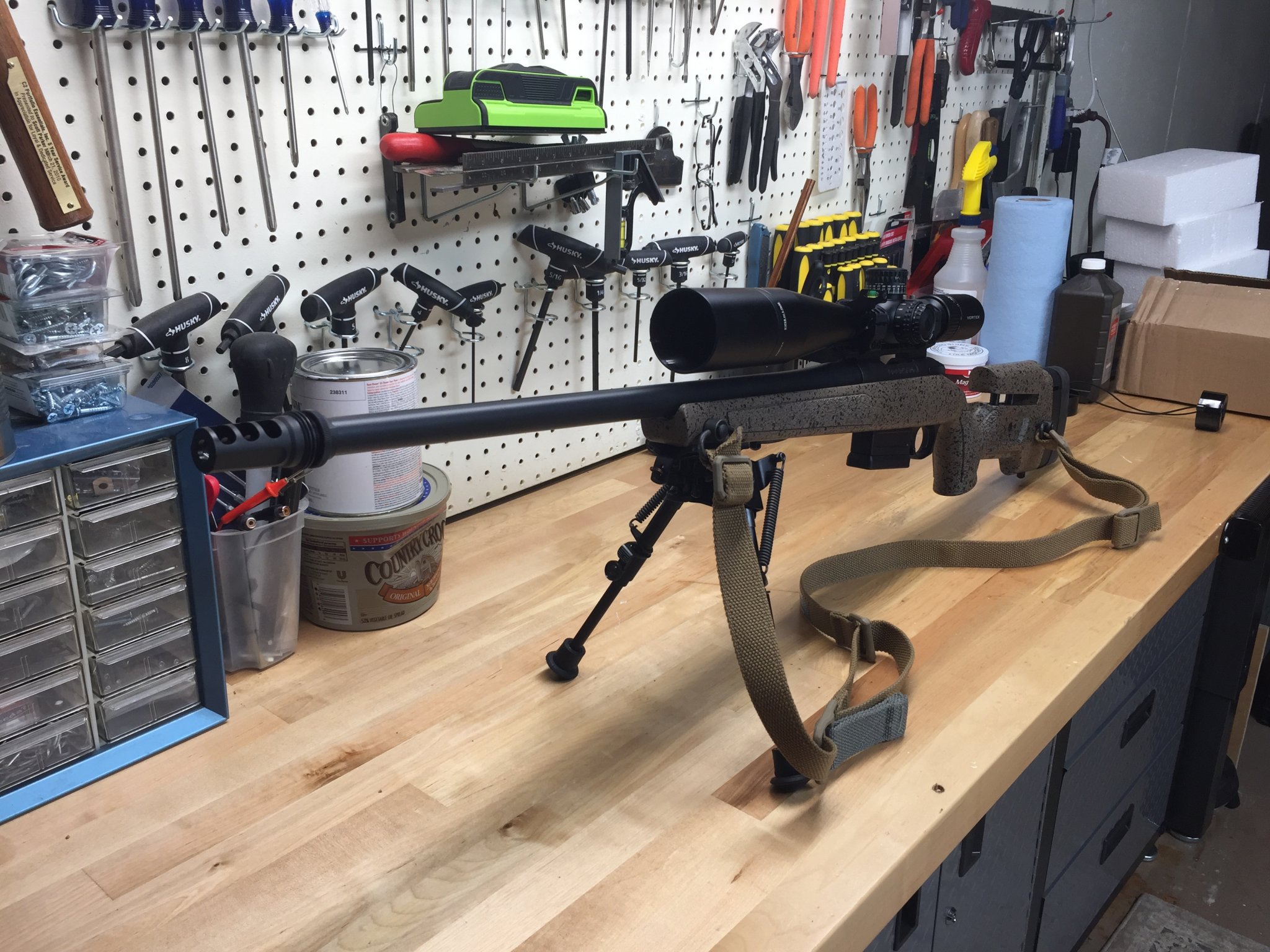

I got the Area 419 rail for it. 40 bucks. Waiting in my atlas bipod also. Love my begara B14 HMR. I found a left hand version that they make and grabbed it up. Put a night force 20 MOA rail on it.
I have a Vortex Strike eagle 5-25 on it and took it out saturday for the first time. Sub MOA with ammo made for another rifle. Will be doing some LD for it this week. Will report back.
