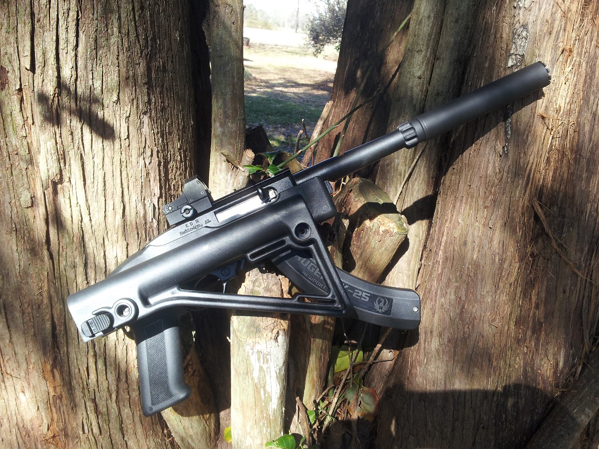

Had a similar issue with a known decent 10/22 that I SBR'd. The barrel was cut down and threaded, a blem folding stock was obtained from AGP, a suppressor, and a Burris Fastfire was attached. This was to be a tractor gun for targets of opportunity while mowing - wasn't a target rifle. When I tested it, I noticed at once mags hung up in the stock. Shot it anyway. Had a lot of light strikes and a few jams. The kicker, tho, was the 8" groups at 50yds... so I inspected the crown and threads again, no issue there. Moved the barrel and can to a different SBR and it worked fine.
FInally decided to relieve the sidewalls of the molded stock where they were pinching the mags and the problem went away. Entirely away. I can only guess the poor magazine placement from the binding stock caused the bolt to struggle to strip a cartridge and some were not seating all the way; this caused the hammer to have to sometimes seat the bolt and fire the round. Inconsistent ignition resulted.
